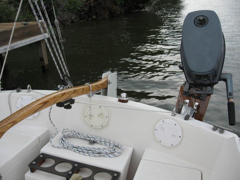

I apologize up front for this lengthy post but it was needed to clarify my question. These are exchanges with the USCG that I have had concerning my oday so please bear with me.
"I have a question about lighting on my sailboat. The boat is just short of 7 meters in length. It now has the bow mounted bi-color nav lights and an all around masthead light. The masthead light may be for navigation or it may be an anchor light I assume. The boat does not have a stern light and did not come from the manufacturer with a stern light installed. My question is this.
Can I use my bow mounted nav lights and the all around masthead light at night under sail? I believe that if I am under power at night I turn off the masthead all around light and use my bow mounted nav lights and stern light (which it does not have right now). I am often under sail and power at night so I do not want anything that would illuminate the sails since I would be blinded at that point for night vision. This would make a mast mounted "steaming" light a bad idea. I think what I can do is just add a stern light and turn off the masthead all around light for powering at night(with the bow mounted nav lights on of course). This brings up another question however. If I mount a stern light in the center of the transom it will be partially blocked by the rudder post. Is it legal to mount a flush mounted stern light off center to avoid having a portion of the light blocked by the rudder post?
I would mount it on a staff under the boom but it would get in the way of the tiller. Thanks so much for any advice you can give me."

I am still a bit confused. I obviously need to mount a stern light which I have done but I do not want to mount a "masthead" or "steaming" light because it will illuminate the sail and I will not be able to see at night. Can I use the all around anchor light which is visible for 2 nm , my bow nav lights and the stern light without adding the steaming light?
This would make a mast mounted "steaming" light a bad idea.\

Not to beat a dying horse but the USCG seems happy to accept my all around/anchor light along with the nav lights and the transom light. They did not mention having to add a steaming light at the spreaders. Here is another part of the email from them:
"Given the fact that you already have bow mounted sidelights and the masthead/anchor light and only require a sternlight you're proposed course of action to mount a sternlight slightly off-center is acceptable."
Remember when you opt to illuminate the sail at night you should not be under power (power-driven) as that would falsely be advertising your situation and require other vessels to steer clear of you unnecessarily.
We hope this answers your inquiry and we exhort you to always navigate safely,
U.S. Coast Guard
Office of Navigation Systems
Washington, DC 20593-7851
So according to them I only need the nav lights, the stern light and the all around masthead light.
Am I missing something here? Probably but they really have confused me now. I would really like to just be able to switch off the masthead light when I am under power or turn it on when I start the engine.
