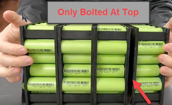

This nickel plated copper plate is relying on friction to pass the current cell to cell.. As can be seen there are only bolts at the top and they are bolted into plastic..

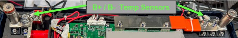

They claim their BMS is not "off the shelf". If that is true, they can add a few temp sensors for pennies. Place one on B+ and the other on B- inside the battery. Epoch does this for a lot less money..
