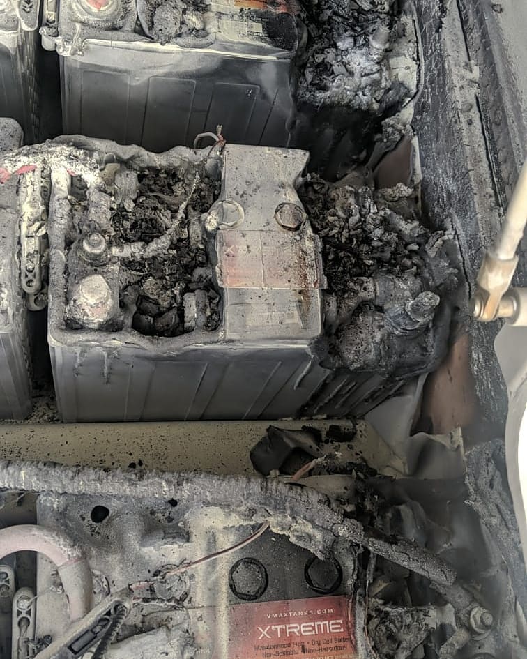

I've never felt safe with lead-acid batteries. The second most dangerous battery chemistry to have on a boat.

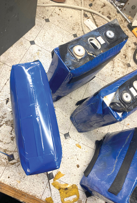

Meanwhile, here are some 3.2V lithium iron phosphate batteries that were charged to 100V(!!!!!)
