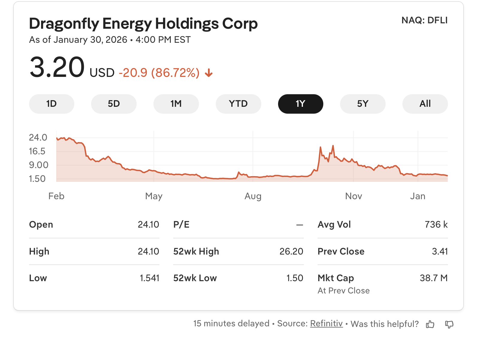

14,157
Battle Born batteries are manufactured by Dragonfly Energy which has 3 product lines: Battle Born LFP batteries, private label LFP batteries, and Wakespeed regulators. It is a publicly traded company, so we can look at how the market feels about the company. Prior to February 2025 the company's stock held in the ~$20 range. In the past year the stock has drop about 87% and stayed except for a flurry of activity last fall preceding a 1:10 reverse stock split necessary to avoid delisting from NASDAQ. Last week the company announced the availability of BattleBorn Solar Panels.
Dragonfly appears to be a company in trouble. I'm wondering if the founders of Wakespeed are second guessing their decision to be acquired by Dragonfly. I wonder what the investors saw that caused them to dump the stock a year ago.
