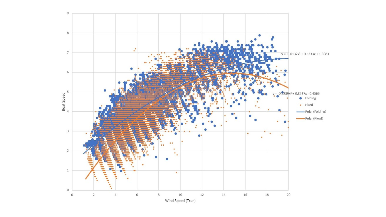

Folding props, in my opinion, are really best used by racing boats. There was a study done - I'm not sure if it was posted here on SBO a few years ago or where I read it but I apologize I don't have a link to it on hand - that quantitatively measured the actual decrease in sailing speed between a fixed blade and feathering prop. As I recall, there was a measurable hit in boat speed at low wind speeds and again at the top end of wind speeds, IIRC. But the middle range of wind speeds showed there was very little difference.
Your mention of improved speed at high wind sounds like you might be remembering my observations switching from a fixed prop to a Flex-o-Fold. This is the graph of my boat speeds relative to wind speed. Orange dots are my original fixed prompt; blue is the Flex-o-Fold. Solid lines are the best-fit curves.
The split at higher wind ranges is probably pretty unique to my model of boat where the turbulence in front of the rudder causes rudder stall at high loads. The lower two thirds of the wind range are probably more consistent across other models of boats. We do lots of Chesapeake sailing, including casual racing, where the half knot extra from the folding prop is nice.
As much as I like the Flex o Fold for the type of sailing we do it is necessary to find the right tool for the job. For trade wind sailing there's probably not much advantage in a folding prop, although the Flex O Fold has basically no extra routine maintenance requirements, and the folding mechanism is robust enough I'd have no concerns about its durability, so there's not really any downside to it either. For the type of trip the OP is planning the MaxProp might be a very good option - its sailing drag is not quite as low as a folding prop but its power motoring is generally better than even a fixed prop, and its maneuverability and power in reverse (for example when docking in unfamiliar marinas) is much better.
That's interesting data. How are you recording it?
I have a Raspberry Pi running SignalK connected to my NMEA network. SignalK saves all of the NMEA data into a database, and then I can query the database for different time periods. If I remember right the points on that plot are about four years of data, filtered to times when I was racing (so not just casually trimmed) and when apparent wind angles showed a beat.
There are some factors that are hard to control for. We had the fixed prop when the boat was brand new and converted after a couple years, so it’s possible that by the time we converted to the folding prop we’d learned how to get more performance out of the boat. Offsetting that the sails were probably a little bit more worn and stretched in the folding prop years. Also we switched from a hard bottom paint to a hybrid ablative the same year we got the folding prop, and I suspect the ablative might be a little slower than the original. So I don’t know if the trend lines are exactly an even comparison, but I think on balance they’re a good indicator of the value.
This may be what I'm remembering. I don't recall you stating the higher speed may be due to turbulence. It would be very interesting to see a similar study across more boats.

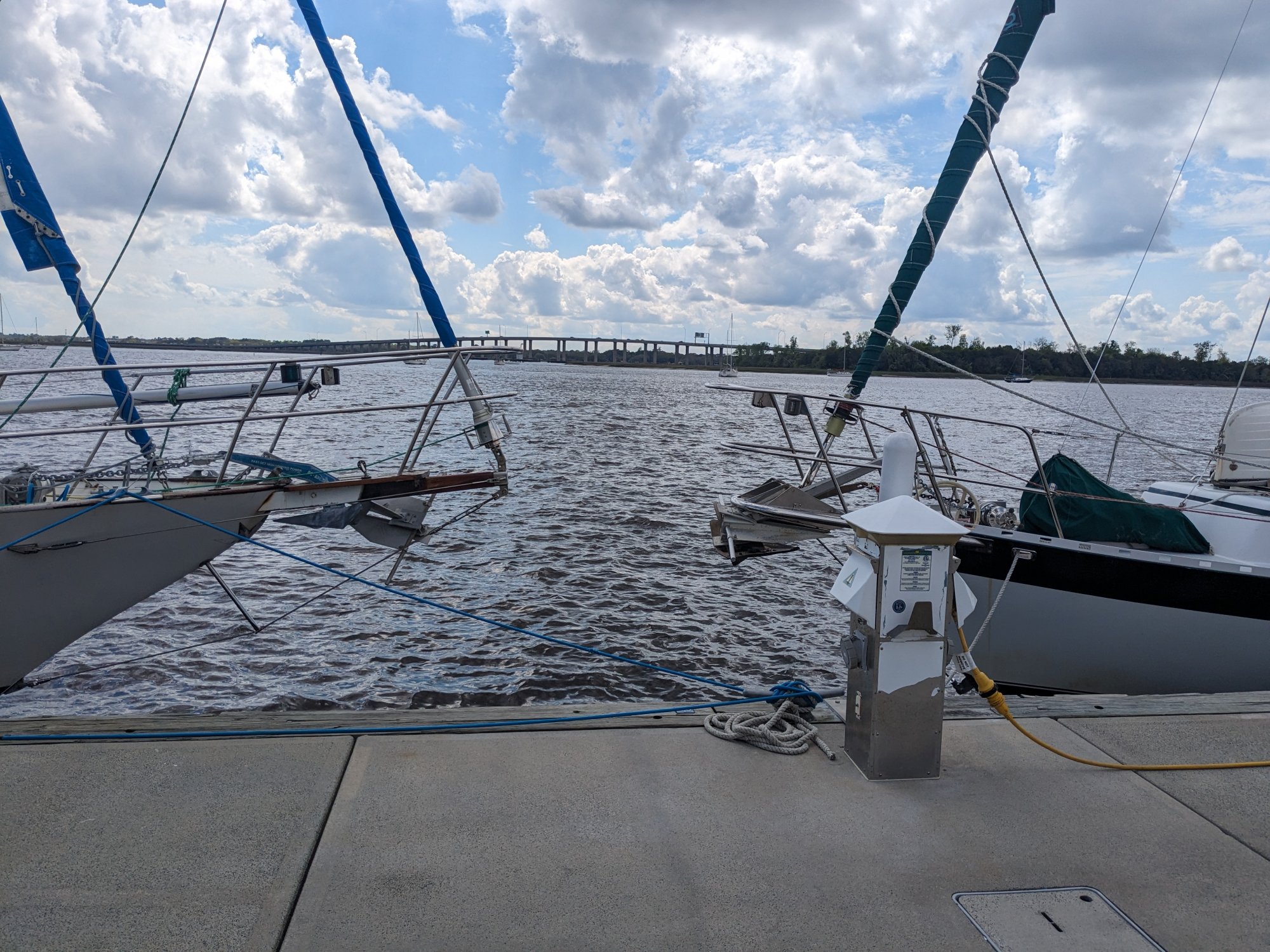

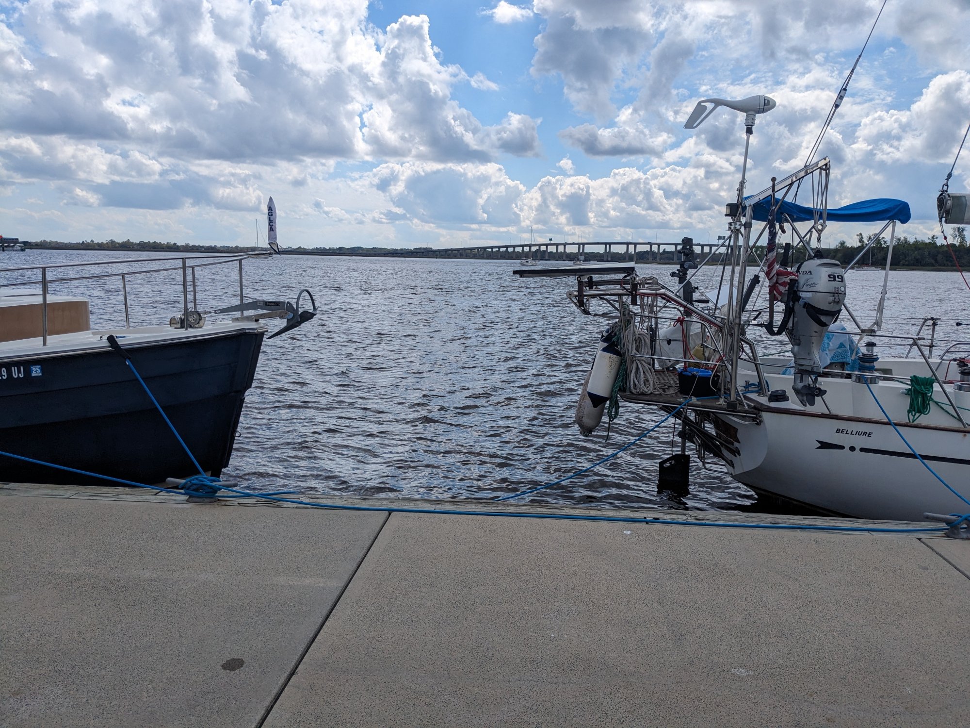

Here are two photos I took after docking down in Charleston. We came into Charleston Harbor and went up to the marina near the Charleston Yacht Club. they have this huge long dock, I think they call it the mile long dock or something like that. In any case we were coming in late, we'd had a long leg to get there - we'd left from the Bahamas. It was pretty late like 1, 2 in the morning thereabouts and the entire dock was full except for this one spot. It was tight. I had wind blowing me away from the dock and current that wasn't helping me. I had one crew with me - it would have been really hard to do this one solo and would have more than likely just anchored out even though tiredness was high... I took these two photos the next morning just before we moved the boat back just a bit to center it in the space. In the one photo, you can see there is about 2 feet between my bow sprit and the bow sprit of the boat forward of mine and about 5 or 6 feet between my aft solar panel and the bow of the boat to my stern. The boat on my stern was a trawler and was about 15 feet wide so I couldn't get very close to the dock coming in due to how wide that boat was. I had to come in fairly hot due to the wind and currents. I swung the bow in as close to the dock as I could and then spun the rudder and hit reverse swinging the stern in and stopping the boat dead - in this position. My crew mate stepped off the boat, tied my spring before we got blown back off of the dock. then we just tied her down.
Somebody is going to have to make one heck of a case for any prop that can out perform this fixed blade. Jus' sayin'

Some marinas really do not provide a lot of maneuvering room. In Daytona the fairway to our slip was not much wider than our boat was long and there were several boats encroaching into the fairway reducing the width even more. With the Max Prop we were able to easily turn the boat into the slip and align it with the finger. Like wise backing out was easy because the prop walk let us turn the boat without making any appreciable headway. That's just one of many memorable docks along the east coast of the US and Canada.
As to being able to to maneuver in tight quarters, I was sailing into Sunbay Marina on the East Coast of Puerto Rico. We needed water. They assigned me a slip that was about 3/4's of the way down one of the aisles (what are these called?). The wind was blowing pretty well and as I swung into the slip, my bow thruster quit (that's a long story). I had to quickly back up to not hit the dock and there I was sideways in the aisle. My boat with bow sprit and aft platform and solar panel must be about 50 feet. I don't think that aisle was much more than 60 feet wide with all the boats sticking out into it. The wind was blowing me sideways down the aisle as it took me a minute to remember how to spin my boat around without a bow thruster - one gets lazy.... By the time I was back in the proper mind, I was well past the slip I needed to enter so I had to spin my boat around to head back up and then into my slip. It was actually easier to get into the slip from that direction given the wind direction. All this to say, I can pretty much spin my boat 360 degrees with almost no forward or aft movement - without a bow thruster.
