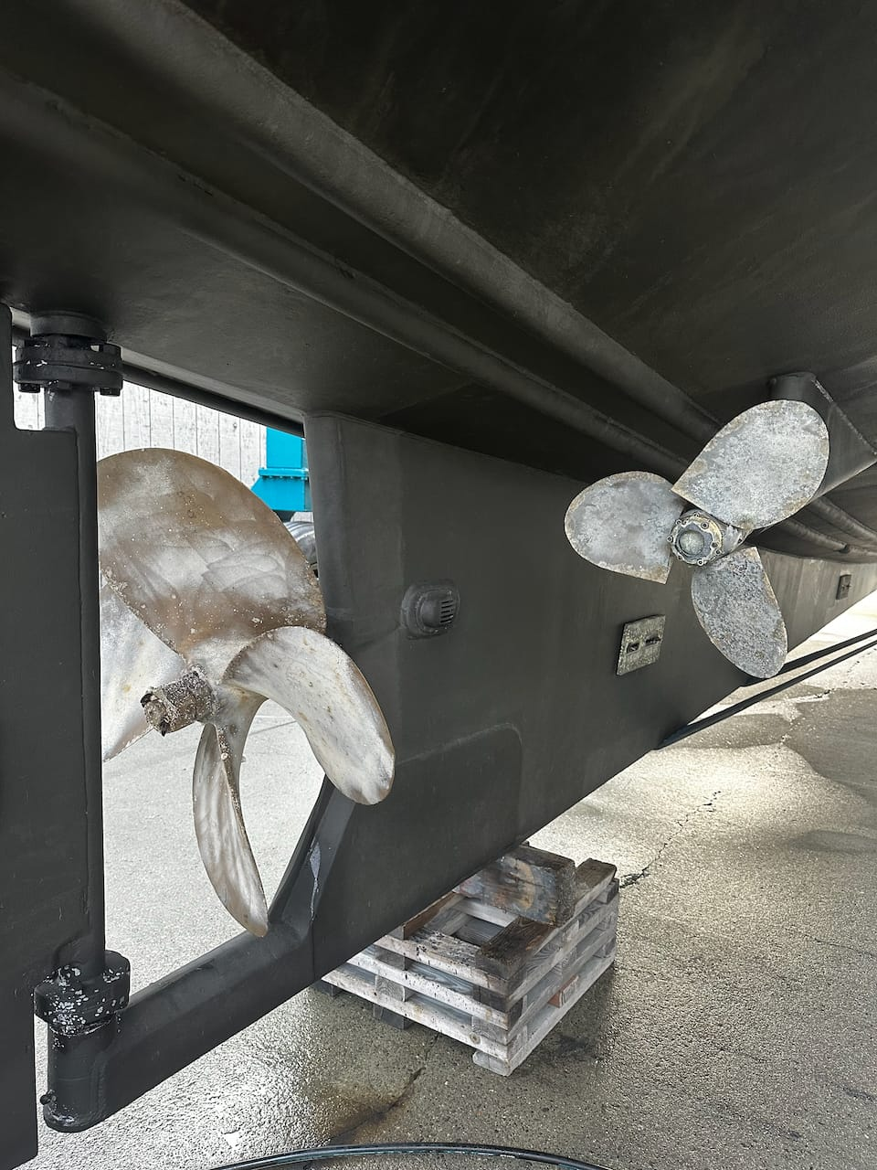

I'd triple check to see if that's the appropriate prop for your engine and boat
Well, trawlers don't use folding props.
This one does! It's a really neat setup. Hydraulically driven backup backup prop powered by the genset. See sailbits.com for more info on it
It's obviously not sized correctly for his engine and transmission. It's over propped...
Talk about pulling oue out of your ... Or as they say, there's one in every crowd... (I'm joking - just in case you didn't get it hahahha)
That's a back up prop - it has nothing to do with the main drive prop. It's a feathering prop specifically because it's not a main drive prop... Show me a trawler with the main drive prop as a feathering prop - I've never seen one... but hey, I'm always open to learning...

Talk about pulling out out of your ... Or as they say, there's one in every crowd... (I'm joking - just in case you didn't get it hahahha)
I just happened to come across that boat the other day. Really nifty setup. The feathering prop for the backup is a really nice feature to reduce drag. Few expenses have been spared on this boat
That's a pretty cool boat!
Before buying my current boat, I considered a trawler thinking I was getting up there in age and maybe I should go that way. I spent quite a bit of time researching trawlers. What an amazing range of craft! In the end, I simply can't afford one, AND, I am still very much a sailor...
When I was in the Azores, there was a trawler that came in. It grounded in the harbor and sat in the middle of the harbor for a day waiting for the tide to rise. What a ship! But the fuel costs... There are trawlers made to be very efficient on fuel usage, but even those drink far more diesel then my sail boat...
There are a number of folks taking smaller sailboats and pulling the masts off and making them essentially trawlers. They are using them for the Great loop to keep the fuel costs way down compared to the more traditional trawlers. Kind of sounds like the OP in this thread, at least using a sailboat to do the loop...
