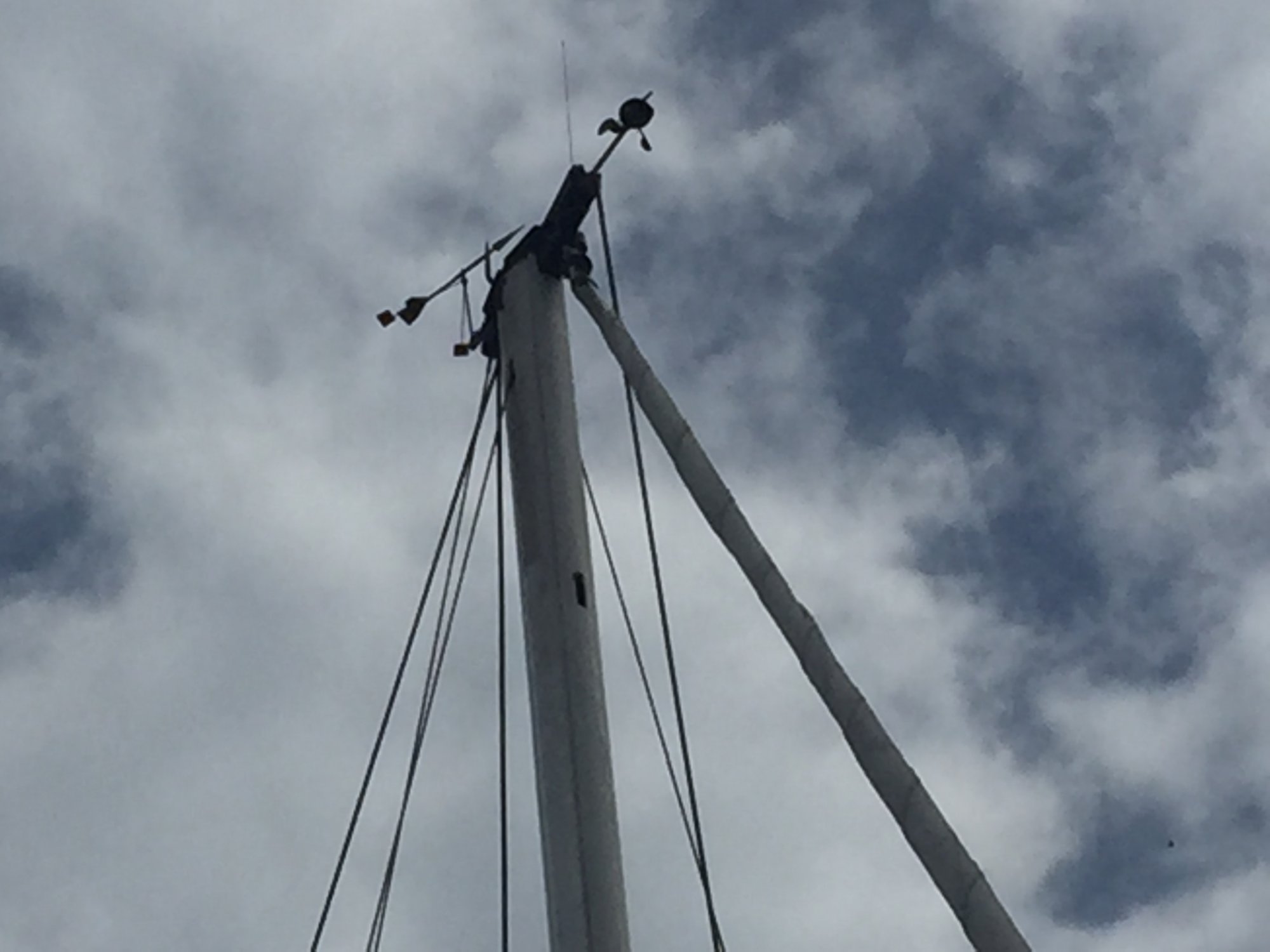

Thanks rgranger. Sounds like i'm climbing the mast. I hope thats all it is. Ill be replacing some of the before spring.

I am sure you all have given me the right answer. Cant thank you enough. I do need to replace the sheaves with all running rigging, wiring and everything else. The mast really needs to come back down so I can do everything i need to do. But that will be some time from now. I really just want to be able to get the sails up in the spring and enjoy her until i have the time and money to do all that needs done.

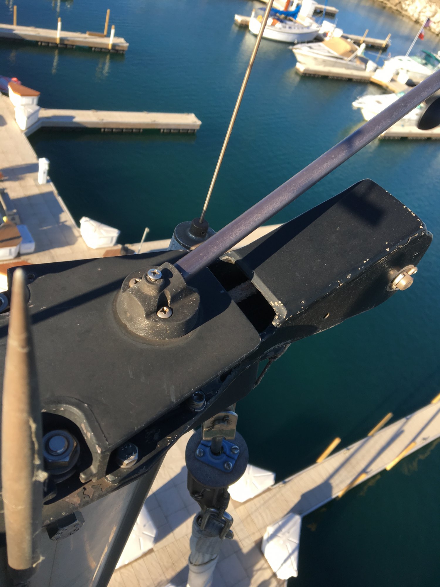

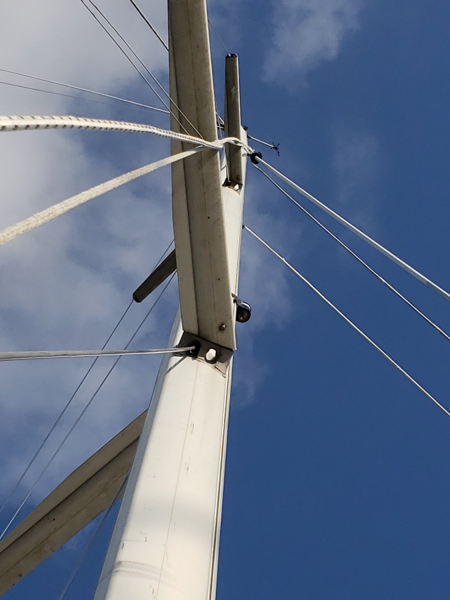

If you can get your hands on a still or video camera with zoom lens, you may be able to get a better idea as to what is going on....
I took these when trying to get an idea how my spinnaker halyard was rigged up on the mast...

Great idea.... also see if you know a kid with a drone (or adult) I have a drone with a very nice camera that I can control with my phone. Don't know why I didn't think of that earlier. If you don't know someone, you can buy one at Walmart for less than $70.

tally ho... The picture i posted is zoomed all the way in with my phone. Don't like drones but have other cameras. I figured it was an internal problem so didn't try to look closer.
I used a DSLR with a 50-300 zoom lens. Probably can’t get enough zoom with a phone camera.
But if you go up the mast, you can get a good close-up...;-)
