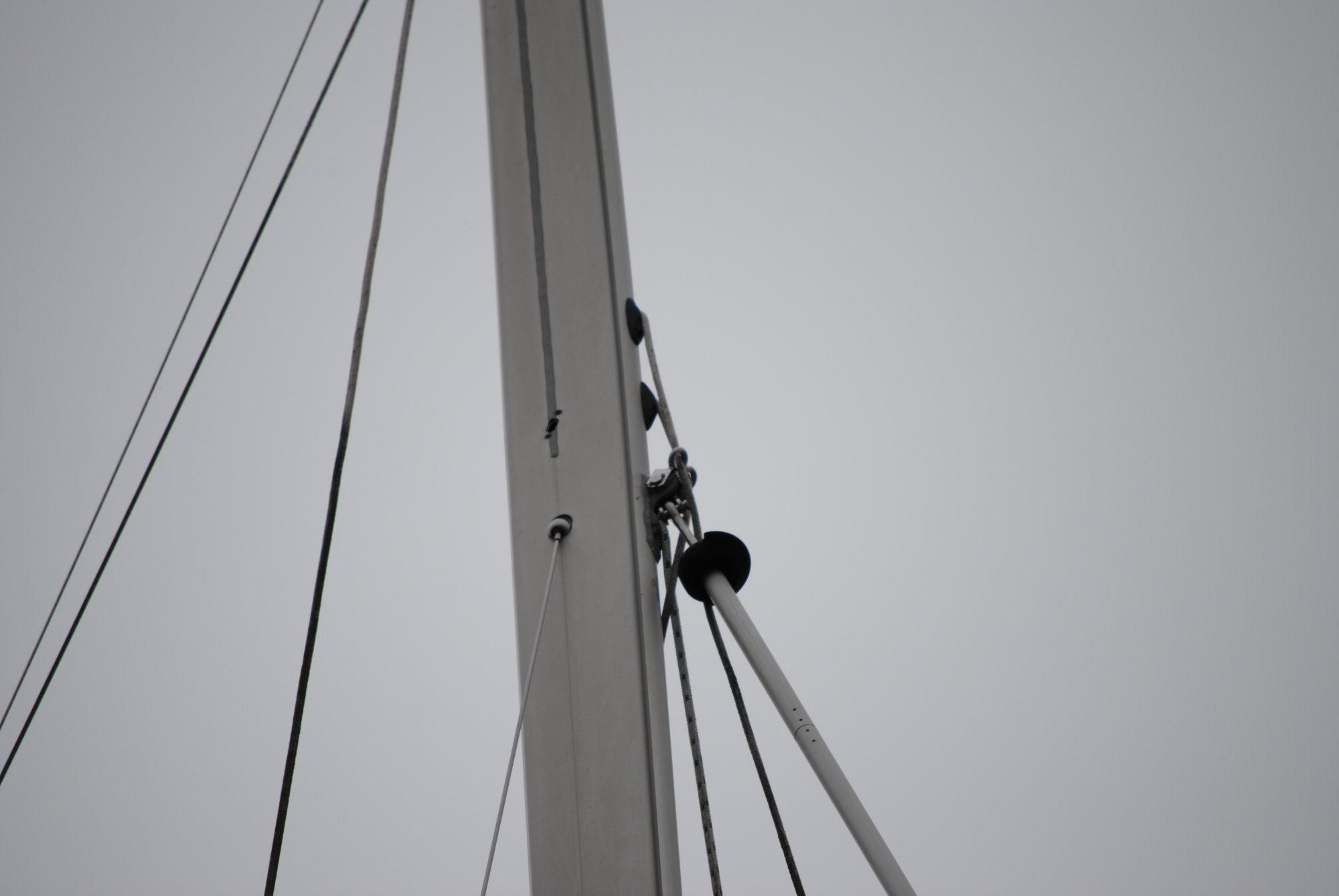

Used a better camera and have a better view. It looks like the Isomat NG-2-30 exit block. Its a single sheave block so unless im looking at the wrong part, the line jumping the inner sheave is not the problem. In fact it looks like it may be pinched by the furller, maybe my mast is not tuned right. One thought i've had is, if i need to change the sheave, I don't see how. Another question I have now is. why two spinnaker halyards? There is another exit block lower with a line leading back to a rope clutch labeled staysail halyard.
Any thoughts?

The Spinnaker halyard looks like it's running over the jib halyard (or it's twisted with it). I believe the spinnaker halyard is supposed to be "free" and run directly out.
Don't let the spinnaker halyard get into that guide above the furler.
I'd drop the jib, untwist or free the spinnaker halyard, then raise the jib.

They are all wrapped around each other. However I dont see that being my problem, otherwise id get some movement when pulling on the mast end of the halyard.
Ive read a lot trying to figure this out and I understand that the reason for leading the spinny down like that is to lessen the wear on the sheave, from the back and forth movement of the halyard.
Unless someone can give me a good reason for 2 spinnaker halyards, ill be eliminating one.

It looks like you have 3 halyards. Two come out above the top of your furler I'll label
  1. "A" upper sheave to Starboard,
  2. "B" middle sheave to Port, and
  3. "C" lowest sheave just beneath the connection of the Furler to the Mast.
It looks like you have a Profurler Doughnut at the tope of your furler. It is there to stop the halyard from wrapping around the sail as the furler is turned.
  • Halyards "A" and "B" look to be used for Spinnaker, or a Sock for your furled sail.
  • I would take the A halyard out beyond the front of the furler and locate it on the bow pulpit on the starboard side. The way it aligns with the furler I would use it to raise a sock as a cover for the sail on the furler.
  • B halyard could be used as a Spinnaker halyard. I would put a block attached to what looks like the "fairlead" fitting. This would aid in managing the spinnaker and the way it moves about when being flown. You could also just use the "fairlead". But ti would add to the possibility of chafe of the halyard as the sail moved about while flying. This halyard looks to be bent back onthe port side of the mast. Any idea where it is hanging? Could it be wrapped somewhere? I would pull it forward and attache it to the Port side of the bow pulpit.
  • C halyard is the one that you say is hung up? That is the one I would inspect. A hung up halyard that is run through the mast can be hung up where you can see it or it can get hung up on something inside the mast. This is where you need to investigate.
Can you take a picture of the attachment rig for the Jib on the furler? It needs to be one that will match with the doughnut so that it works correctly.
Your furler set up is not like the Harken set up posted earlier. It looks identical to the ProFurler set up I had on my boat.

Yes the one halyard is wrapped back around a shroud. My jib has a sewn in sail cover, no need for a sleeve. I want to eliminate one of the halyards, one less thing to worry about. Also my boat is on a lake and I dont race, I doubt i ever raise my spinnaker. Attached is a picture with the jib on, before the mast was taken down. I hope you can zoom in enough to see what you were asking a picture of.

OK. Still a bit fuzzy, but it looks like you raise the jib with a furler head bearing system. The way the unit is hoisted the halyard is held away from the furler extrusion. If the bearing s are working smoothly that looks like a good set up. Your furler then rolls the sail while the halyard and bearing unit stay put.
When you lower the sail does it come down smoothly?
If not it may be the way the furler block is sliding over the furler extrusion.
I could not see the upper section clearly. It does not look like a Profurler Block. Could not see a bar that would engage with the doughnut. The doughnut may just be to keep lines from wrapping on the top of the furler extrusion.
With regard to "line removal" There is nothing wrong with removing lines. When you do you might want to leave a messenger line in the mast in the off chance you change your mind a few years in the future. Running lines down a mast can be a PIA. :yikes: Tying a Stopper Knot in the line and pulling it tight against the upper furler will remove it from conflict on the mast yet will make it available to your rigger to pull a new halyard if needed.

When i took the jib down, it took a little effort but i figured that was because of all the not so good blocks that led the line to the cockpit jamming it up.
