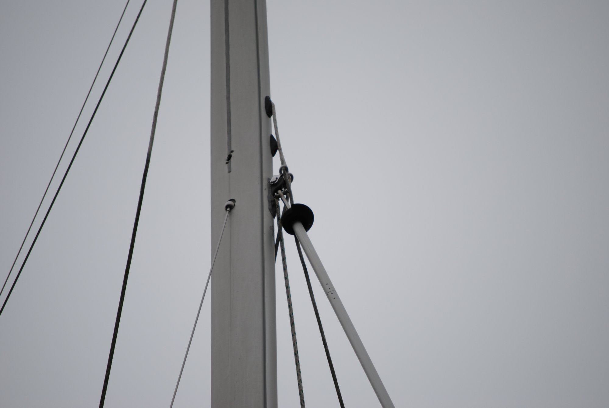

Problem with jib halyard

I have refrained from saying anything but there are some things to point out. I wonder about the two spinnaker lines being for a racing style spinnaker vs an A symmetrical spinnaker which requires only a single halyard. Then they appear to run thru a block on top of the forestay which may cause friction.
Then I wonder if the furler itself is too long being too long interfering with the lines exiting from the mast. Then was the jib or Genoa sail ever replaced with it being too long on front? Then the question of the jib halyard not being properly coming out and routed in the proper sequence attached to the furler itself causing friction.
There appears to be more going on from several stand points and will request @Jackdaw and @DrJudyB to chime in as they have good knowledge.
Then the next question is there a spinnaker with the boat and if so which kind. Personally I would shorten the furling extrusion on top and top of jib/ Genoa to allow proper attachment of jib halyard and better flow of lines. If you have an A Symetrical spinnaker, I would either remove the lower spinnaker halyard or follow @jsailem about knotting the end and pull it out till the knot stops at the.sheave to declutter that area of lines.
For now suggest resolving this problem befor talking boom/rigid bangs, topping lift and so on.

Thank you. I know that my jib should be first priority but I have no lines i would feel safe climbing. So i have to replace others so i can climb and get a good look at the jib halyard. In the picture I posted earlier, it appears the halyard may be wedged under the forestay, and asked if the mast may not be trimmed correctly.

After buying my 88 hunter 37 legend, I had it moved to another lake. when moved I did not have any trouble taking the jib down or pulling the slack back through the mast before taking down the mast. After putting the mast back up, waiting till the next season to put Jib back on the roller. I found i could pull the halyard out but it would jam when i tried to pull back to raise the jib.
I believe i have the isomat 60 mast with NG2 Fractional Jib Box: Best i can tell from rigright site and pictures taken from deck. I reattached picture.
Some think the line is off the sheave, from the picture, It looks like the forestay could be wedging it. Maybe the mast is not tuned correctly? problem is i have to replace some other halyards before I can climb the mast to get a closer look. Then I also started thinking about installing exit blocks higher on the mast to keep the halyards at the mast instead of running to the cockpit. I was looking at the Antal 40mm mast block double sheave.

Your setup look pretty normal. The two spin halyards both exit the mast above the forestay box, and come down to a set of halyard restrainers built into the box. A good all normal. The two spin halyards are more common on race boats, but still a nice add for a cruising boat. Options.
So on to your issue. When the mast was drop/raised, were the halyards unrun then rerun? Allowing then to twist can easily causes a one-way jam. A twist under the box inside the nasty could cause that. You might try and really slack the spin halyards, and see what happens.
An open cotter pin on the forestay, that lets the halyard out, but hooks it on the way in could also cause this. It’s all so close there, and hard to see from a distance.
I really suggest a trip up the mast. We go up every few weeks just to check everything out. This is just good boat hygiene. You get to see everything up close. Have someone go up and it will all become clear. This can be solved in a hour.
