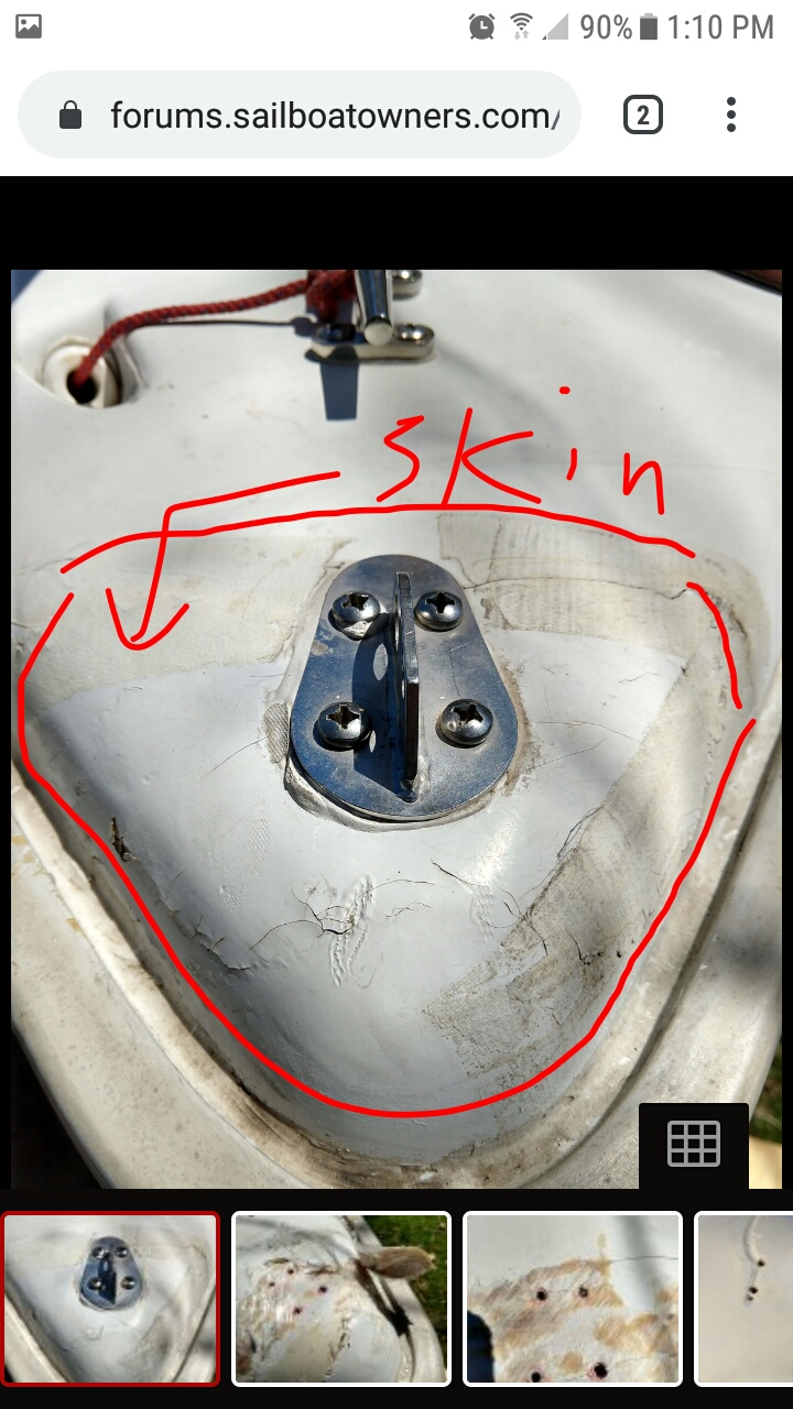

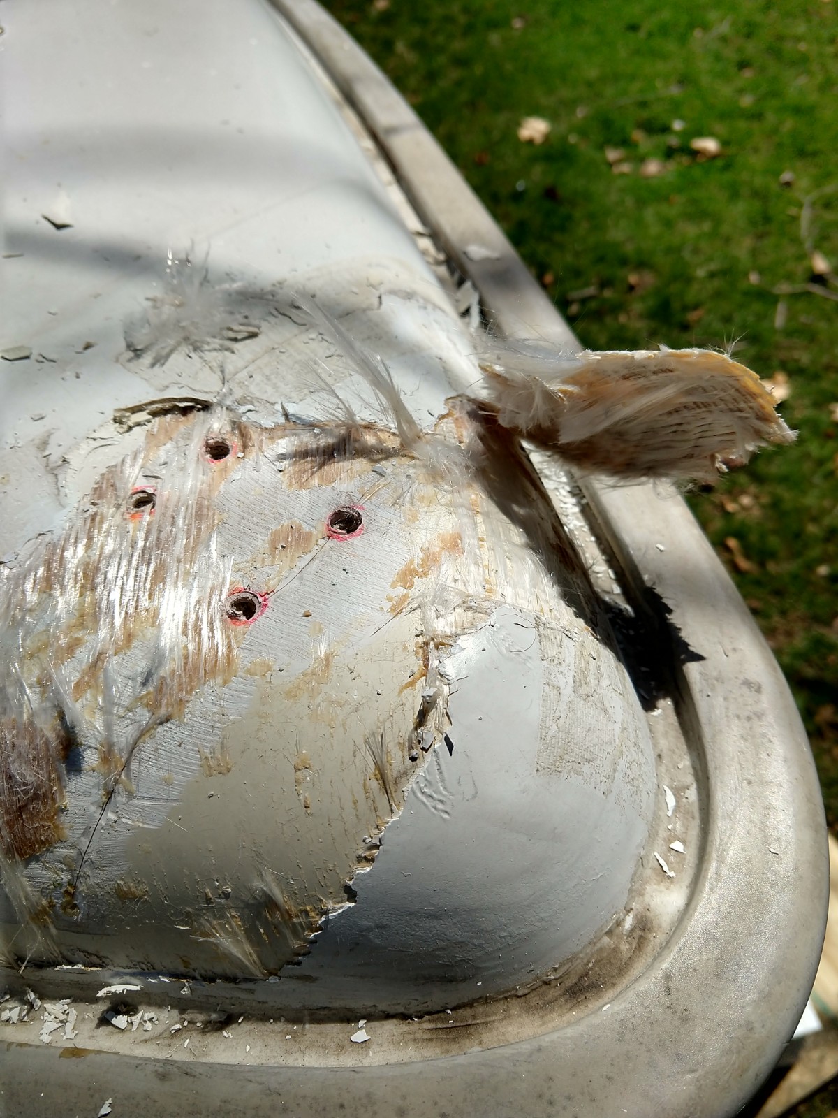

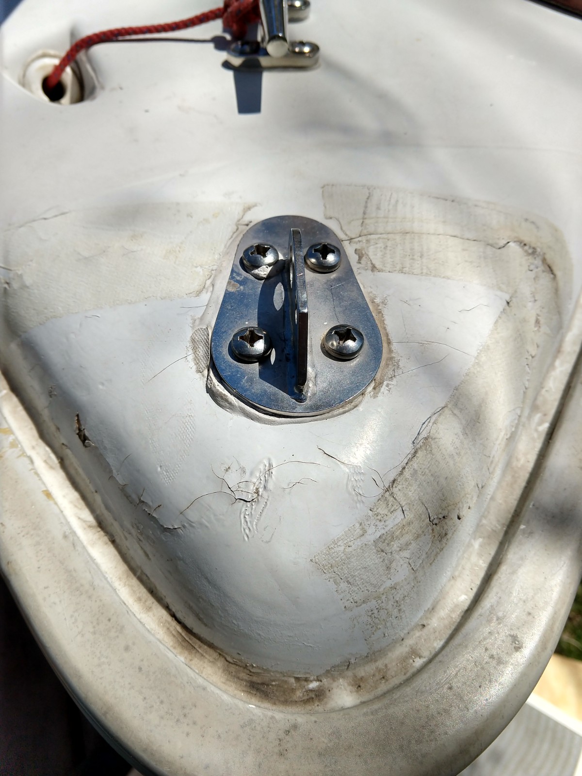

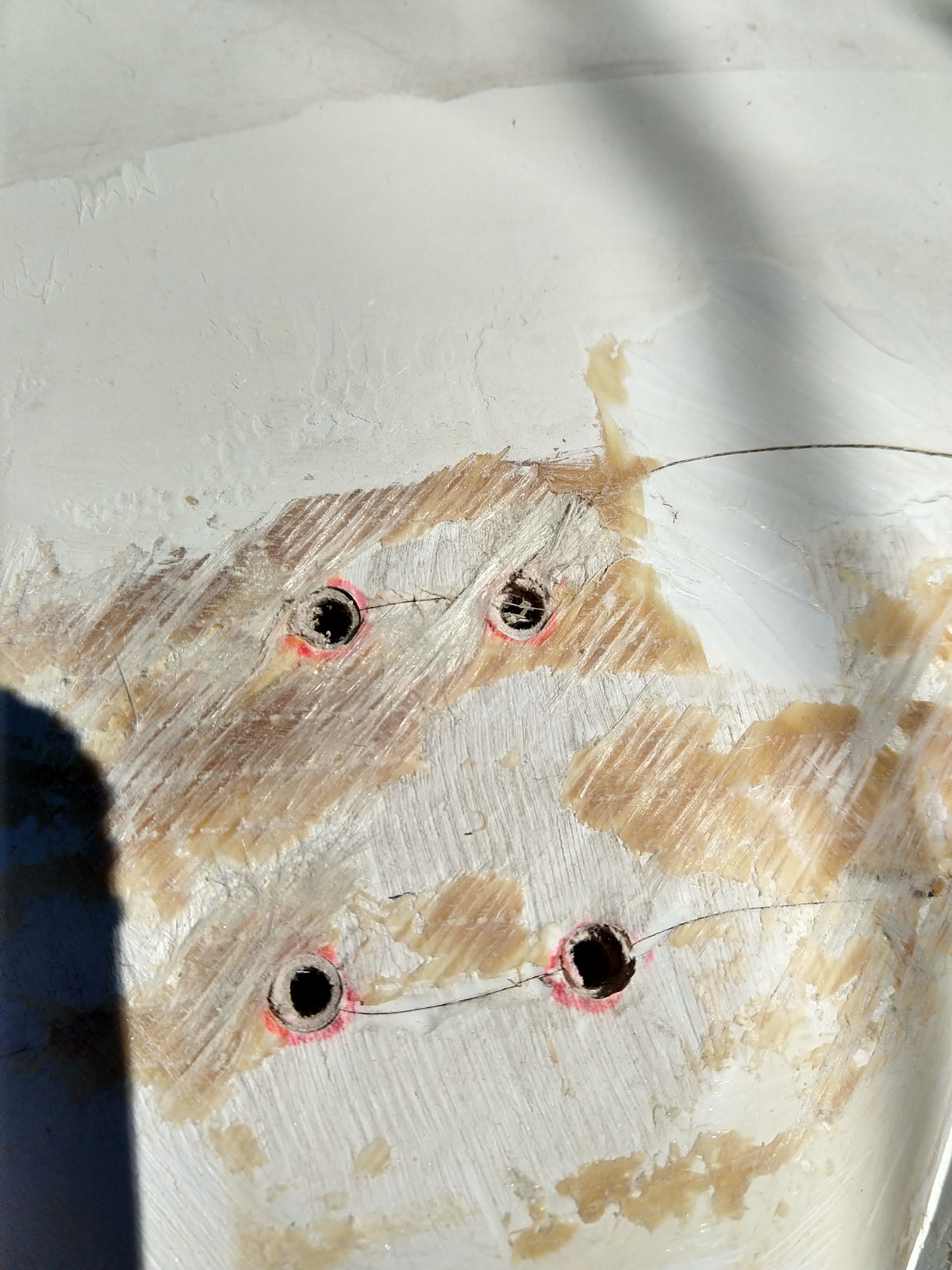

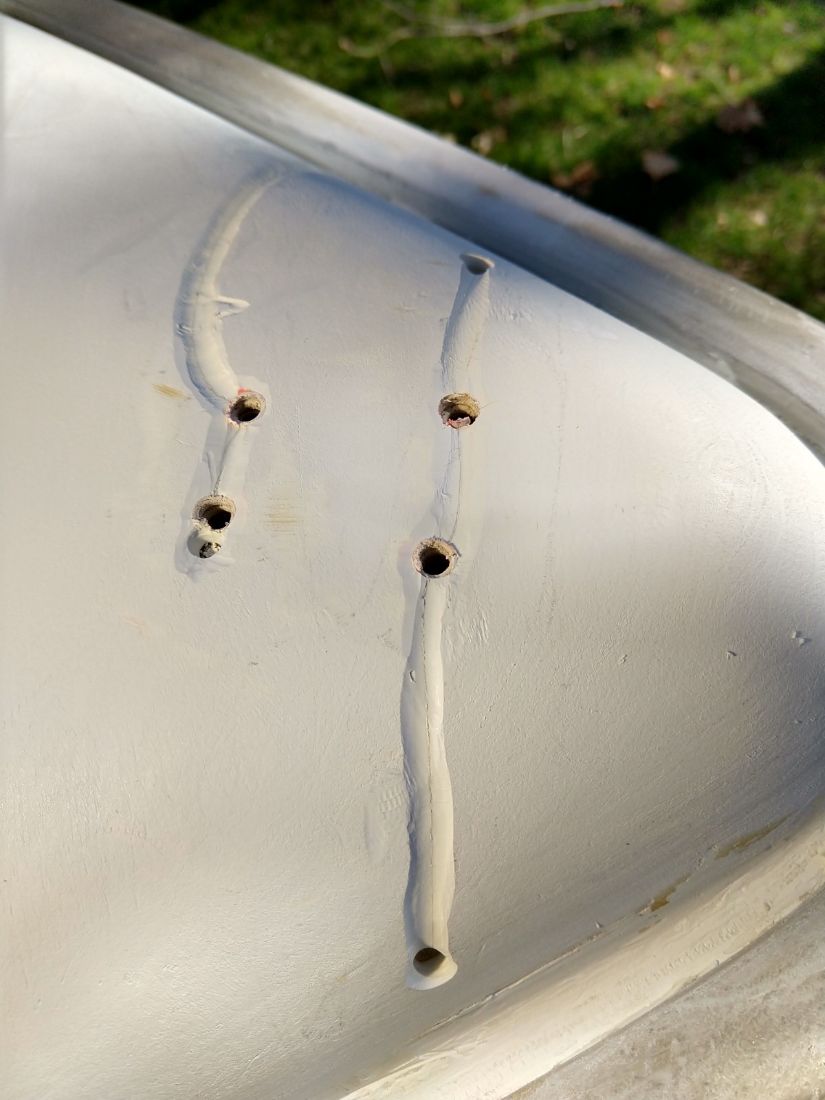

Here's a few pics from my first day at this crack repair. The previous fiberglass repair made it interesting. I tried a heat gun first, but too much made it easy to dig into the ACP, and too little didn't do anything. So I peeled it off, sanded it down to the ACP. I'm assuming that the "V", or river bed one creates for the Plexus should not go so deep that it gets to the foam, but for the drilling at the end of the cracks, I went to the foam. The hardware was bedded on some sealant, so the screws into the support below were solid. Happy about that!! Anyway, that's how far I got today! So far, so good!

Grind deeper as you want it very thin at the bottom. After you fill the cut u you if use a spreader to level and force through the bottom. While it may not happen fully along the crack, some will get through and bind the back side. Plus the deeper cut gets wider and makes more surface area. You do not need to get the glue to the end as the spreader will move some down. If you have perfectly level glue it shrinks and will curve down some.

Makes sense, now that I think about it. Why weld only the top portion of the crack. Widening the crack nearly to the bottom of it would insure more complete contact (like you say, "surface area") with the glue. Also, I know that this Methacrylate heats up considerably when it "goes off" to create the weld. I'm guessing that more material is better than just a hair line of it, for facilitating the chemical reaction. I know that too much is not good also, as one can melt the surrounding Luran. A final finish coat will probably need to be applied after the initial weld shrinks down. Thanks for the advice. Waiting for the weather to warm up, and dry up now. Do you know if I need a minimum outside temperature to apply the Methacrylate? I should get my shipment today. Maybe it will tell about minimum temperature on the package. Thanks again!

That bow section is pretty bad. The cracks between the mounting hardware suggests the previous owner filled the rotten holes with something. Luran has no redeeming quality here, It probably delaminated off the foam. Purly cosmetic if delaminated.
Id cut all that luran off except for about 1-2 inches above the deck joint. Go back enough to get most cracks. Put some fresh wood (sealed) back in the foam, cut into the front cuddy and put a G10 backing plate in the hull space. Get a access port to seal it up. You might be able to pull the luran off and then reattch with 5200. MA will be hard to spread everywhere and set the luran back on. Still need MA to fix those cracks if reusing.
Lay up some cloth and resin to reattach to the foam. Grind off the overlap between new and luran.
In 6 months you may have a new crack between the luran and your new GRF layer. Use MA to fill it back.

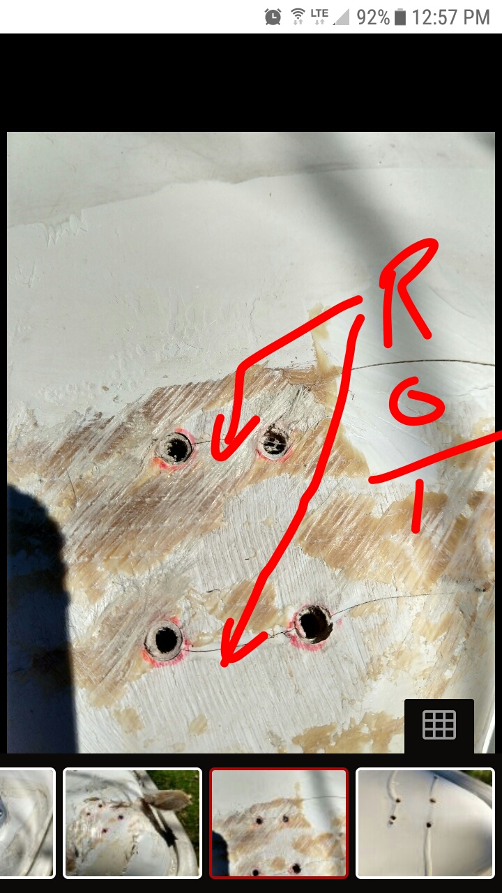

Hey BobbyFunn, You are so right about the need to remove all Rot! When I took off the bow hardware, I tested the screws to see if they felt firm as I tightened them. I will do it again before I go further, as I respect your suggestion that there may not be much of anything left underneath the Luran. If it's rotten, then I will likely trash the whole project for a while until I have the time, and motivation to do all the things you say to do. Obviously, you've been there, done that by your thoroughness. I'll test the screws again, and if they feel firm, I'm going to take your original advice from April 5.

You have some tough choices. The foam underneath probably looks fantastic. Both resin and epoxy will stick to that foam for another 20 years. Before placing hardware back set a couple screws in about halfway, then wiggle them loose. If the luran moves, you are in trouble. If not, then you have several years left. I initally fixed my rudder by injecting epoxy. It was super tight to the end. The luran was flexing with the "repair" causing it to flex and crack. Focus on shielding the luran from becoming structural.

I see, if I put the screws in half way, wiggle them, it will tell me if it's all still bonded together. Thanks, I think I have it, and will test it out before I start filling cracks with Methacrylate. One question: I assume that what you mean by "fixing your rudder by injecting epoxy" is that you filled the screw holes with epoxy first, and then screwed your rudder hardware in. Is that correct? Or do you mean that the Luran was flexing above the foam because it was not bonded to the foam, and injecting epoxy between them firmed it up nicely? I'm a little confused, as usual. Also, what do I do with the hardware screw holes? If I determine that it's all pretty solid, and go ahead with the crack repair, should I set the screws in first so the holes don't get filled up with Methacrylate, or let them fill up, and drill them out just a bit before I set the hardware? Or should I fill them up with epoxy first??? or what? I'm thinking what should I use for a "Loctite" sort of adhesive to make sure when I set the hardware that the screws are setting down into an adhesive that will lock them in nicely. I wish I wasn't such a novice at this stuff. I really am enjoying the learning process. I wake up in the morning thinking about it.. Am I now a Boat Nerd??

You dont want to inject anything in the original screw hole. If the screws wiggle you need to rebed the mount. You cant rebed without knowing if the substrate is solid all the way through. The last thing you want to do is allow the luran to bond to the substate you screw into underneath.
You do this wrong and youll have a snot of glue injection spread out into rotton screw threads. The snot will form a tight bond to the luran and loosen from the substrate. Itll work for a couple years.
I redrilled the holes, reamed out some rotten wood, then filled with MarineTex. Then drilled new holes. It lasted three years before the luran started to crack spreading out of the holes. I had a glue snot pretending to be a "nut" on the luran.
