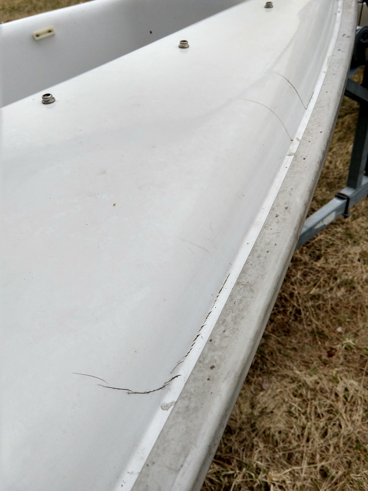

Hi! I’m new to this forum! I am pleased to find all the helpful information about crack repairs on Hunter sailboats, because I just bought a 2004 146. And guess what, it has lots of cracks. Fortunately, I paid minimum for this boat. My boat repair skill is “beginner”, although I ran a small auto-body shop for a while in the early 80s. I’m trying to lay out a plan of attack, and will welcome helpful hints to my plan.
From what I can tell from the forum comments, and the Hunter General ACP repair manual PDF, the basic way to repair these cracks is:
  1. Drill holes at each end of the crack. Dremel a V along the crack to create a trough for Plexus (whether it’s from Home Depot Locktite, Walmart Devcon, or Plexus, it’s Methyl Acrylate)
    1. Question: Do I use straight Plexus, or combine it with milled fibers of fiberglass to give it more substance/strength. My guess is that really small cracks get just plexus, and as they increase in size, add milled fibers, and even fiberglass cloth.
    2. The bigger the crack, the more you dredge out, sometimes even down to the foam layer. And then bevel it up to the top to assist with feathering.
    3. Sand it down, and paint it with Krylon fusion. ( has anyone used that rubberized paint Flex-seal? Rustoleum has a cheaper equivalent. Just curious )
  2. Part of the deck is a little “bouncy”, so I think part of it has delaminated from the foam. I’m not sure what to do there, so suggestions are welcome. Do I cut out the bouncy part, and build it up with Plexus/Fiberglass clothe, or pump Plexus under it??
This boat does not need to be perfectly pretty. I just want to make it sound, and keep water out of the foam. I bought it to sail with my 1st mate. She lives on a small 80 acre lake in N. Illinois. It’s not going to have to endure much, so I’m hoping my repairs will hold up. I have a CLC wooden dory that I sail elsewhere, and a Raider Sport that I hope to fix up also. It has some major repairs needed, and a story for another day. Thanks, If a couple of you could just let me know if I’m on the right track,, and also, where is the best place to get a good value on this Plexus stuff. It looks to me like I’ll need quite a bit of it. Being new to "SailboatOwners", I think I'm posting this in the correct place. If not, let me know. Ric

You are up north. If the sails are shot, buy new ones and go sailing with them until the hardware rips out. Sell the sails online afterwards.
There is aready water in between the luran skin and the foam. You cant get it out so any repairs will reaapear with the freeze.
If the deck is bouncy its because the foam core underneath is no longer attached to the luran. The core probably broke somewhere and cant be repaired without access underneath.
This looks really bad. @Shorefun has the best plan for the buck. If the luran is detached from the foam at those cracks then inject adhesive about an inch on both sides, underneath. Also cut a 1/4inch notch down into the foam at the crack so that the glue grabs the foam to depth versus just a thin surface layer.
If i had to save the 146 to pass down to generations i would take all the top skin off and cover it resin and new glass.

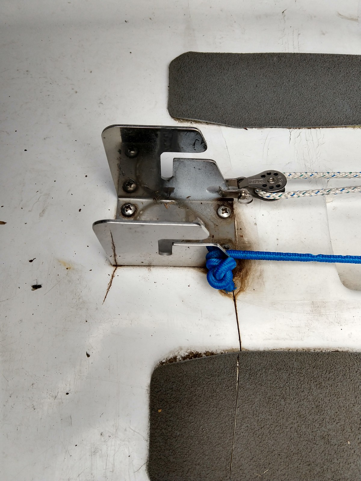

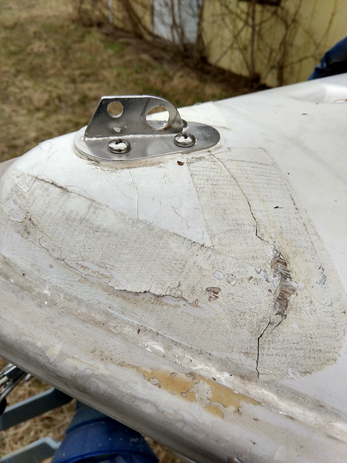

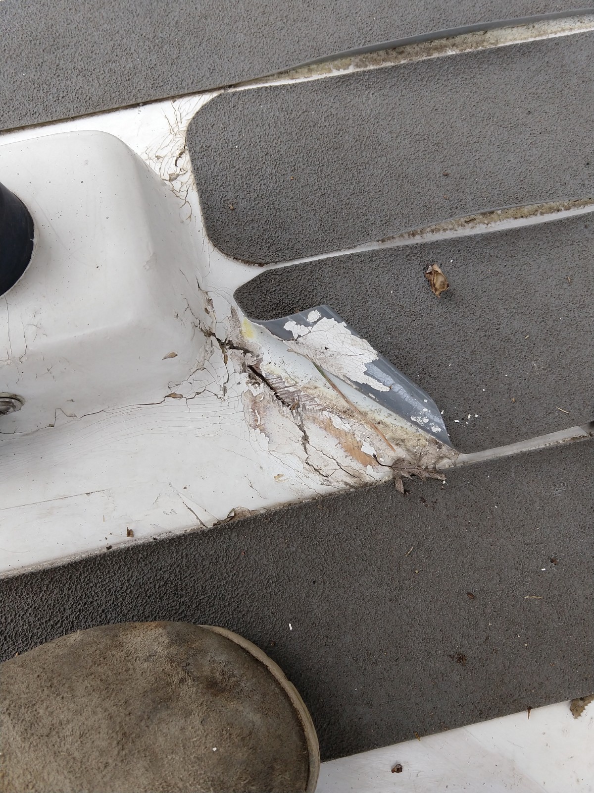

So what are your goals? I am a beginner with not real boat experience that bought, in retrospect, a pretty good condition 170 real cheap. I have done antique car restoration work and know some more advanced autobody, I can paint but I suck at it.
Honestly, So long as the bottom is not cracked and the various brackets still have good wood that holds the screws you can likely sail it. Now the bracket on the bow needs to be held in tight. There is a lot of cracking around that area that would concern me. That is not an area where the 170 has issues it seems.
My first order of business would be to peel up the anti skid and that glass around the bow. This will let you see what you really have. Post pictures.
Base on my experiences try backing out all the screws on the bracket on the bow, where the mast mounts, where the rudder attaches and the motor mount if it has one. Back the screws out then try to tighten them down. The should come to a solid stop. If they do not then you know you do not have wood there. Hopefully you have look around enough to see the level of work needed. Next take them all out and probe with a pick an see if the wood is solid or wet and nasty. You need these screws to hold for the boat to work. The typical problems are with the rudder and motor mount.
From the automotive perspective you are used to putting a correct scratch on a material and then be able to get adhesive to stick. This plastic does not work that way. It is just hard to get a good bond if you are not 'melting' the plastic so the glue can actually stick to the plastic. Just like doing bumper covers. The MA300 melts the surface and lets the adhesive lock into the plastic. Anything else in my opinion is likely to fail over time with exception the 5200 (*failure depends on the structure and how you set it up).
Rebonding the plastic to the foam to get the floors solid is another story. You have to look at how bad yours is and make a guess as to what will work best for you. One guy cut up the floors and did some glass and other work, that is a lot of work. I used 5200 and worked it out manually. My floors were not so bad and I figure lots of 4" dots holding the plastic floor to the foam would be ok. Worse I have to cut it out later.
The way I figure it is they are crappy construction but fun capable boats for learning. If you get them cheap enough you can likely have a boat that will be fine to learn on. If you get more serious then you might want to move up so you sell this one cheap and move on.
The boats can't sink, you are not crossing oceans. So long as the screws are not falling out and the cracks are glued up it is going to work. It does not have to be pretty, just work.
I think you need to know what you are getting into before you start. You could end up putting more into this boat then if you were to find a decent O'day day sailer that is ready to go.
I would want to look closer at the bow forestay bracket. All that cracking would have me worried about strength and that needs to hold good. Plus water may gotten in and may have hurt the wood that you have to screw into. In that case you will have to cut it out and make up something new. A day sailer might start looking to be a better toy.
This...
The factory would have put white down. The black color could be causing the luran underneath to expand and contract, disengaging from the core below.
Im really concerned that you have cracks where there is some meaningful hardware.
Those cracks let water in, so we're all nervous about the wood under the luran.
Sometimes the cracks near hardware are there because the wood is soft and the hardware is flexing the luran.
