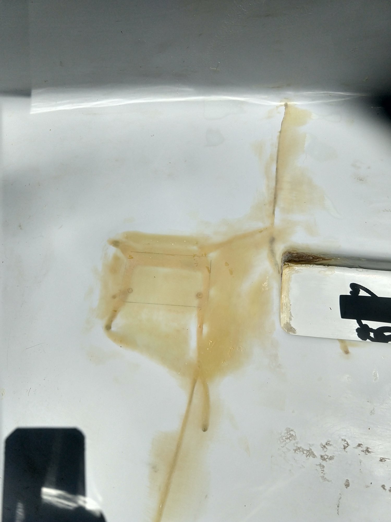

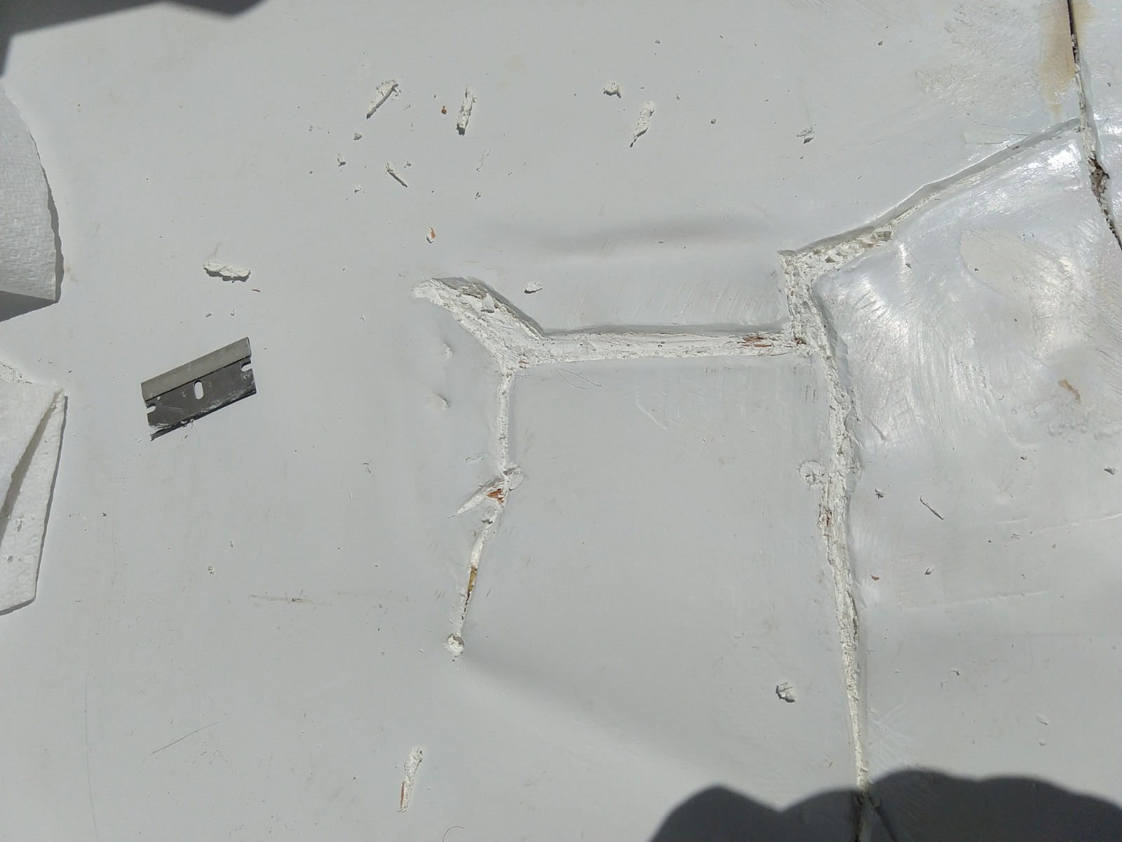

I know it will make most of you cringe to hear that I'm thinking about waiting on paint altogether. This thing is really ugly right now! I'll finish up the sanding of the MA today, and start cleaning the rest of the boat up with SoftScrub. At that Point, I'd almost like to know if all the repairs are solid before spending $ and energy on paint. As I asked earlier, does anyone see any issue with this ? Other than cosmetic, that is. Plastic is Plastic, and really doesn't need paint. I can make it pretty next year.

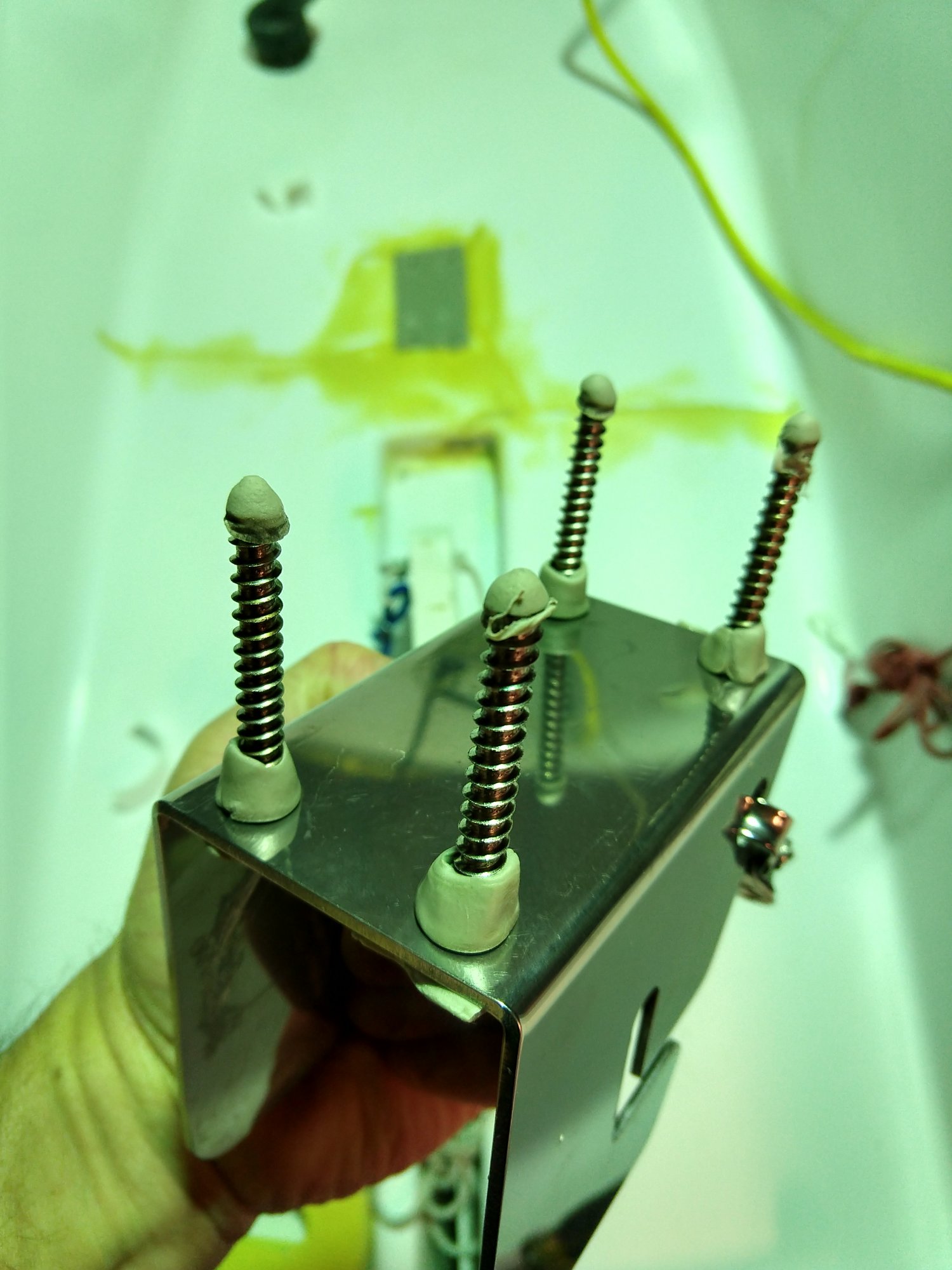

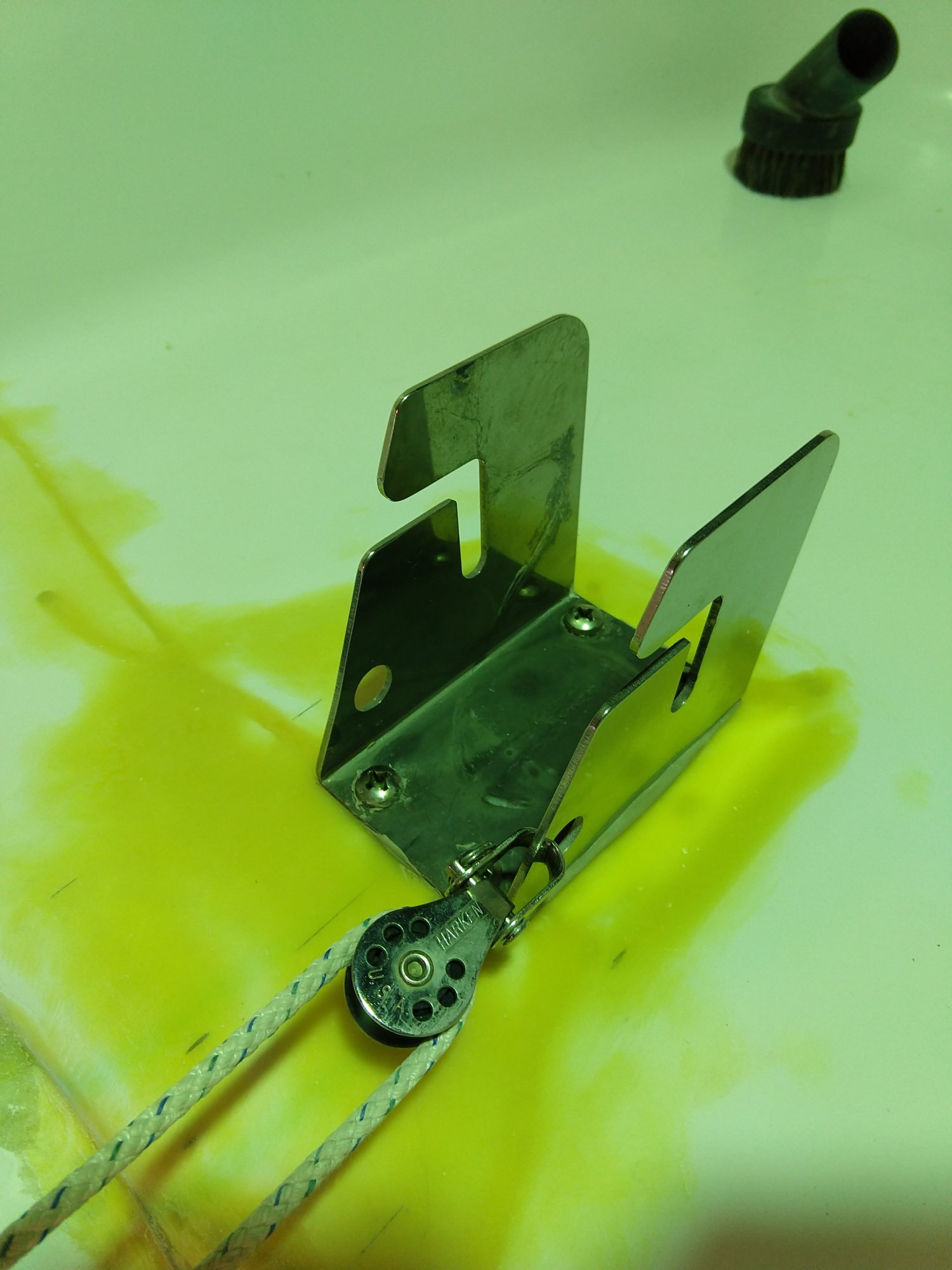

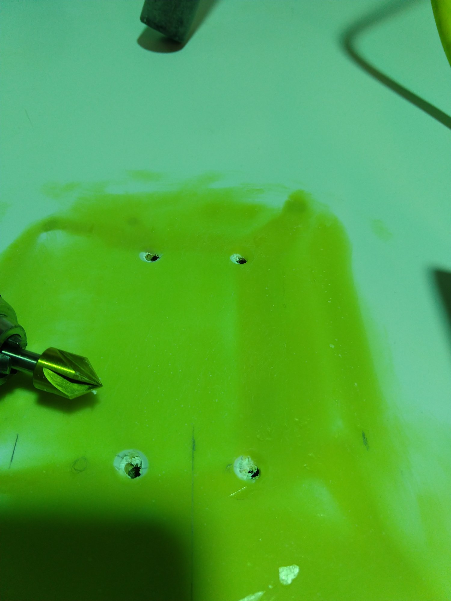

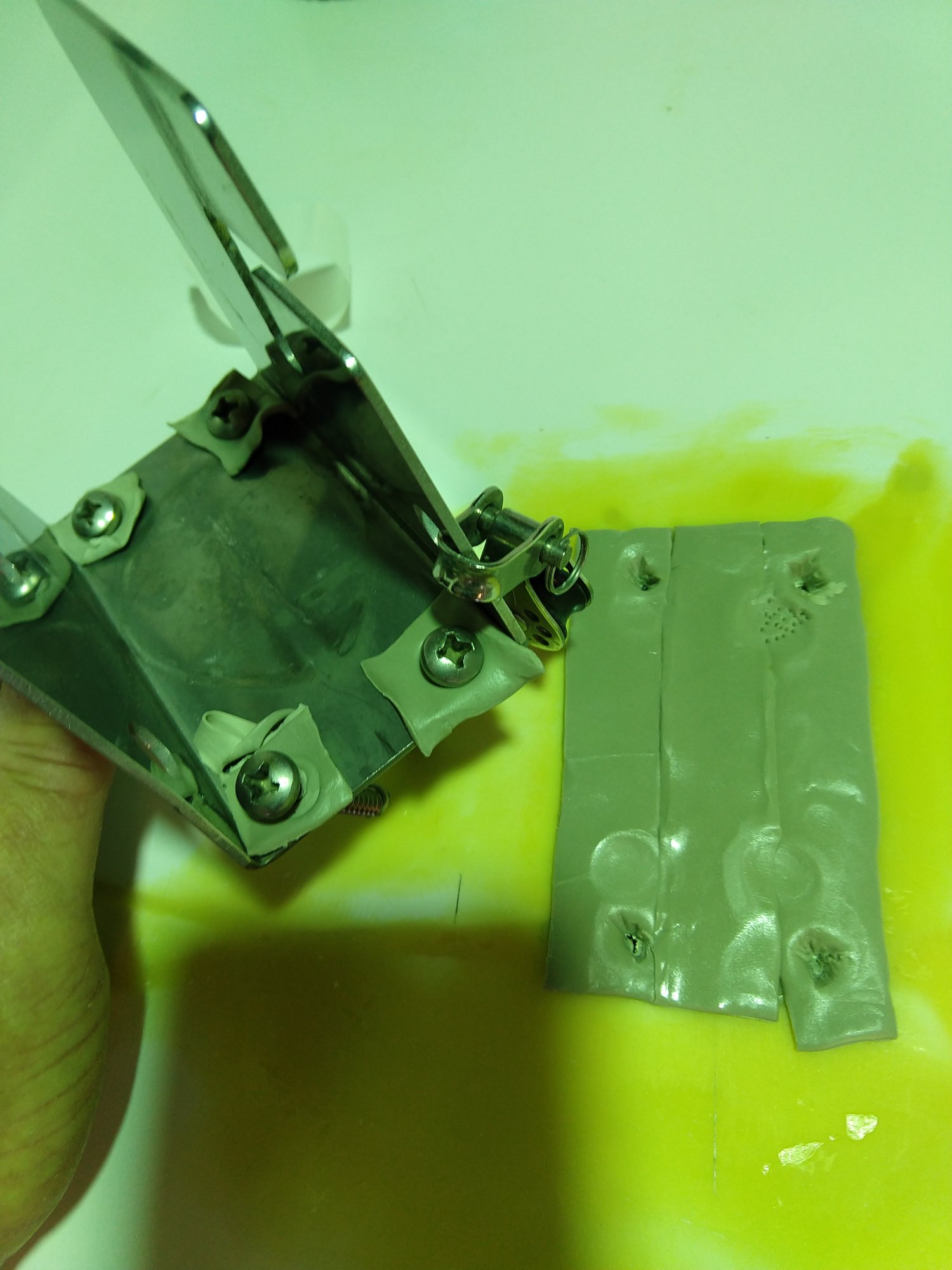

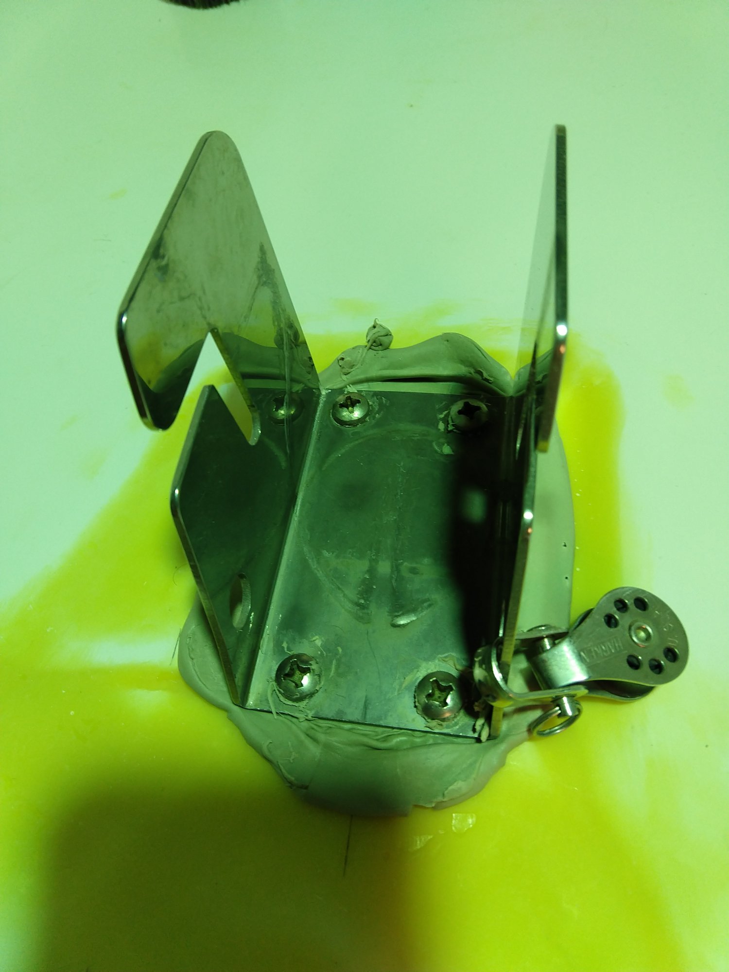

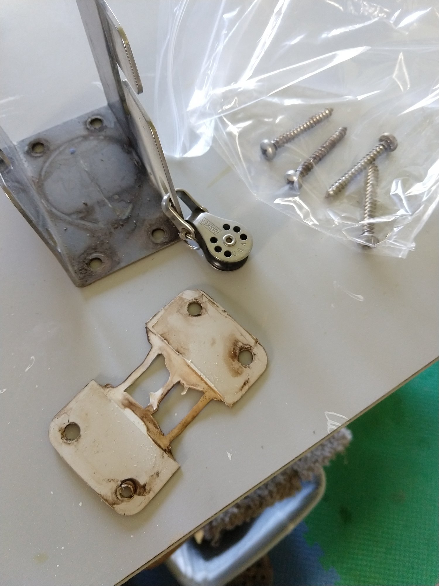

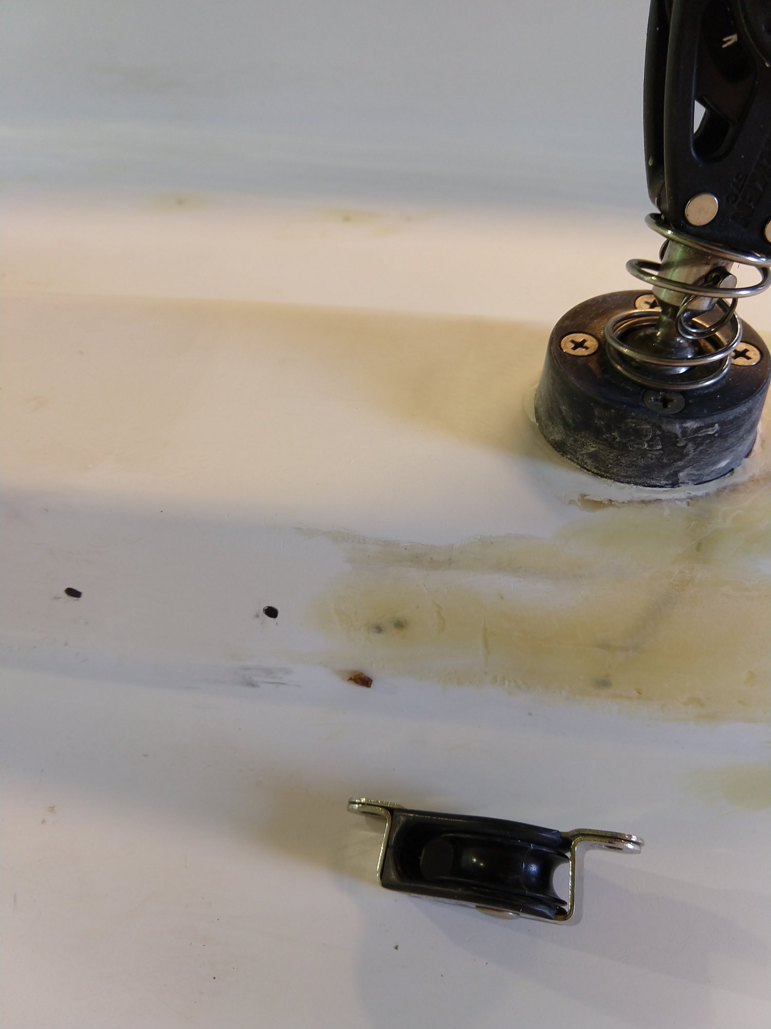

Last question for now: For Hardware re-attachment to the deck, I'm thinking of bedding each piece in Fast Cure 5200, on top of the MA/Luran fist. I'll paint around it later. To me, it makes sense to stick the hardware on top of the boat, not paint. Any suggestions for bedding, other than 5200? I thought about bedding the hardware in MA directly, but 5200 will absorb more vibration/shock. Going out to sand off the last coat now. Hurrah! No more cracks! For now anyway. Ric
