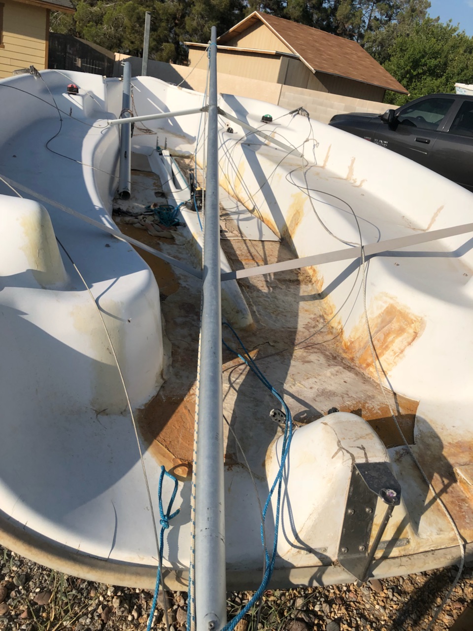

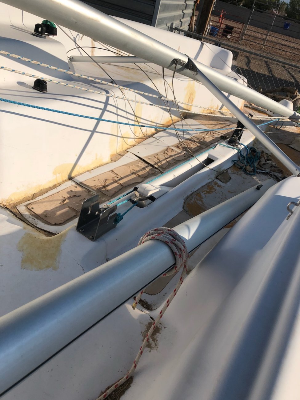

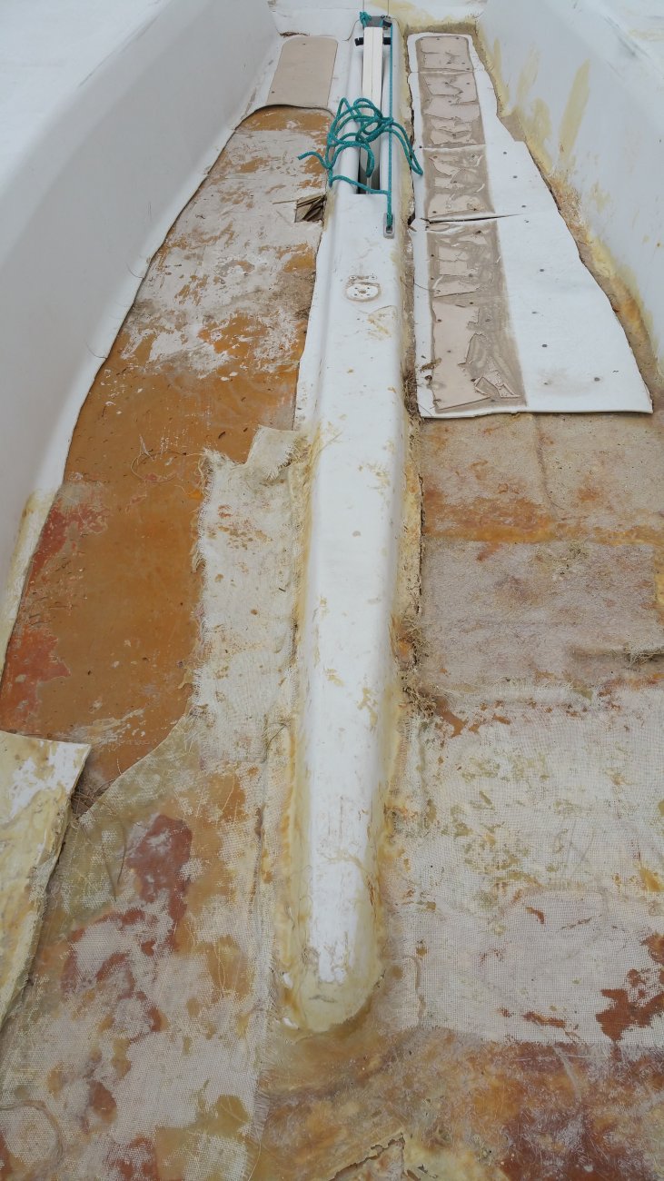

First off, that is about the worst damage to ACP that I have ever seen. I would not want to try the classic crack repair methods with areas that big that are de-laminated. Repairs on that mess are going to be experimental, as I believe that you will be the first one to attempt repairs on an area that big in ACP.
The classic accepted repair methods use one of two epoxies, either Devcon or Plexus. These were recommended for repairing cracks in the Luran S skin. Some people have had luck using them with glass cloth to add strength to repairs of somewhat larger areas, but nothing like what I see pictured here. I believe that you will be in uncharted territory.

If I were to repair a 170 with that amount of cockpit damage, I would probably cut all the Luran out of the floor of the cockpit & maybe up the sides of the seats about 2”. I would replace it with glass cloth, probably a single layer of 1708 hybrid cloth with the matt side facing the foam. I would use the same West epoxy that worked for me in my motor mount repair & I would feather the glass into the surrounding Luran with at least an inch of overlap. If that comes out well, then I would tape off the Luran & gel coat the new fiberglass. If it felt flimsy, I would then add a second layer of 1708 before the gel coat. That would be my game plan. I would budget 2 weekends for the project.
If you are going to try to make that repair, make sure that the foam is Bone Dry before you start. Since you are in Chandler, that shouldn’t be to hard for you to arrange.
If you do decide to throw in the towel & part out the boat, I would probably be interested in most of what you have that fits in boxes & ships easily via UPS, assuming that the price is right. If I were in your shoes & I had the time, I would probably try to fix the boat. The repair materials are probably a few hundred dollars. It’s not a gigantic investment. I am going to assume that your boat is primarily going to see use on Lake Pleasant. Even if your repairs are half as good as new, I would not hesitate to use it there. I would expect properly executed repairs to be at least as strong as new, with maybe 50# added to the original boat weight. It should be a great boat for Lake Pleasant. You will probably want to get a boom tent.
