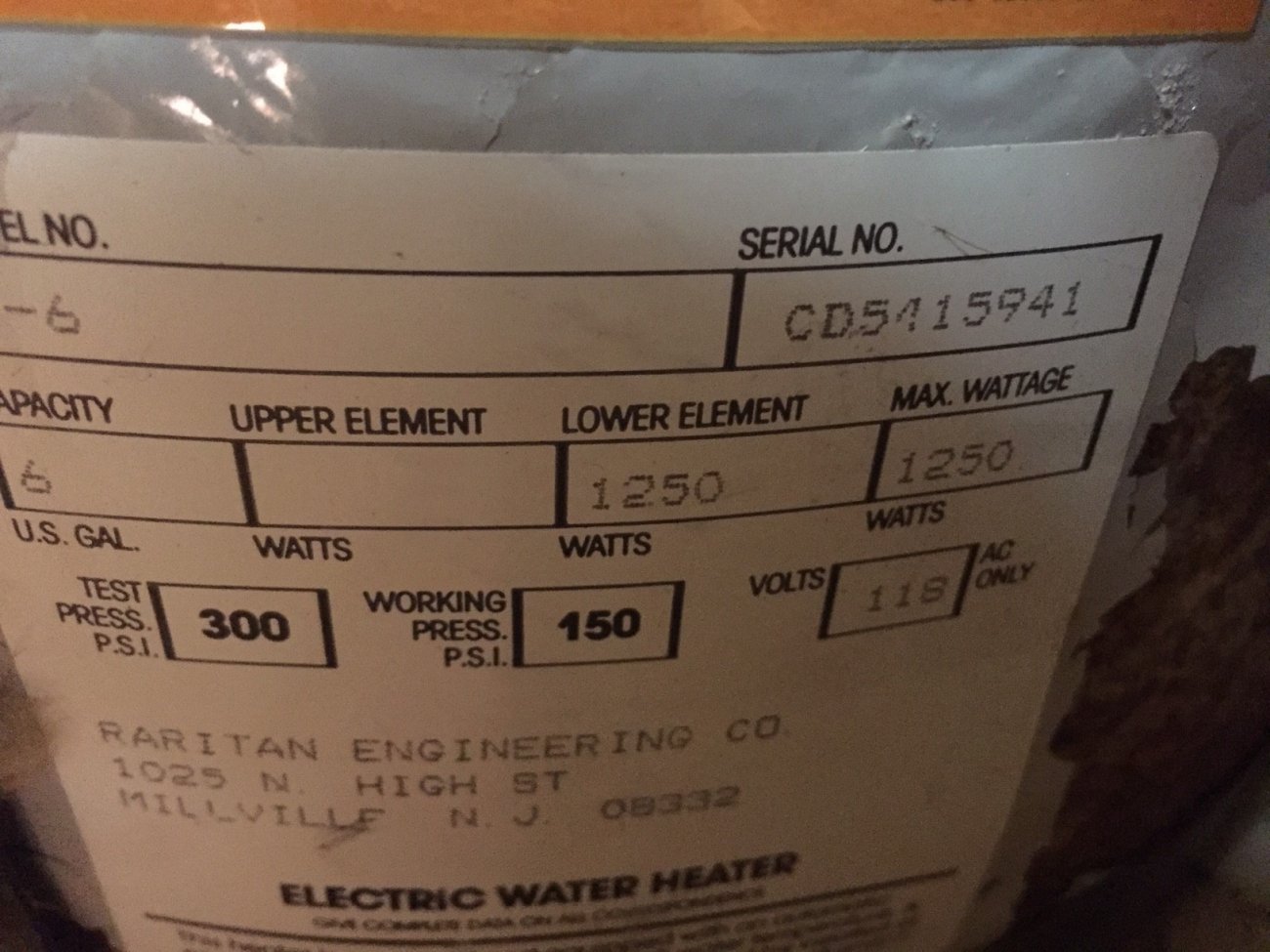

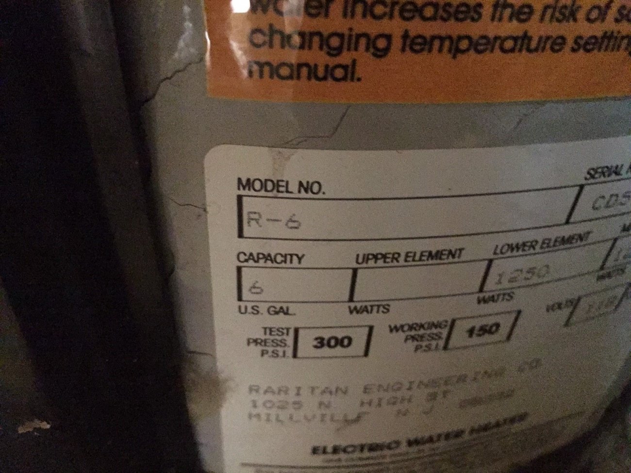

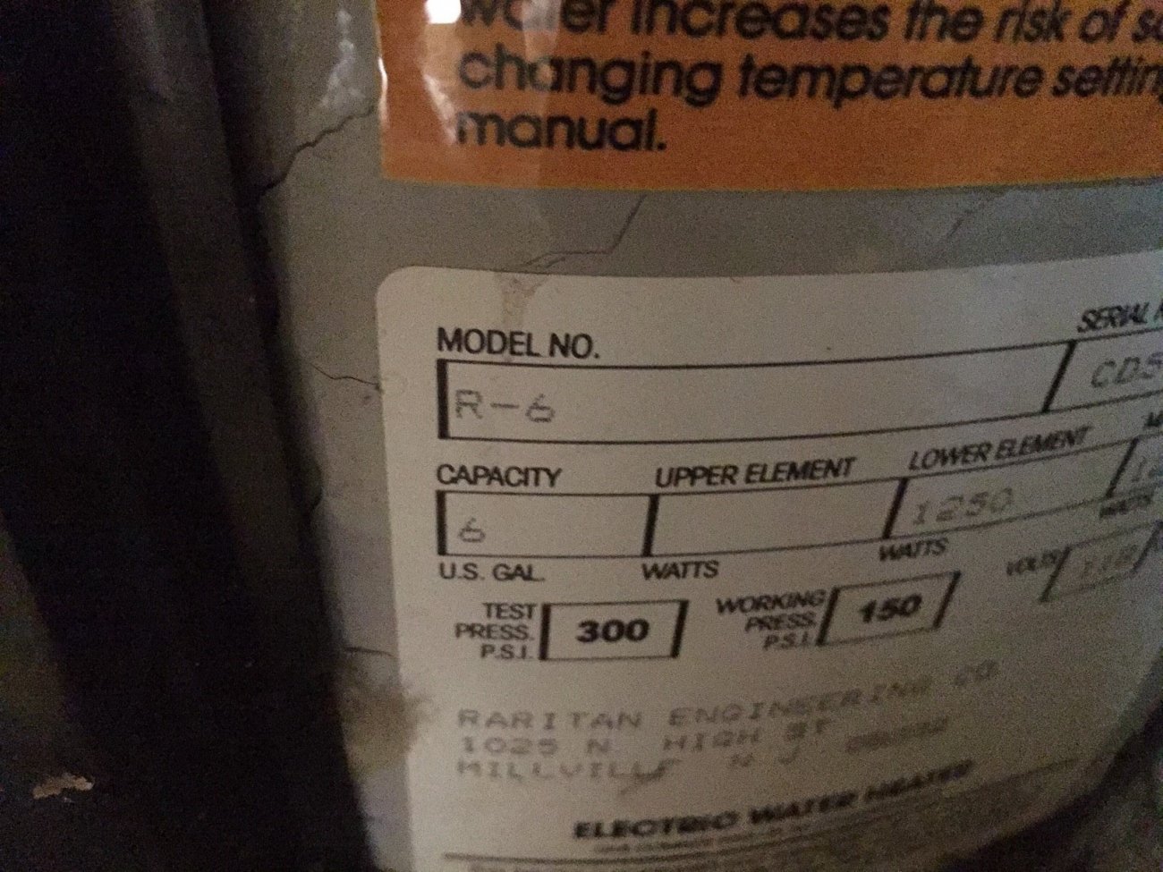

Thanks to all. I managed to get my iphone wormed into the space and a plate says it's a Raritan R6. The current version measures slightly larger than I had it, so if it's gonna come out, it will be in pieces. Since the boat is an '87 and they apparently built the hull around the heater, it's remarkable that it has lasted this long. Being a freshwater boat can't have hurt.

Well, we now know you have a Raritan R-6 6 gallon water heater. That is a good brand.

Well, okay. These don't show the deck and rust stains but you can see some of the compromised paint on the heater cover. Does this take us somewhere?
Not really. I was attempting to get some ideas to cover it.
24,872
Call Raritan. You have the serial number They will be able to help you.
