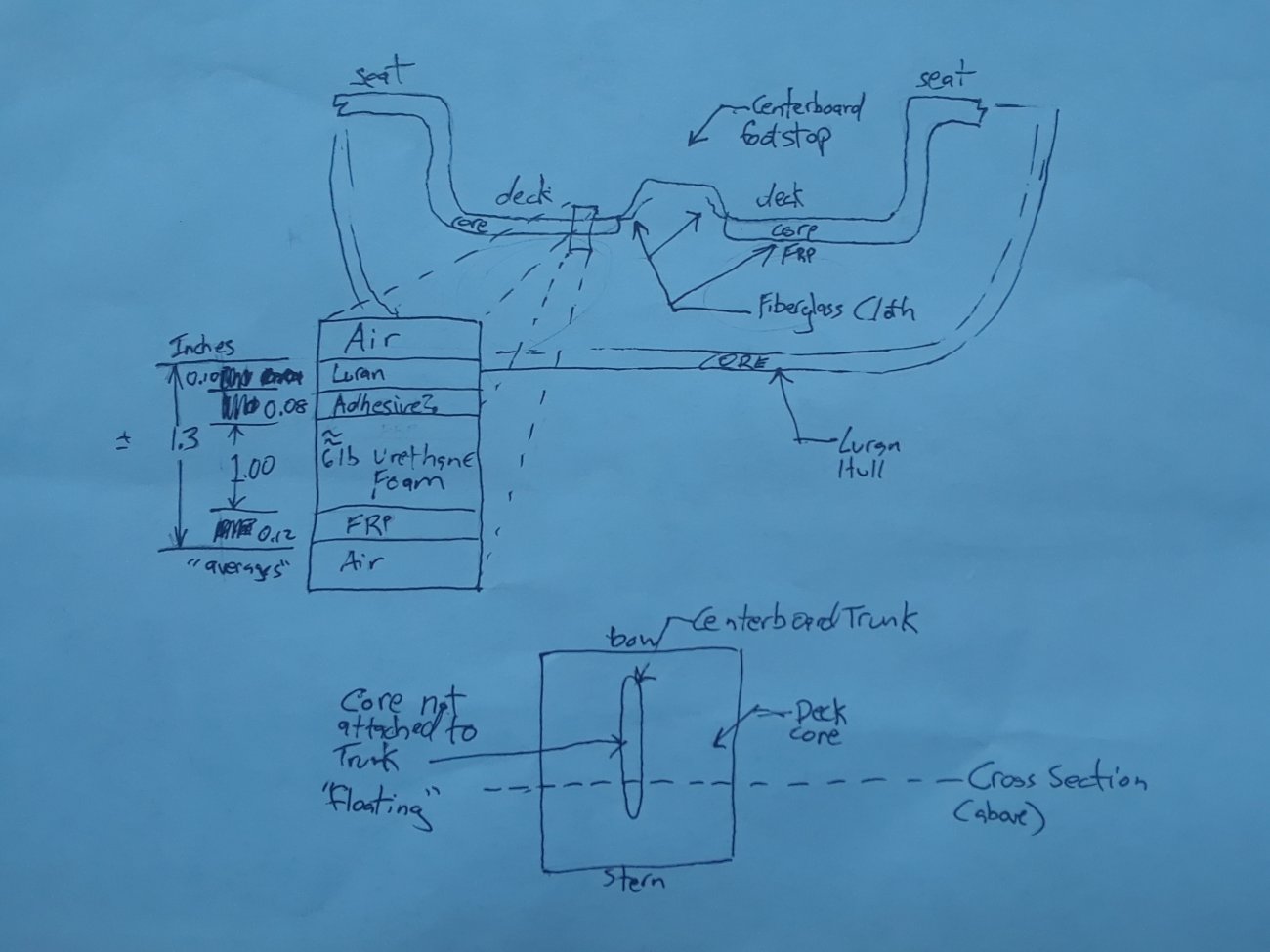

I am curious what the opposite side of the boat looks like in that area. Is it also bare glass? or is there resin on that side?
It's bare glass under centerboard section. The Hunter production crew could have cut it off, but then, there goes the price point...
The core and FRP is "floating" around the centerboard trunk.

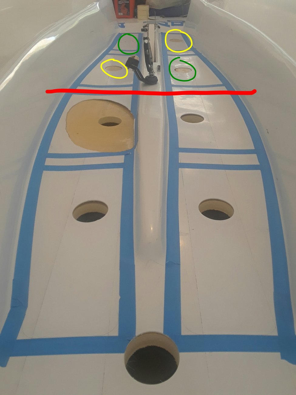

Using @txjim info I have started putting the repair plan in action.

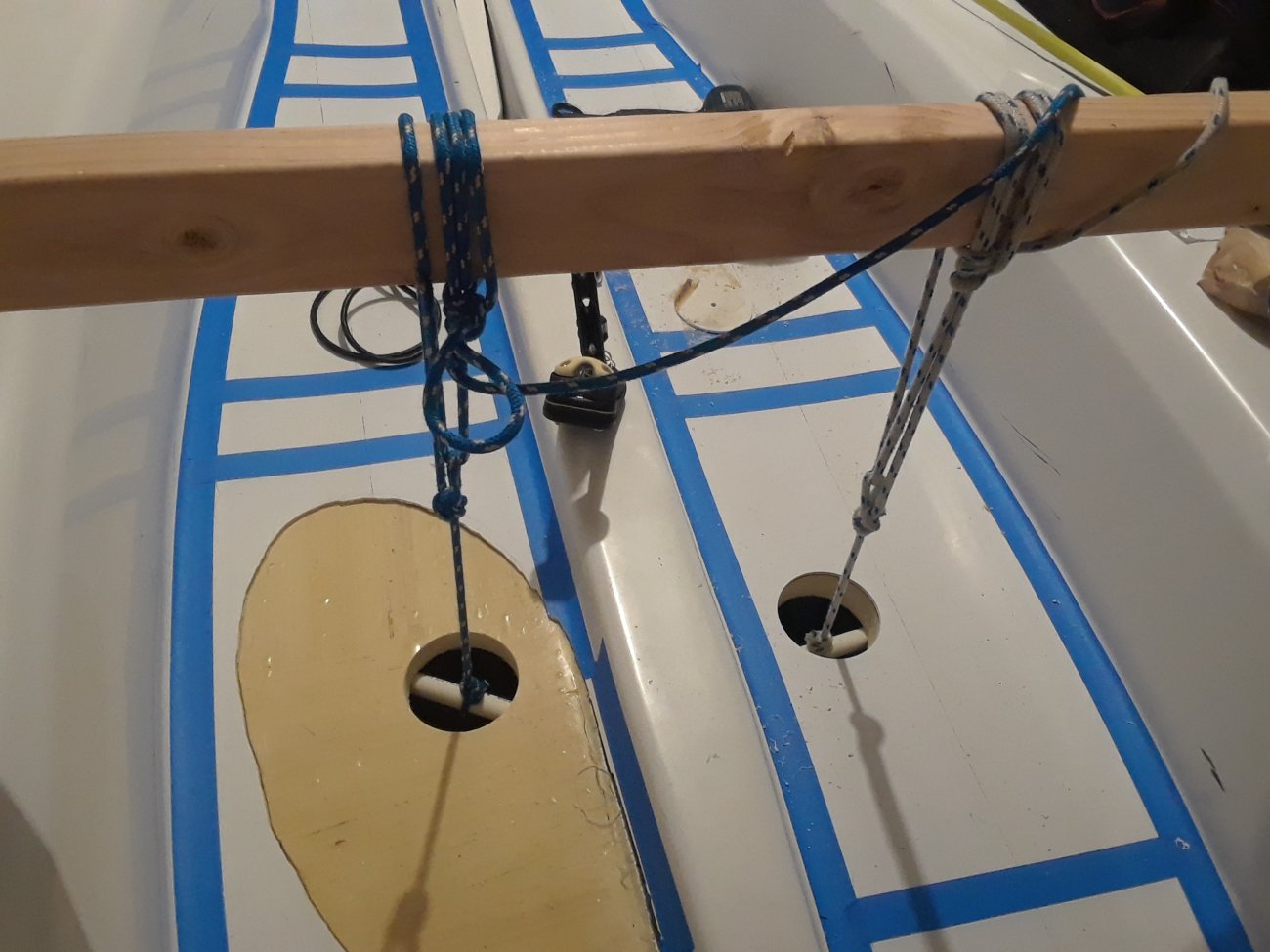

Stage I is to test pull the core up to the Luran and look for gaps, Then drill any new cores for low spots. I'll also drill several small holes for spreading glue in more locations. While the core is dropped I'll fill the gaps with adhesive. I'll try using compressed air to blow in some water and adhesive per crazy dave's suggestion. Then, raise the core.
I picked out a glue...Loctite PL 3X premium. Its a moisture cure Urethane glue much like 5200 and gorilla glue. The best glue for this scenerio is actually any "MMA adhesive", but the cost is brutal and the working time is too short. 3M 5200 is the next choice, but was concerned it might not stick to plastic for the long haul. Epoxy would spread nice and probably stick really well, but the reports are it is brittle and cracks with movement.
The application of adhesive will begin when the two part 4lb urethane foam is delivered.
Stage II will be the pouring of foam structural columns under the deck as soon as full tension on the deck is applied. These will substitute for "stringers".
The tension required to pull the floor up is pretty high so I'll leave the clamping system tight until the colum supports are fully cured.

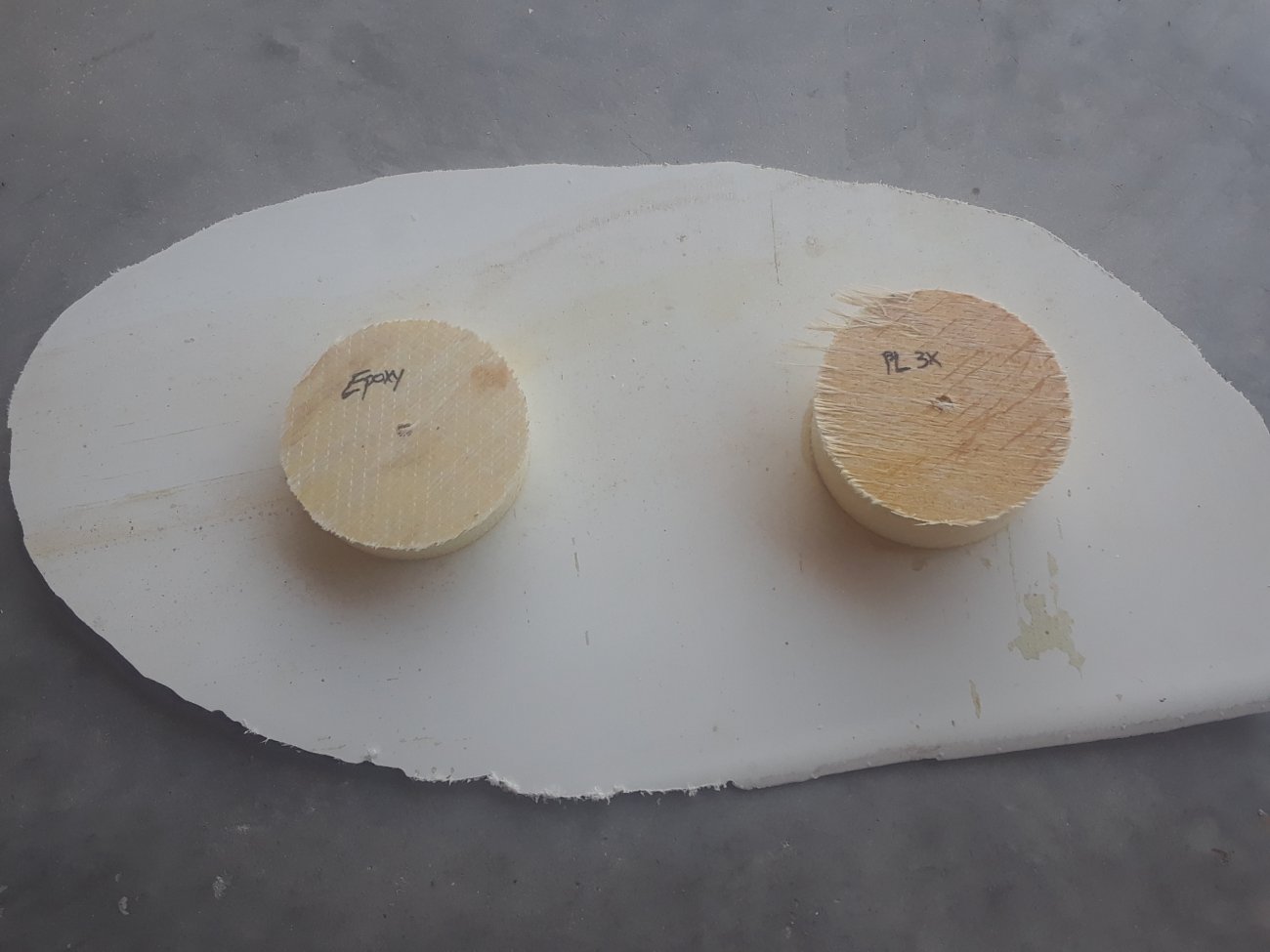

I found a left over west system activity kit (101-6) in the paint job box and there is one packet left. Ill test that "neat" against the pl 3x.
Next weekend Ill have to remove the cores from the luran.

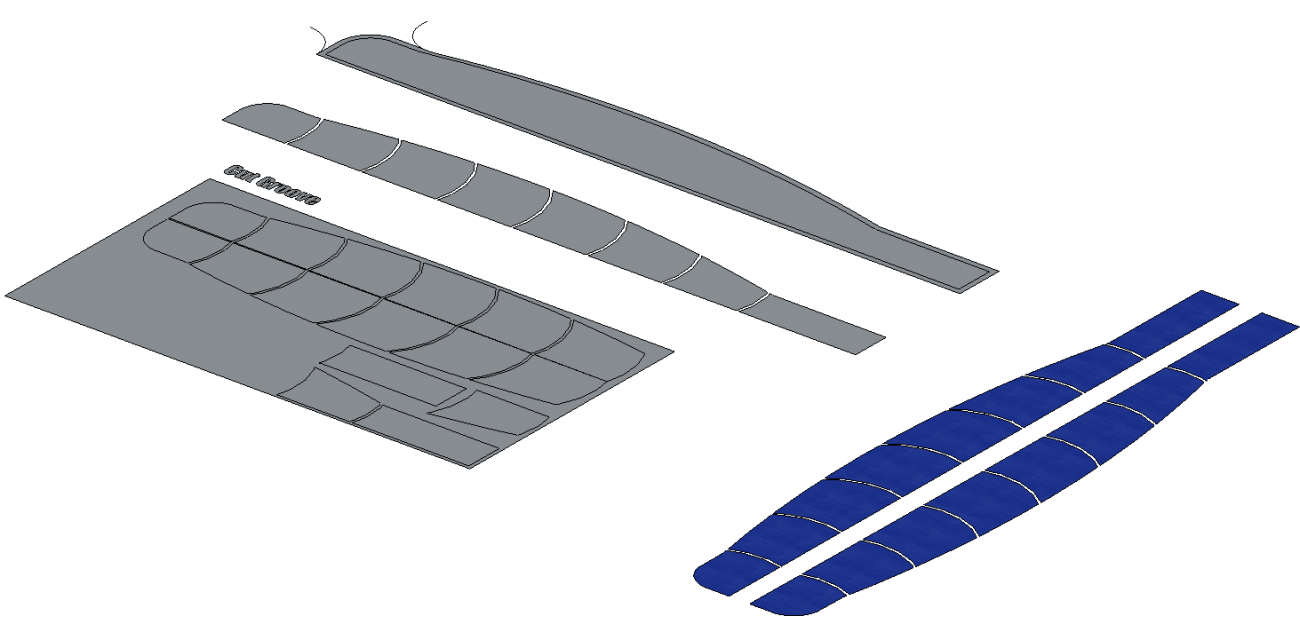

Here a google SketchUp plan for the new proposed Hydroturf decking. Looks like one full sheet might leave enough for 8 seat pads. Waiting for the samples.

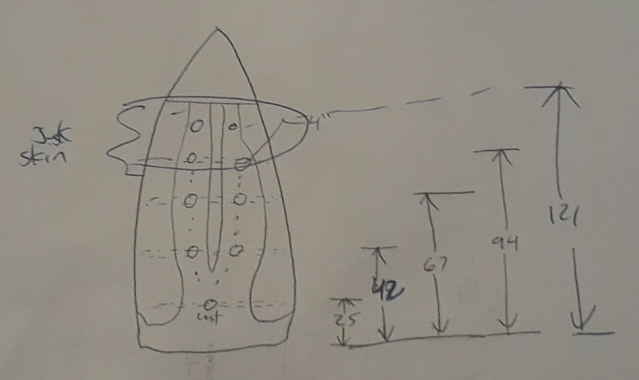

The test pull is complete and its pretty obvious that I'll need at least 5 stringer colums added. Moving to the bow i found that around the centerboard housing the flexing is minimal. The core is attached to the centerboard closer to the bow. Two disc were not attached, two were well attached. I pryed one off the foam and it was hard to remove. One puck I left attached to foam. I was going to drill a bunch of small holes for glue but decided instead to take advantage of the larger acces to lift the luran up for injecting glue in a star pattern out from tbe circumference. Its going to be better to glue the pucks back and fill the small gaps versus filling and leveling 3/8 holes.
I have till the weekend to storyboard the forms for the columns.

Just throwing out an idea that builds a little on JI's mini airbag suggestion. To lift the deck could you use a tire tube(s) inserted in the holes and then inflated in the air space?
There is nothing under core to push against. Its a giant cavern under the deck. I cant imagine what to place in the large gap that would also be recoverable. The deck is about 10 inches off the hull.
On the other hand...Near the mainsheet swivel, it is 1foot from the skin to the hull. Might be ideal for placing a recessed battery case there...then use that big hole for using adding and removing expansion devices. Then sink the recessed battery box to seal the hole.

So my “theory” is to jam a deflated inner tube of appropriate size down one of the hole saw holes and then somehow push or pull it around until it lies flat on the inner surface of the hull, inflate the tube and it should equalize itself in the available space and while pushing down on the inner hull FRP it would also push up on the inner surface of the “deck” FRP which should push the floor up, sort of acting like a stringer. If you needed to remove it just deflate and pull it out of the hole. If it’s not in the way of anything leave it in for some structural support. Just don’t put the boat in an unpressurized plane or it would likely explode :beer:
