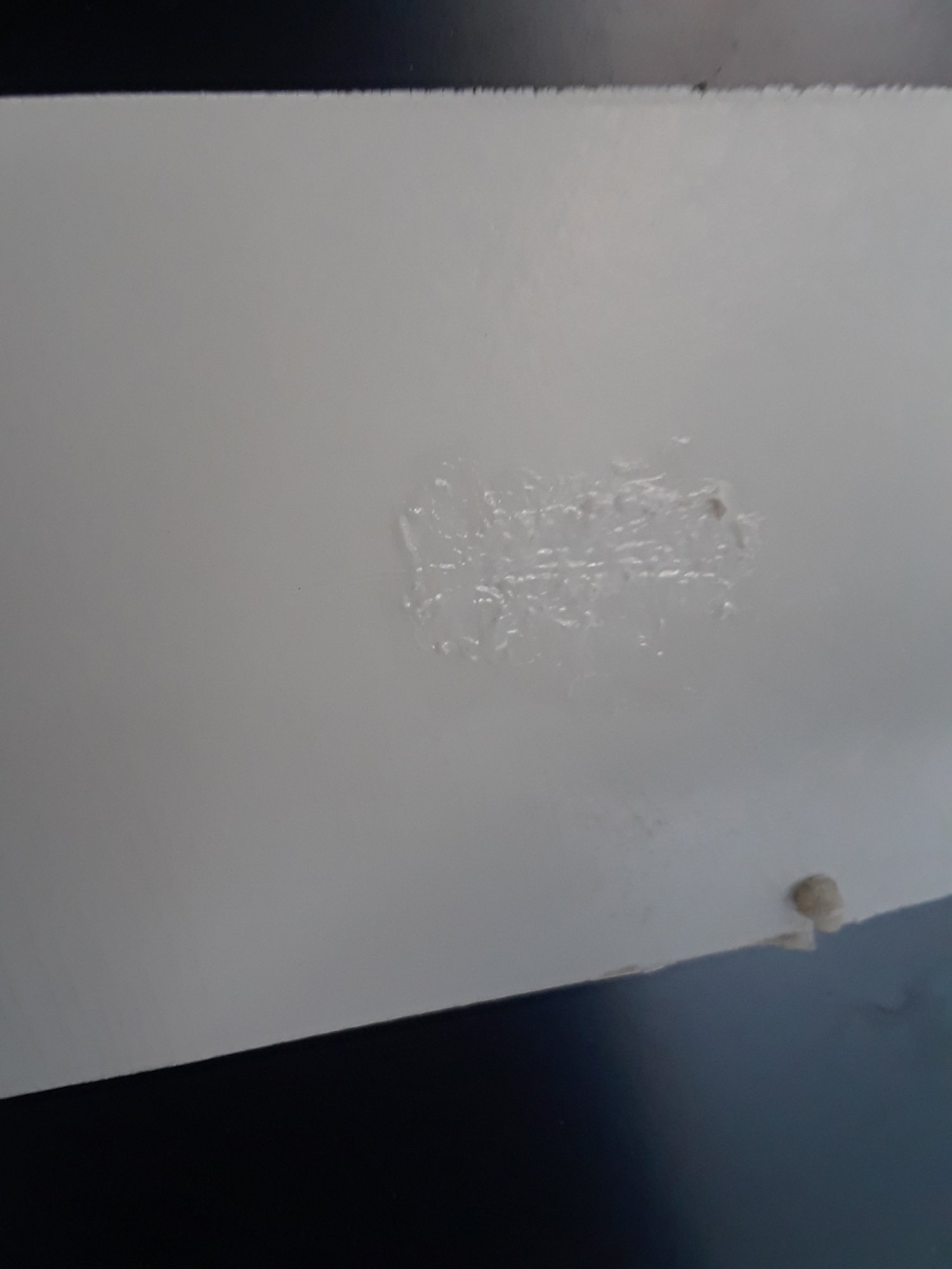

Cut off a sliver of luran from the scrap pile to make a crayon. Dip the crayon in a small cup of acetone and transfer the crayon to the gash. Repeat until both start to soften, be careful not to drip any.
It doesnt take long to blend out the gash with the gummy crayon.
I tested it out by adding some dock rash to a good looking sample and sticking a sample on a cabinet wall.
This is probably the best way to do it horizontally as well.
Follow up in a few hours with 220, 320, 400, 1000, then start polishing

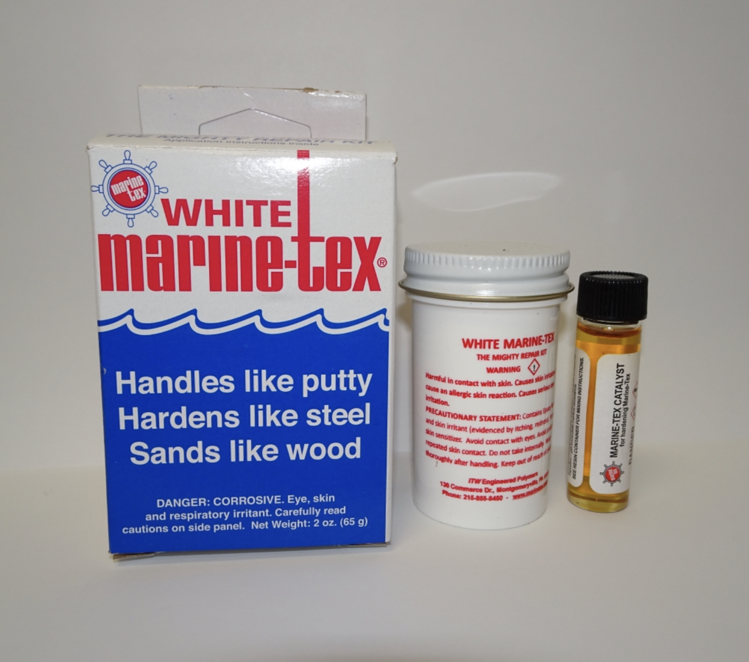

I used to have some Ding Stick (quicky repair for a windsurfer) but it’s long gone. Is this the Marinetex product you used?

That's it. Its a good product if you want white and you dont want to get a custom epoxy kit like total boat, or west system or us composite. Mix the two products then spread. It is harder to sand than luran so be sure to sand with a block. It is a different color white as well.
I covered hundreds of scratches and some pretty big gouges. I then primed and painted over it. I am not sure if it needs paint to protect from uv.
If you have the epoxy and fairing fillers, they work too, just spray paint over it. Id probably spraypaint over marine tex too.
Then of course there is the plexus, but im not sold that that is for filling.
