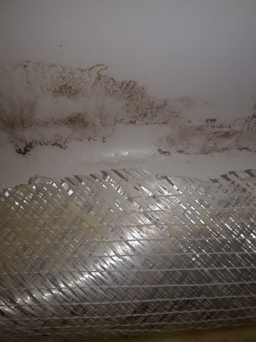

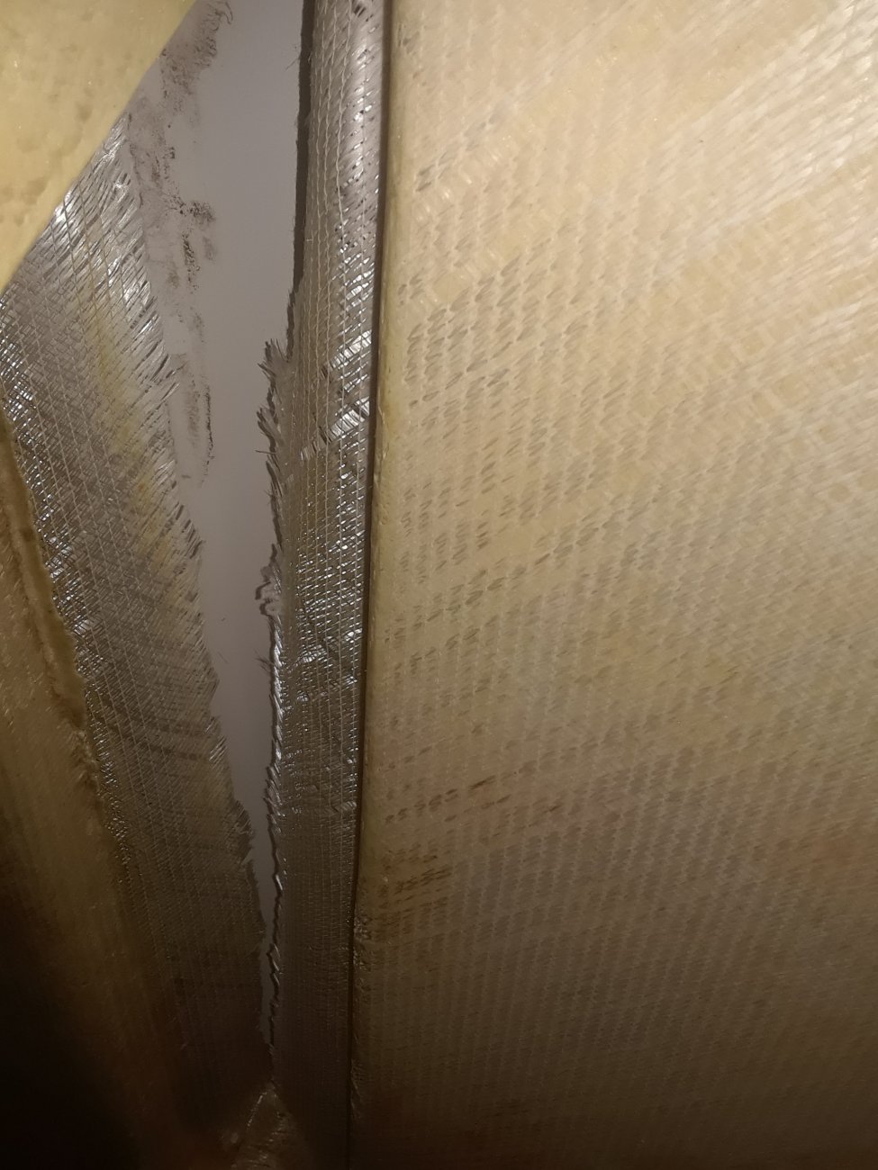

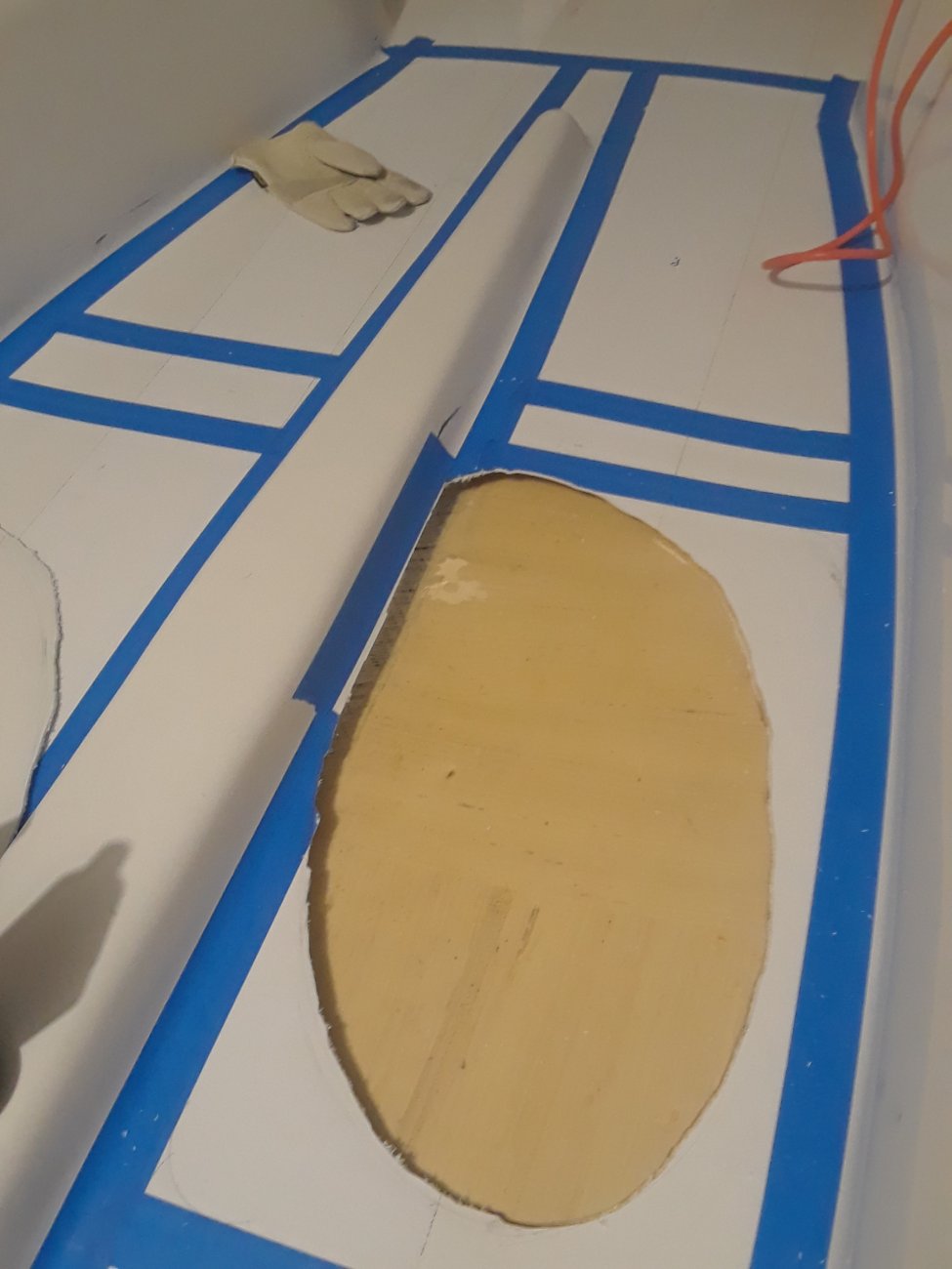

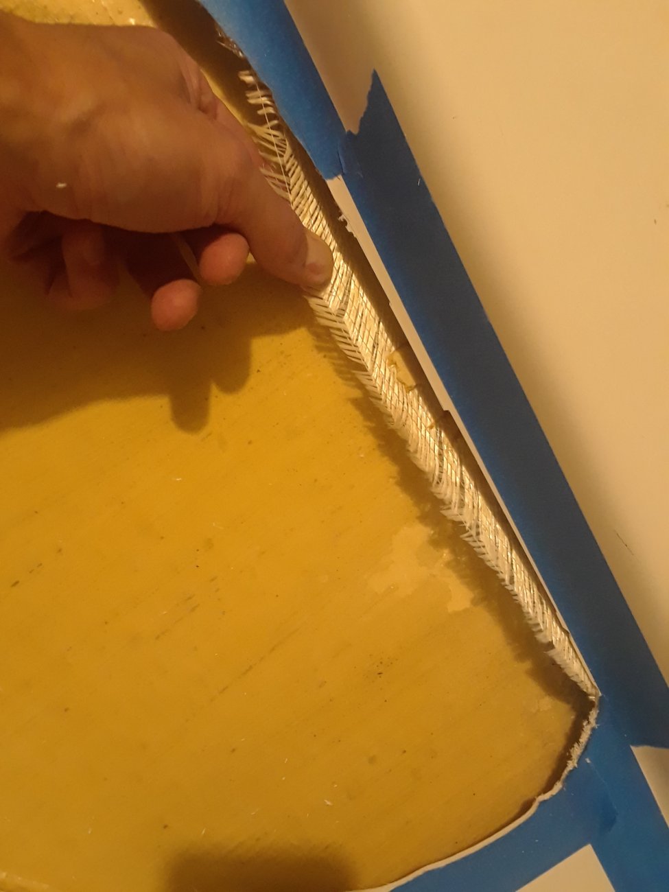

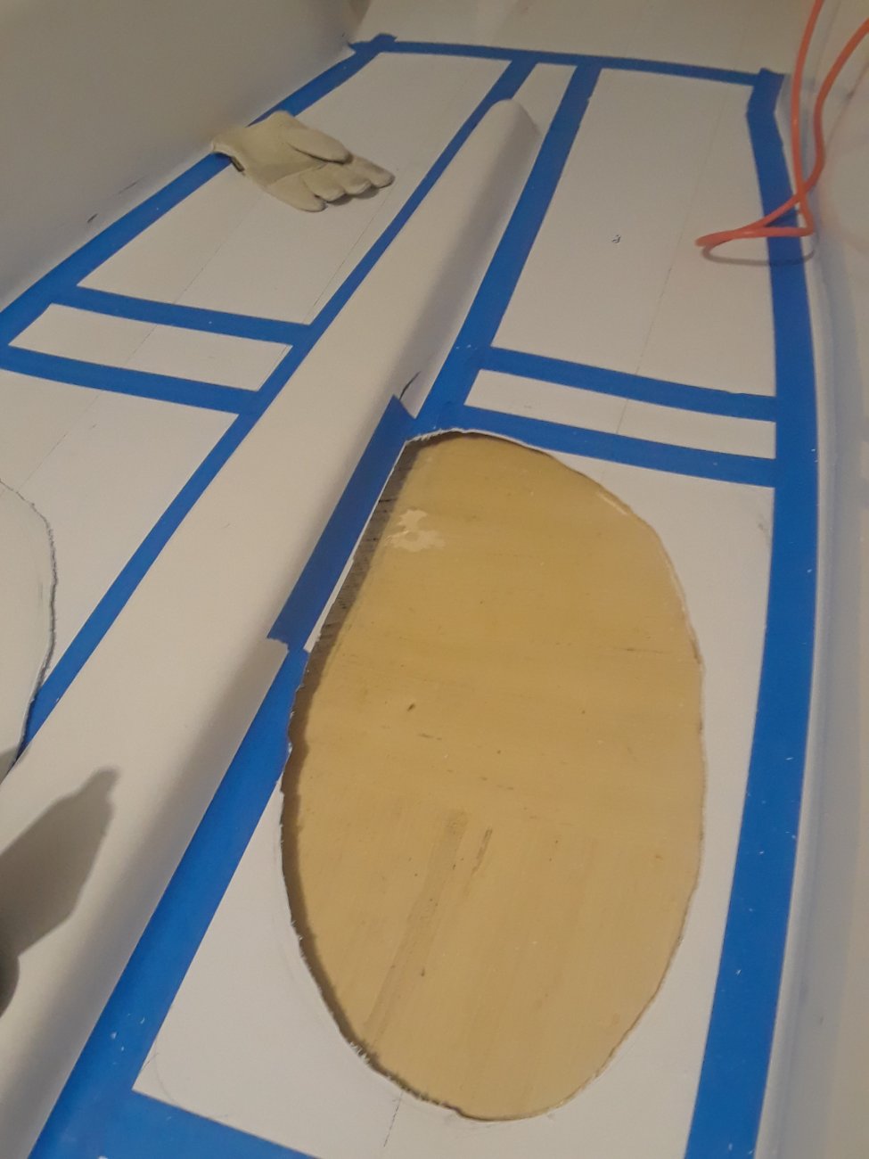

My deck has been flexing for a while and a crack occured near the centerboard housing. i figured the foam had collapsed so began a repair. The plan was to cut out small shapes, build the foam back up, then replace the skin. The picture shows where i marked tape to section out the shapes. Can see one shape has been cut out.

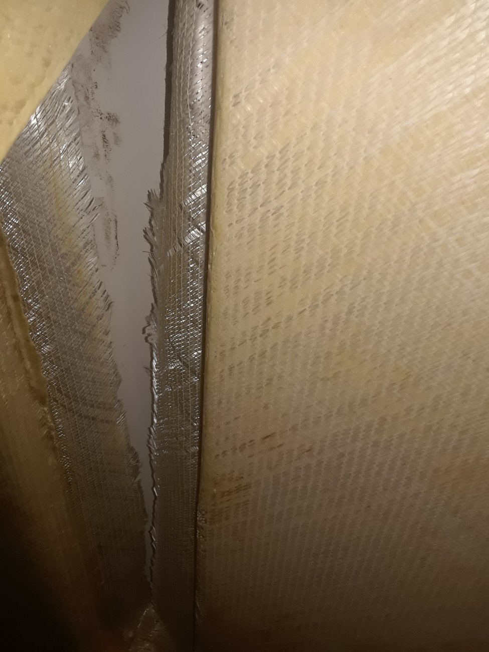

Im dumbfounded as to what has happened. It appears the bottom of the decking is no longer attached structurally to the centerboard housing. There is a loose section of fiberglass with no resin of any kind. The foam is actually intact underneath.
In one picture you can see the 2 inch gap caused by the floor collapsing.
Im guessing for this repair i need to find a way to support the foam deck, glue the foam up to the plastic skin, then patch it up.
Most of the repairs are about pressing the decking skin diwn, i need to pull it up?

The resin-free area looks very regular. It almost looks too regular to have been an accident. I wonder if that was done intentionally to allow flex & prevent the creation of a stress concentration point.
My 212 has the same ACP construction as the 170. It had a small area of de-lamination. I drilled a small hole, filled it with 5200 & weighted the skin down until the 5200 cured. So far, so good on that boat. That was probably 2 years ago or more.
I will be following this repair with great interest. My 170 has a small de-laminated/cracked area. I will be very interested to see what you find inside there as repairs continue.
Thank you for posting.

Another thought -
You say that you need to support the foam. Another option might be to drill a small hole through the foam, insert a toggle bolt, then attach a cord to pull it up.
...Just an alternate way of putting upward pressure on the foam sheet.

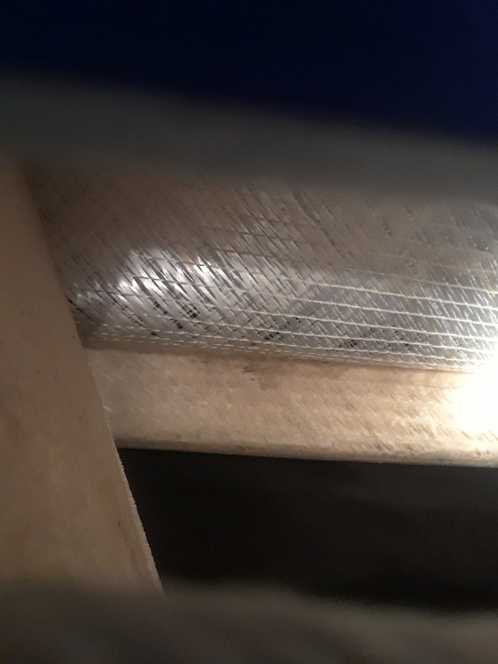

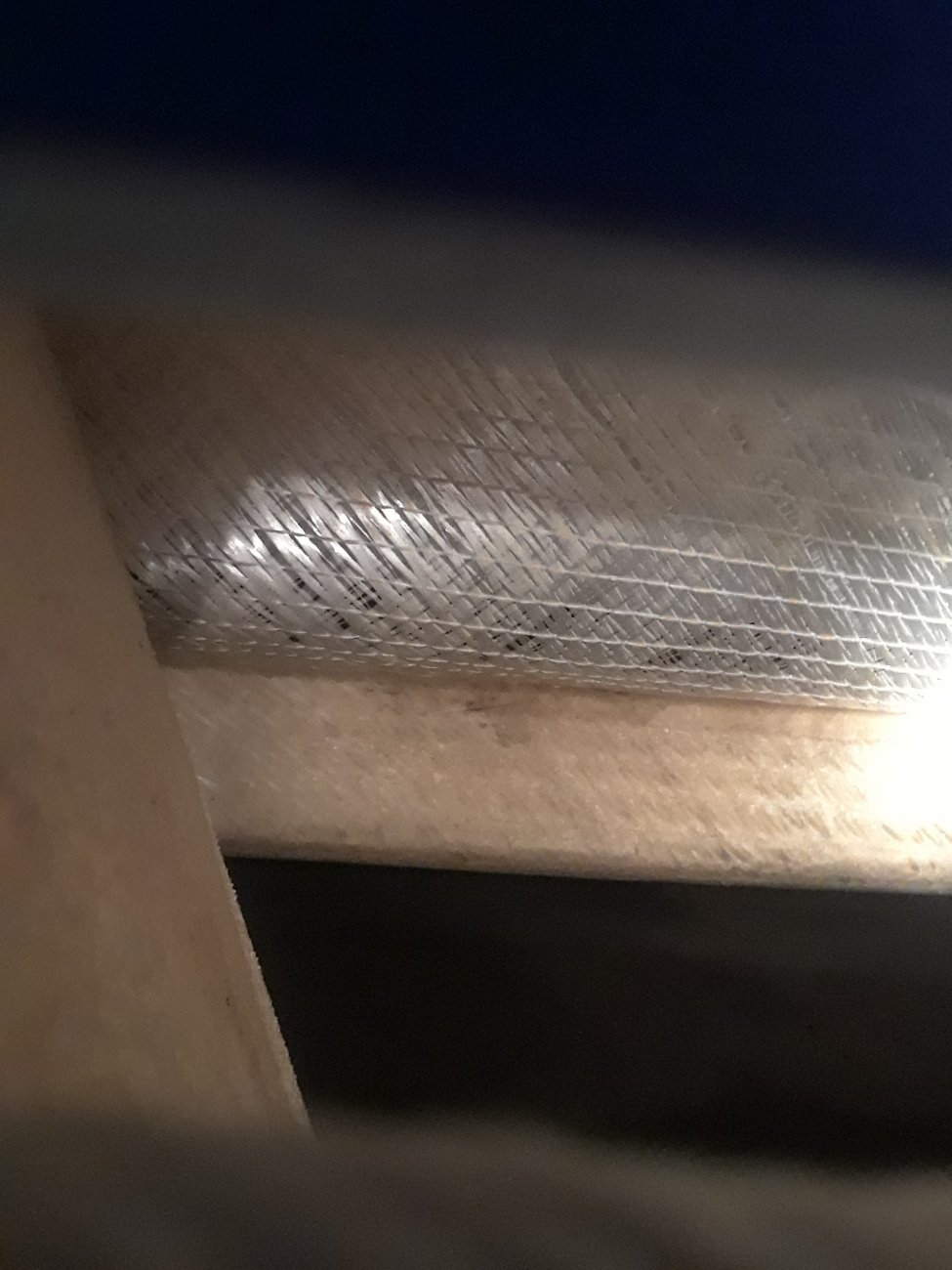

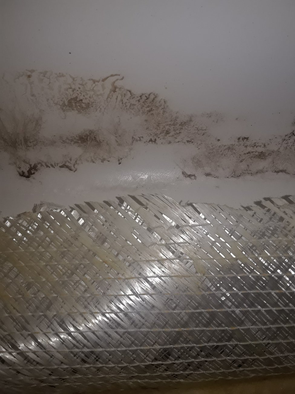

This appears reasonable. I was able to press the deck down enough to get the phone inside. Could also see the other side od the centerboad housing(foot stop). There is a consistant strip of resin free glass running along the centerboard housing. Good news...There is no water in tbe hull.
One picture shows the decking on the other side of the centerboard housing. can see the inch and a half of good looking foam and the resin free glass just resting on tbe foot stop. Can also see some plastic chunk that is the structure for the centerboad trunk.
next picture is looking up underneath the foot stop. I was thinking Hunter used a solid piece of glass fabric and used it for support, but its cut clean under the foot stop.
In essence the only thing holding that floor together is the tension of the skin between the seats and the adhesion of the skin to the foam. When the adhesion ends so does the floor.

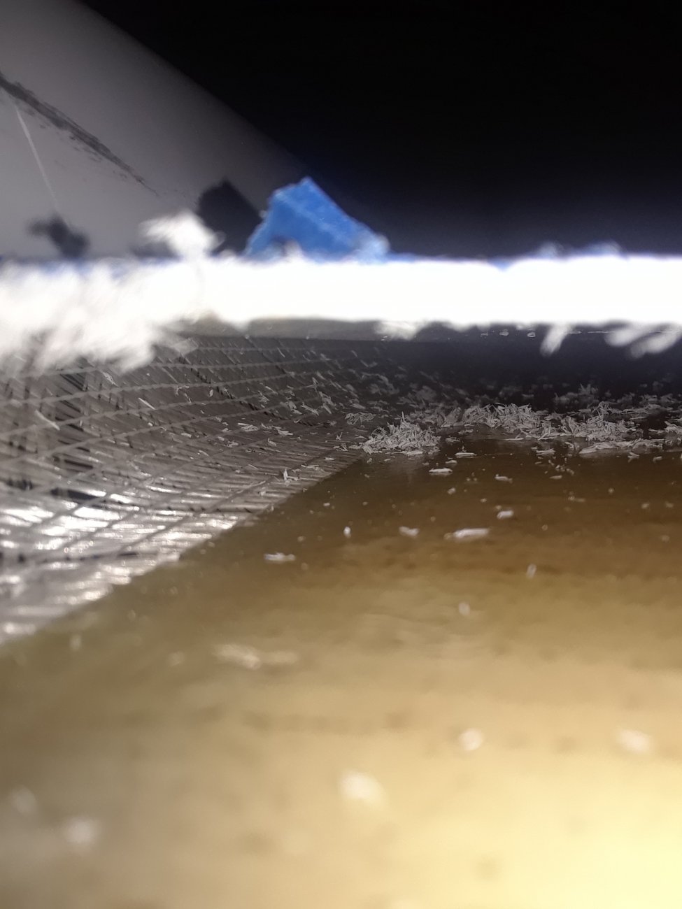

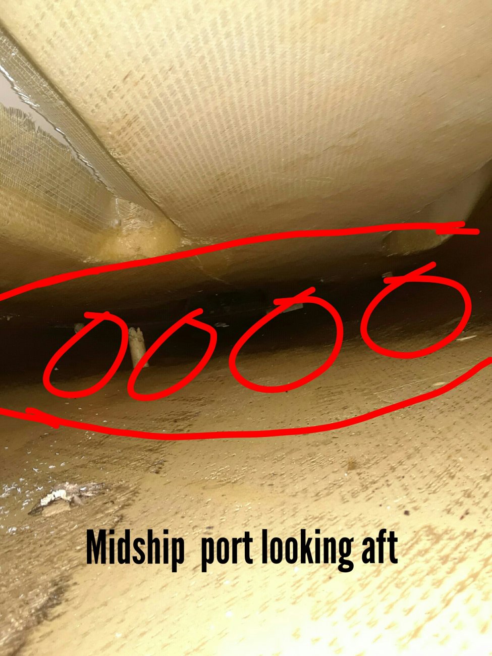

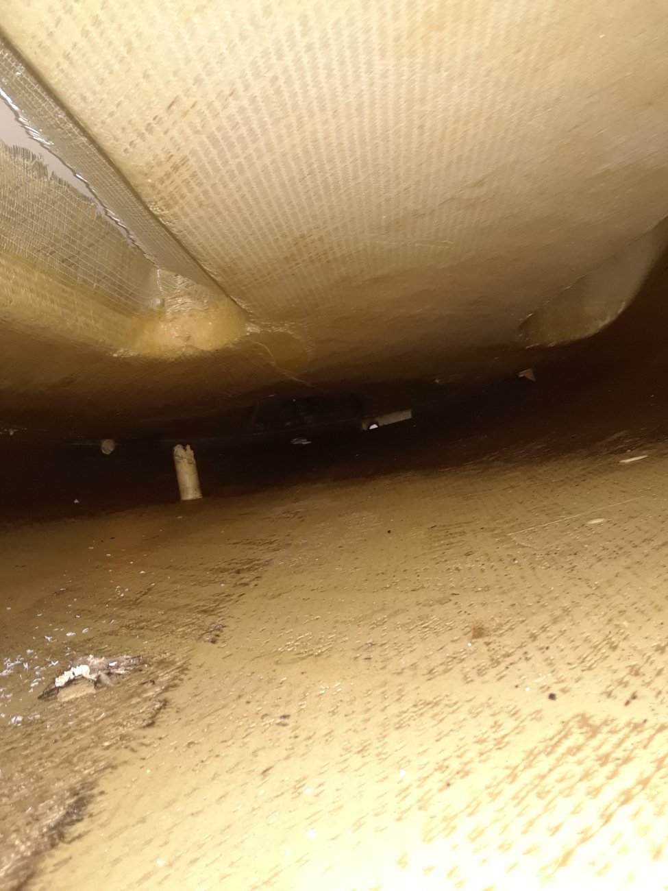

Got a 4" hole saw and cut through the foam in the same area as the skin I removed. This allowed me to get a camera in the hull.
The unedited picture is under the port deck by the mainsheet swival, looking towards the motor mount. The drain hole is visible on right. Not sure what the expanded foam column is to the left.
This explains everything. There is no support under the deck at all and there is about 3 feet where the deck has to wrap around the centerboard and it is not attached, purposely. In my opinion, Hunter170 deck delamination repairs are only temporary fixes if the deck is not fully supported.
Im guessing that Hunter has that free floating deck after the mainsheet swival because the core would split right there. They knew it would wiggle, but hoped that the skin to core adhesive would hold.
Better construction would have been the inclusion of a stringer at the end of the centerboard trunk that spans both decks and connects or at least rests on the hull.

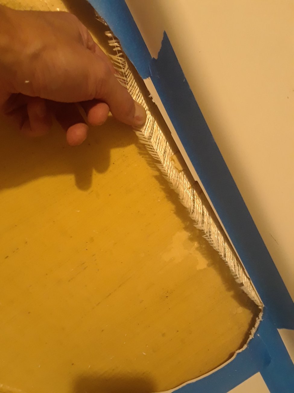

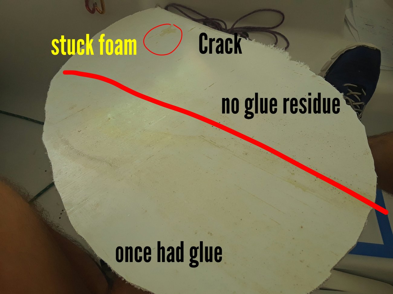

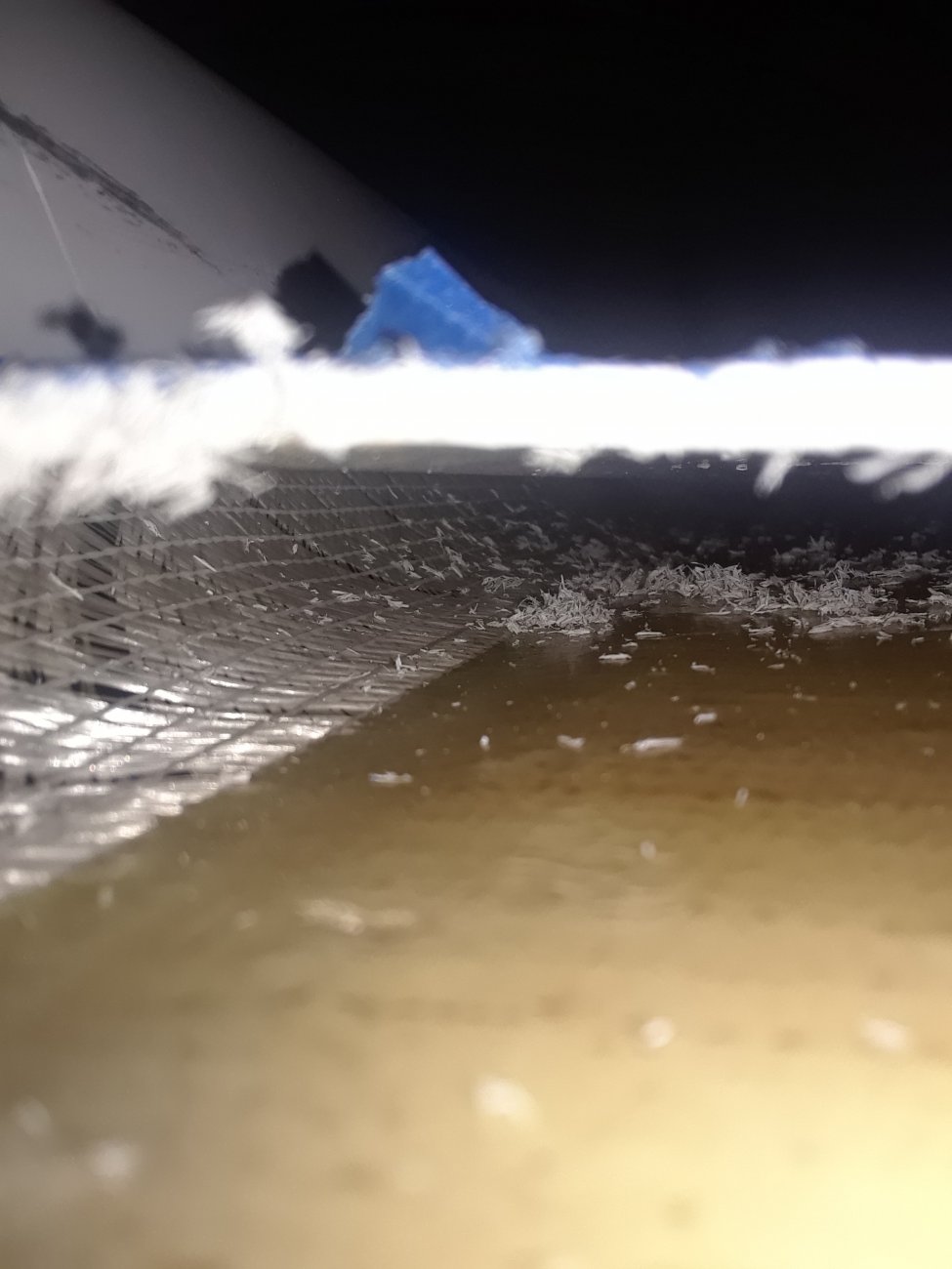

Here is a picture of the underside of the luran skin panel i dremeled off.
This provides evidence to me that 2 part urathane foam core barely sticks to plastic. It also shows what looks like the section closest to the centerboard housing/foot stop did not get attached to the core during the factory build.
Gorrila glue might work for areas like seats that are well structured, but it might not be great for decking. Gorrila glue expands with moisture and if the space isnt pressed together and the gaps removed the bond will be made of foam bubbles. I can see the circular bubbles on the panel.
Fun fact...As i was pulling the grip tape off the deck, i could hear the luran delaminate from the core
Aug 22, 2017
1,609
Hunter 26.5 West Palm Beach
In the picture in post 38, on the left, I see bare glass cloth that looks cut. I am curious what the opposite side of the boat looks like in that area. Is it also bare glass? or is there resin on that side? If there is resin on the other side, I am going to have to conclude that somebody probably did a poor quality vacuum bag job. I am leaning towards that conclusion at this time since the resin looks significantly richer towards the stern of the boat compared to mid-ship.
