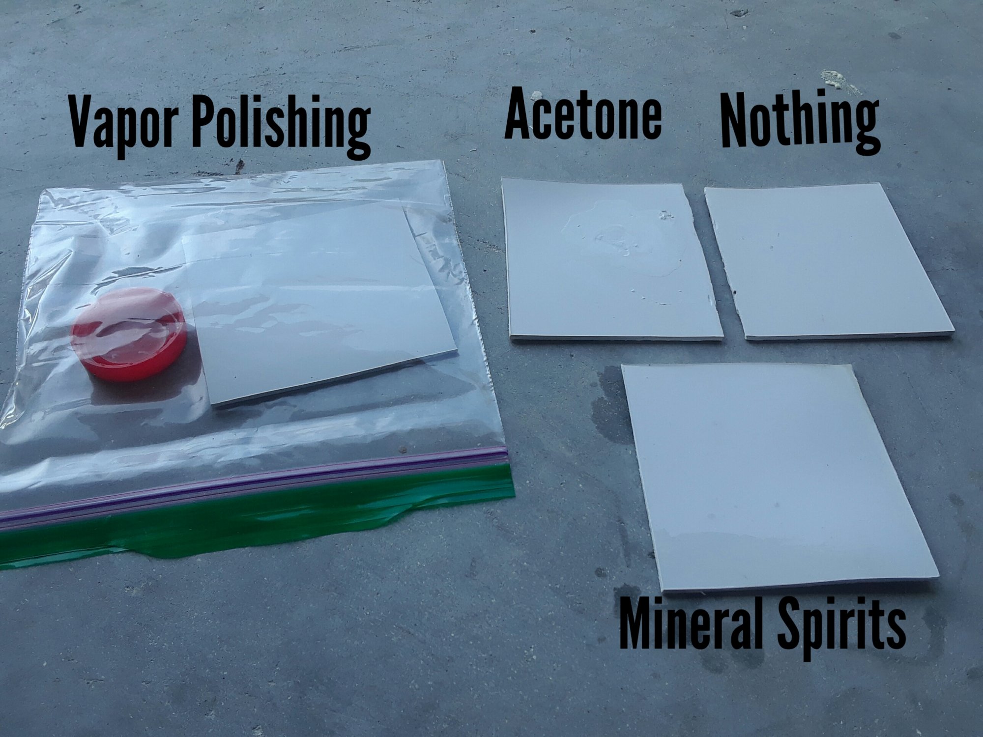

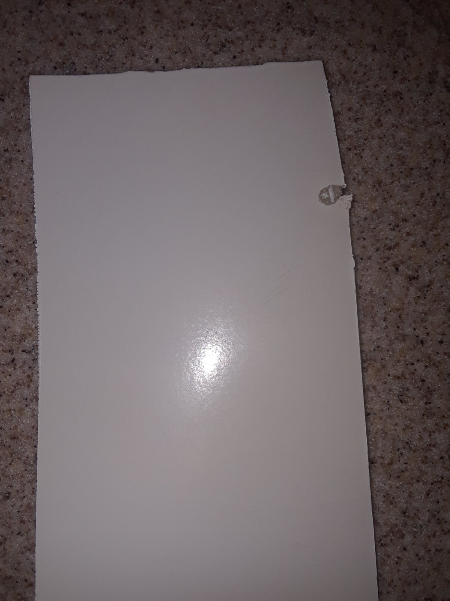

Did a couple experiments this afternoon. With informative results.
i sanded a section of scrap with 80g, 120g, then 220g, then snapped them into 4 sections.
Did 4 tests:
1. Can luran be vapor polished. Probably.
2. Is Acetone bad for luran. EXTREMELY BAD
3. Are Mineral Spirit dangerous? Nope.
4. Does PVC Cement bond Luran? Nope, but the acetone in the primer and cement turn the luran to wet paint.
I "cold" vapor polished a section for about 20 minutes. I did not leave it in the polishing container long enough. The luran was resting horizontally and often that does not help. The Luran test sample surface was much softer and scratched like wet paint even with just the acetone vapor. The section still looked exactly the same as the the non treated section and 220 grit lines were still visible.

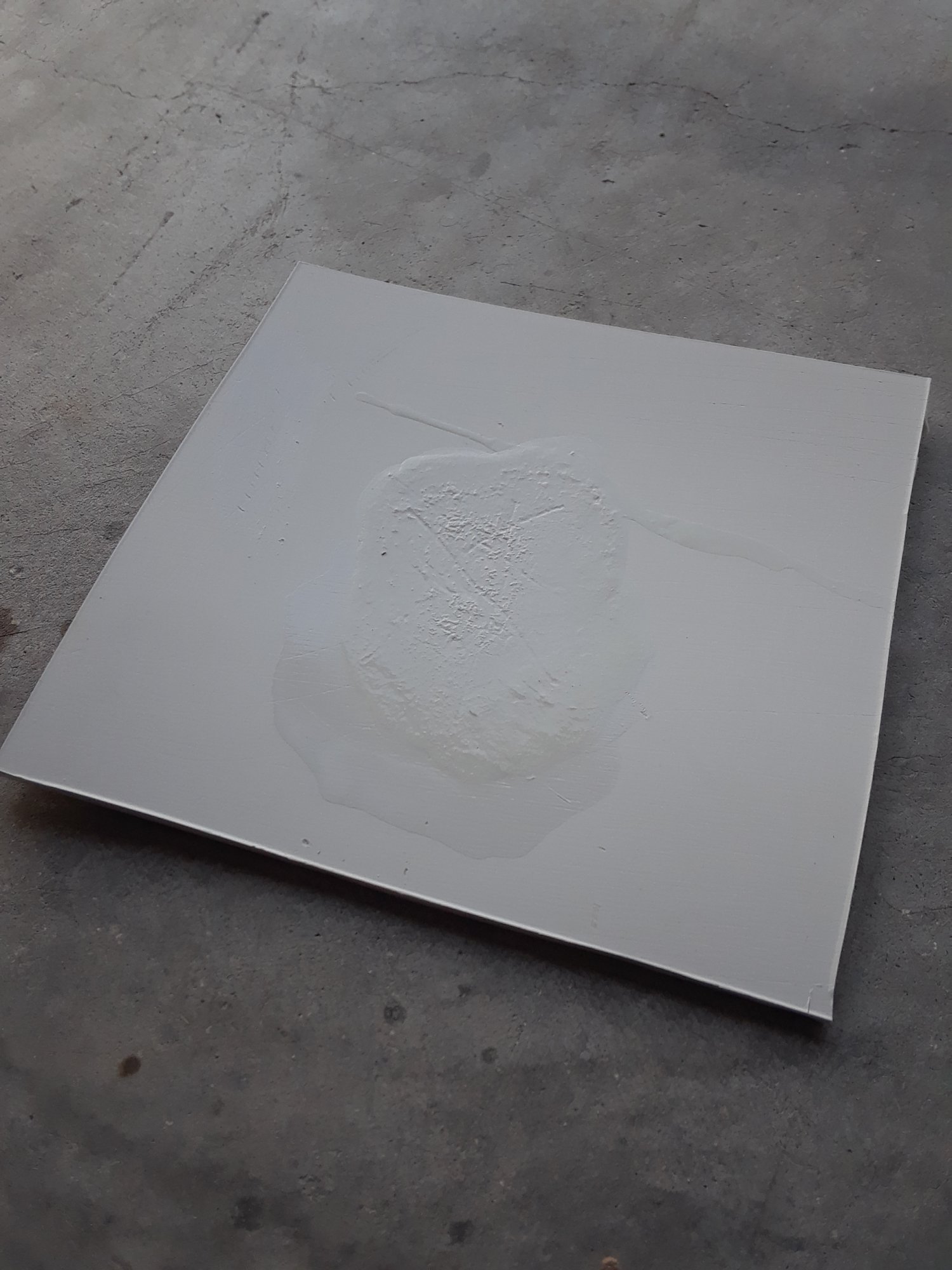

I poured several drops of acetone on a test section and let it evaporate off. The goo that remained was like semi dried latex paint. In theory the surface should harded after the acetone fully goes away. The surface was raised a little so it probably would need to be sanded afterwards. I put a couple more drops on and started stirring the surface, the acetone turned the plastic to paint. A full thickness of luran would probably completly dissolve in acetone in less than 10 minutes.
Mineral spirits left on the surface evaporated off with no results.
I had some left over pvc cement from a project of getting rid of a water softener. Both the primer and the cement are in an acetone solution. As soon as the primer went down the luran turned to mush. The two pieces i glued together came right apart.
Acetone is nasty stuff for luran. Even the fumes will ruin the surface.
How can thus be useful? Will acetone level a deep scratch?

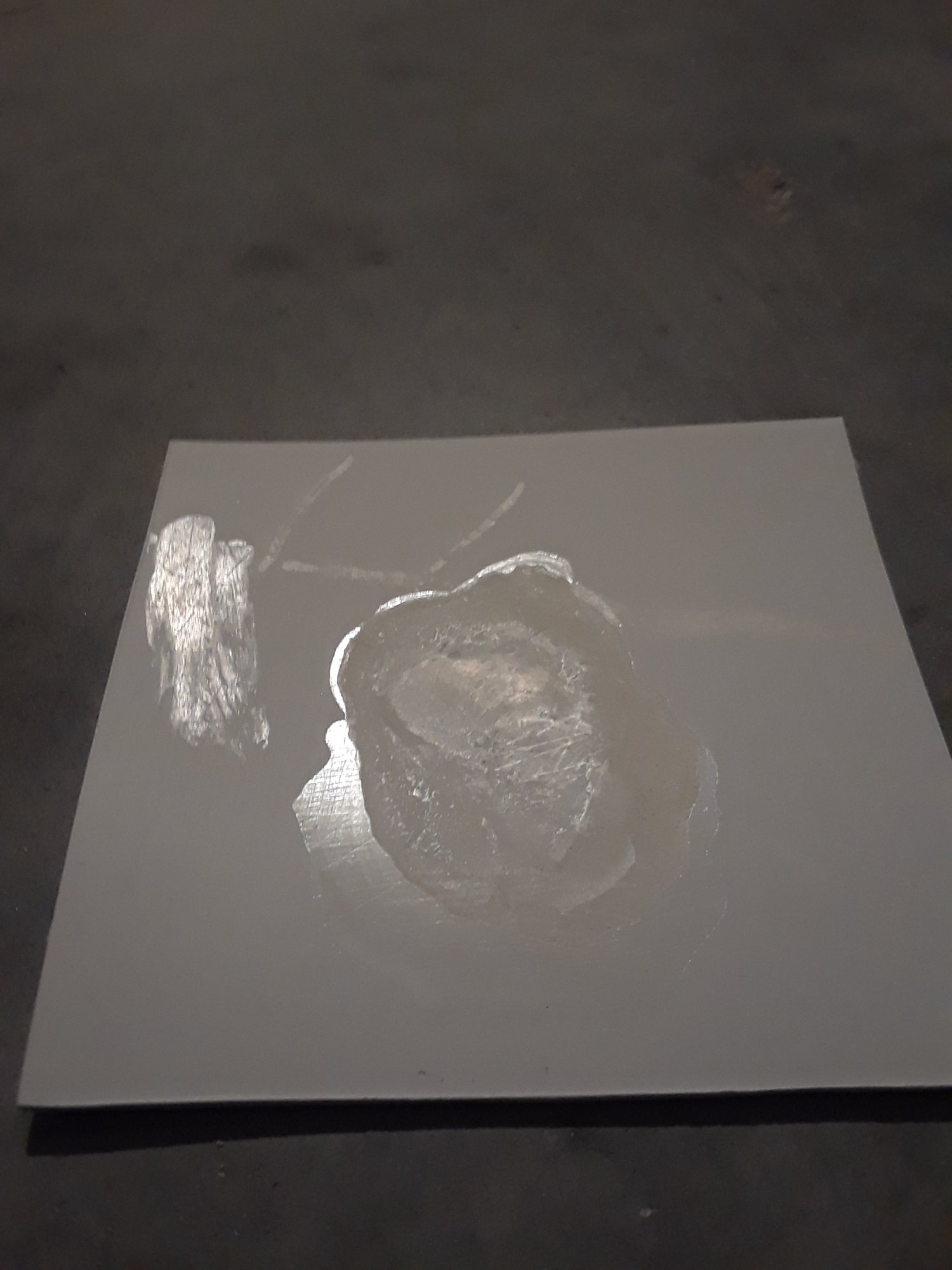

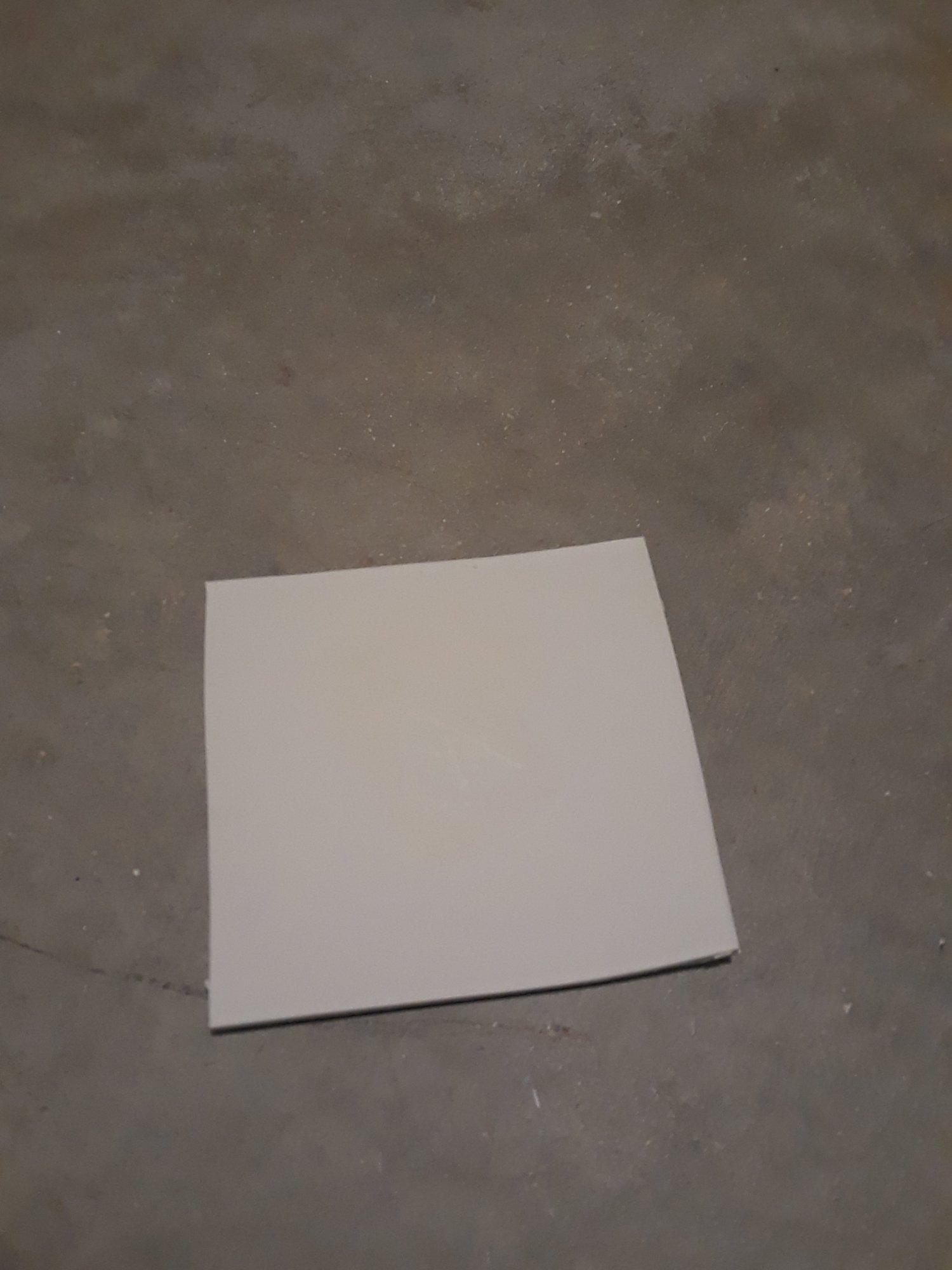

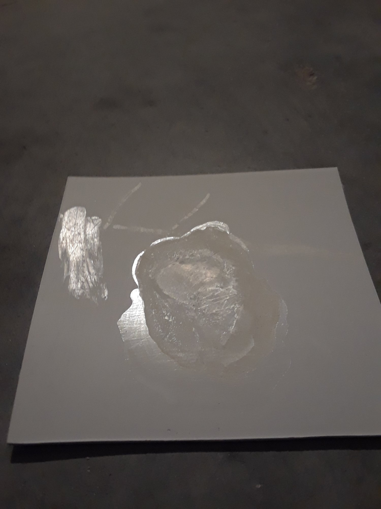

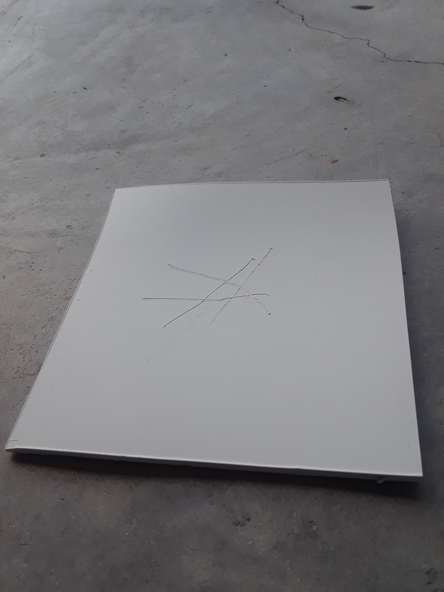

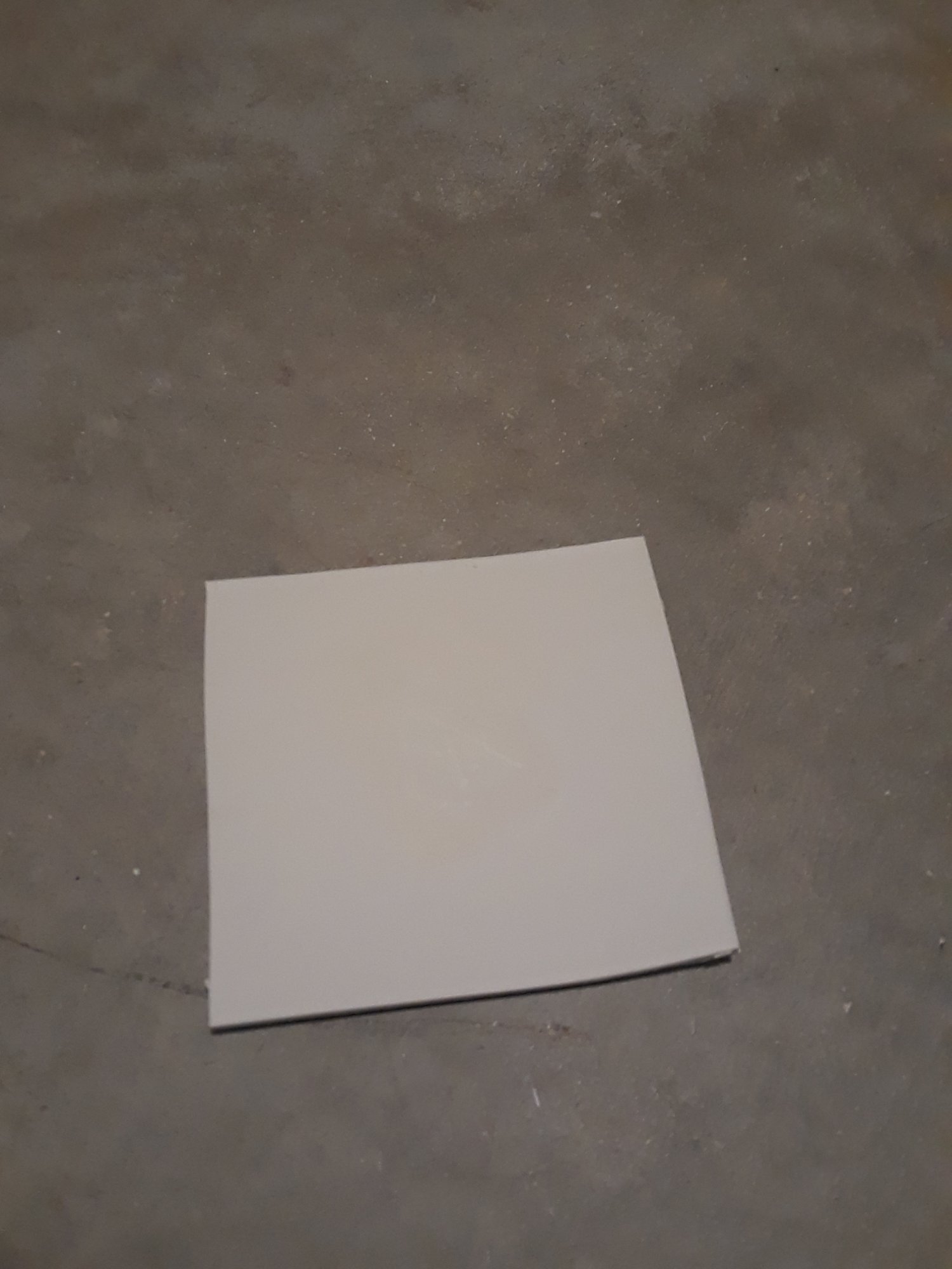

You actually can use acetone to get rid of scratches. Its not a great system but it sort of works.
I started with a smooth sample and cut a few gouges with a screwdriver.
I then poured acetone over the scratches and started rubbing the chemical melt around with a finger (with gloves). The acetone flashes off quickly, so you need to add a little more if the melt start getting gummy. Pour a little more acetone and try to level it before it gums up again
After a couple hours the hardness of the luran returns and it can be sanded. I lightly sanded the luran with 220 grit and within a minute the surface was nearly perfect. There is some discoloration that wont go away. The attached pictures have timestamps.
The gouges were pretty deep and would have required some 80g, 120g prep and there would be a dip in the luran.
Likes: Hunter216

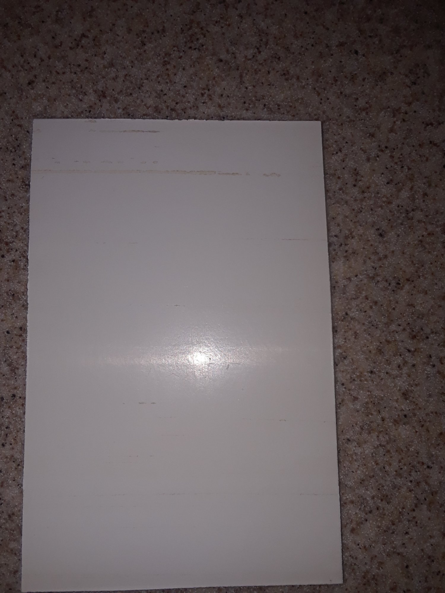

Bar keepers friend will clean luran luran and the sample i had did not change. It is abbrasive so rubbing will dull the surface. I have used it before to polish when soft scrub just cleans. Use lots of water.
Using oxcilic acid is safe. Feldspar crystals in barkeepers friend are not.
Oven cleaner is amazing on luran. I sampled the bottom of the luran (side facibg foam) under the cuddy cabin. It cleaned the surface to a polish and was so thorough that i can see the stress fractures from warping.
Both samples had 1/4 of surface covered overnight. There was no difference between overnight and exposure from nirmal cleaning.
Its hard to get good pictures, but the oven cleaner restores the underside of luran to like new.
