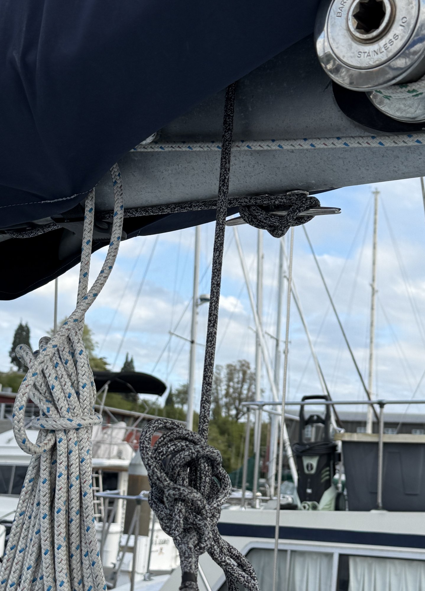

Here is the attached images of the outhaul tie off on the boom near the mast.

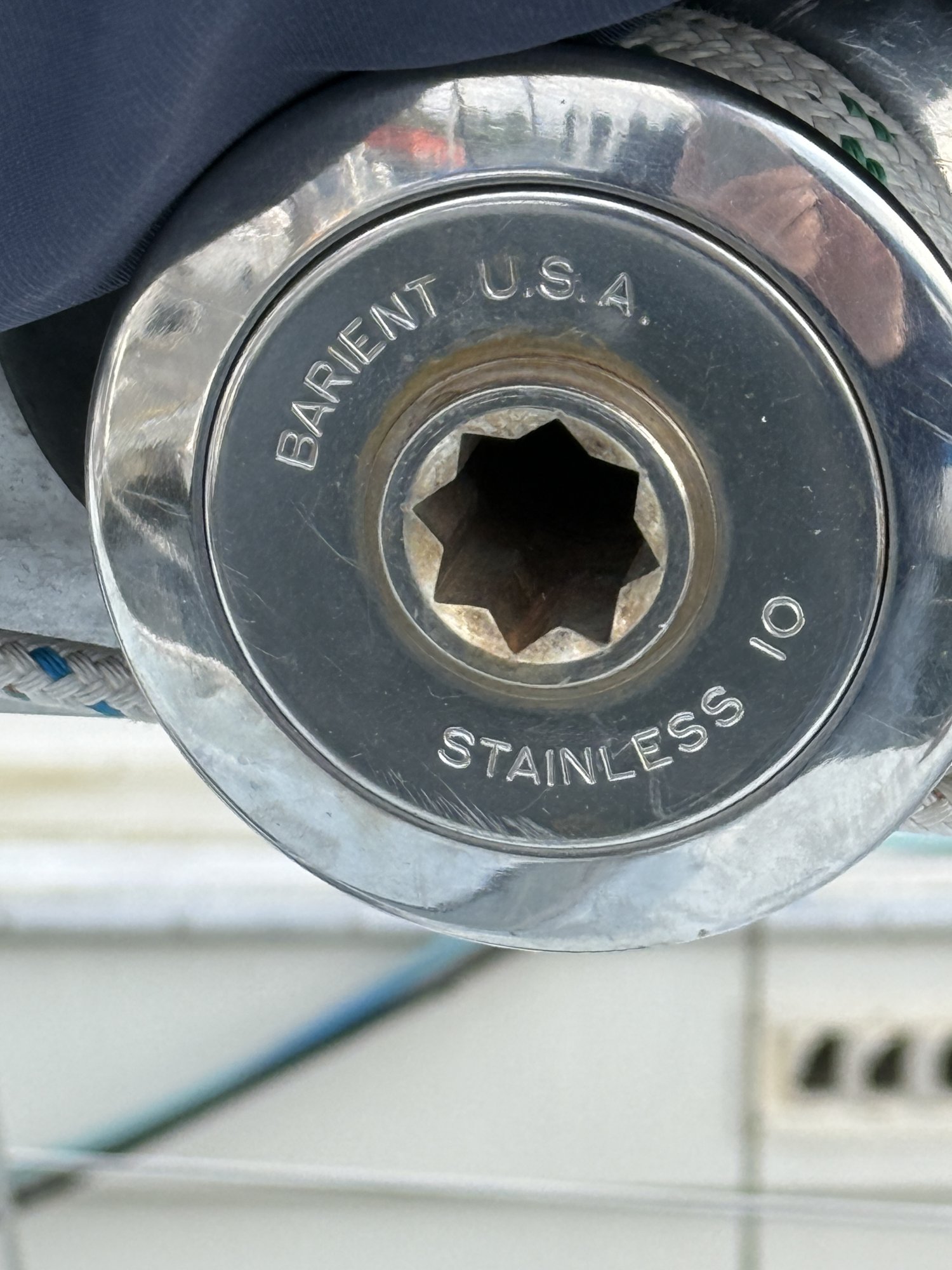

Here is the #10 winch I installed.

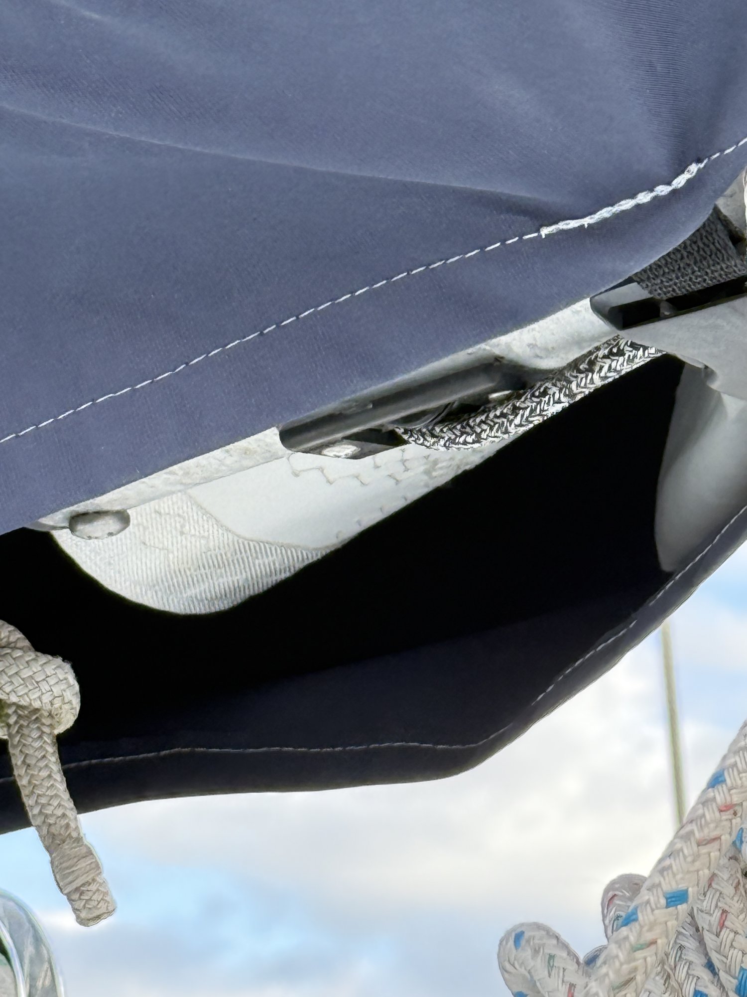

Here is the exit box where the outhaul line exits the boom underneath.
The line goes back to a cleat.

Can you use that winch for the outhaul? It seems that the lead angle would be really sever for both the exit block and the winch.
