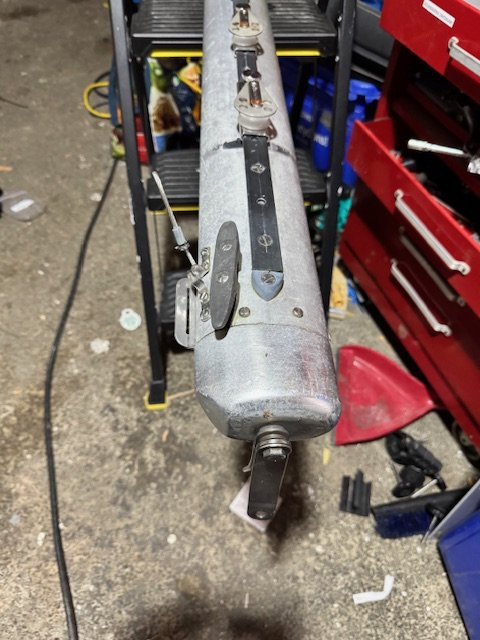

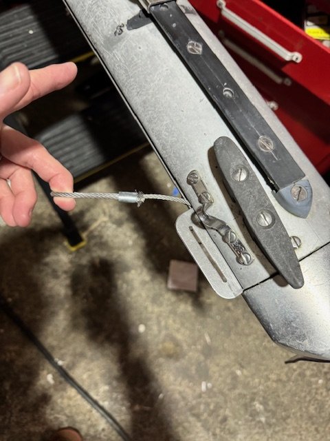

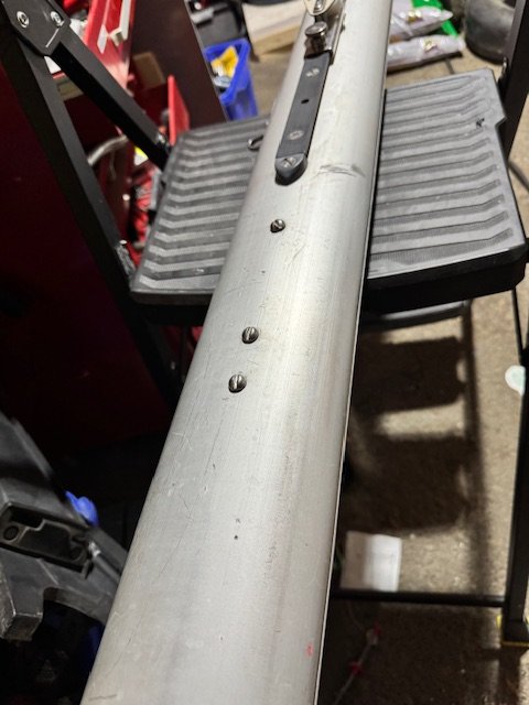

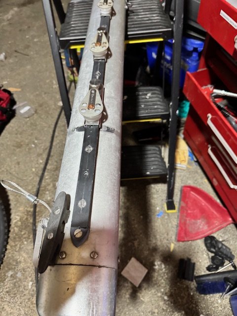

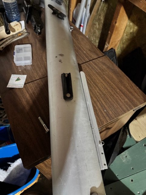

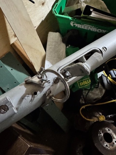

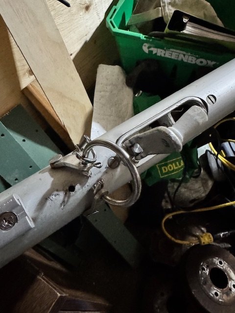

So here are pics of my boom
Good thing, the end caps are screwed, so it should be easy to remove unless they are seized in place.
The crank is held in place by 2 screws, I cannot see a sheave where the wire goes in, will take it apart and see what I have to work with
7,761
There's got to be a better way. I would be inclined to design a new system on paper maybe even make a mockup to get measurements. And then take all the hardware off and re-do it according to that design. I don't think you need as much purchase as mentioned. I think 3:1 ought to do it. After a point the extra turns become more friction than help.
I think your boom may have once been a roller as some boats of that vintage were. My Ranger 29 was. The boom would turn a little which I never cured.

Yes it was a roller boom, I still have the hand crank for it, I use it to aligne the boom early spring

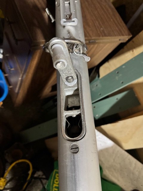

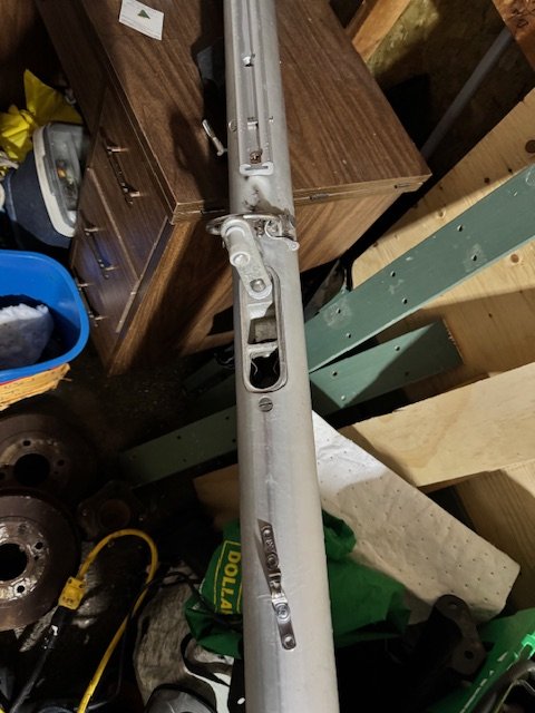

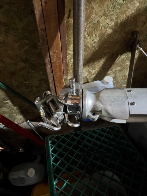

I also took the afternoon end of the boom off and unscrewed the original internal winch, ow more headaches.
The boom end does have a sheave inside it, which is perfect, I am trying to figure if I need to reinstall this part, it’s a slider that goes in the boom track, there is a hole in it so the line goes through, but I cannot figure out the why of it’s existence
Now trying to remove the winch is proving to be more complicated than expected, I took some pics of the inside of the boom where the winch was and not sure what to do next

Ok, by the aft end didn’t work, so I removed the fore end cap, tried to remove the whole sled assembly, did not want to move, removed all the fasteners and with a little persuasion it finally came out
So by removing the sled assembly, was not sure how this was setup, so it is a sled that is moved by the crank, now having seen what was there, I can fully understand why the outhaul was not pulling the main tight, very little travel.
next steps will be installing the new outhaul, will try and get all the crap out from inside the boom first
