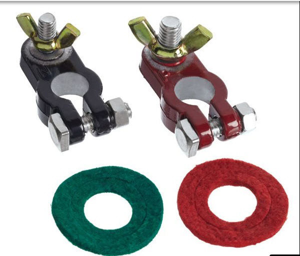

Has anyone ever had a nut seize up on a Post terminal before. Tried WD 40 and can't get it to move. May have to cut it off. Any other suggestion would be appreciated.

If it is seized then it will continue to give you issues. I'd replace the complete terminal, they are not that much $$$$.
Cut the bolt and spread the terminal apart.
Not sure if these are rated for marine use, but I used the picture just for the explanation.

Terminal Post Claps.jpg :dancing: DaveJ......... that's what I was looking at a few minutes ago. These are for marine use.
May 20, 2016
3,015
Wytekwire.com sells just the bolt. Do yourself a favor and only use crimped battery cables.

Just talked to the supplier of batteries and he said just to cut it off. Doesn't matter if it is missing. Their recycling the batteries.

Are you talking cutting the posts or the cables? I'd cut the cables as cutting the post is risky with puncturing the battery
