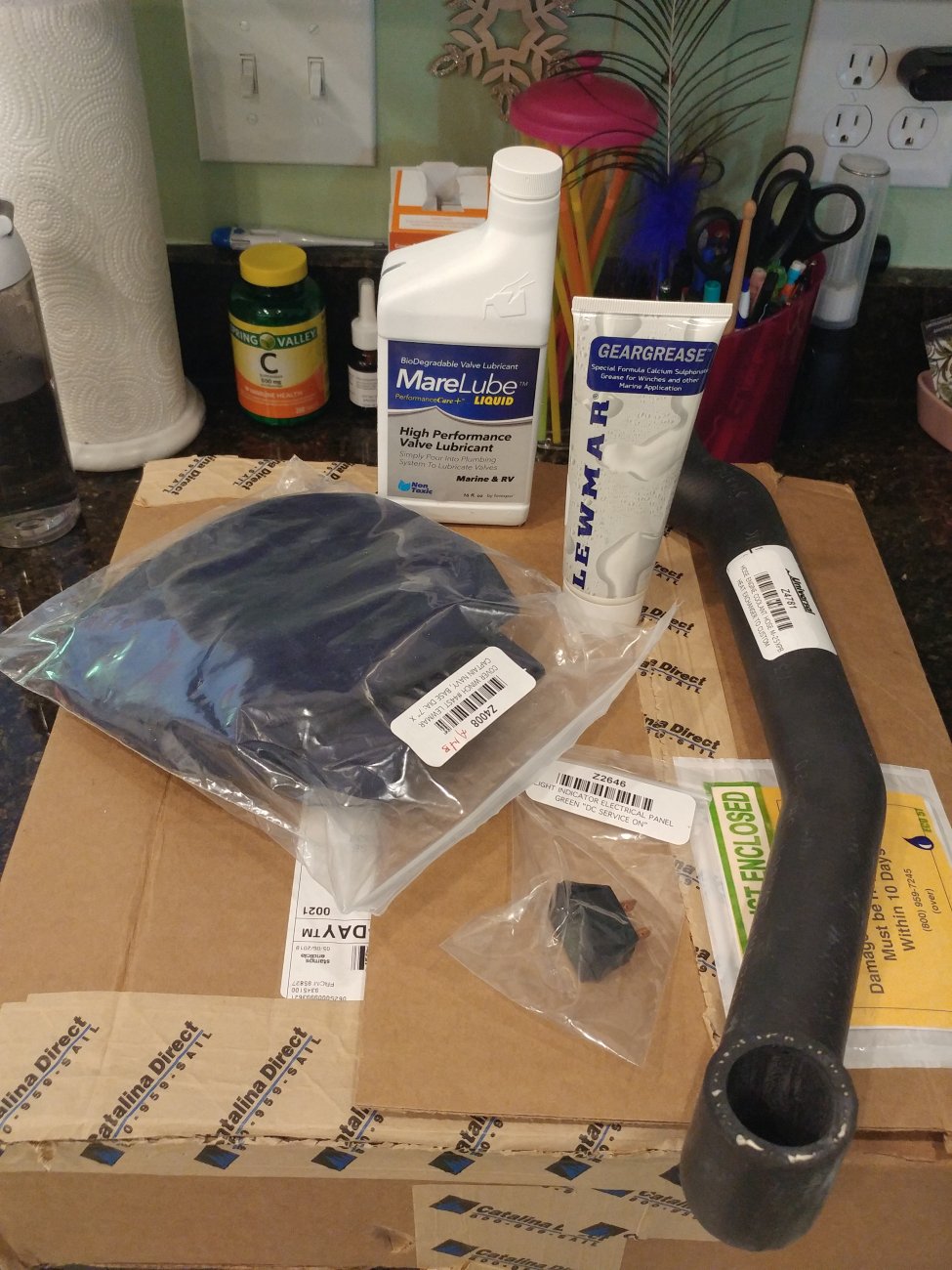

My first Catalina Direct Order. The little front hose is on backorder which is a bummer.20190508_175824.jpg

I see you have the green "power on" light for the DC panel...I also had to replace that when I bought hull #48 five or so years ago...

I started out just planning to order hoses but the shipping charges encourage you to add on!
If yours burns out again I can tell you where to buy an LED version that shouldn’t do that...
Likes: JRT

we also replaced ours just after we got the boat, as it also had burned out, I remember comments about not replacing or putting tape over it as it was too bright (?). We like it of course its personal preference.
I am also with justin nsa!
Likes: JRT
