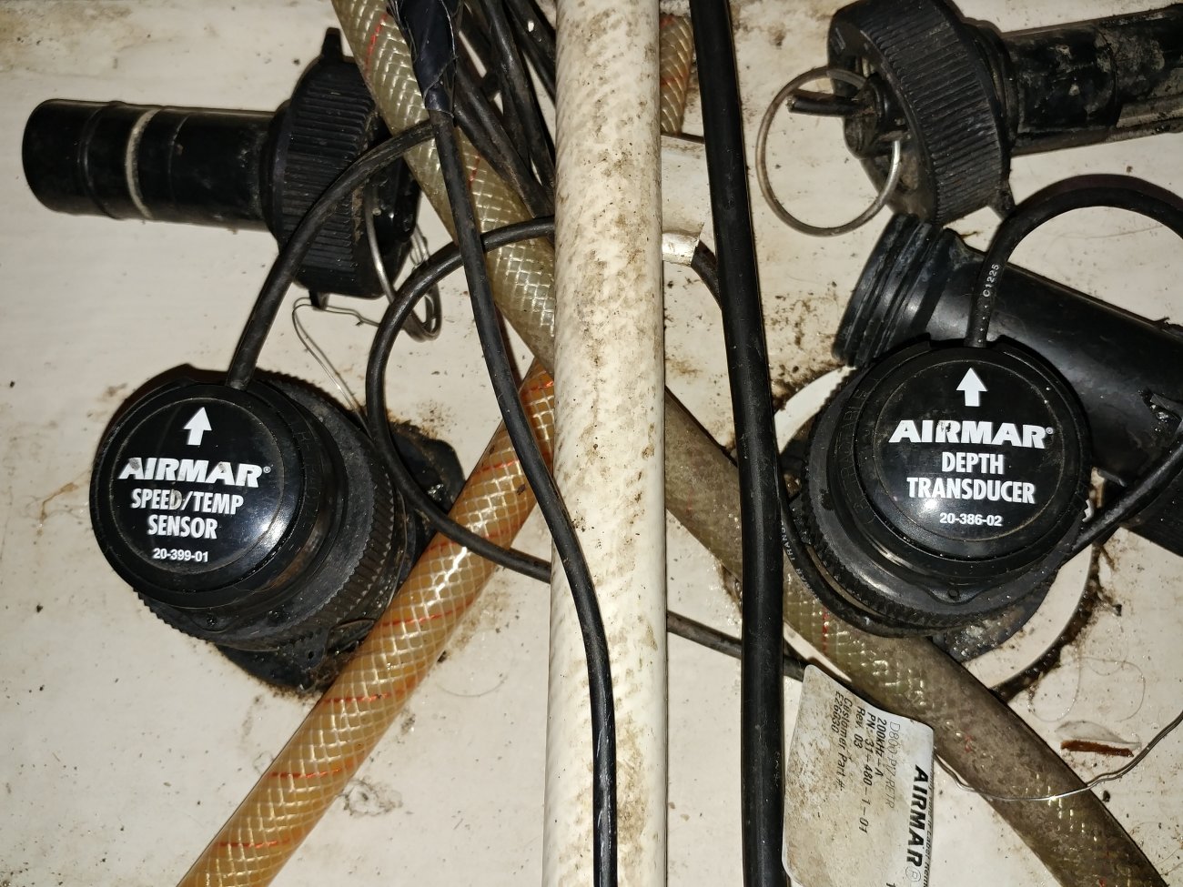

Thanks, for the feedback. I also pulled the speed transducer, ya the water was pretty exciting! Plug in hand and seemed to seal it up while I cleaned the wheel, which seemed fine. Maybe the hull needs to be cleaned so I'll try that next time out.

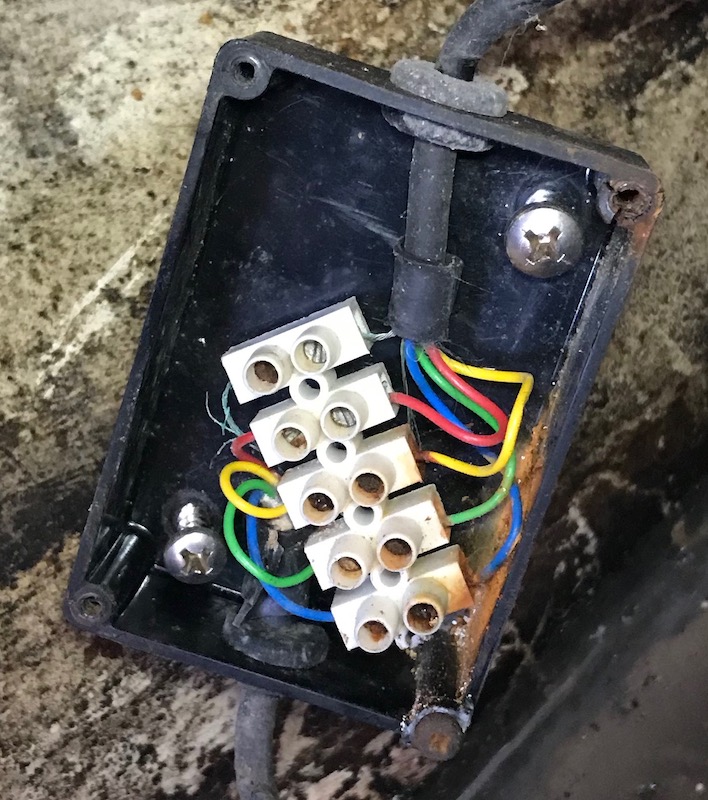

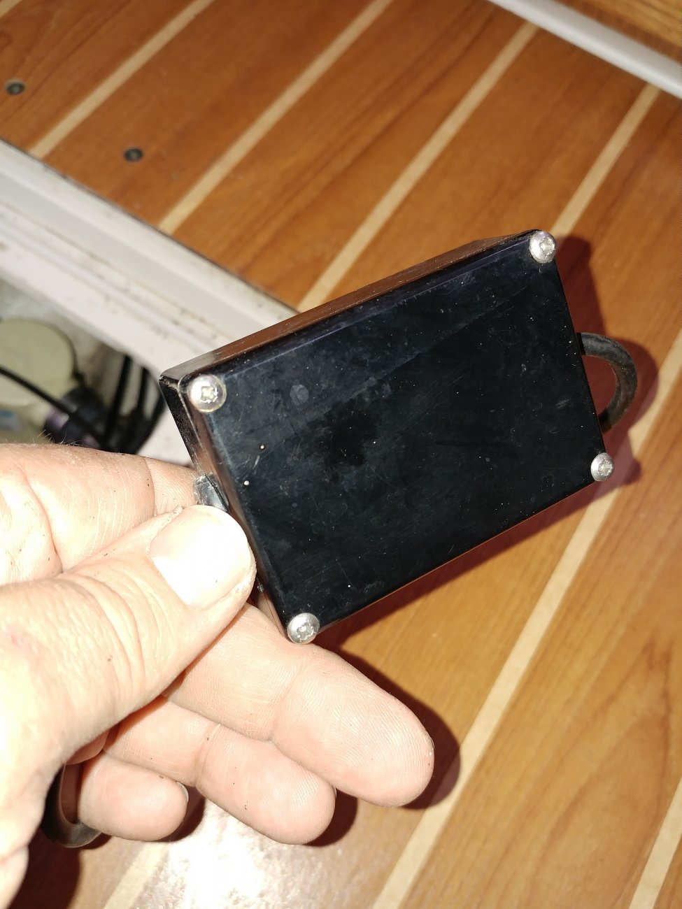

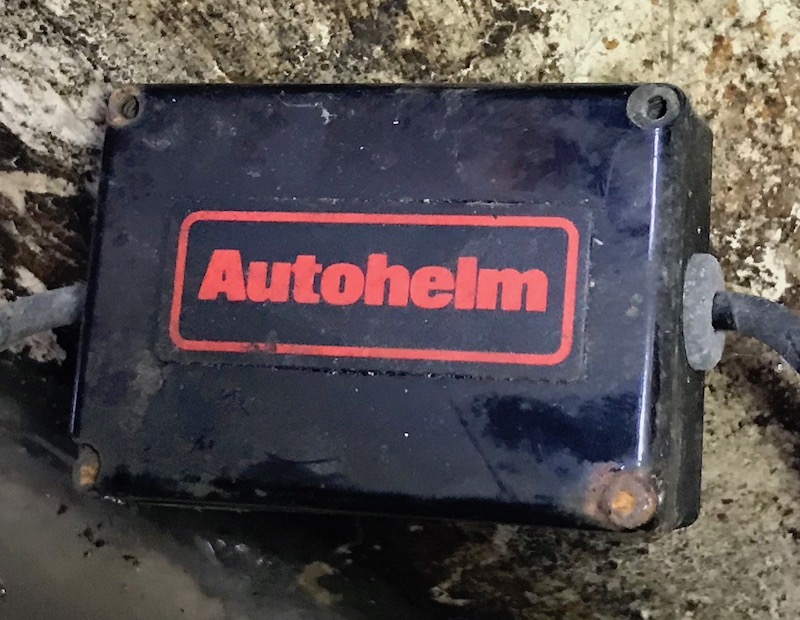

I also found this box with a wire that seems to lead to the compression post and lead aft. No info or anything on it. Any ideas, is this for the mast instruments?
Nov 16, 2012
1,055
Catalina 310, 2000, #31 31 Santa Cruz
Maybe a splice box for the wind unit, assuming it was replaced at some point. I'd open it up to see what's inside, but that's my nature-taking things apart.
In salt water there are often little critters that like to hide in the depths of the sensor. A quick dip in fresh water makes them leave, at least for a while. Not sure if the same thing happens in fresh water...
Was it a real fountain of water? If so then the sealing flap may be AWOL. Something to think about replacing when the boat is next hauled out. If you only got a quart or less then no big deal, especially since it's fresh!
I have found that my flap is only about 50% effective - the force of the water seems to open and close it so I get a pulsating fountain when I pull the speedo, at least until I can get the plug in place.

It wasn't bad, I read a bunch, knew what to expect, told my slip neighbor if he heard loud yelling to come running with a hand pump:) It was up a bit but went down as soon as the sensor was all the way out. I noticed the sensor had been replaced and that it was spliced to the original wire. I pulled the tape off and check the connections, not issues or corrosion so I wrapped up and made sure to put the bundle forward and high so if there was a leak it would stay dry if the bilge pump could handle it.
John,
Last week I finished installing all my new instruments and everything worked but the wind transducer. I remembered seeing a similar box in the forward area of my bilge but at the time a PO mod over half the bilge cover prevented me from getting to it.
Now I had the motivation to undo the PO mod and get to the box. It was a wiring junction box for the wind transducer cable and the wires were corroded. I used an Airmar barrel connector and the wind data came to life.
Here's a photo of the box and what was inside. (excuse the dirty bilge, that's next on my list)

Cool, find, I'll have to open it next time out to see what I have. Seems a bad idea in this potentially damp space, that said my only water source in my bilge is AC condensation and the weird occasional water in the after section from the fridge which I think builds up condensation when off and if I forget to drain it overflows into the bilge. Just a theory right now as that seems to be the direction the water comes from, it isn't consistent, but the water is cold and very clean.
