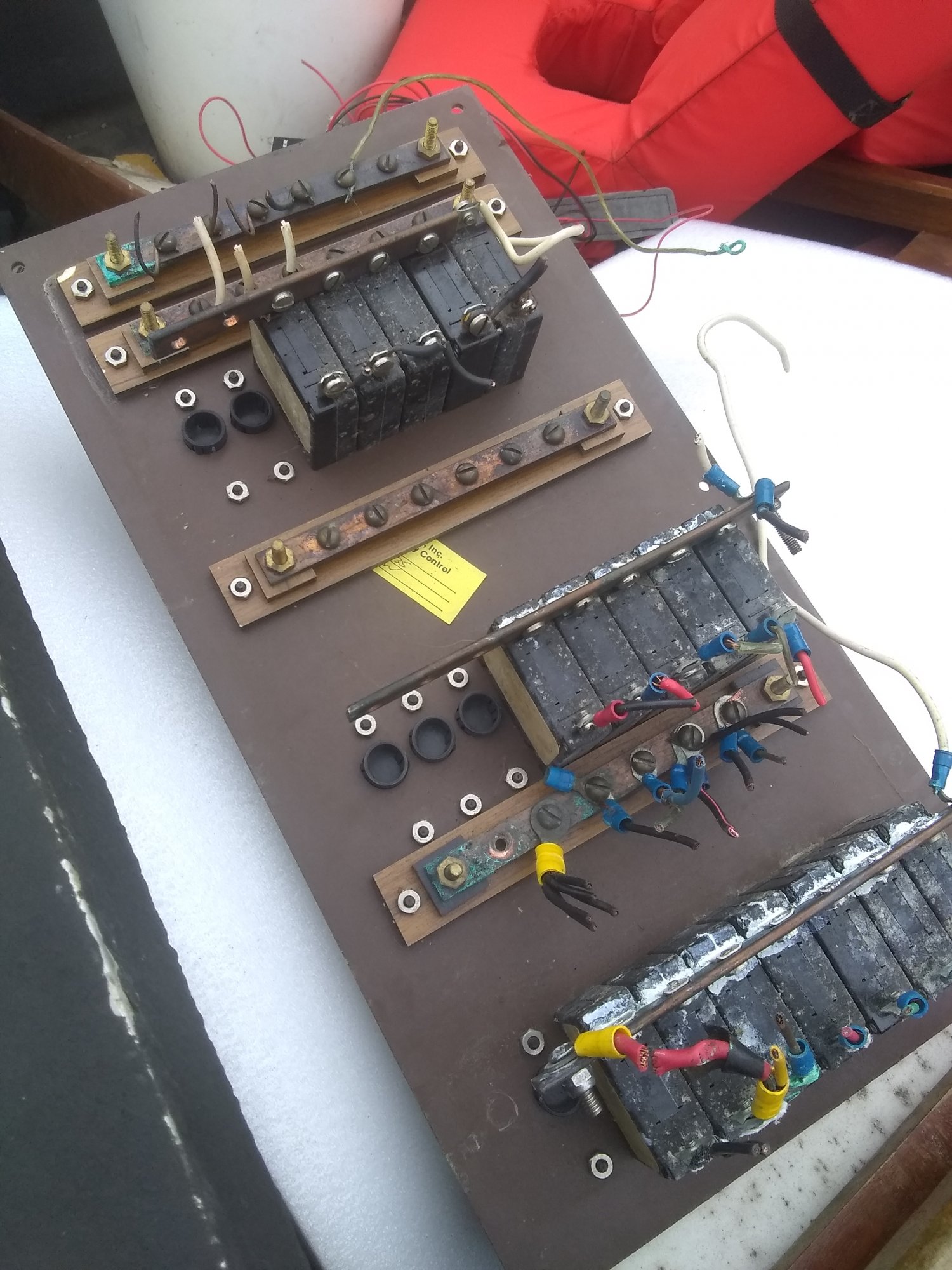

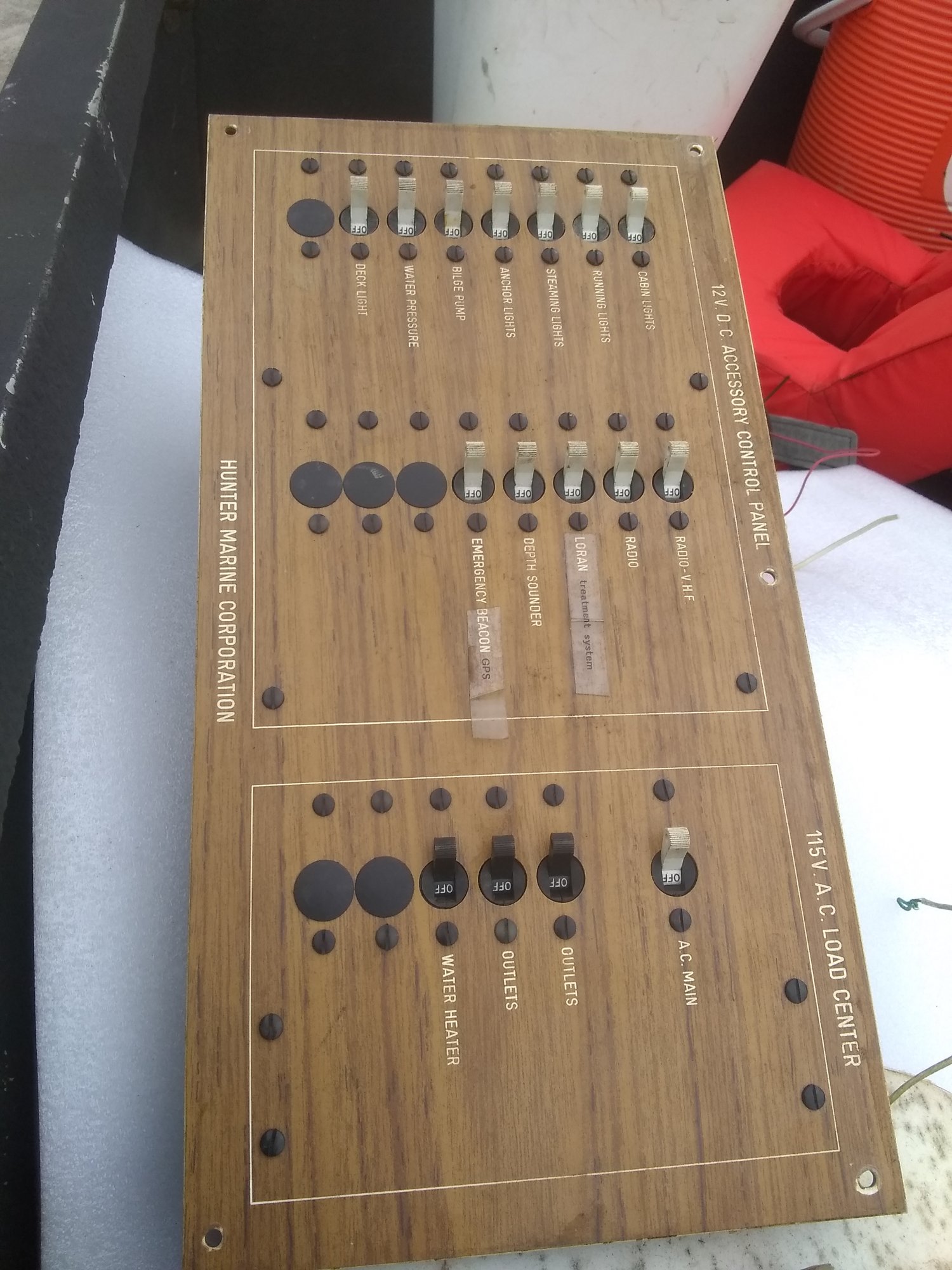

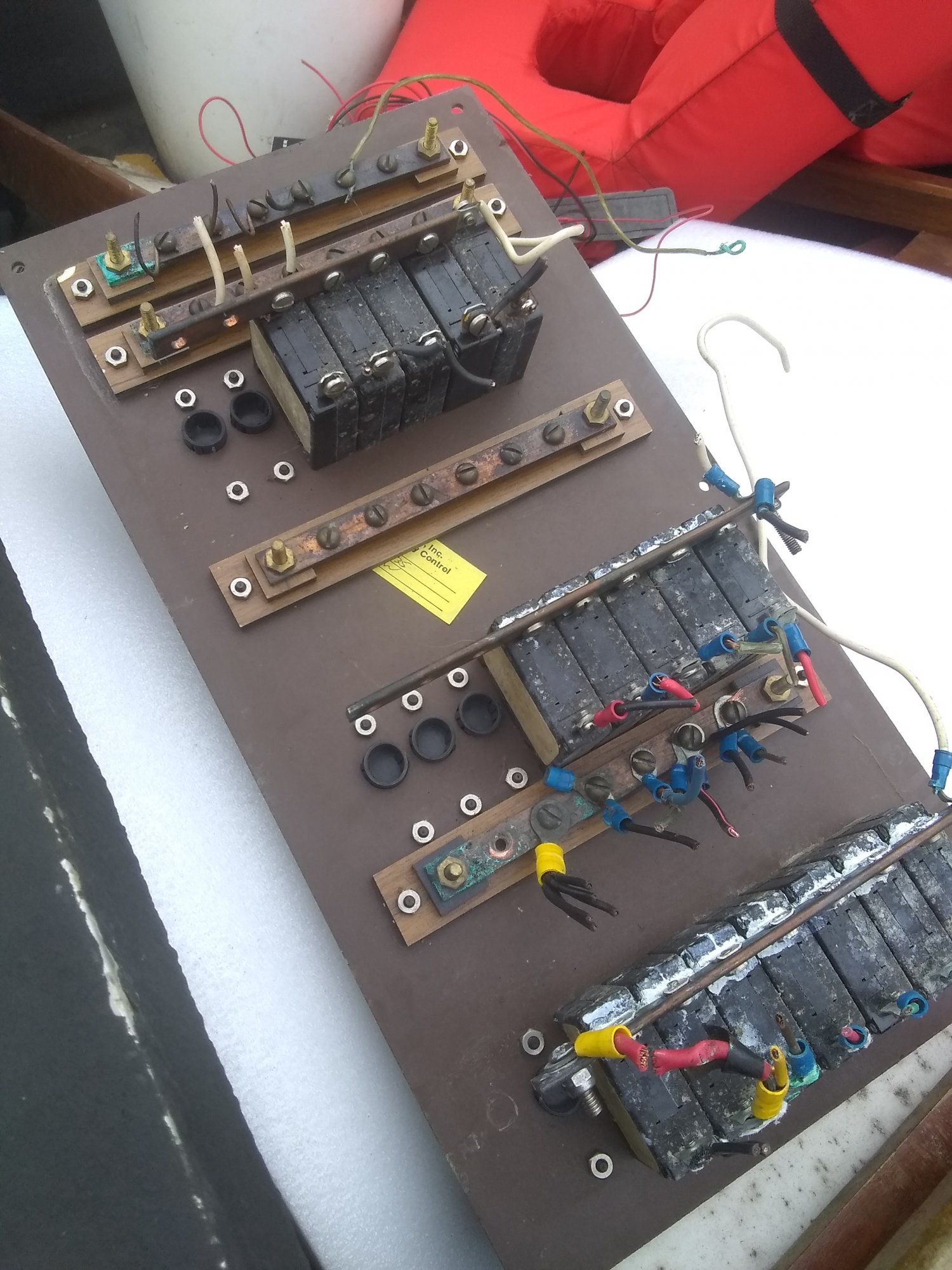

Posted the switch board which I yanked out. Plan on buying a more simplified master as I want minimal electric on board. Maybe I will repurpose one set of the bus bars and switches if I test them and they seem good. Any feedback on whether I should salvage or pitch it is appreciated. I am not using a/c or shore power at all.

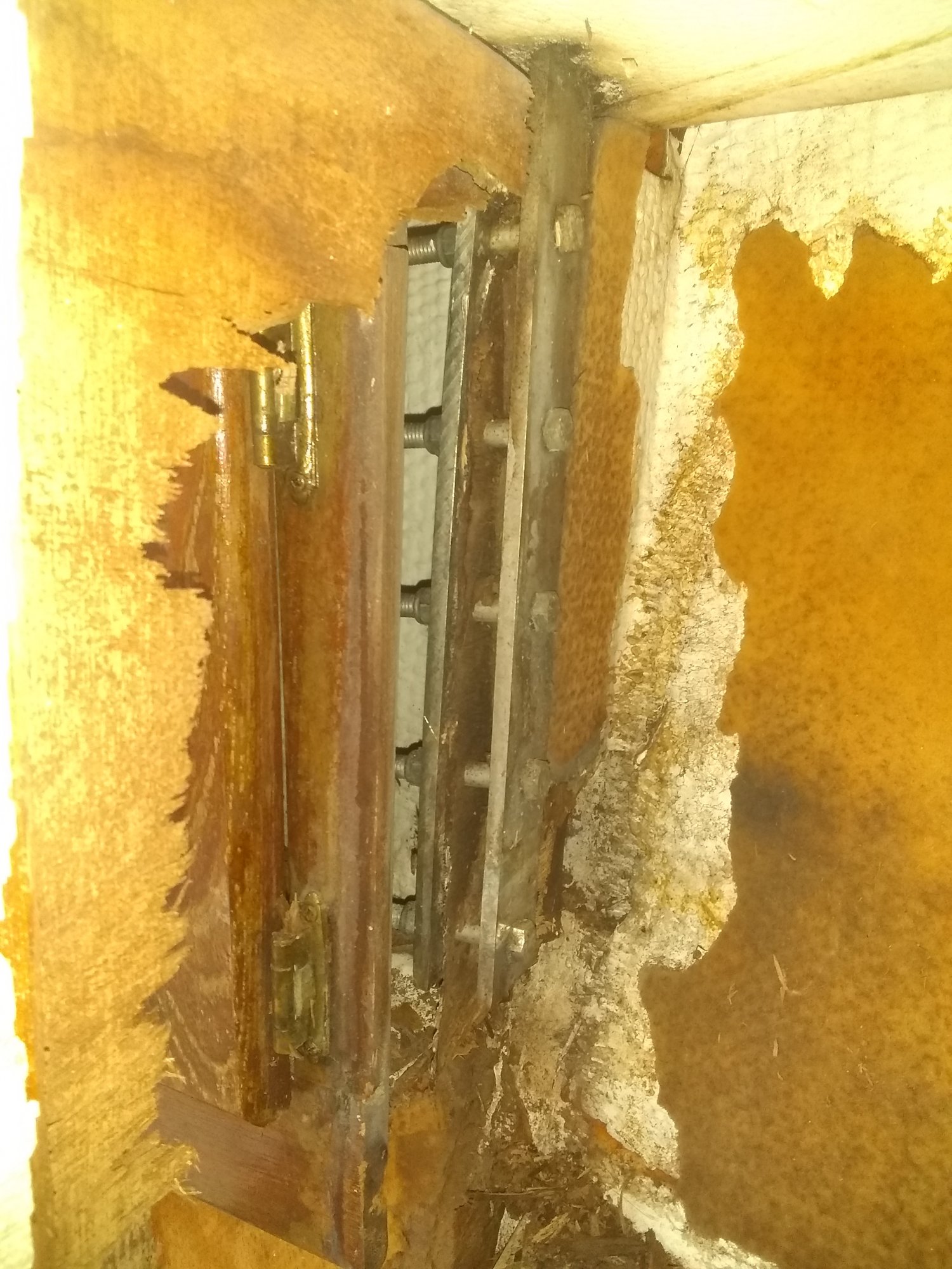

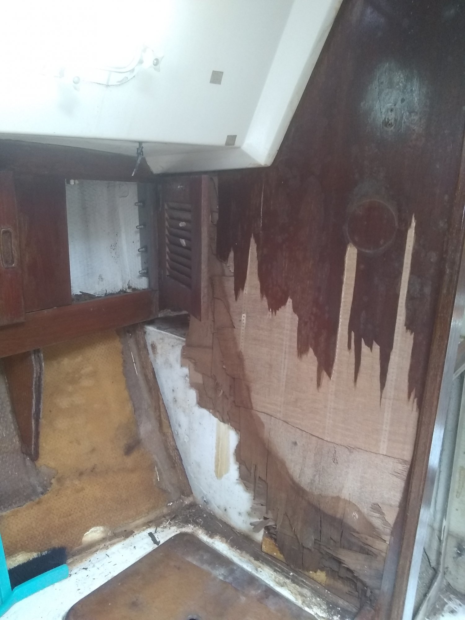

Ripping everything rotten out. Forward port shroud chain plate with literally no wood left and only some fiberglass holding it in place, shroud is hand loosened.
Bulkhead aft of said chainplate is also rotten and will be replaced.

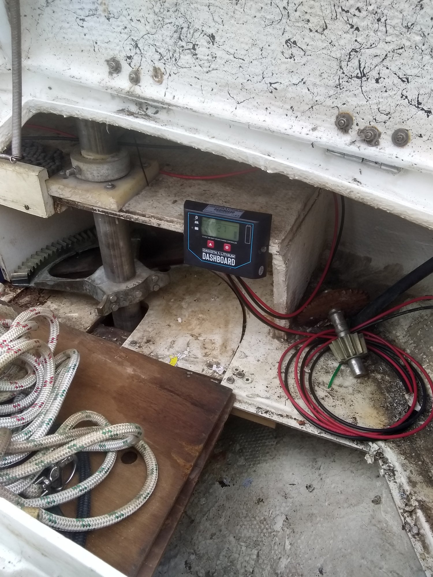

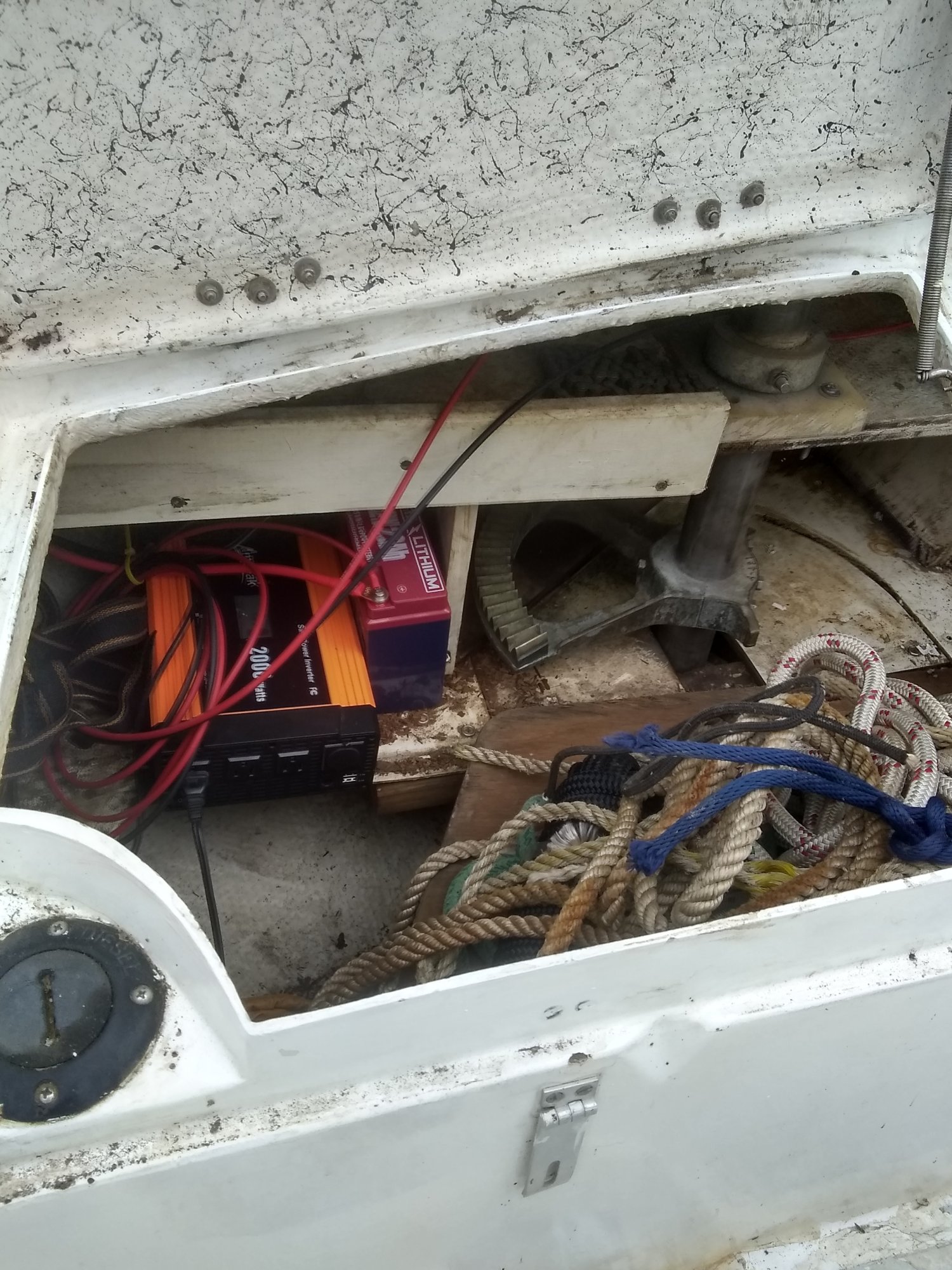

Temporarily set up the solar power in the aft compartment as it stays dry and I put the panel up on the Bimini rails. I am using the power to charge power tool batteries and keep my starter battery charged. But I am going to pull out the yanmar and rebuild it on a table.

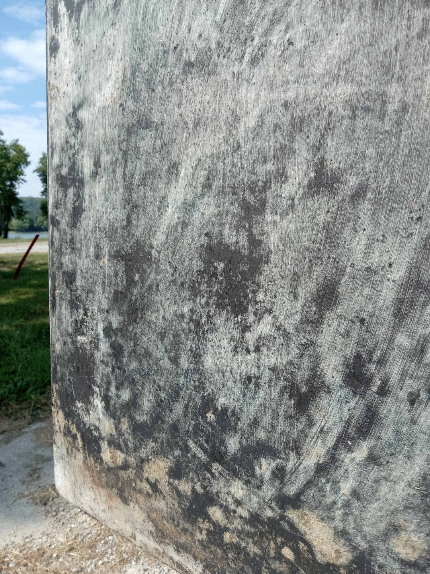

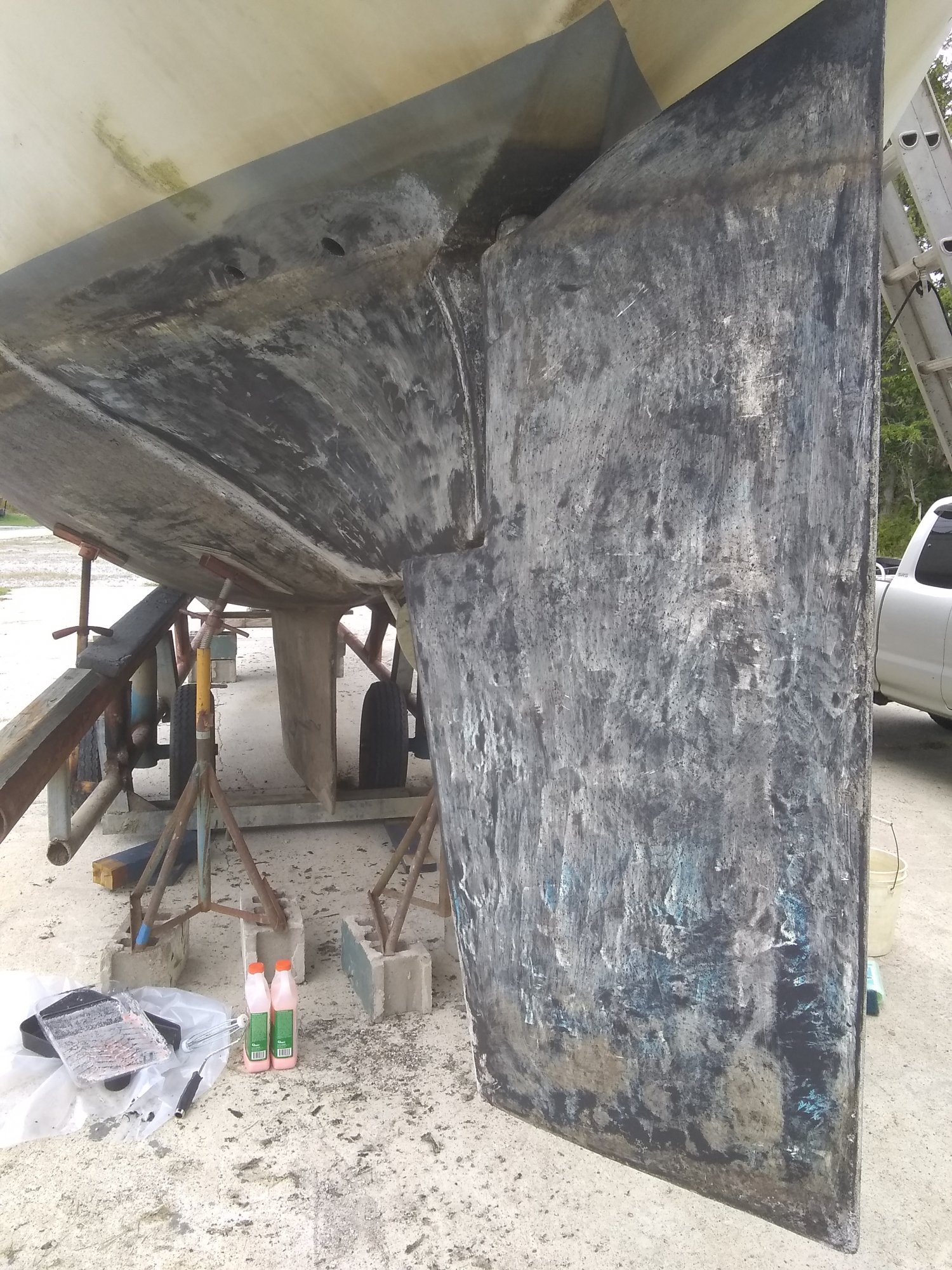

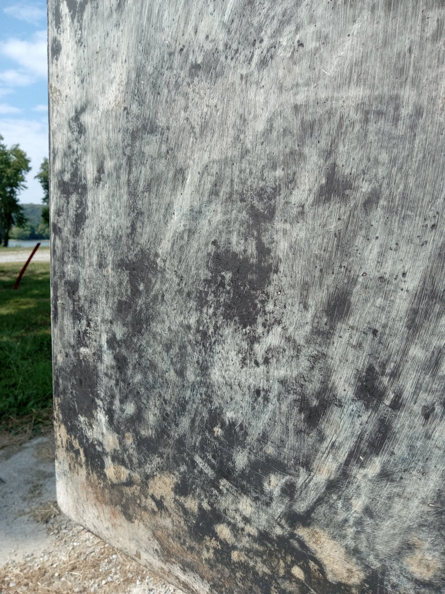

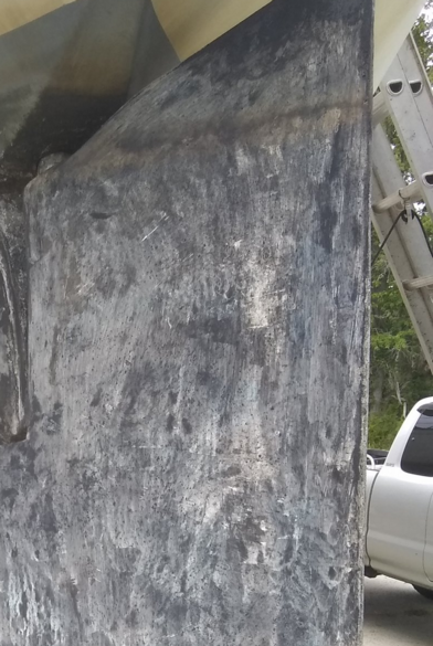

I don't know? The black came off and this is what was under it. I have not done any sanding yet.

The black came off
I presume the black was only the black bottom paint as Citristrip isn't going to attack either epoxy or gel coat.
Now you're at the crossroads ..................... what do you intend to do with the hull bottom ? If you have a good solid epoxy coating on the bottom, you're lucky and can lightly sand it and proceed with bottom paint. If it's gel coat, is it solid enough to lightly sand and bottom coat. You're going to have to make some decisions here which could impact you're future work on the hull.

How do I know if it's epoxy or gelcoat? Is there a test I can do to the surface? I figure doing this first strip will take awhile and I can research more about what bottom paint I want to use.
14,244
The boat is not made of epoxy, it is likely polyester resin and glass. If there is epoxy on the bottom, it will be a barrier coat to prevent blisters. Gelcoat is usually white. If you sand through the gelcoat you will see the polyester resin and glass, it will e quit obvious. Citristrip is safe for gelcoat so it will not remove it. Gelcoat has to be mechanically removed by sanding, grinding, or soda blasting.
So I can sand the black and blue off down to all white everywhere, and then prep for new barrier coat or just new bottom coat? I've only found one blister so far and will remedy it.
14,244
Yep. The fiberglass usually has a slight blue tint to it, but it doesn't look anything like blue bottom paint.
Jan 4, 2006
7,843
The gel coat on the bottom of the hull flows into the gel coat above the water line hence the same colour.
The epoxy barrier coat I applied was a gun metal grey. If you have a epoxy barrier coat, it will unlikely be the same colour as the gel coat above the water line.
If you plan to pour your heart and soul into this boat, I would ensure it has a sound barrier coat even if it means applying a new one. So far you only show one blister and it would be nice to avoid any others into the future.

Excellent! I did find some grey just above the white so yes to the gelcoat layer. I will carry on with the citristrip and scrape and sand so it's all white, do repairs and I'm looking at silic one bottom paint system.
