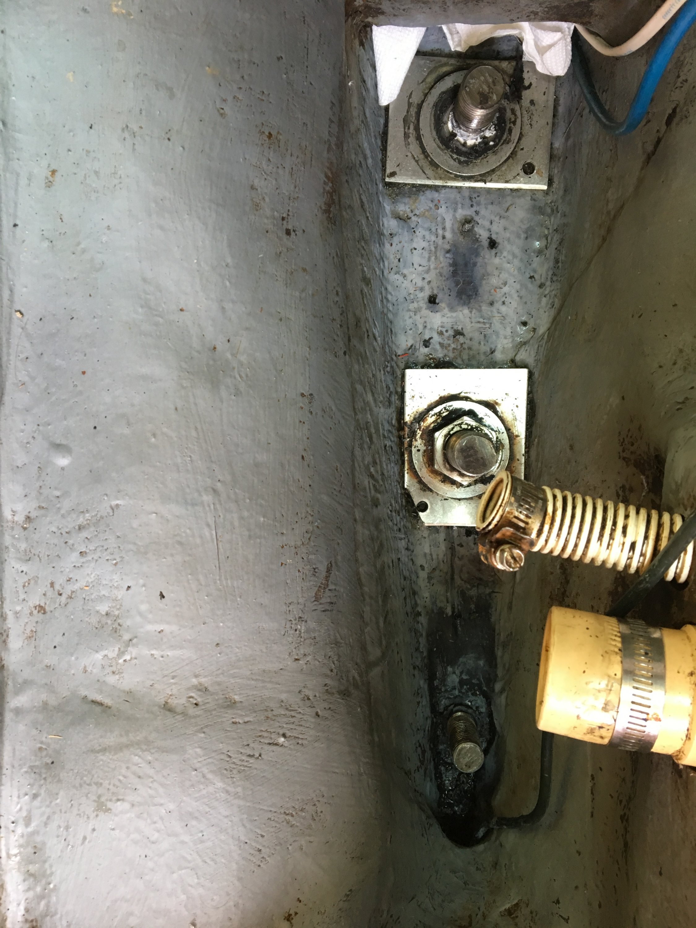

So after closer inspection not pristine after all.

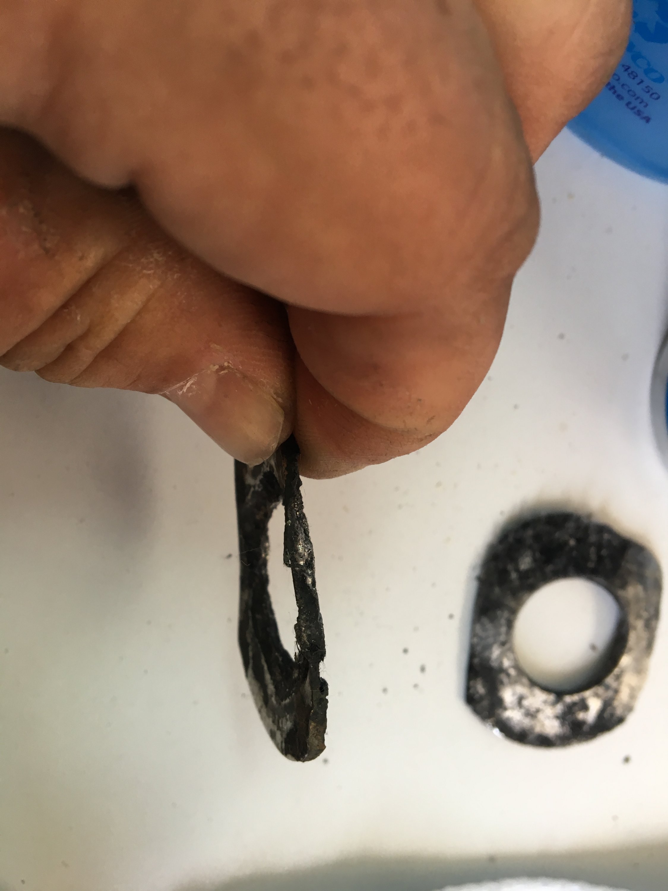

I’ve removed the small nut and one of the big nuts. I’m not happy with the small nuts washers they are compressed and corroded See picture.
I’m thinking of having a single stainless plate fabricated to conform with the bilge area for the aft 3 bolts. If I do this I’m thinking of bedding it in G flex epoxy. Any thoughts on this? Is G flex the right stuff for the job? Any opinions would be appreciated.
10,206
heavy plate, like 3/16 or 1/4".. G-Flex is fine..
Carefully inspect the trace that looks like a crack that starts top right by blue wire and goes diagonally to under the middle bolt.. may be cosmetic, but check that out carefully.

Is the small one with the damaged washer on the forward or aft end? Has there been a hard grounding? Inspect inside and outside for any signs of cracking in the resin or gelcoat. Clean up around that small stud and check for cracks, also check very closely around the stud at the opposite end.
It may just be the large nuts have not been torqued properly through their life and the load was transferred to the small stud which caused the damage to the washer you are seeing. If that is true, and there aren't any signs of damage to the laminate, torqueing everything up to spec could fix this issue. Don't be too optimistic in your inspection though, you don't want to find out the hard way there is a structural problem.

Thanks! The small bolt is aft. There has been a couple bumps over the years but none in the last 10. No damage on exterior noted. I’ll do some more digging tomorrow and post the results.

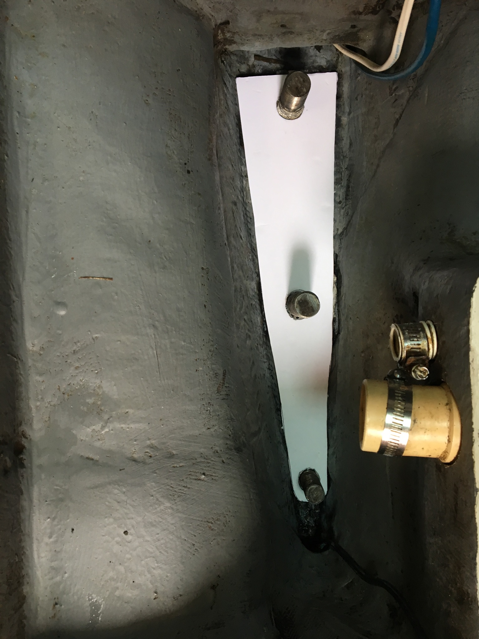

I inspected the keel sump area in and out and am glad that what looked to be a crack in the picture I posted is actually just inconsistencies in the fibergalss layup. I’ve made a template and will have it made up this week.

Looks good Josh. What material are you using for the plate?
DArcy
Feb 11, 2017
1,786
Islander Freeport 36 Ottawa
1/4 inch stainless steel should be enough, if you like to be one or two sizes more than enough :) Are you using 316 stainless? 316 is a really good for corrosion resistance but not generally used below the water line. It looks like this is an easy area to inspect so just keep an eye on it, especially if there is standing water in your bilge.
Yes, we just ordered a piece of 316. There is usually a bit of standing water but the existing smaller plates lasted this long so I should be good.

One more note on a problem that I uncovered on my 322.
The rear keel bolt was not bonded. I never thought about it before this project but now think it presents a problem. The three larger bolts have plates that are bonded. I think the lack of bonding contributed to the poor condition of the washers on the small bolt due to electrolysis.
My fix will address the issue because I’m bonding the new stainless plate. If I wasn’t doing this I’d probably add a bonding wire to the top of the smaller bolt with a second nut.
