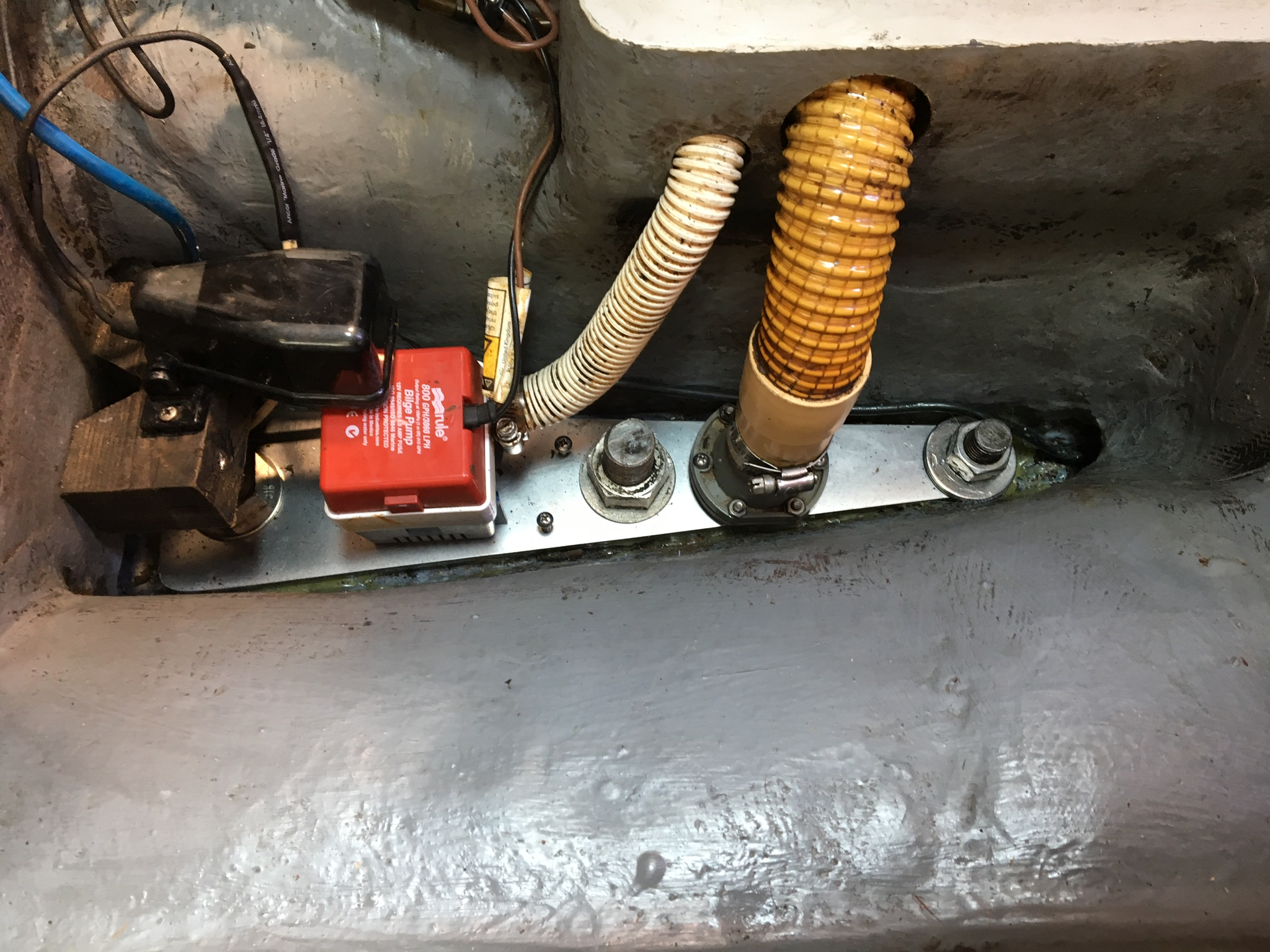

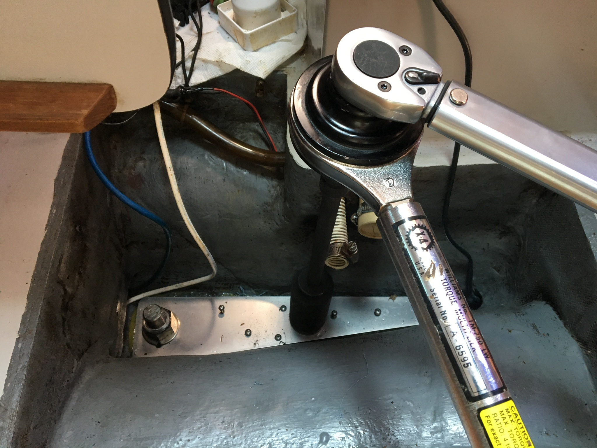

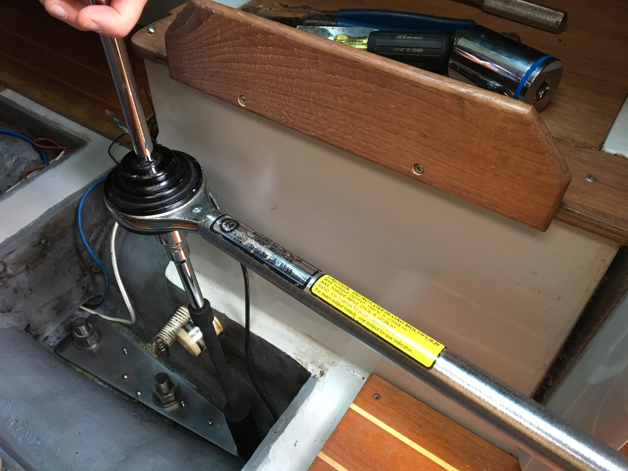

The rear small bolt takes 1 1/8 extra deep socket. I bought Sunex 236xd. The front three take 1 1/2 extra deep socket. I bought a Sunex 248xd. You will also need a 10 inch extension Sunex 2510 worked for me. I originally tried an extension bought at autozone and it was really wobbly.
Thanks Josh. The PO left me a large socket for the 3) 1” bolts, but my deep well sockets would bottom out before getting on the nut. I didn’t want to buy an extra deep socket in the wrong size.
I do have the 1/2 “drive extension and was able to get about a 1/4 turn on the larger bolts before I splashed. Will get a socket for the smaller one and see if it can be tightened.

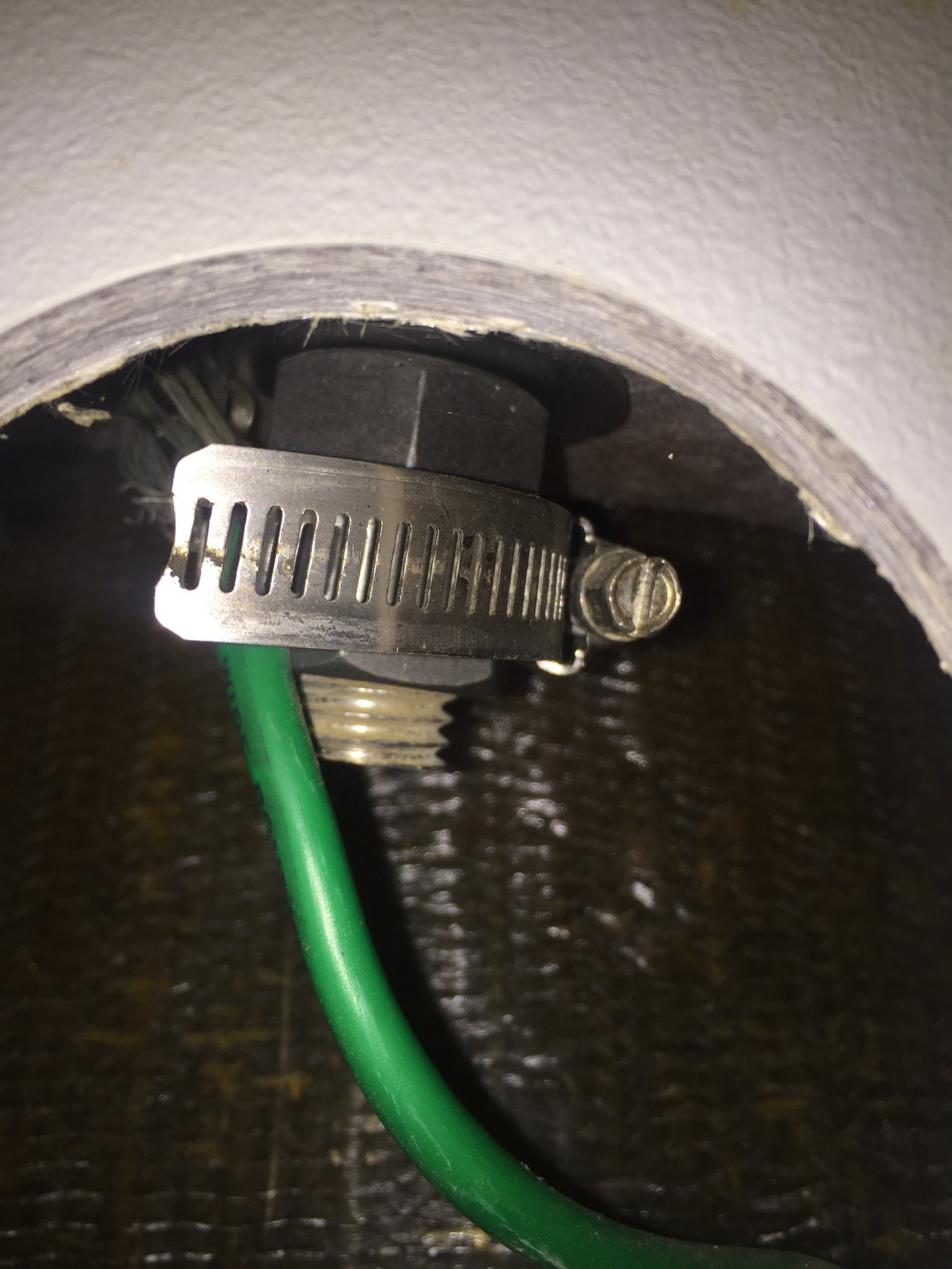

I don’t think all of my bolts are bonded.
My thought was they were putting a pathway from the mast and shrouds to the keel....what is the purpose of grounding all the keel bolts?
The grounding connections to the chain plates look a bit cheesy to me...no sure if that hose clamp is the only thing holding the bonding wire or if the wire is sandwiched between the 2 nuts...but either way, seems a bit weak.

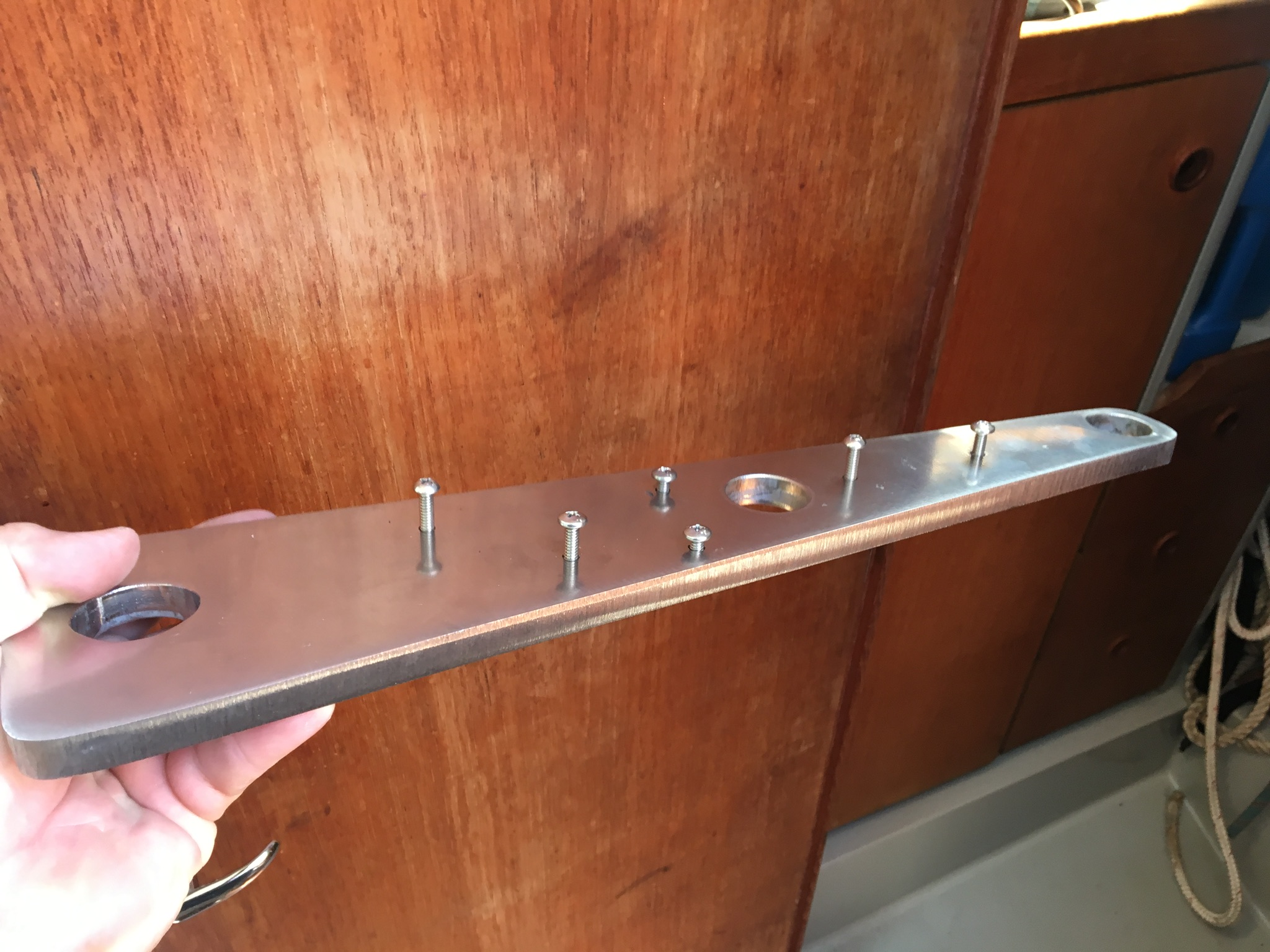

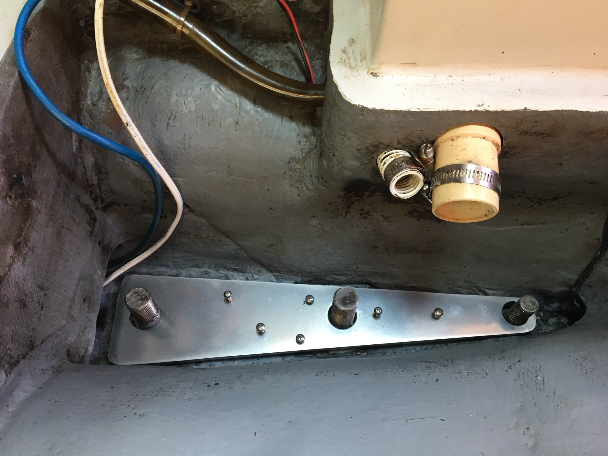

Well that looks very beefy!
Did you drop the keel to check the bedding and state of the stub keel?
