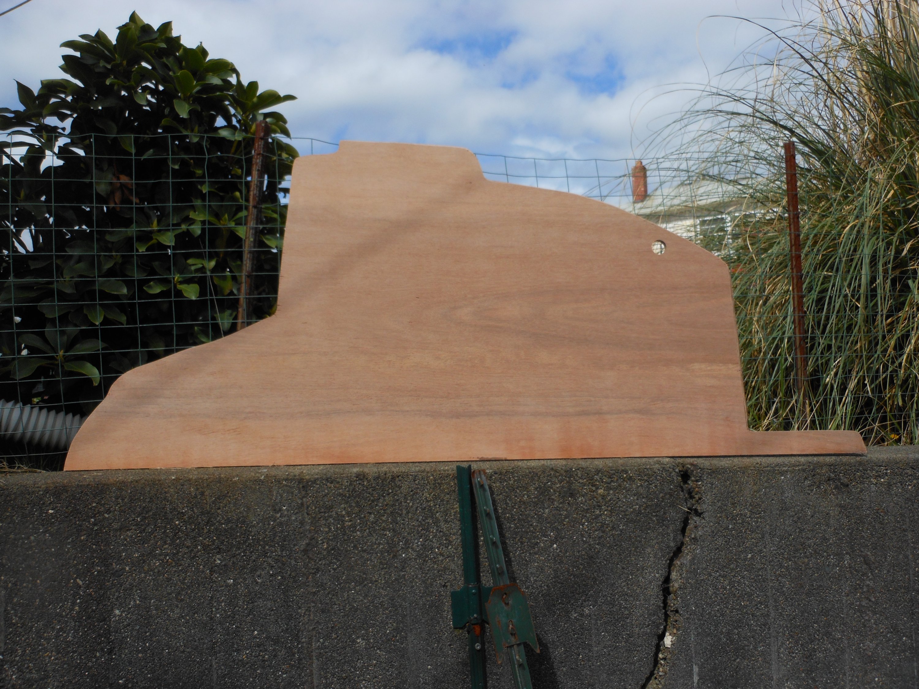

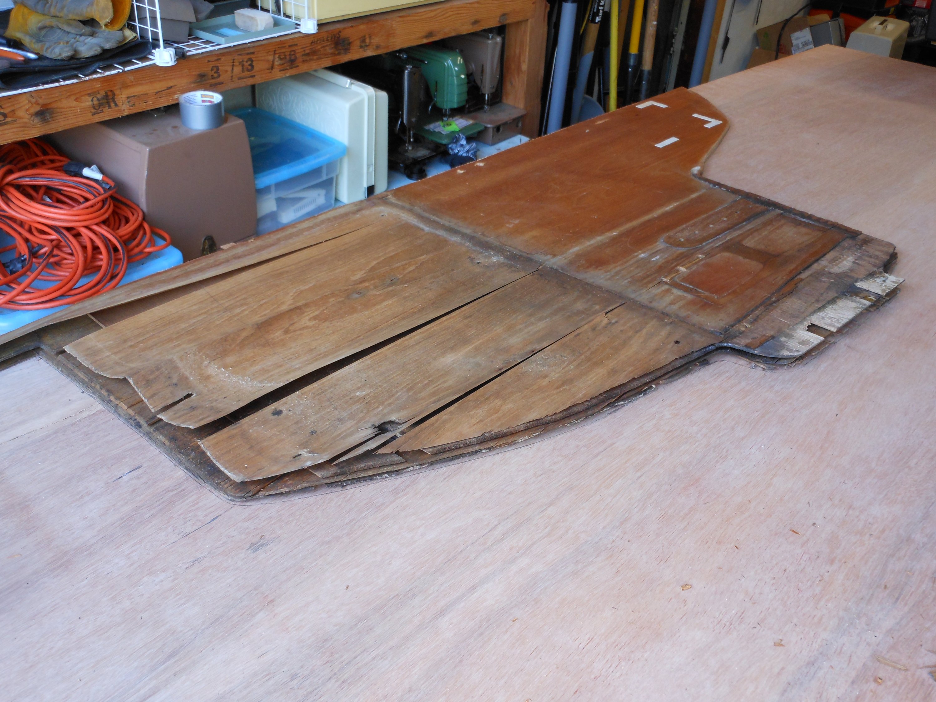

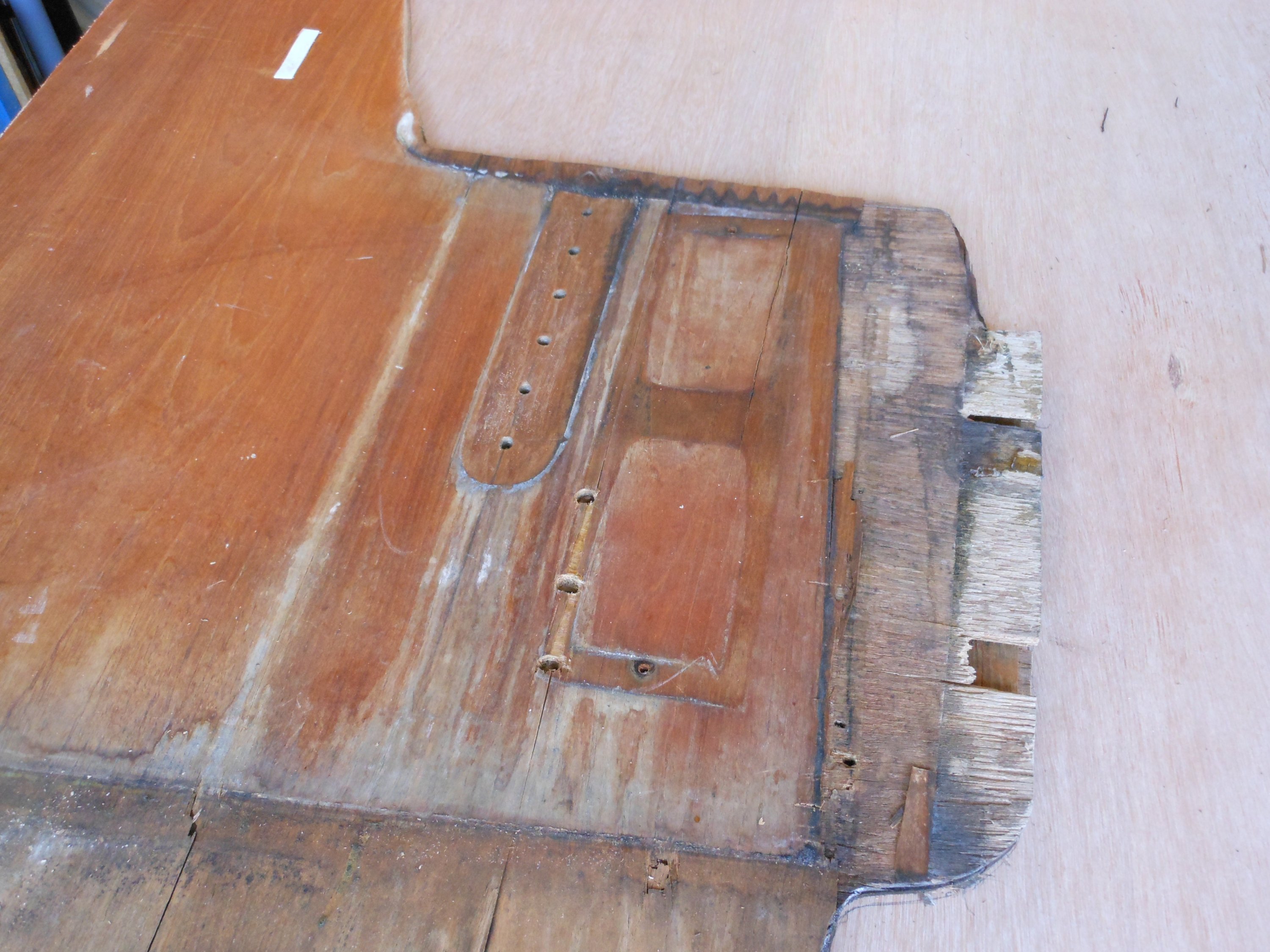

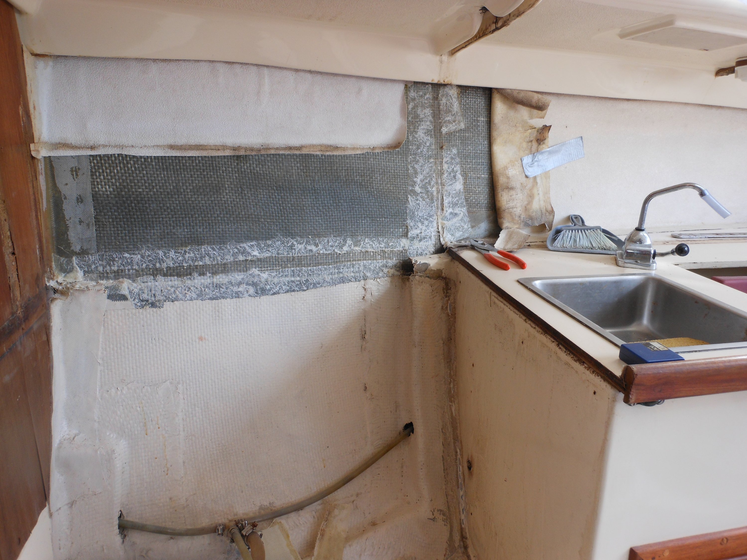

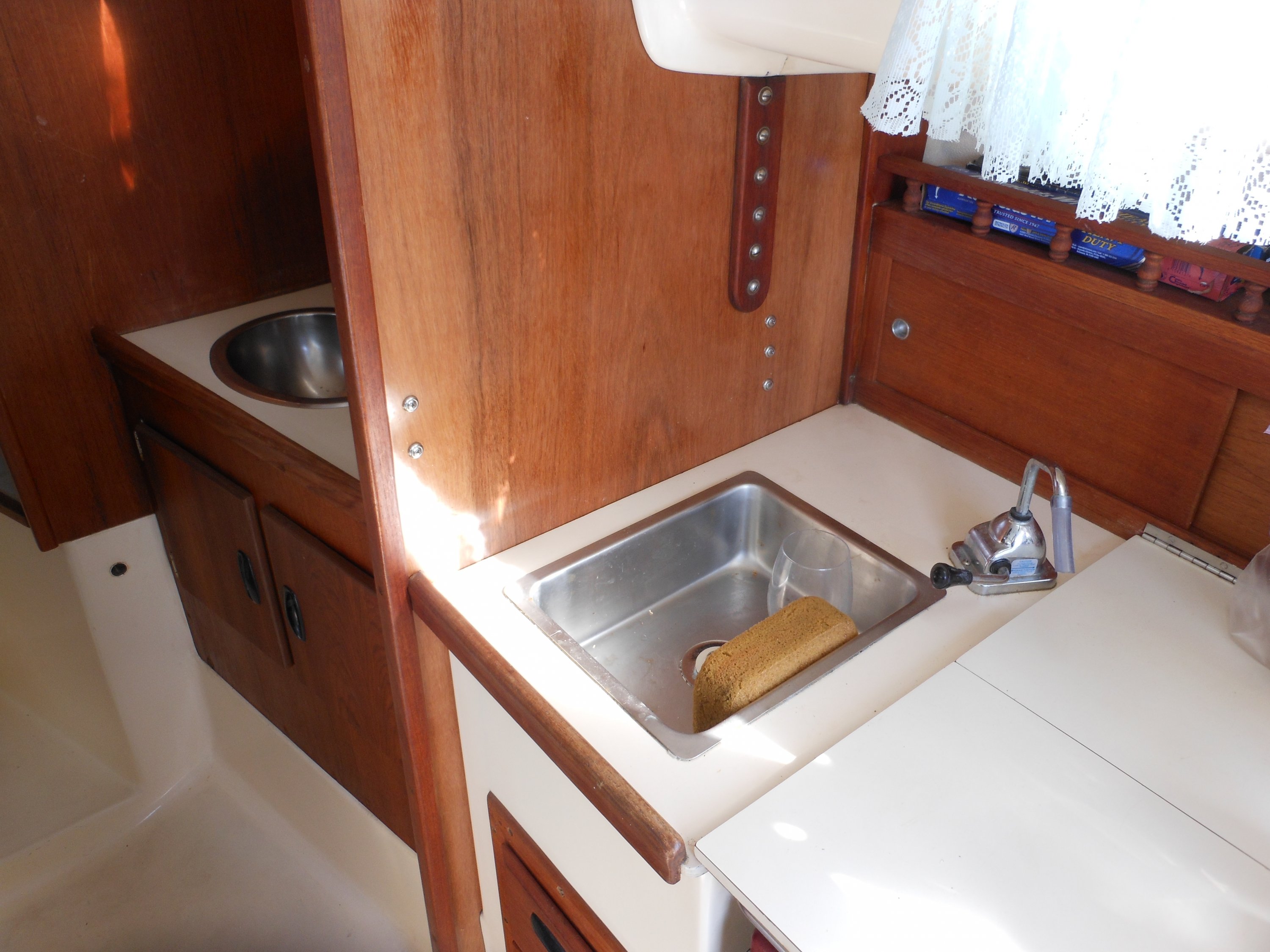

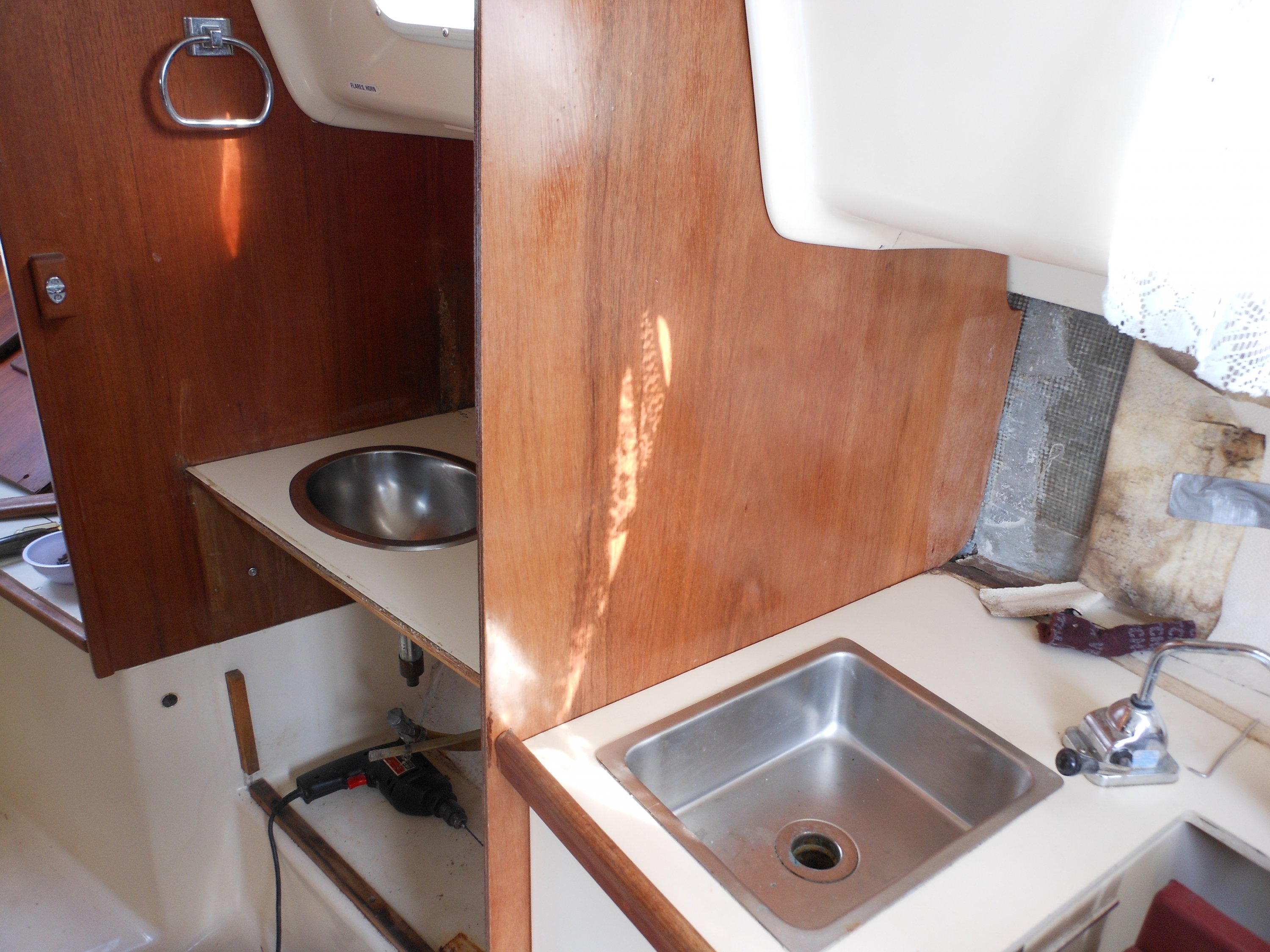

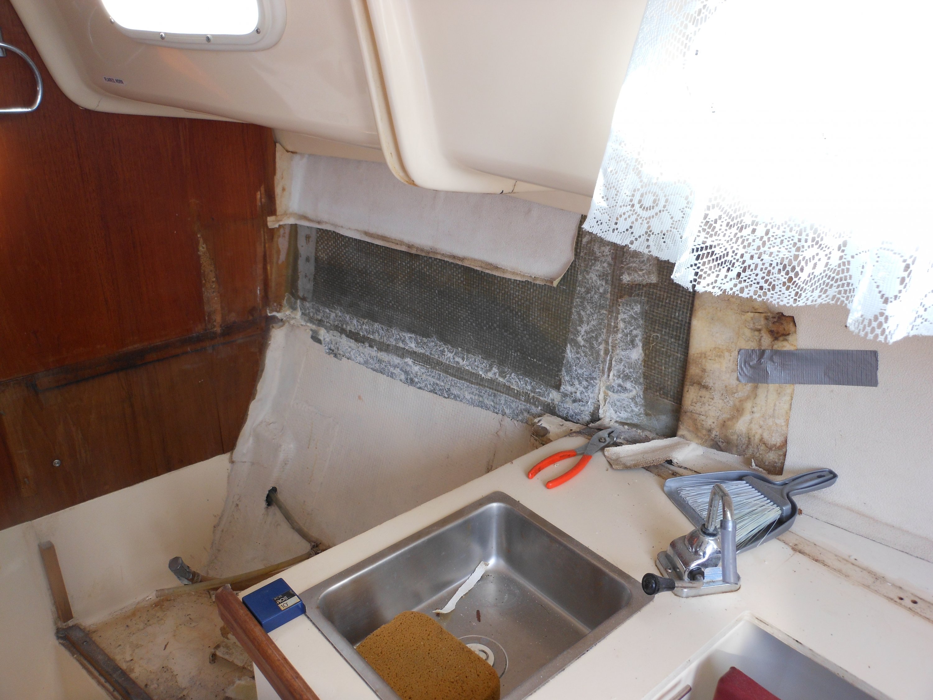

Some photos of my starboard bulkhead replacement. I did encapsulate the new bulkhead in epoxie before installing it. image.jpeg image.jpeg image.jpeg image.jpeg image.jpeg image.jpeg image.jpeg image.jpeg image.jpeg

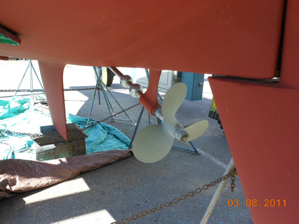

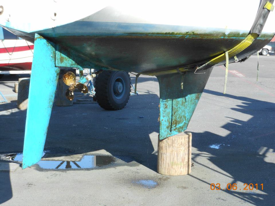

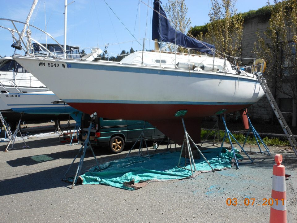

Hear are a couple pictures of my boat below the water line. Give you some idea what you would be up against to convert to an inboard.image.jpegimage.jpeg

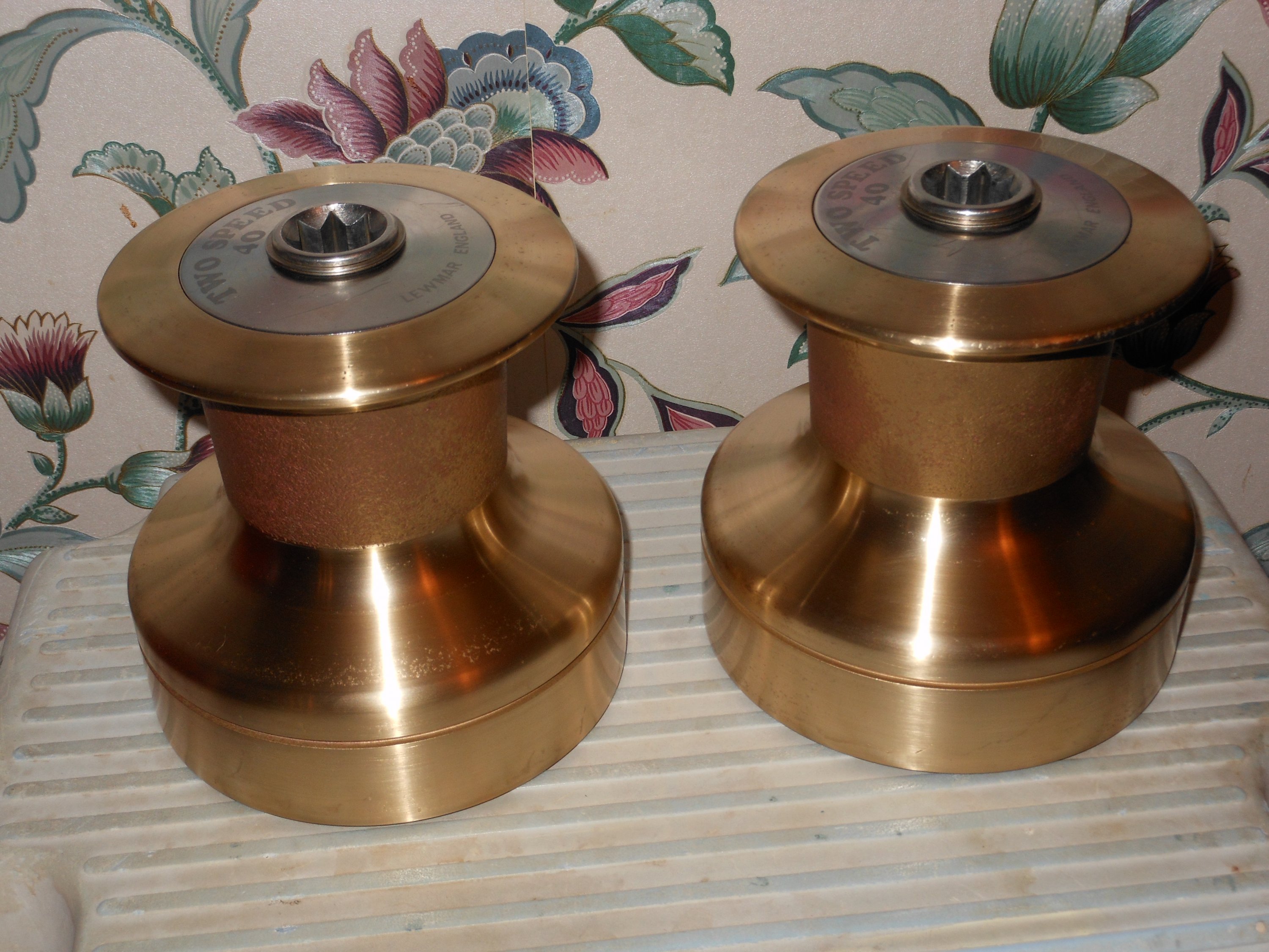

I did find the original sheet winches to be a bit small so I upgraded to lewmar 40 two speeds that I got a killer deal on. image.jpegimage.jpeg

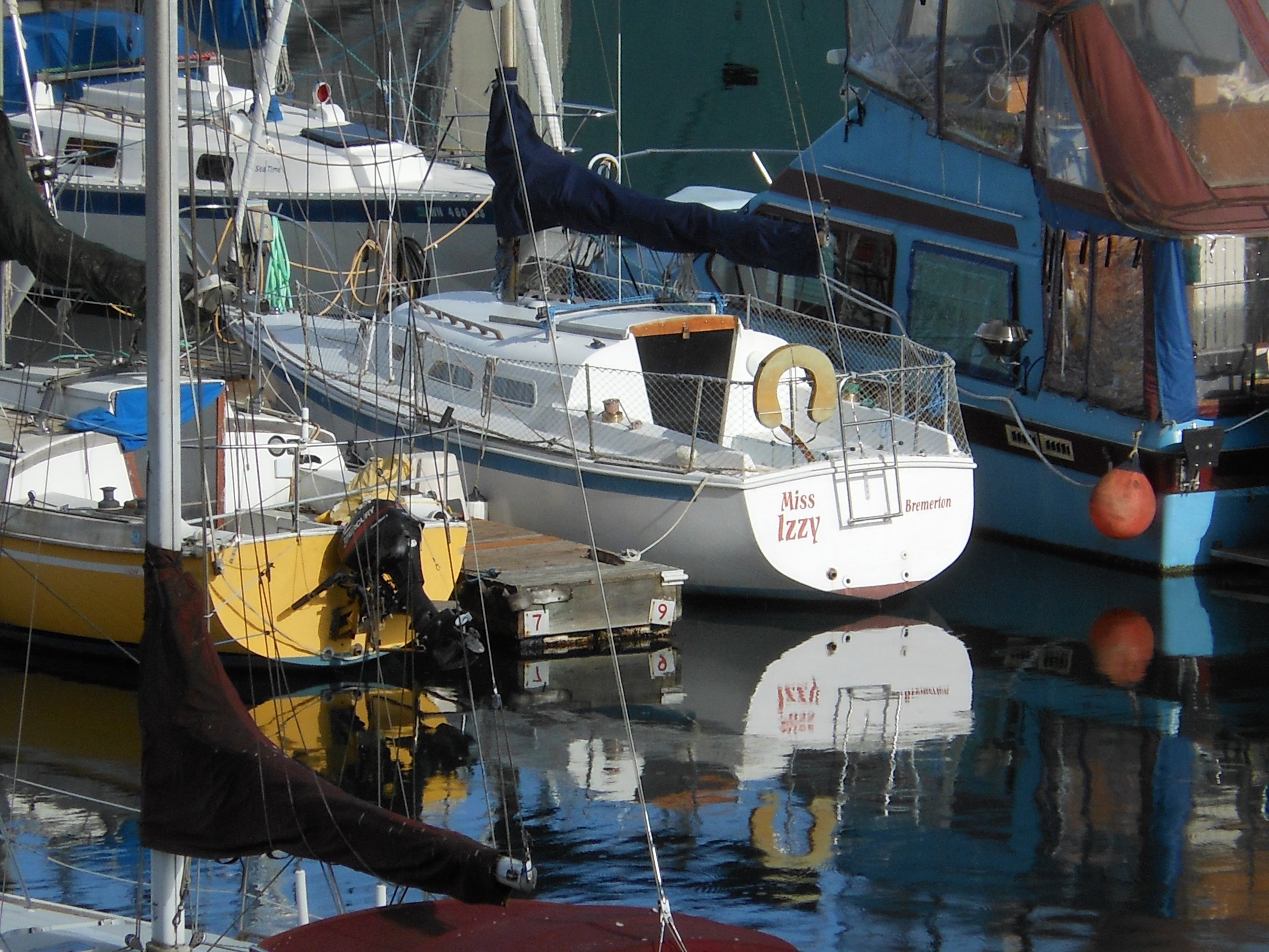

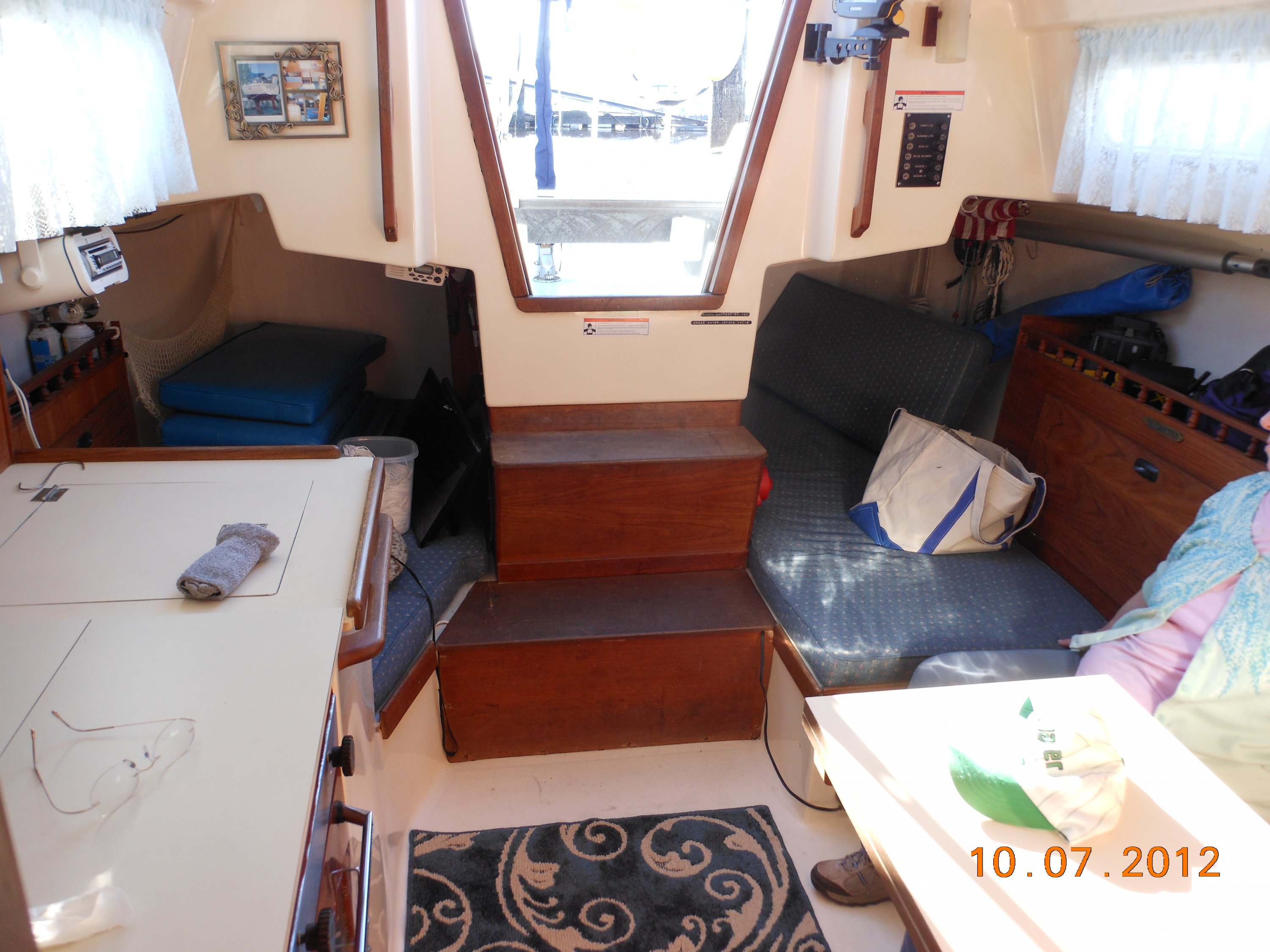

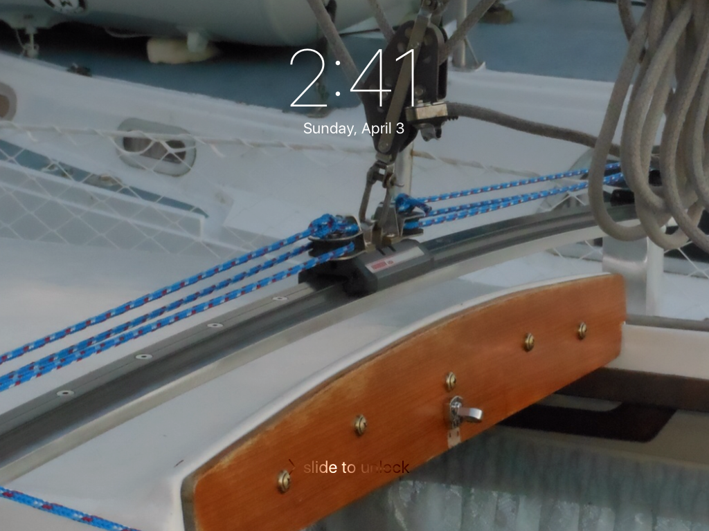

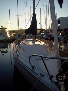

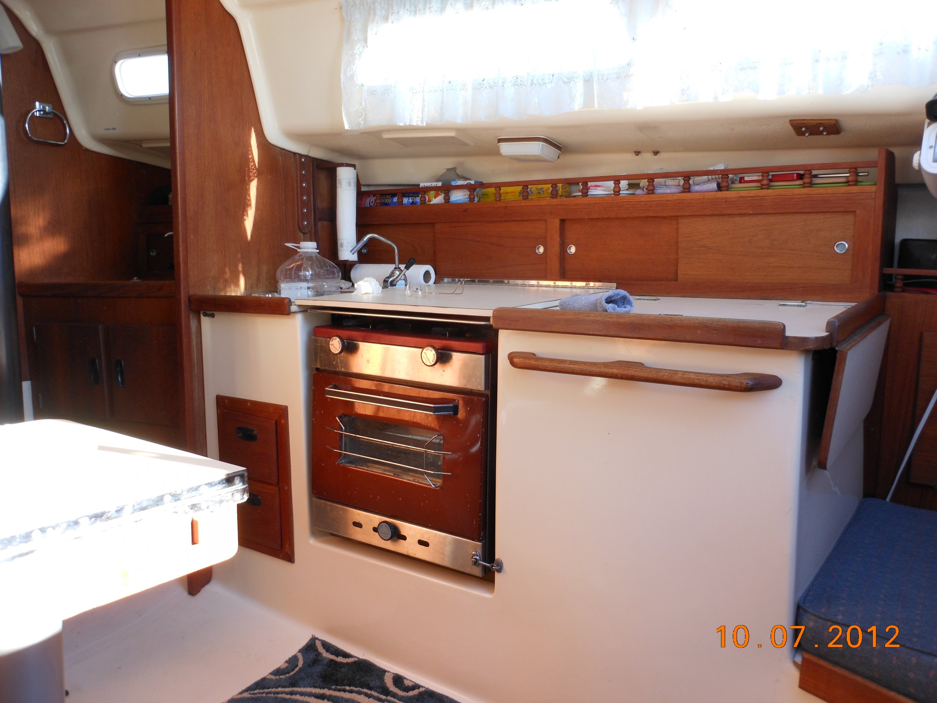

Some random pics of Miss Izzy, she is also a 75. She is pretty heart worn but is still as shippy solid little boat. I moved the main sheet traveler to the cabin top, added lazy jacks and a halyard winch for the head sail.image.jpegimage.pngimage.jpegimage.jpegimage.jpegimage.jpeg
