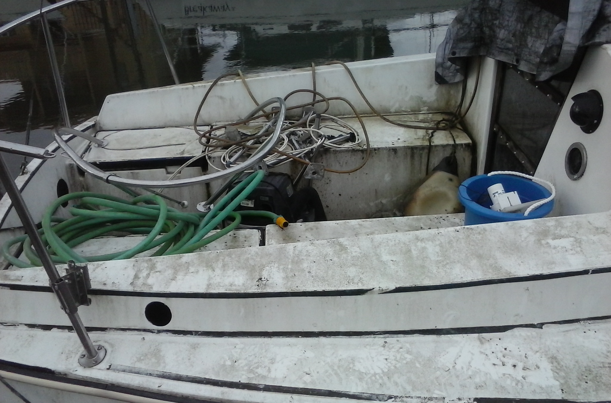

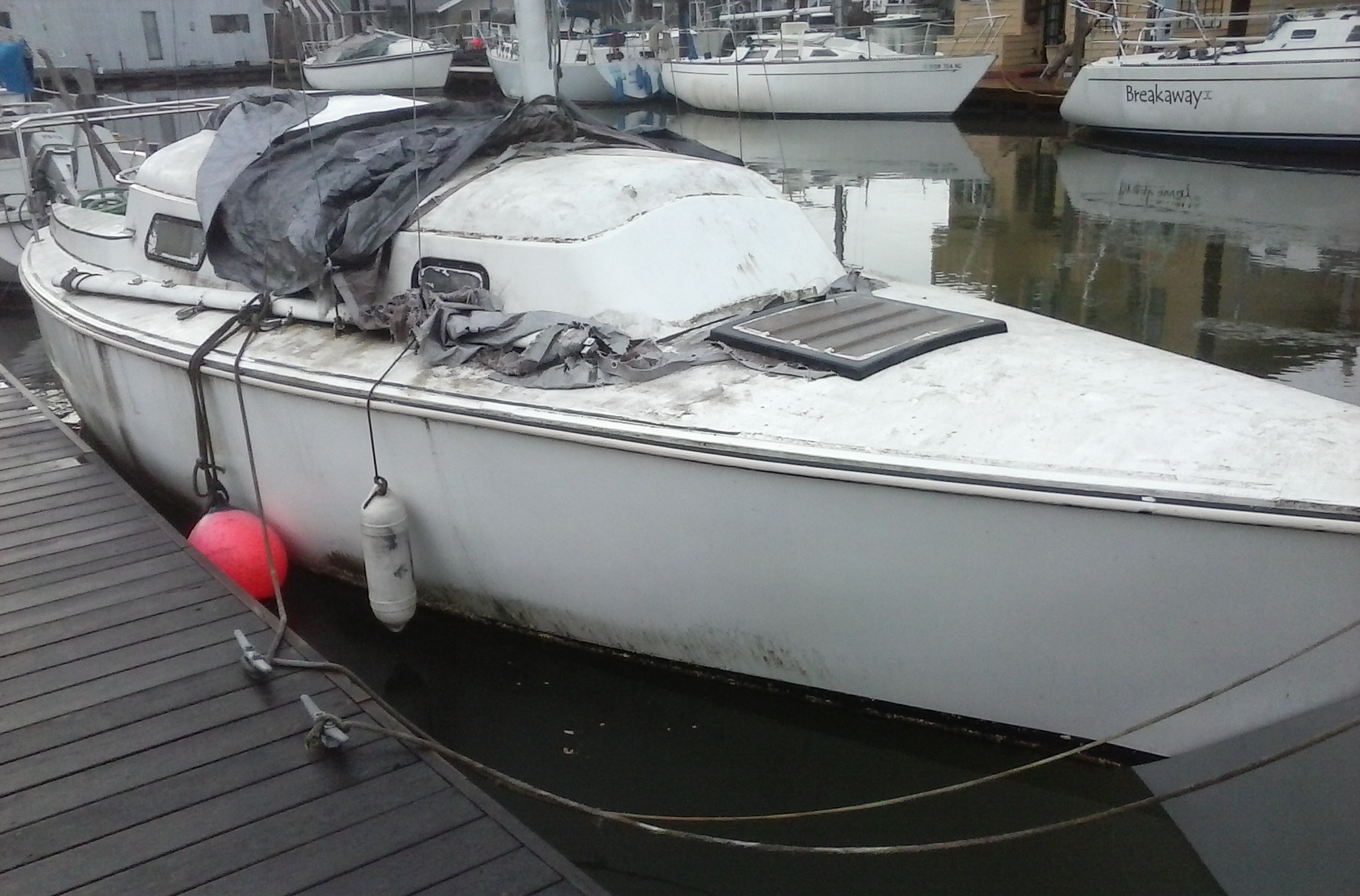

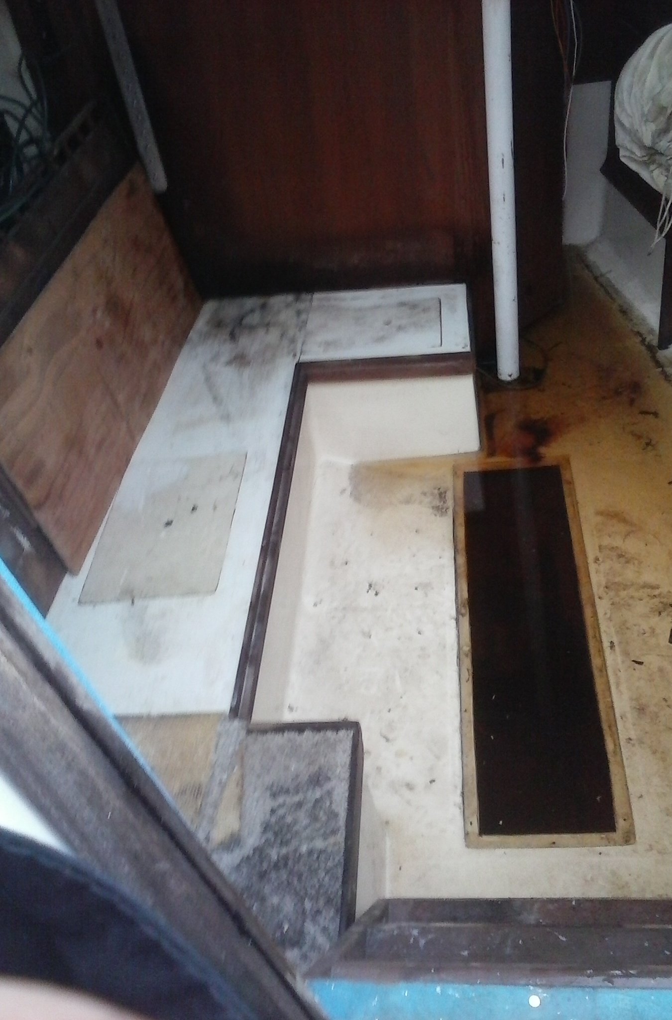

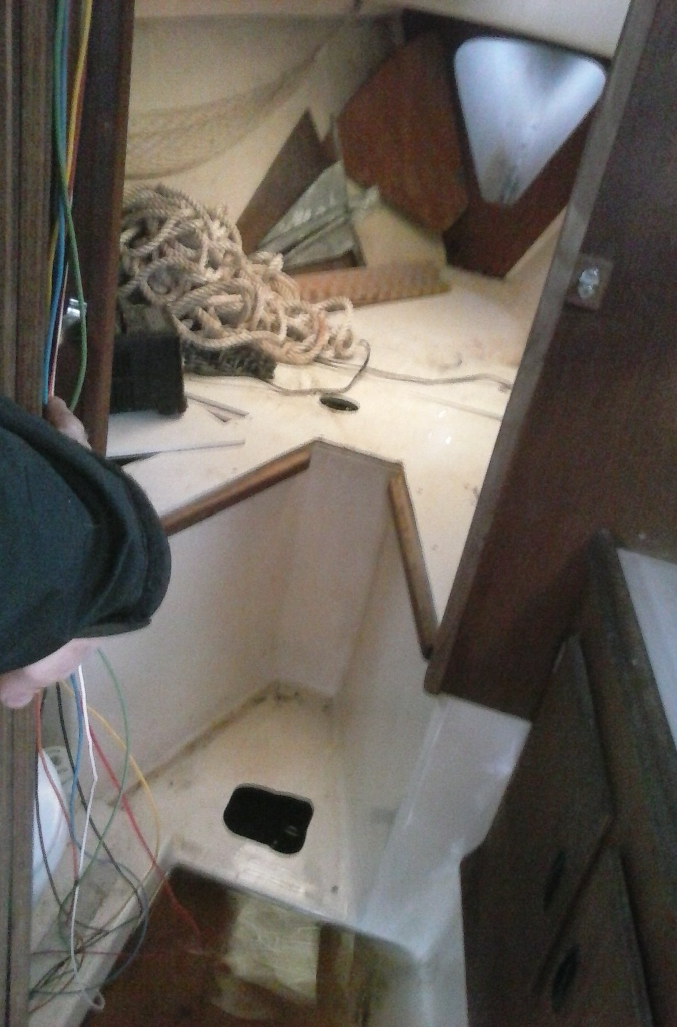

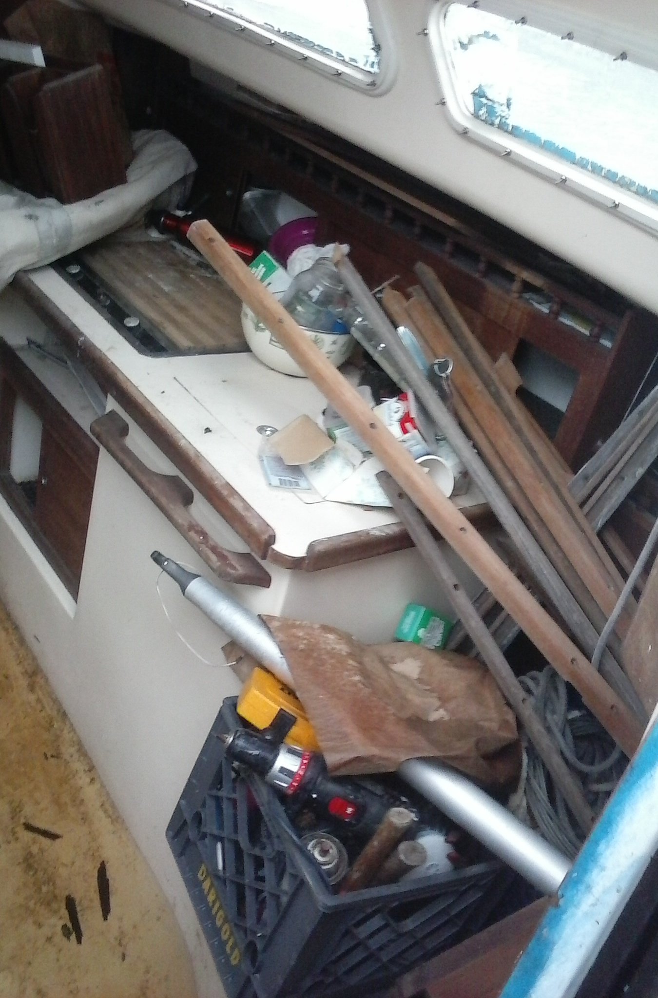

Thought I would introduce myself. I'm Daniel and I just purchased a project Oday 27 (1975) which is a move up from my Aquarius 21. I live by Newport, OR and the boat is in Portland, OR, so I am traveling several hours on the weekend and staying the night aboard while i fix it up. Many thanks to 25yearslater for his very informative thread on this boat. Open to ideas/comments. Videos and pics from my first night (3-12 & 3-13). More to come :)mattress-removed.jpg original-condition.jpg original-condition2.jpg original-condition3.jpg original-condition4.jpg
