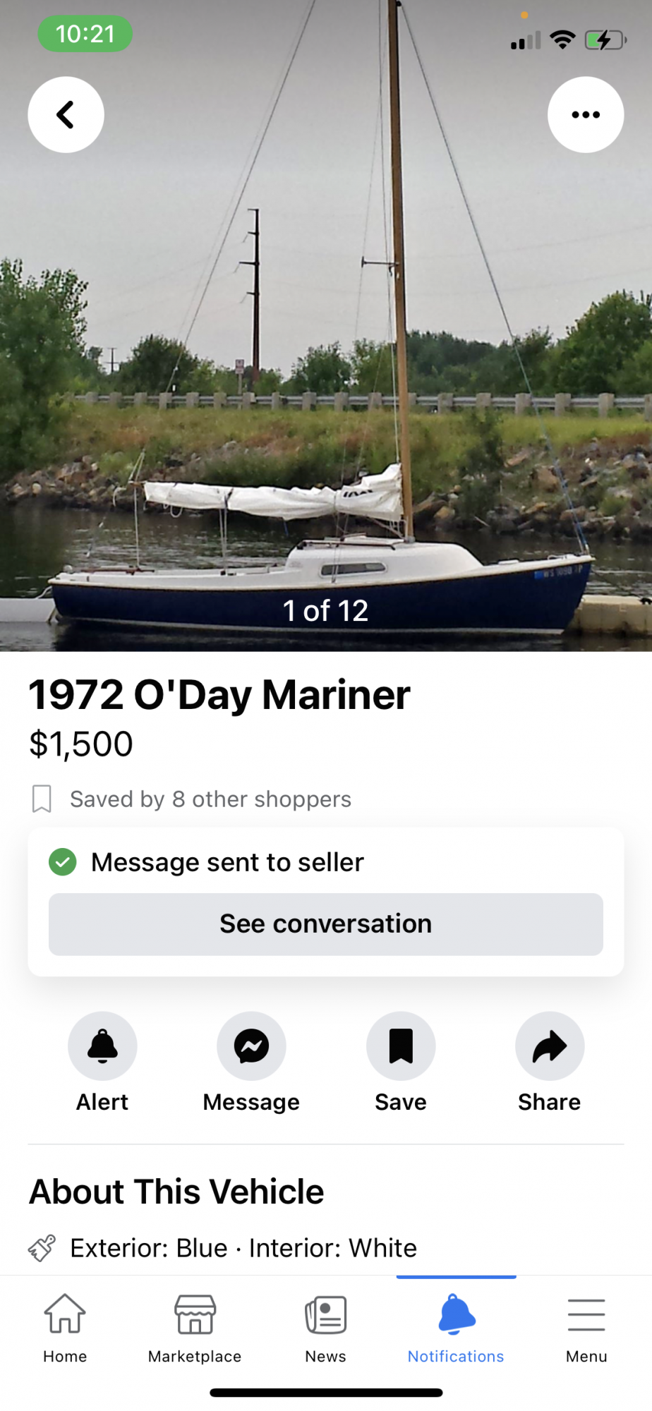

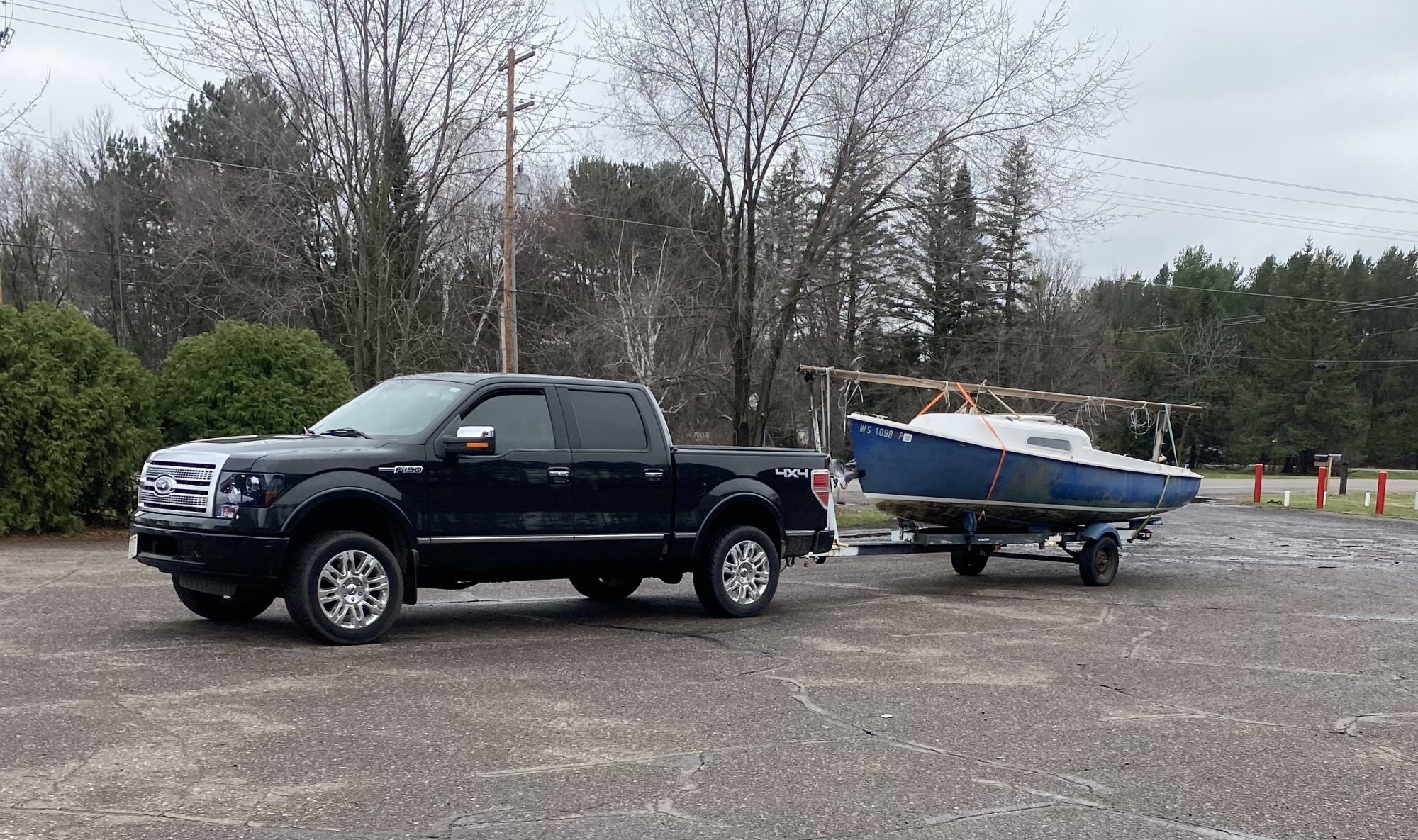

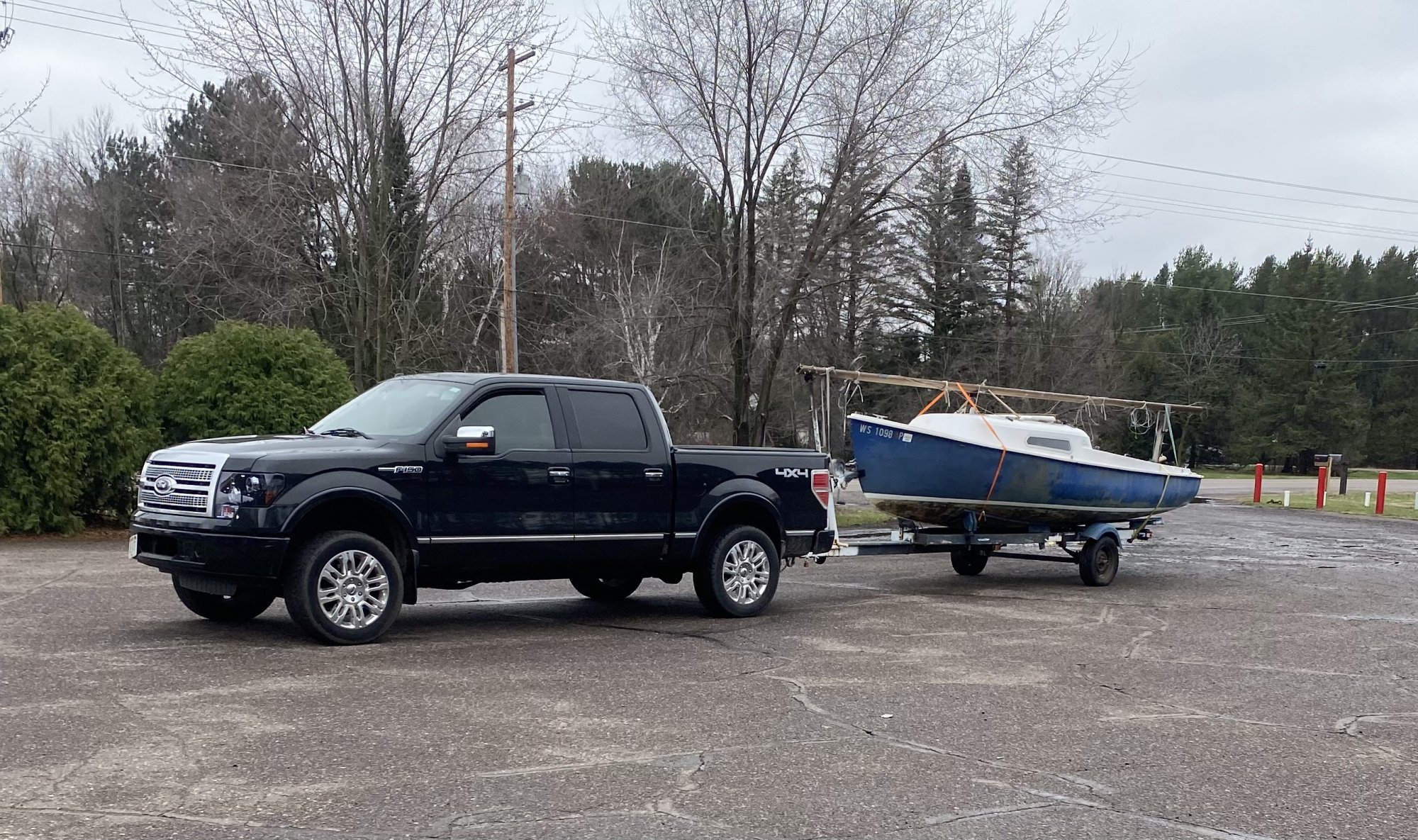

Hey everyone, I just picked up a 19’ mariner and I’m just looking for literally any advice on where to get started with it. It hasn’t been in the water in over 2 years. It seems to be well taken care of. It has 2 sets of sails one being fairly new. And a 2hp outboard. And all of the gear, ropes and accessories I could ever need. I paid $1200. I’m in the process of cleaning it up right now and am trying to see where I should start to bring it back to its glory days. I know almost nothing about sailboats but I’m excited to learn everything I can squeeze into my thick skull.
May 1, 2022
3
o’day mariner 19 Lake Wissota
Sorry about the double pics this forum is also new. Go ahead and roast me if need be.

Hi Girth, Welcome to the forum.
Cleaned up the extra images for you.
Looks like a great find. She will get you on the water having fun.
The first actions would be to examine the boat to be sure she is water tight and will not sink. Put the 2 hp engine in a tank of water and test to see if it works. I used a trash can filled with water, to test and tune my 2hp motor.
Raise the mast and put the best sails up on her. I did that in my driveway with my pocket yacht. I chose a calm day which allowed me to do the task with out any drama.
Personal thoughts would be to put it in the water and try out sailing her as soon as sure she will float. You really do not know what to prioritize till you have had some experience with her.
Give her a name and splash a little beverage christening her. Make a list or two then prioritize them. Once ready go to work. I believe in letting a little time with the boat makes me smart about what the boat needs.

Your new-to-you Mariner is a beauty. She looks to be around the same year as mine, '73. The hull number should be etched into the transom on the starboard side of the rudder. That will have the year and production number coded in it, if you don't already know her age. Hull ID Help - Mariner Class Association

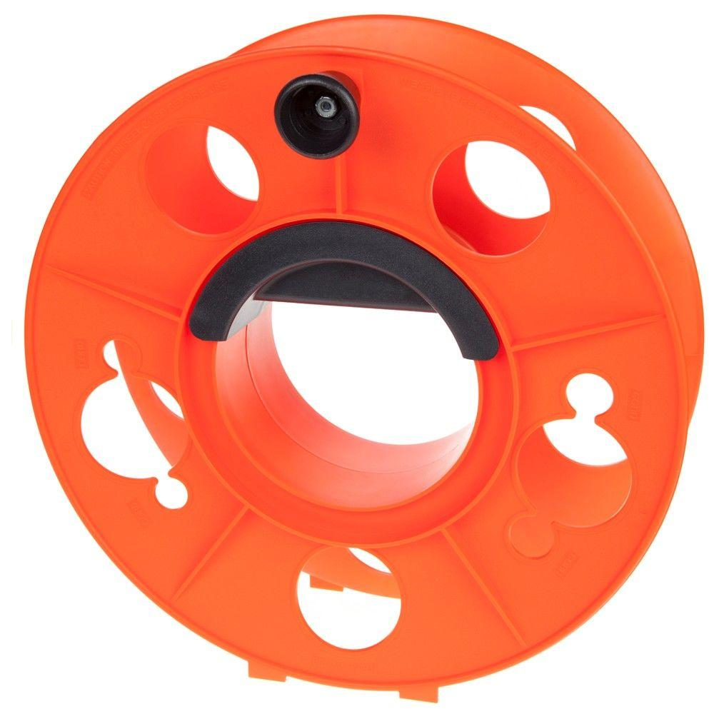

One of these for your anchor rode... you can get 100' of 1/2 line on one of these but you should stow them as two 25' pieces and one 50' piece with an eye splice and a shackle.

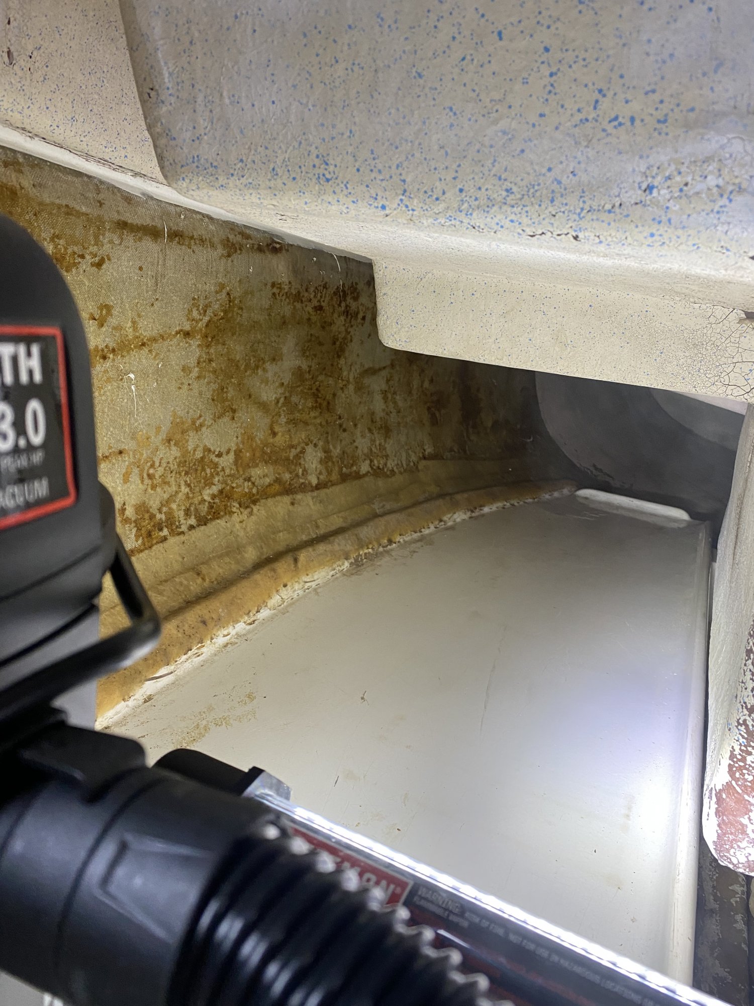

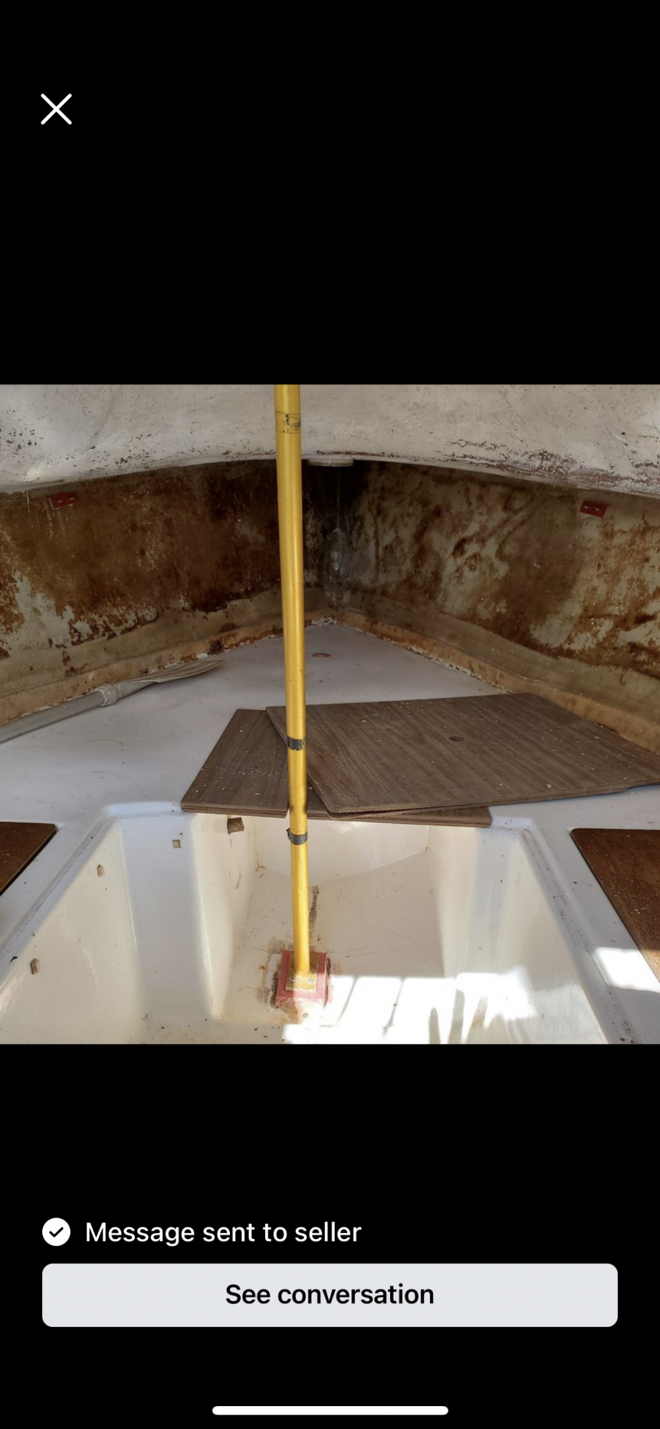

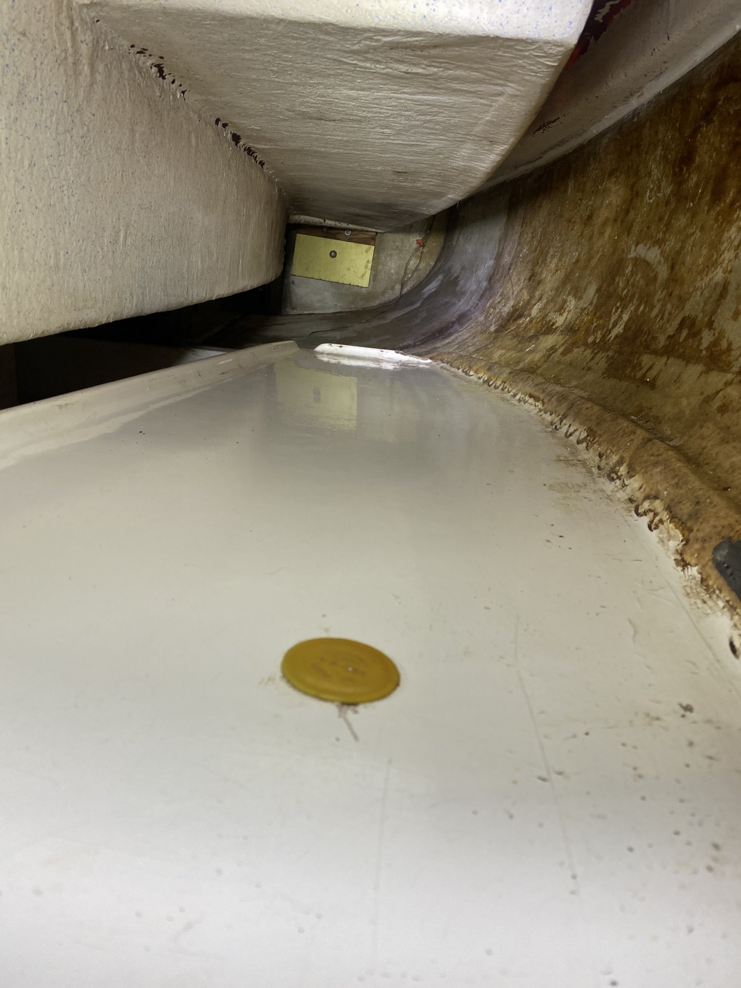

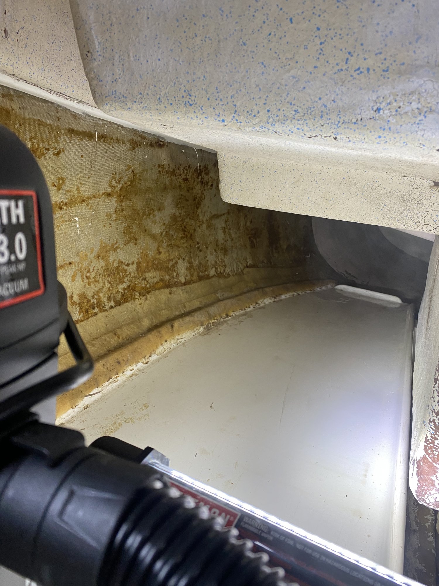

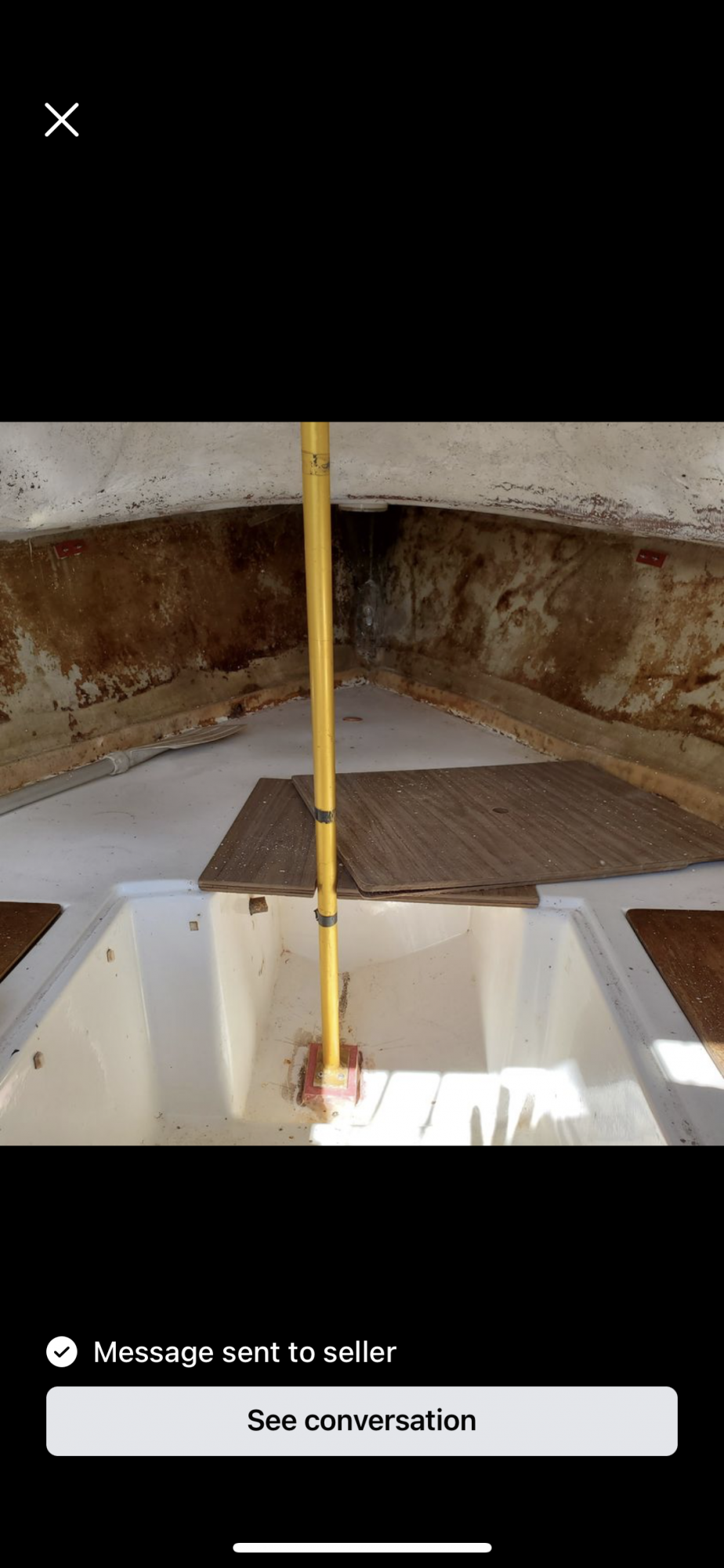

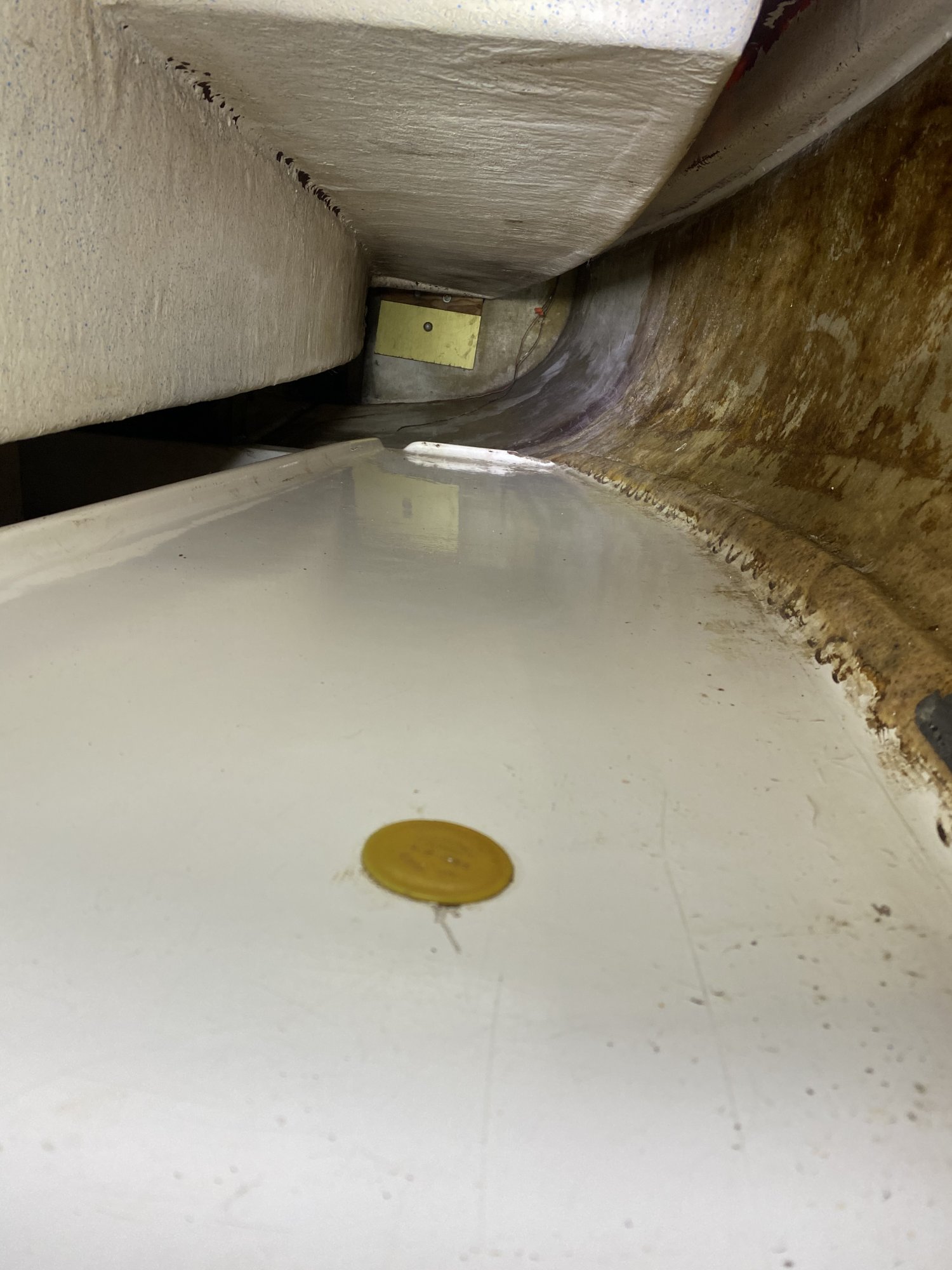

I recall the interior fiberglass as being rough, but lighter in color than yours. Check to see if there's an issue causing the discoloring.
The Mariner was the least expensive and easiest to keep boat I have owned. While the rest of us are on dry land doing maintenance, you can be on the water in an amazing range of locations. Get some good camping mattresses, a Coleman Stove and a porta-potty and you'll be good to sail and camp anywhere!
Oct 19, 2017
8,166
What the OP has is a removed vinyl wall liner and that glue is notoriously hard to clean off.
I suggest a two part epoxy paint after sanding as best as you can. If it is bothersome. Mine still has the liner, but it looks ragged and the edges are peeling, so That will be the route I may someday take.
-Will
13,045

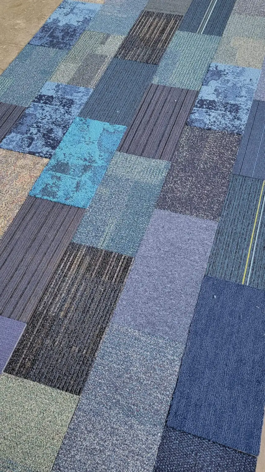

A way to cover the rough fiberglass is with exterior grade carpet tile. Nice stuff, easy to work with. All you need is a sharp box knife. If you alternate the direction of the pattern, the missmatch looks intentional and you don't have to fret lining up the runs.
13,045
@Will Gilmore is right though, you will need to knock that glue down a bit first. A rubber wheel or a whire wheel on a cordless drill will do the trick.
