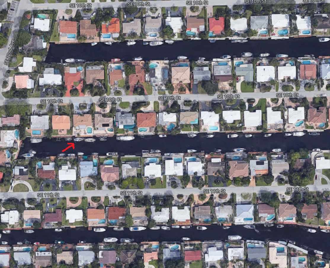

This is not a slip. In S Florida with all of the canal front docks, it is traditional to cross tie in the middle of the canal during Hurricanes. This moves your boat away from the dock, while blocking the canal from other boats. You can see my dock location in the below image.

This normally works well.
We have smilar type dead end Canal type developments.
But...
Katrina's storm surge that hit canals like your, when the surge was directed straight down the the canal [right to left on your picture] the guys at the dead end of canal were devastated.
If there was a jetty or blocking structure at the beginning or surge was different direction, Survival.

We were three houses from the inside end of the Canal. Here is a video of the boats during Irma:
The Spiderweb of lines kept them where they should be.
