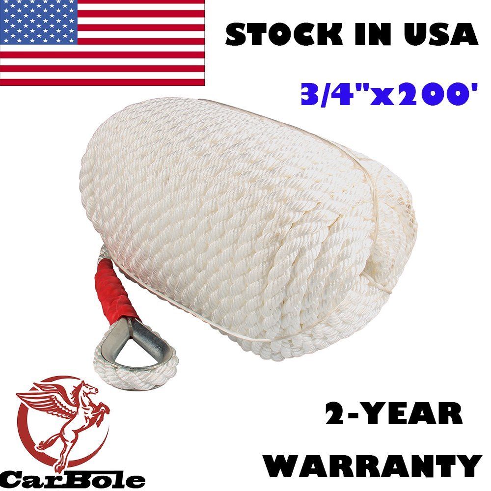

Chip are you comparing new and new line? A soft hand is not necessarily bad. It may be the tightness of the line twists. I bought a set of pretty RWB lines from WM that were 'soft hand' and use them when I visit marinas and want to dress up the boat. I have some everyday duty lines that are white and stiffer. I know the SWL numbers on each an use them based on service conditions.
It is just a guess, but 3/4 nylon line should secure your H31 with out much trouble. May have a bit of issue on the H31 cleats or deck chaulks.

Comparing the new E-bay line and older but rarely used line. I only use the 3/4 for Hurricane tie out. The existing line I had is much stiffer/tighter, than the E-bay line.
3/4" works fine on my cleats, but does not allow me to double up. I used an eye spliced 1/2" loop first, and then cleated the 3/4 on top of it. so that I had 3/4" and 1/2" doubled up lines.
