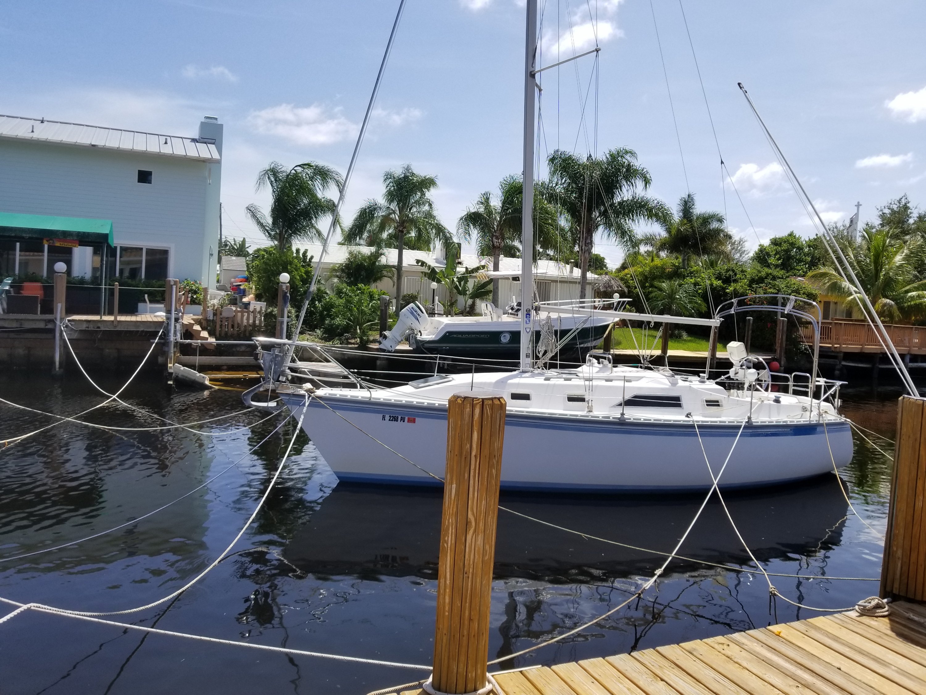

I've done considerable instrumented (load cell) testing of dock lines in moderate storm conditions. The biggest problem with doubling lines, other than chafe, is that the kines will NEVER share the load equally. One is always stiffer than the other, either because it is older or because of differences in weave. There is nearly always a better way.
a. Change the angle at least a little. Even if they must go the same cleat, anchor them to point separated on the dock by a few feet. In this way they have a much better chance of sharing load.
b. Spring lines. Every boat that is properly prepared for a storm will have 2 springs on each side. Even when you think they are not bearing load, they reduce surging so much, they reduce the load on the bow and stern lines by nearly 50%.
No matter what the wind direction, the boat is nearly always supported by more lines than you think in more dynamic ways than you think. You need to sit on the boat in gale conditions, from several directions, to begin to understand the interplay. For example, the most severe forces are generally associated with winds at odd angles, not straight on the beam, because the keel prevent rapid moment to the side. It is usually the fore-aft horsing that does the damage, and that is what springs can stop.

By doubling up, I meant I had two lines to each cleat on the boat. they each went to separate pilings/cleats. See picture below.
24,812
Love the spider web Chip. Captures the boat.
