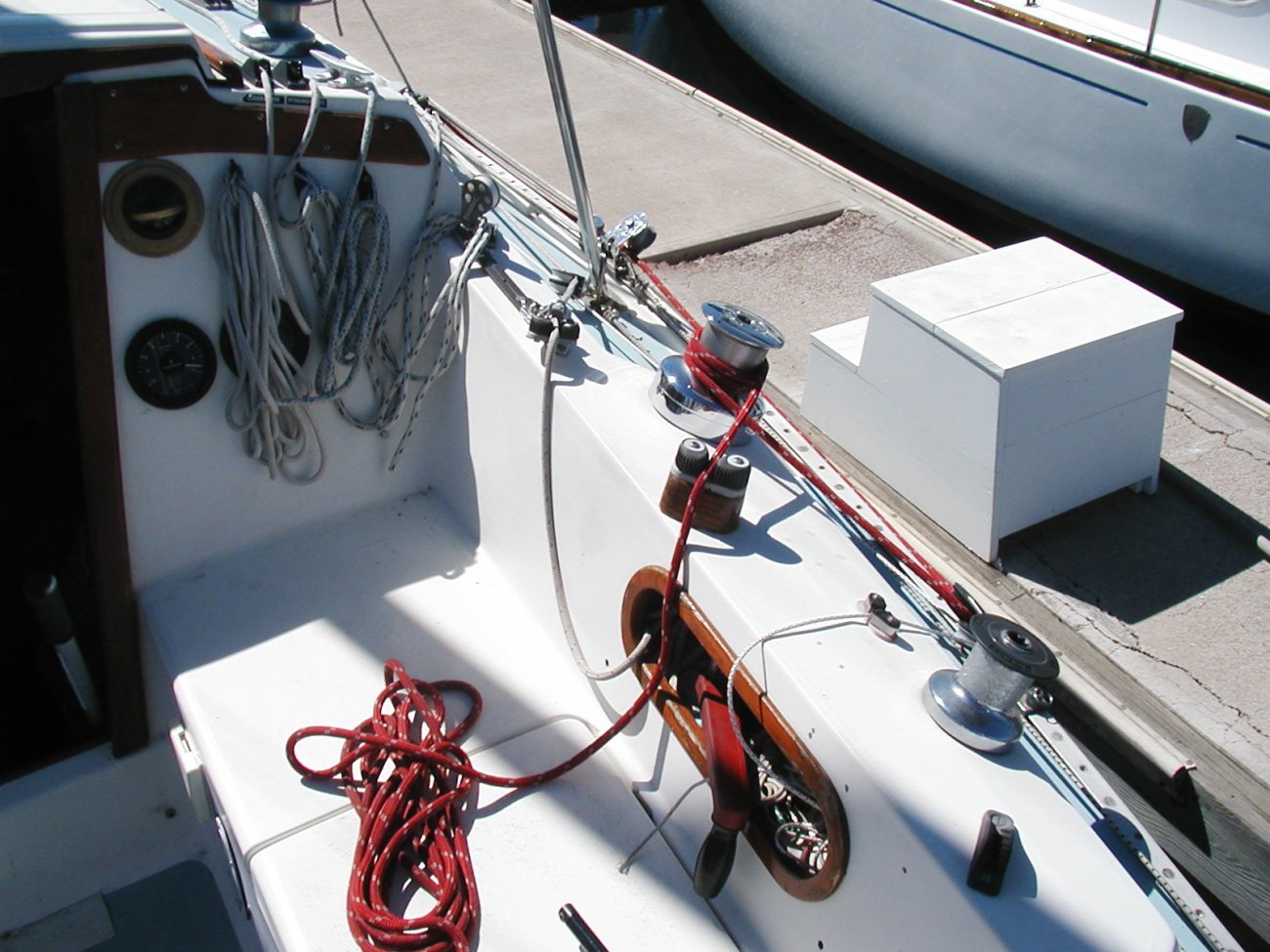

If you have to strip the line off the drum when it fills up.... it isn't "self tailing"... Now.... "self holding" could be a good description of the rubber "wincher" device.... but more than half a turn you'll have to peel off the line with your free hand, or stop grinding and use that hand to free it up.
The wincher has jaw cleats that allow you to secure the line, just like a regular self tailor... the underside is ribbed... which is suppose to help pull the tail off the loaded drum... but it doesn't really work because the gripper jaws will not release the line without the operator pulling the line out.... it's very frustrating and hugely inefficient.
So..... how does one improve his single handing capacity without investing a couple thousand for self tailing winches???? simple.... get an auto/tiller pilot, or wheel/tiller lock if you're short of funds, set your course, engage the steering device and take your damn time using both hands to trim up that headsail.

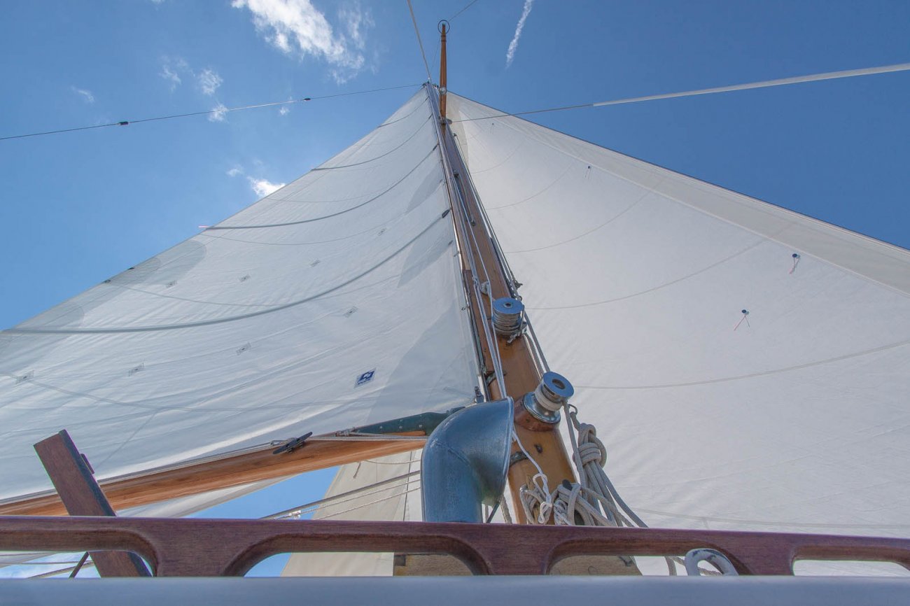

#1 place to spend money on a sailboat.
#2 place for me, is to fix what's broken.
#3 Maintain what's there (if it's made it this long, it's probably better than a new replacement).
After I owned my old boat for 8 or so years, I had to do an insurance value survey. Much to my embarrassment, it went down in value... :)
But when I looked around at other similar boats - for sale - that had new everything, I realized I'd saved money, a lot of money.
The $$ spent is gone as soon as the check clears, make sure you enjoy the return on what you buy for your boat.
