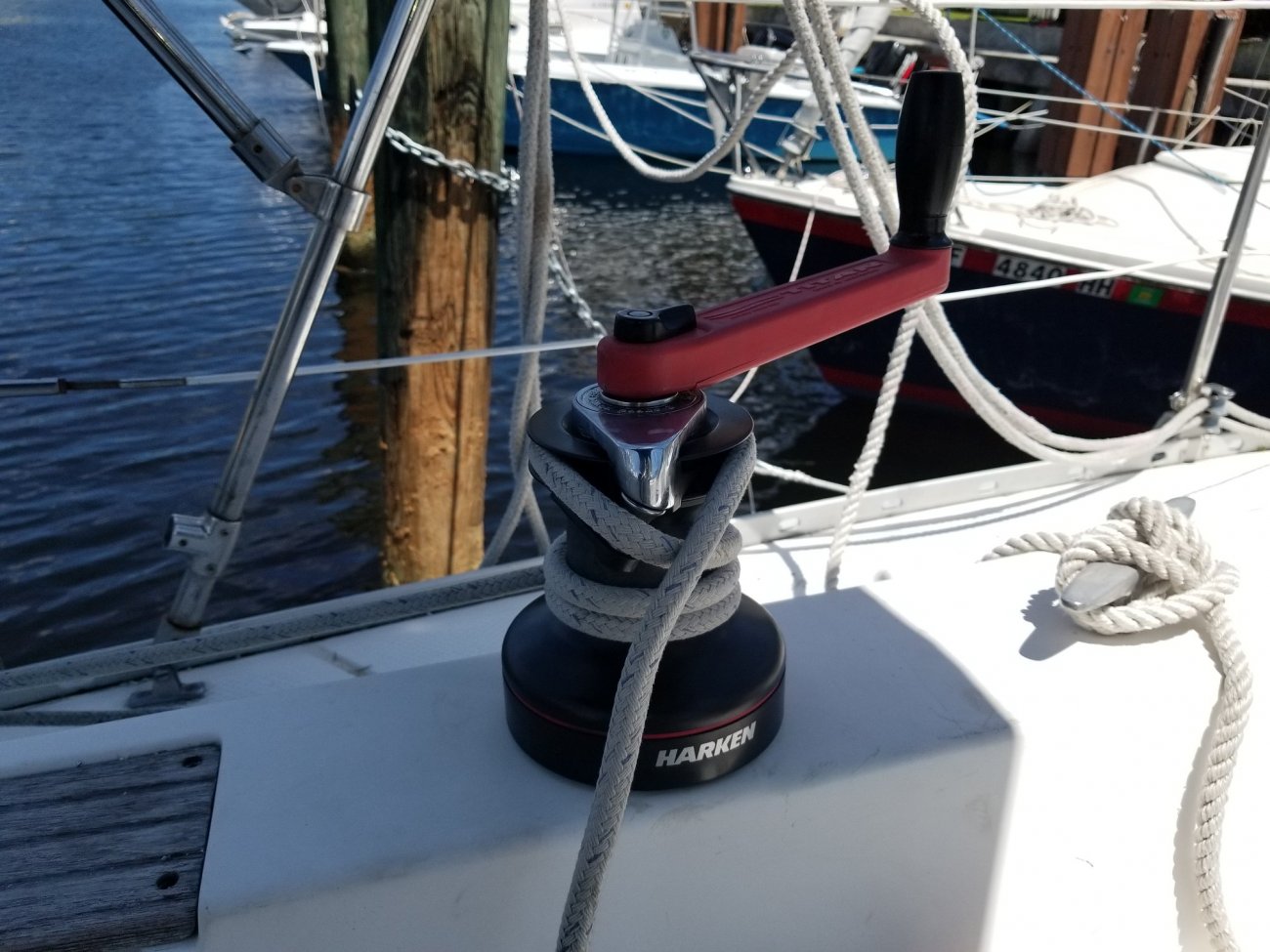

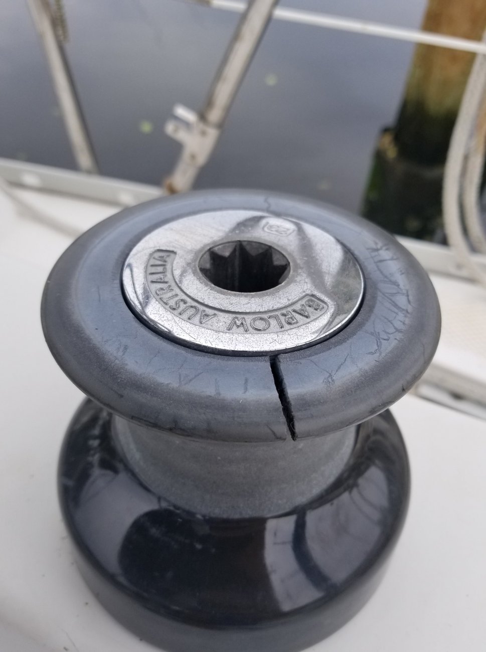

I did the used self tailing winches off E-Bay, but I had a broken cracked primary, so there was an additional reason to upgrade.
New to me Used Harkens
Busted old winch.
If your not racing, and your sails are not falling apart, self tailing winches make sailing short crewed a lot easier.
