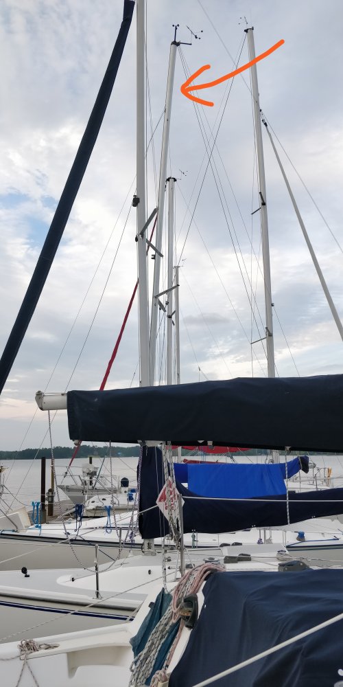

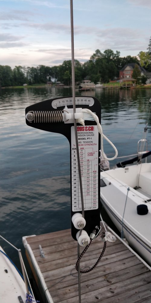

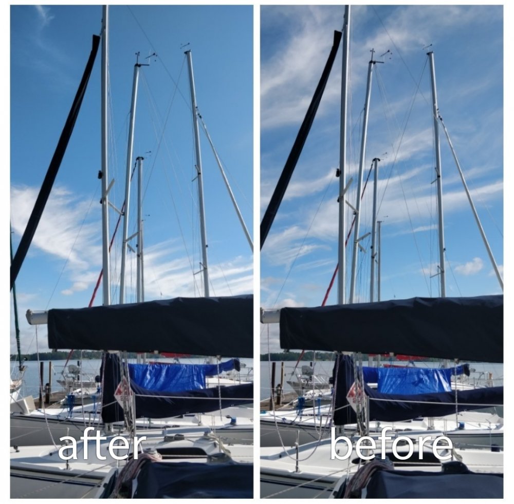

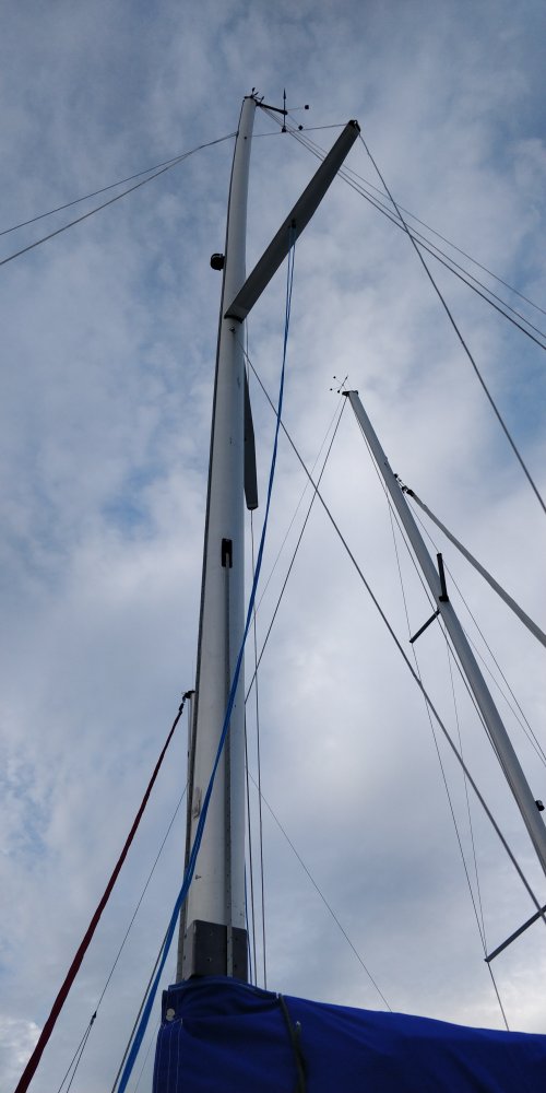

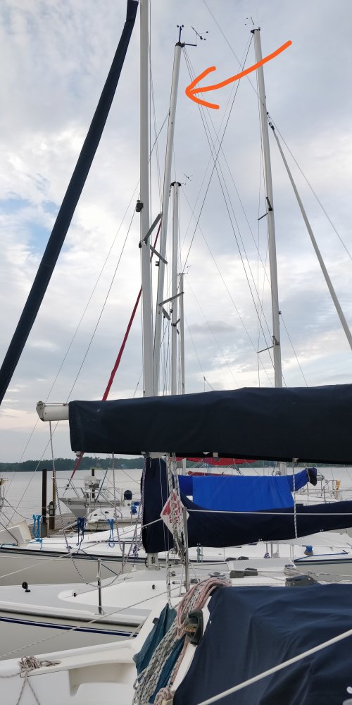

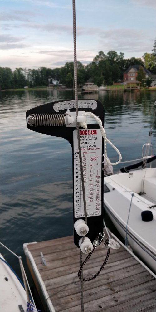

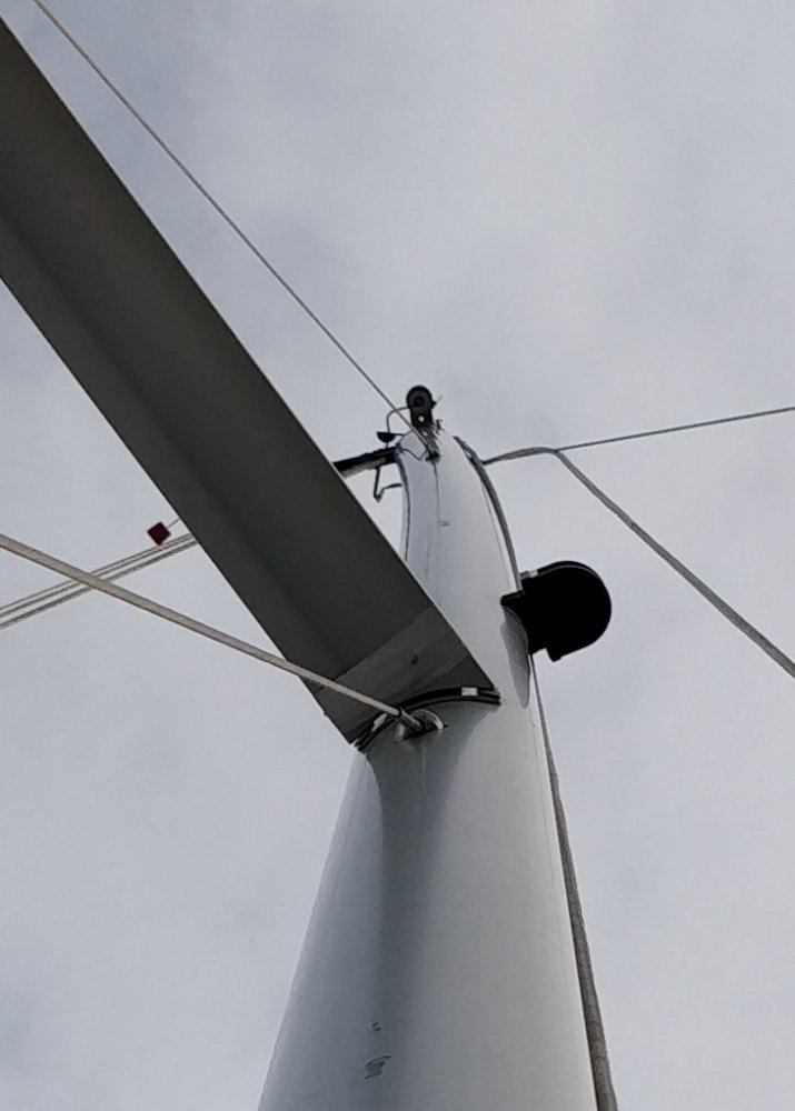

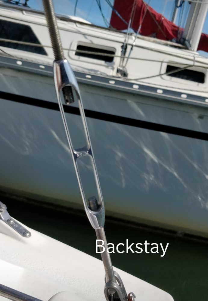

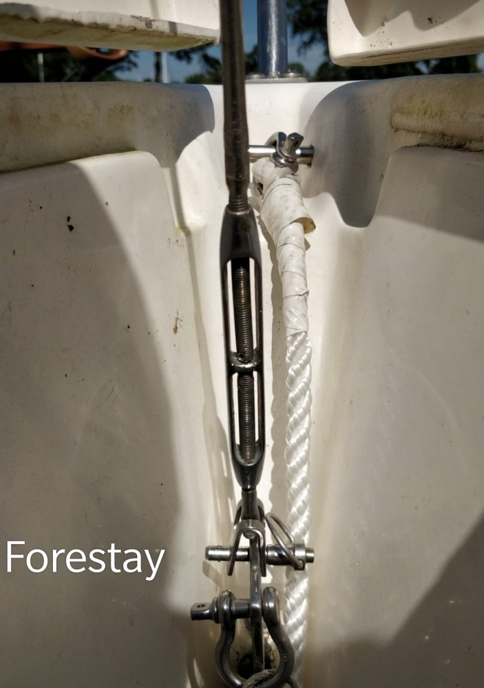

So I recently bought an 87 H23. I've owned 3 other sailboats and I have never encountered the following: my mast has some major rake the likes I have never seen. The uppers won't go taunt at all. They have 4" of play and the turnbuckles are maxed. They register a 12 on a loos gauge. The lowers are currently at around 10 percent at about 3/4 of the turnbuckles. So they could go tighter. And the forestay is currently at about 15 percent/500 lbs on a loose gauge, but probably could go tighter. The backstay is at about 4 percent. But nothing increases the tension on the uppers. What's going on here? I was going to order new standing rigging from Jean but i don't know why my uppers won't tune and why the upper part of the mast is a banana. Thanks for all responses
