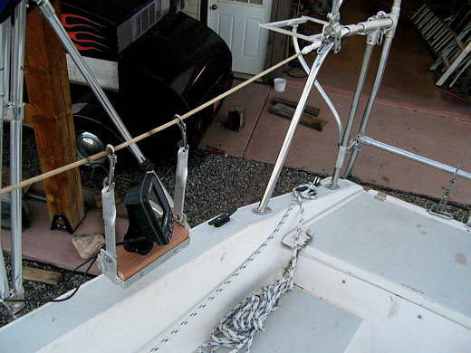

Nice simple chartplotter cockpit mount, Sumner
Just got back from looking at your Mac(gregor) website and your info on hanging the chartplotter from the lifelines was a great simple idea.
I do not have a chartplotter yet and am of course going to overthink the options some more before doing anything :D. Liked the looks of flush mounting a chartplotter in the forward cockpit/cabin bulkhead, but understand the limitations in being able to see it at that distance from the tiller. Hmm. Didn't care for mounting an arm at foot level in lazarette wall, with it being in the way; ditto for mounting on bench seat backs and cockpit lip (not the gunwale...what is it called?).
Your idea is flexible and not permanent, so it can be undone easily without drill holes to deal with.
Any improvement ideas (wish-I-woulda's) that you have thought of for your hanging mount if you were to do it again? I was thinking an inverted U-shaped base to sit over the cockpit lip (?) to keep the unit from swinging to and fro on the lifeline? Or does it not really swing enough to be a bother?
Any other neat/novel ideas from others on how they mounted their chartplotter in their tiller cockpit?
Thanks for posting the link to your site.

This is the first trip that we have used the Cuda on the lifeline and have been out about 2 weeks now. To this point it has worked even better than we thought it would and would do it again without changes. It is far more flexible in how you can view it vs. the old one that was in a fixed location.
Ruth can see it easily while on the tiller and that helps when we are in shallow water looking for a place to anchor with me up on the bow. At night I can pull it forward up to the cabin where I can stay below and reach out and turn it on to check our depth as we swing on anchor and the tide goes out.
I wonder how the cables will hold up over the long haul. I plan on making up a second set and have them on board just in case we would ever have a problem. If they hold up for a couple years even then the cost of replacing them would be well worth the convenience of viewing the unit.
We have been running it in the "map" mode and not in the sonar mode, although you can run a split screen. You can overlay data on the screen in about 4 sizes of text. We have the depth displayed at the top in the largest font and below that speed and below that different items depending on what is important at the time.
I think for $200 it is a great buy, but wouldn't want it as my only GPS device on board. One reason we bought it was that it will output our position in NEMA to the Standard Horizon VHF that has DSC and it has been doing that fine. The only thing that I really wish it would have is NEMA input so that I could send waypoints to it via SeaClear like we can to the handheld Garmin. You can manually input waypoints, but that is a pain and we don't do it.
The manual implies that it comes with the NEMA output cable, but that isn't true and you have to buy that separate. We just got ours before we left since the cables where on back-order for a couple months. The cable was about $20 from Defender. I had to add to the length of that cable and the power cable to mount it like I did. The depth transducer cable was long enough.
One added benefit is that while trailering or if you are worried about someone taking it you just unplug the cables from the back and unclip the unit from the line and take it below.
If anyone else is interested here is the link to the mod....
http://purplesagetradingpost.com/sumner/macgregor-navigation/Cuda 350.html
