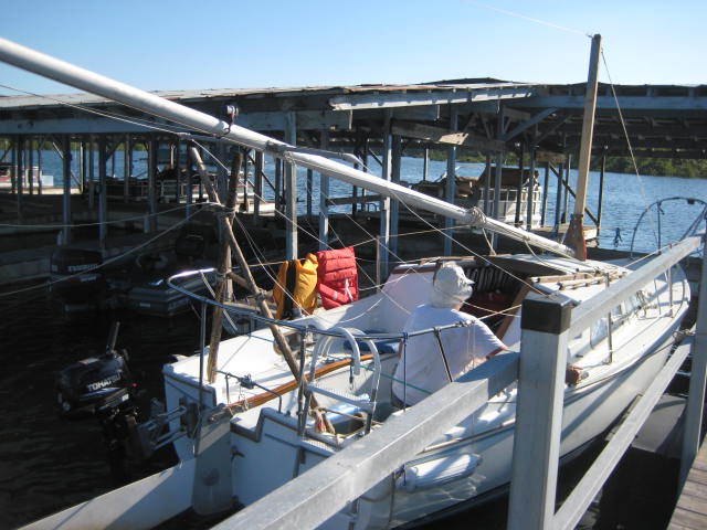

After launching and tying up to slip I set up and tried the single handed gin pole mast raising system. It was not pretty. The boat in the water is too susceptible to listing from side to side with wind, waves and my fat ass moving around. So the gin pole to mast connection has to be rock solid secured cause if not it will lean. After a couple of tries I gave up "single handed" and had to have the mate on deck holding the gin pole steady.
admittedly my pole to mast hook up was not as elaborate as others I've seen posted. Mine was too insecure and did not work without help. At this point I think the best for me is the A-frame because of its steadiness when the boat rocks. A more carefully built elaborate gin pole base to mast construct may solve that issue. However for me the simplicity of the A-frame build / assembly for on water single handed stepping will be the way I'll go. I will try to make the a-frame a little smaller, shorter, lighter, storable and more portable. I didn’t get many pics because the mate had to stop photos and come aboard to help steady things up.

Looks like you did it right so you are probably correct to go to an A frame for your application. Chief

I used the stays for both types (gin pole, A-frame) in the water the gin pole w stays still got scary single hand using a cockpit winch. Having the time and inclination to make a tight fitting and securable gin pole is not something I want to invest in. The simpler a-frame helps the stays steady things up and is more stable in the water when the boat list. On land and with wife to crank trailer winch attached to jib halyard I just walk it up. But I want to have a system to single hand on the water from the cockpit. So far the a-frame has worked better. James

Refitted my a-frame with a better bolt connect point for jib halyard and anchor line / stem / block set up. I had to raise and lower the mast twice while on the water to unconfused lines and repair mast light. It works like a charm and I can single hand the operation from the cockpit on a sheet winch. I guess everybody has their own preferences but for me this is the best, easy, simplest and cheapest to make. Material was a couple of left over wall studs, recycled two feet of 1 x 6 board with some old carpet glued on, 7 x ½” , bolt, wing nut , washers and three links of 5/8 chain. It takes about 6-8 ft of ¼ line, two stainless rings, and the use of a couple of dock lines. I didn’t buy anything new just recycled stuff I had. If I had started with new material probably less that $10.00.
I am slow getting it set up because of my mobility issues but slow and steady gets it done and then up (or down) she goes.
I took her out sailing after all that was done. I am very pleased with how much better the boat sails and handles with my keel repaired, goofy upside down hangers replaced and bottom cleaned, faired, painted. I clipped right along close hauled in a 5-6 knot SW breeze. Man! What fun, peace and serenity. It is really good to have "Grace" back in the water where she belongs.
