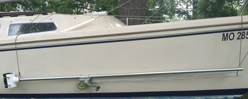

OK, I built my gin pole over the weekend. I utilized a 3x2 PVC saddle Tee for the mast attachment point. A 2 1/2x2 would have been a better fit, but this allowed me space for padding, and I just happened to have a scrap piece of 3 1//2" foam rubber pipe insulation that fits perfect.

Very clever, Jacomo. Have you had a chance to test it yet?

Have not tested it yet but hope to this weekend. I got the idea for the saddle tee from this blog that I found in a google search http://cjandeai.blogspot.com/2007_11_01_archive.html
The blog mentions that he had to bore out a 1 1/2" bushing to make the aluminum pole fit. I decided to bush mine down to 1" because a 1 3/8" galvanized chain link fence top rail has the same OD as 1" pvc and fits very snug in the bushing.

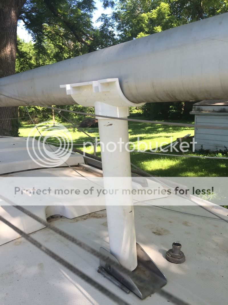

I cut the pole to 92" and pressed the bushings on one end. The winch is mounted with the U bolt and the hex bolt. I cut the swivel eye off from the snatch block and replaced it with the eye bolt which runs through the end of the pole. I glued the two bushing together with pvc glue but didn't glue them into the tee for two reasons. 1, the tee will be easier to attach to the mast without the pole attached. 2, a short piece of 2" pvc stuck in the tee makes a great mid mast support at the tabernacle when trailing.

Nice plan. I like the idea of using the T part as a mast crutch in the tabernacle. I think I just stuffed a bunch of throwables up there. Lol.

The fence rail is only 17 ga and it only weights a little over 5 1/2 lbs. The winch with cable weighs 5 lbs and the rest of the parts might add up to a pound, so total weight is less than 12 lbs.
Storage aboard isn't an issue for me as my boat will sit on a mooring ball and the dry sail lot during the winter, so the once the mast is up the only time I'll need to drop it is for maintenance or upgrades.

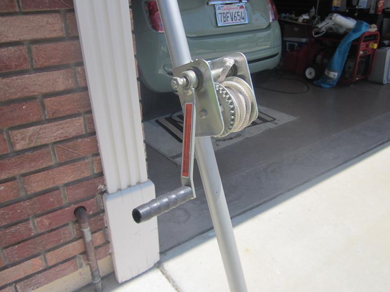

I purchased my winch from Northern Tool...it ratchets both ways and was around 20 dollars. While building your gin pole, keep in mind that there are hardly any "bending" loads on the pole. Most of the stress will be in compression removing the need for the pole to be "built like a bridge"! The basic function of the gin pole is to hold 2 opposing lines at an acute angle. Mine is simple, lightweight and functions perfectly. After using it twice, I can have the mast up in about 2 1/2 minutes...and never break a sweat!:)
