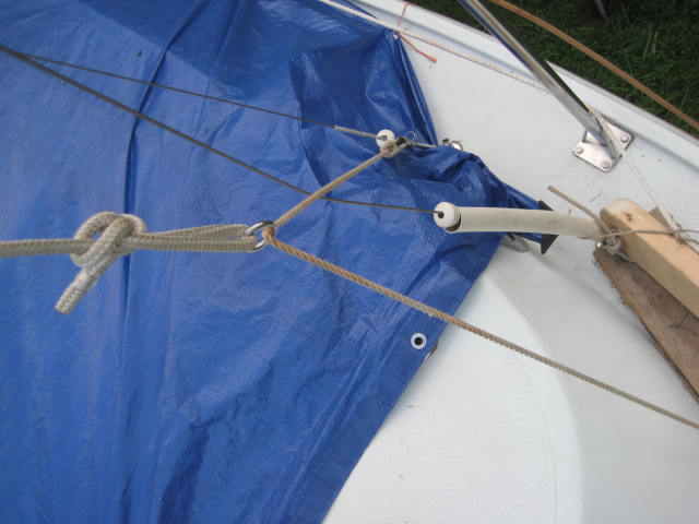

Not to one up Capt Don but what I understood from one the tech manual write up: it says tie a 1/4 line thru the bottom on the forward turn buckle and the top aft turn buckle. I wonder will this bend the turnbuckle? My forward lower stay will not hook up with the mast all the way down even with turn buckle all the way extended so I tied stay bridle line to the fore lower eyebolt (there may be something wrong with mine?). The key semed to be to have the aft bridle connection higher than the forward one and use the ring to attach the line going up to the mast so they slide as the mast goes up. That was the best thing I learned in setting up a prototype.

The only question I have is how secure the baby stays will be if connected to the main halyard with a wrap around line to keep them close to the mast. Hard to explain, but I think I saw someone else's post that used a similar baby stay setup. Any opinions?
I used this stay attached to the mast system and found it to be very satisfactory. A short 1/4 line tied around the baby stays andt the mast with the main halyard conected to all 3. worked very good. it is possible to make the stays tight and they stay that way. I think using the rings on the bottom end of the stay line to connect them to the bridle line is also important.
