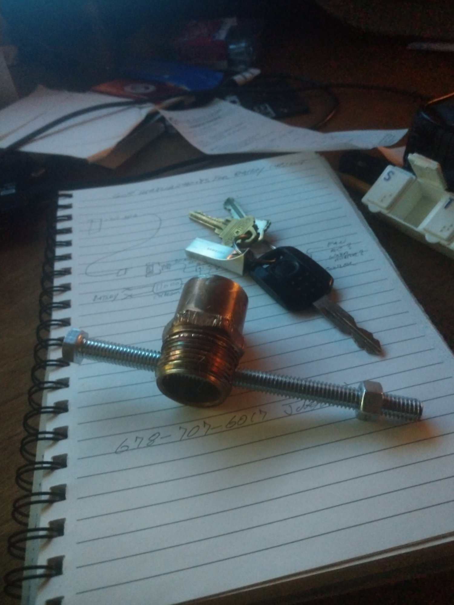

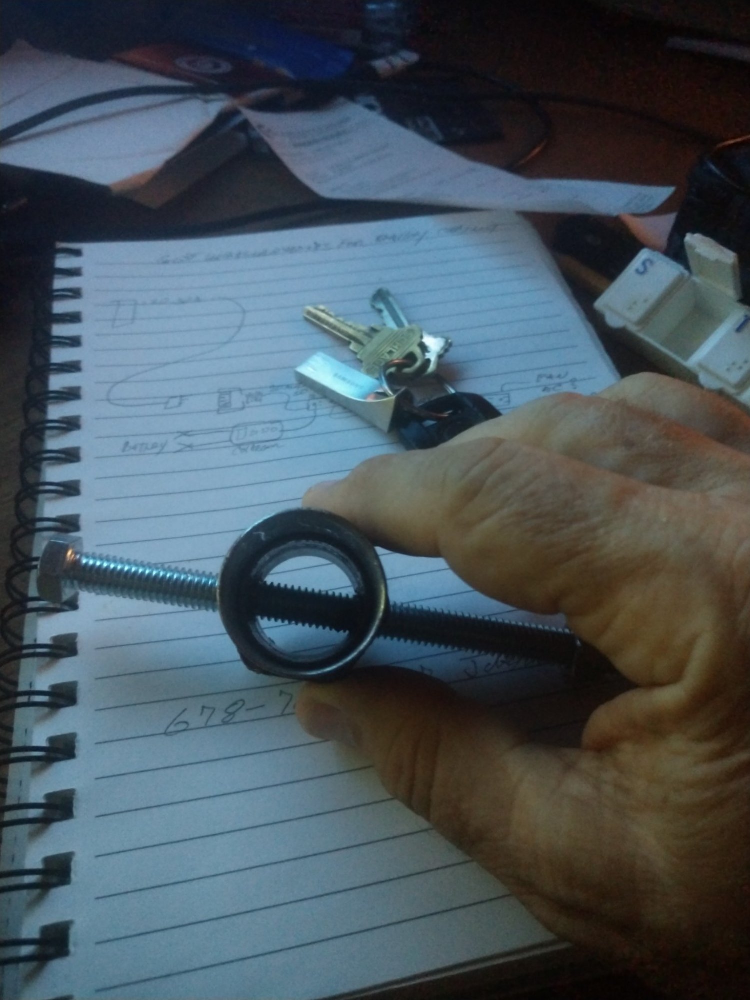

I took a 1" brass plumbing fitting (solder to thread adapter) and drilled the tread end cross ways with a 3/8" drill. I suspended it between the mast raising brackets with a 3/8" bolt and pushed the mast raising pole end into it. We had no problems raising the mast. I will save the parts.
