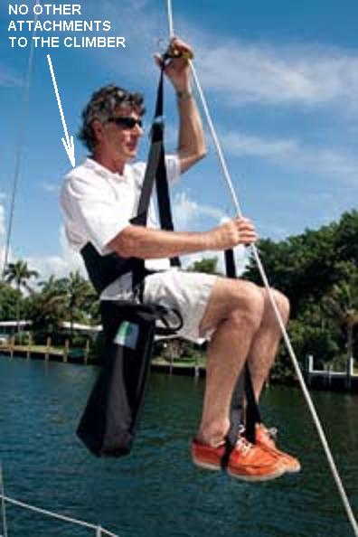

Geezz just get one of these they work great. I choose safety.
I hope you're using an additional line for a safety line and NOT following the demonstration shown in their video and other pictures they have on their site. I could not see if there was a safety line in the Vendee Globe videos. In fact, I would say that MOST of the demonstrations of mast climbing equipment on the web don't use a safety line.
Everywhere you look in sailboating it's safety, safety, safety, but when it comes to climbing a mast where the outcome of an equipment failure is most likely death, c'mon take a chance :thumbup: .
I appreciate the basic idea of the mast climber Keith, but if I head up in that direction, I've got to be wearing a body harness with a separate halyard snugged up from below as I ascend. Thanks again.

I think the point we're trying to make here is that these single ascending, climbing, lifting, or what have you lines are the working lines. I want an additional safety line when aloft, something completely separate from the working line, so that "IF" something goes wrong with the working line, you're saved.
Like an electrical fuse is a safety device ............ nothing should ever go wrong but if the wiring should short out, you're saved.
Like a PFD is a safety device ............ nothing should ever go wrong but should you fall over, you're saved.
Like a relief valve on your hot water tank is a safety device ............ nothing should ever go wrong but if the tank should over-pressure, you're saved.
Like a propane detector/shutdown is a safety device in your cabin ............ nothing should ever go wrong but if you get a gas leak, you're saved.
Like a pilot light sensor is a safety device on your gas stove ............ nothing should ever go wrong but if the main and pilot flames are extinguished, you're saved.
"IF" something goes wrong with the working line, pretty much a death sentence. If life safety wasn't involved, no big deal. Just be careful and take a chance.
