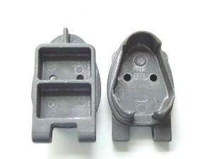

Here is a pic of the H23.5 mast foot that gets riveted to the mast base (top and bottom view). The right pic is the part that gets the rivets and goes into the mast.
Pic from Hunter Parts Store
13,046
That is the exact same as mine

Just for clarification, the pic you posted was not a Hunter mast base, correct? O'Day?
Yup, you got that right, @CrispyCringle. It's for an ODay 192.
That's a Zspar Z145 mast foot, which was OEM on the small Oday keelboats in the 1970's. There was a thread about this a week or two ago on the ODay forum, with links to RigRite.com part numbers.

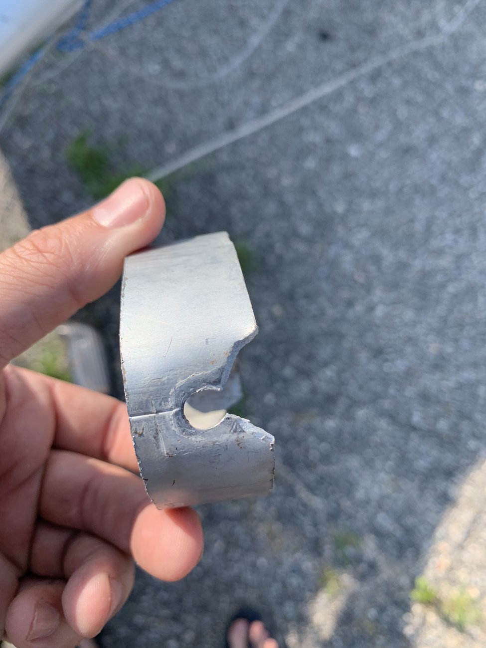

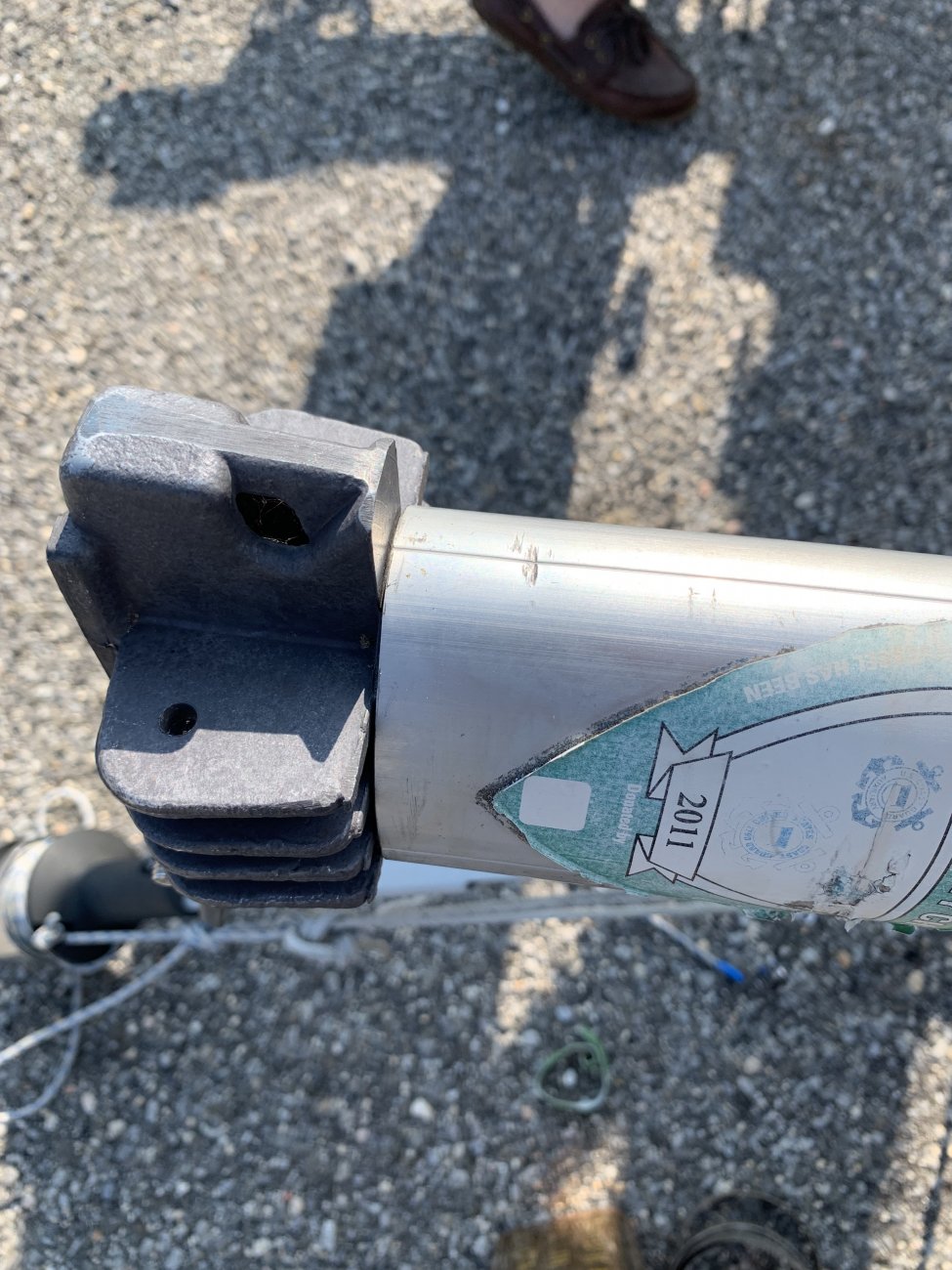

Please no offense, but I wasn’t asking a question or looking for help. I made a suggestion to the person who started the thread. I’ve been in the sailing industry for over 15 years and counting and the other person helping me also spent a lot of time in the industry and is an experienced engineer who also sails (and currently owns a Flicka 20). We came to this decision after considering a range of options.
For my application, the spacer below the hinge will work fine. The mast will be properly supported by the original Z Spar casting. 1” off the mast and 1” added below the hinge will keep the rig specs right where they were and give me better clearance over my companionway hatch when raising / lowering the mast. Not saying it’s the right move 100% of the time but it’s a valid fix in my case and I believe it could be an option worth consideration for the original poster as well if they have the ability to do it.

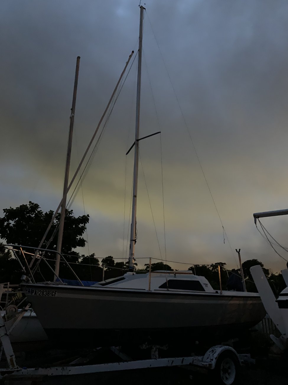

I cut the mast today and the base will be reattached tomorrow as long as it’s not raining.
FYI:
This is the Z Spar Mast from a 1988 O’Day 192

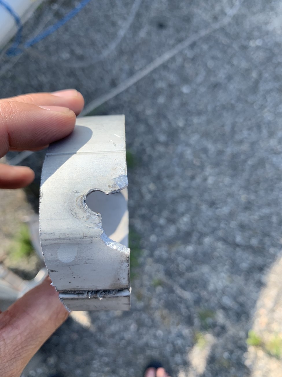

GSBNY, thats a clean cut. Mind sharing how you did it?
Thanks, it’s always slightly nerve wracking to put a saw to a mast.

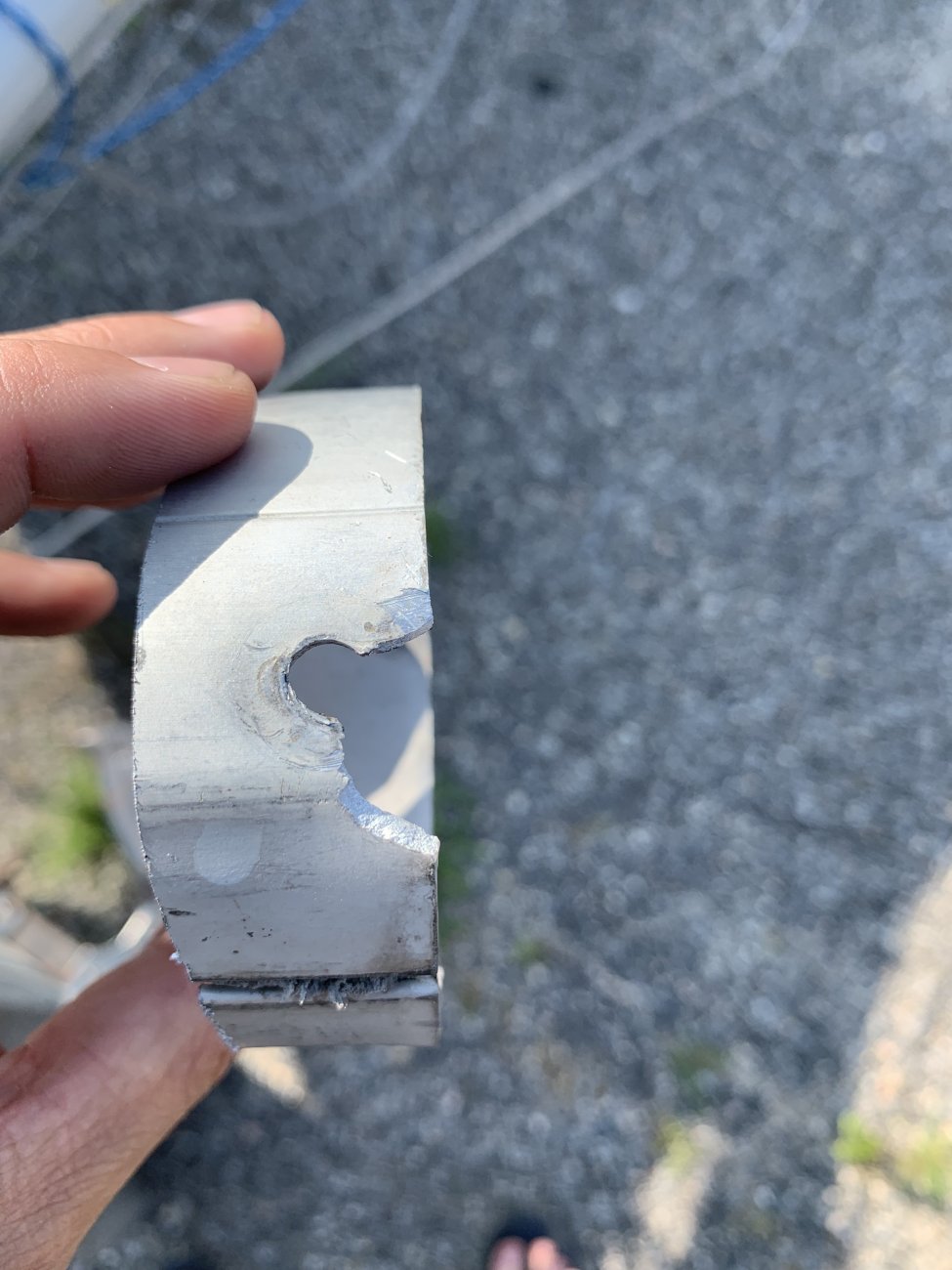

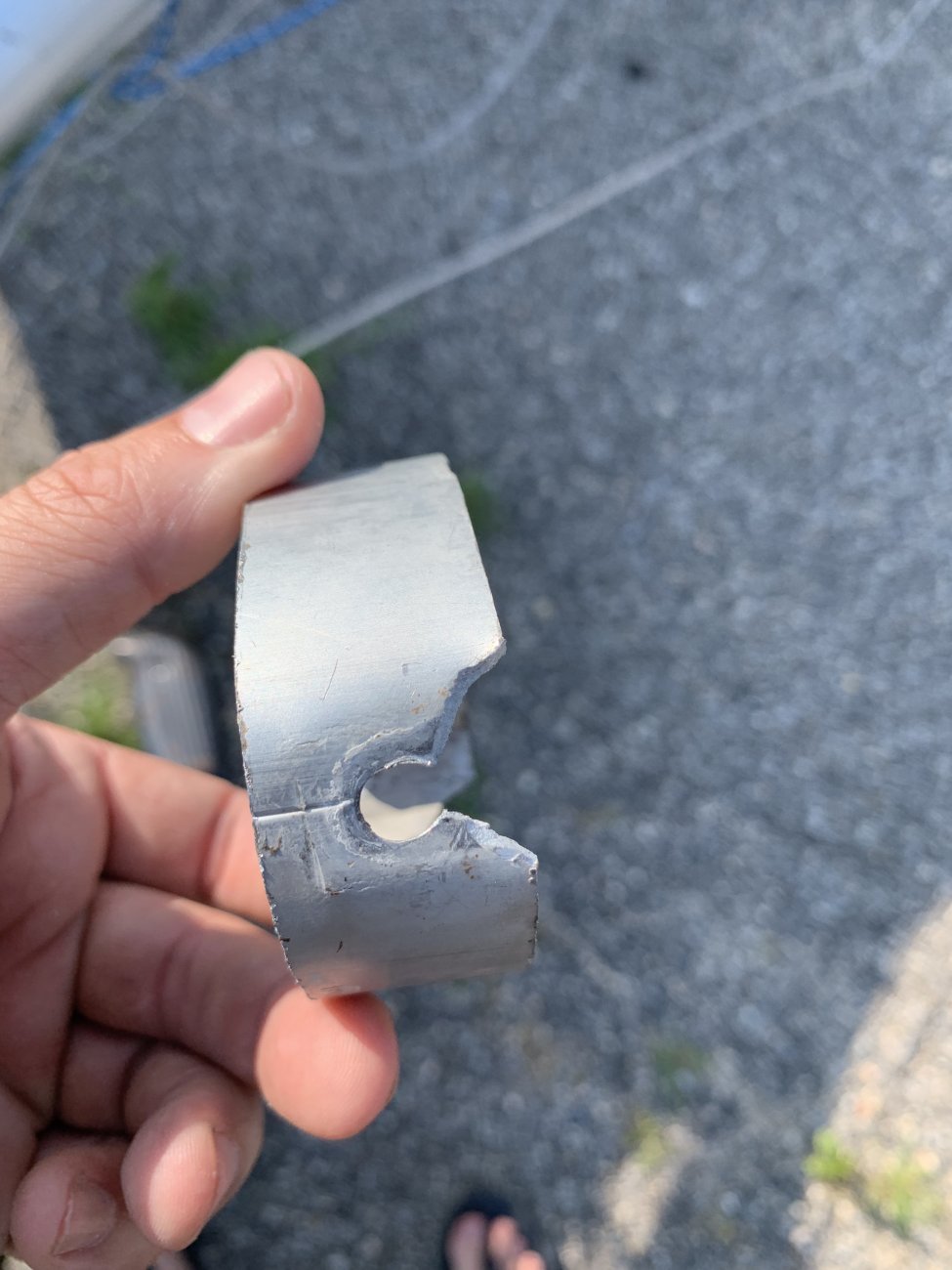

So, I waited to cut until my 1” thick spacer arrived so I could confirm that it was actually 1”. Then we used a caliper to measure the spacer and transferred it to the mast. My dad had the great idea to put a hoseclamp around the mast as a cut guide. I decided to use a hacksaw to make the cut since it would be easy to control. I cut it slow and kept checking. I filed it a bit to remove burrs and touched it up with a bit of light grit sandpaper. In the end the mast was dead flush with the hoseclamp, 1” shorter.
Here’s what came off:
Nice cut! I wouldn't worry about the nay-sayers on this , the bottom of the mast doesn't need to do the flex like the rest of it does, once your shrouds are adjusted you should be good for many years. As far as the stainless screws and plastic washers, you can't get away from interaction corrosion, as the threads still make contact with the aluminum.

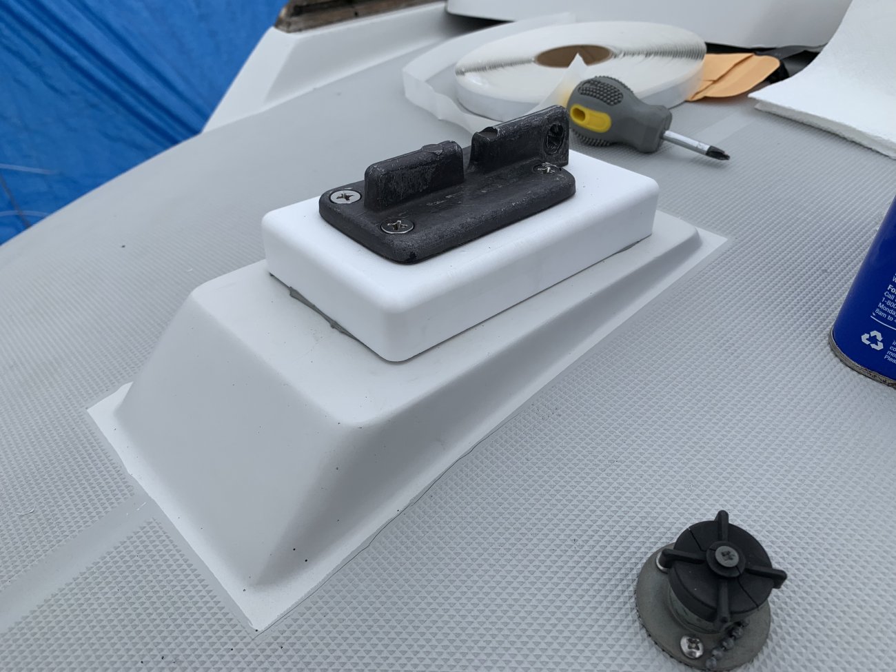

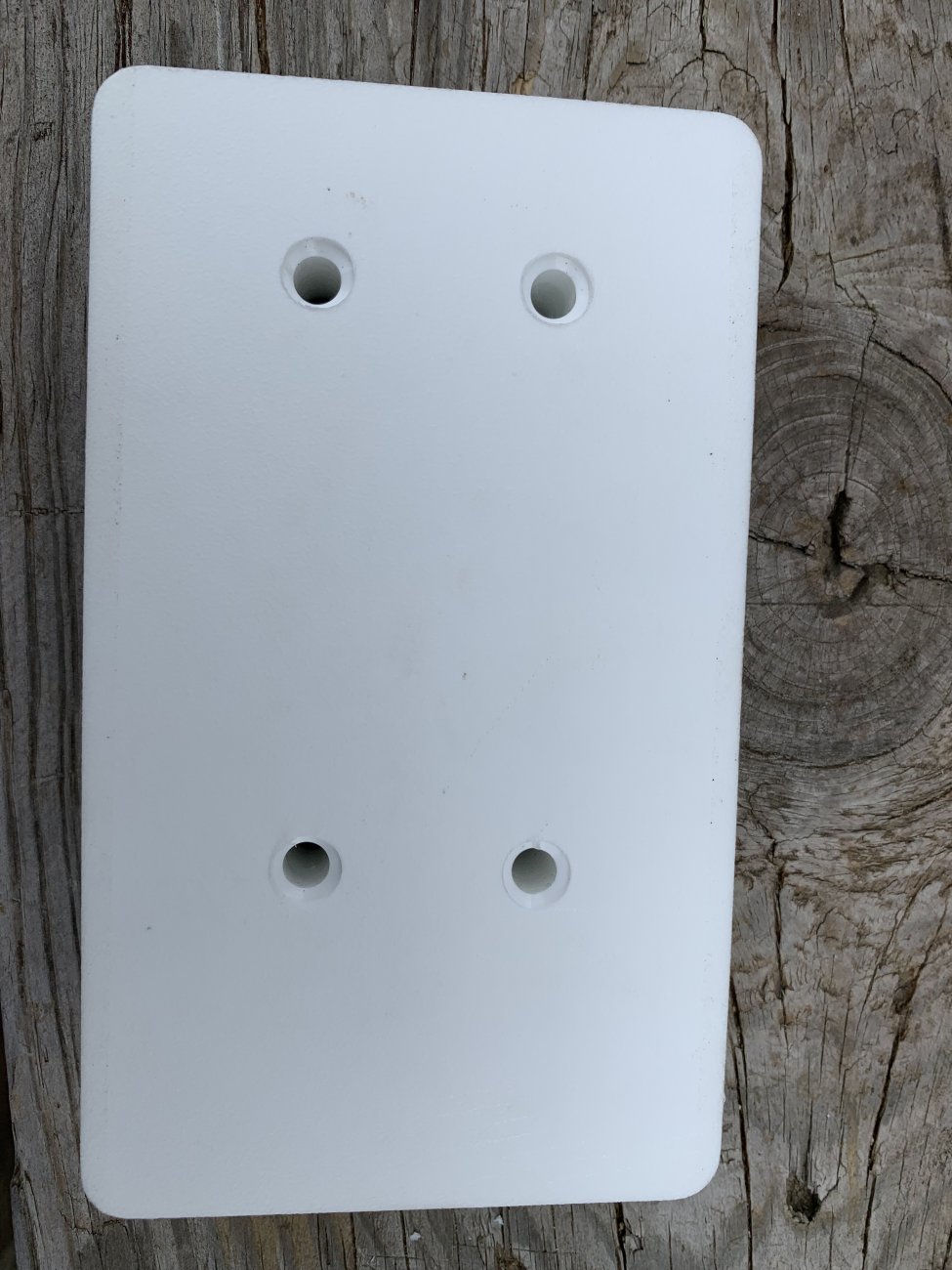

So I took the 1” spacer and drilled it on the drill press today. The holes on the bottom of the spacer were countersunk so there was a recess for the butyl tape to set in. I also had to get new hardware to install the higher step, so I got some 3” x 1/4” stainless bolts.
FYI: This spacer is 1” King Starboard.
And once that was installed, we were able to raise the mast for the first time in over a month. Of course it started raining when I started stepping it but no lightning so up it went in the dark.
The math worked out perfectly and the shrouds all tightened in their normal range. Plus, the extra 1” under the hinge allowed the gooseneck to clear the companionway better.
Everything will settle tonight and tomorrow I’ll go do some final tweaking.
