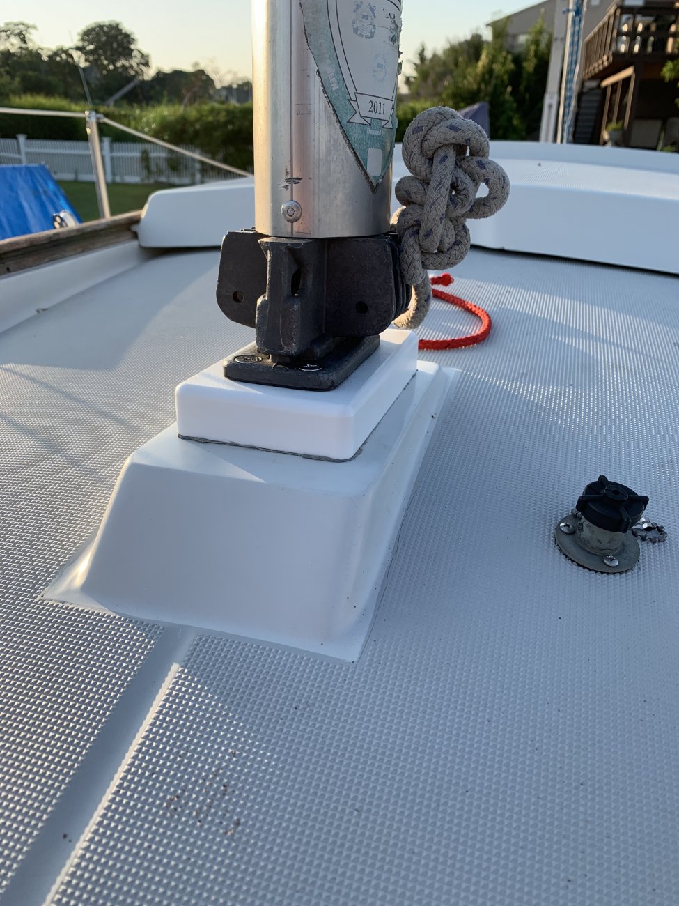

I forgot to post a picture of the spacer when the cut mast is up. I think it looks good and blends in decently. This was before I had a chance to remove the extra butyl squeeze out.
