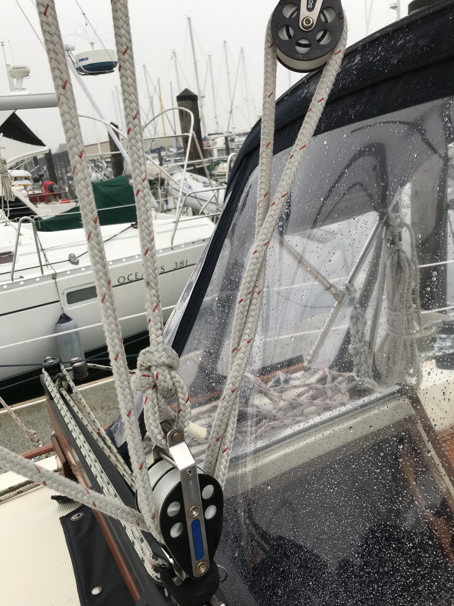

This is my main sheet. How would I keep this from twisting around itself? I have taken the line out of the blocks and re threaded after laying it out flat. Line is sta set X. This is not the original traveler setup. Some PO moved the traveler from the bridge deck to cabin top. I have wanted to move it back, however the admiral countermanded me. If it is on the bridge deck, the dodger would be severely compromised..

Looks like that block on the upper right is rotating on you. There could/should be a little slide piece to lock the block in a fore and aft alignment. If it does not, you need to get one.

That block does rotate 360 By design. I cannot seem to locate one in the right direction Without swiveling. I have never heard of locking a swiveling block in one orientation.

That looks like a Schaefer block, contact Joy and ask if there is a solution. I had a block doing the same and found some blocks didn’t swivel. I remember washing the line and running it differently through the blocks and cured the problem.
Try from the traveler to the aft block, back to the traveler and up to the mid block, then back to the traveler and on to the fore block.

Would the twist be corrected by changing the threading of the block on the traveler? Try to thread the line differently by switching the side (port or starboard) that the lines go through now.

The mainsheet has probably developed a natural twist in it over time, much of it induced during coiling and uncoiling. One way we used to eliminate it on small boats was to let the mainsheet drag behind the boat for a few minutes. Also we would switch the mainsheet end for end occasionally.

Don't know your line size, but to give you an idea, this is on SBO chandlery. Schaefer Marine 60 mm 7 Series Block - Aluminum Sheave This one changes by a set screw, while others have a slide switch. BUT, come to think of it, If you can find a block that does not even swivel, you'll save money since you really do not need the swivel. Also, once a year if you strip the boat for layup, launder the lines and reverse them, end for end.

The blocks should never rotate, not a single one. In the old C34s, like mine, they didn't "get" the problem until after the first few years. My PO used thin string wrapped around the swivel on the block to keep them straight. I've since replaced the blocks.
Stay Set X is absolutely the wrong line to use there, because who is worried about stretch on a sheet? Besides, SS-X simply sucks in all other regards. Whether you use Jack's idea, or just use Sta Set regular or some other Samson line, the stiffer X isn't helping and could be developing its own memory, "like a rock." :)

I can see where I think the block needs to swivel. Will play around with it at the dock. Perhaps some salsa is in order. I lied bout the rope type. It is only sta set...and YES that is smoke in the background. 1/2 mile visibility. Sometimes less. Sailing by plotter, AIS, and radar...Supposed to be getting some rain end of week.

We had that problem with our main sheet, too. Took it out and trailed it behind the boat under power for 15 or 20 minutes and the line relaxed and never did it again. I've had other lines that required a couple of these operations, but unless it is just too old, braided line should relax being towed.

I have a block in that location on my C30. It doesn't need to swivel, just swing a bit side to side. Locking the swivel will work. Garhauer blocks can be locked so they don't swivel.
My problem was the line was over wrapping on the lower block when it was slack. Locking the block in the fore aft position solved the issue.
