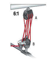

BTW, anyone else here ever ponder the leading of the sheet thru a a 6 part Harken set of blocks.... and have to finally look at their diagram on-line to get the end of the sheet to come out the the correct sheave??
Yeah, it's probably just me....
