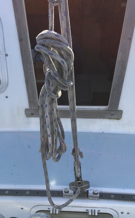

Ron had it right. Lock the block. This is a COMMON problem and COMMON rigging error.
No, it does NOT need to swivel to allow for motion. A shackle or two will allow enough movement. Yes, many brands of swivels blocks have locking mechanisms built in for this reason. You may also be able to do this with rigging wire or cable ties.
No, there is probably nothing wrong with the line, although it is possible a winch is adding turns. Lock the bock first, THEN see if the problem persists.

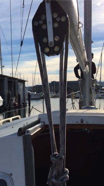

That block does rotate 360 By design. I cannot seem to locate one in the right direction Without swiveling. I have never heard of locking a swiveling block in one orientation.
Take a closer look at the head of the block. There should be a method to lock it's orientation or allow free swivel. Here's an excerpt I found in Schaeffer catalogue... may not be yours, but is an example of what you may need to do. Harken and Ronstan use a different method for this depending on block size. Perhaps a blow up of the blocks head will give us a clue.
Three way Swivel head rotates 360°, or can be locked in place with the simple set screw adjustment. See page 13 for our 5 Series Universal Adapters increasing the ability to use your block where you need it.

Went to the boat today. Stopped in at West Marine and looked at blocks. Some had locking mechanisms. I learned something today. Went to the boat and looked at the block hanging off the bail on the boom. I noticed a small allen hex head inside a small hole. Turned the block in the right direction and tightened up the hex bolt and it tightened up. This an old block so we’ll see how long it works. I know what to do if it fails. Thanks for all the suggestions!

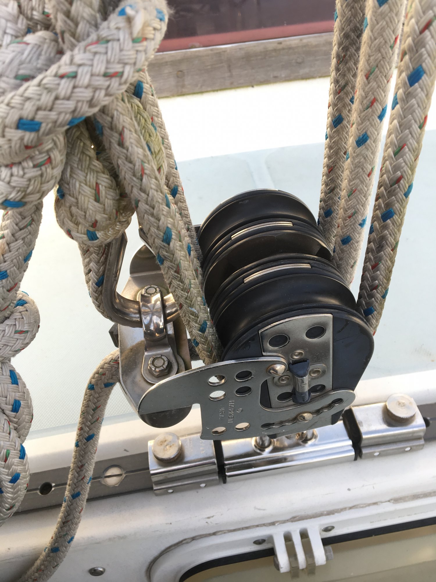

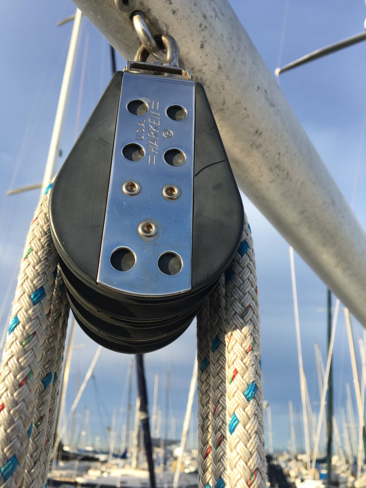

Mark, I feel your pain when the mainsheet works against you. Perhaps the fiddle block is not enough.
In 2015, when I purchased Hadley, she came with a Shaefer 2 sheave cascading fiddle block on the boom and a single sheave cam-cleat block on bridge deck traveler. Mainsheet was about 1/2" braid. Ok for gentle breezes but a lot of work as a solo sailor to manage in a stiff wind.
2 three sheave Harken blocks and cam-cleat, and 5/8ths sheet with enough line to put the boom on the shrouds. Sure the line is a bit heavy and there 3 block rig requires a lot of line, but the hand feel is fabulous, and I can easily control the sheet with one hand, as recently proven in 30 kt gusts. A sweet deal. When I installed the rig on my boat I saw that the lines had not been lead through the block properly. The lines were crossing, adding friction to the system, making it difficult to let line out or draw it in. I rejigged the blocks correctly and now they run smooth as silk. Also helps to occasionally rinse the blocks and carefully add a bit of lube to the bearings.
