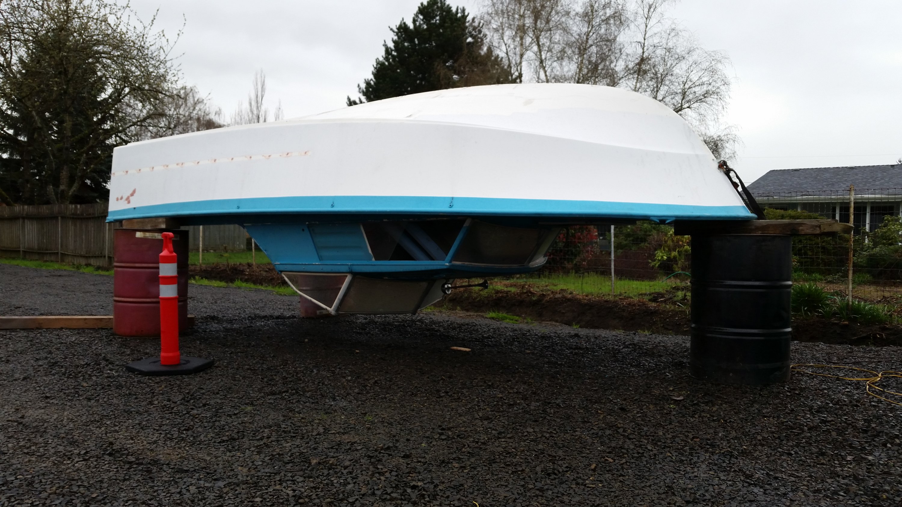

the title of your post, "Mac ceiling paint help".... here is one of the best tips that will help make your job easier when painting the boat, no matter if your working on the topsides, bottom, or cabin roof.... it also works well when repairing soft decks from inside the boat.... and sorry about the powerboat picture, but it works just as well on sailboats..... do this and it will cut your effort by 2/3rds:biggrin:....
