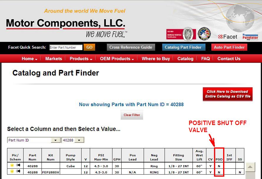

I may be missing something here, but as previously mentioned, a failure of your lift pump to operate MUST NOT cause a loss of fuel flow to the HP pump. This is shown here:
On an H-310, the fuel tank is pretty much above the level of the HP pump exept when near empty. You will not notice any change in running WOT if you shut off the electric lift pump. Not unless you are near empty and then all bets are off. Do you really need a spare for your set up ?

I may be missing something here, but as previously mentioned, a failure of your lift pump to operate MUST NOT cause a loss of fuel flow to the HP pump...

Apparently I don't need a second pump if the system can operate with no lift pump (as long as it is primed). I do understand that the pump must have an internal forward bypass to allow fuel flow while pump is stopped or DOA.
