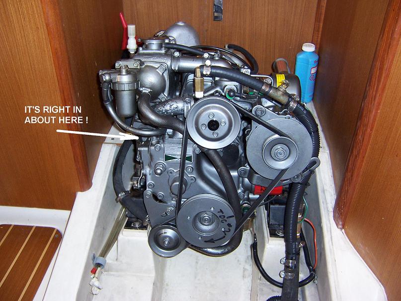

Are you really going to try to get that pump back in there:
You'll be trying to get the arm to land on the appropriate cam and it's none too friendly.
Please let us know how it goes.

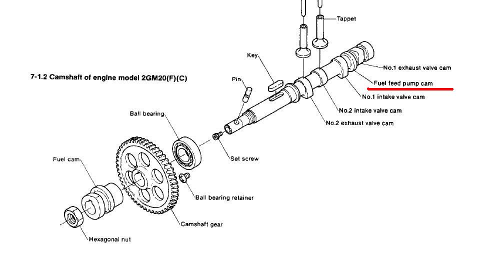

As far as replacing the bolts with studs in the block, in theory a good idea but still difficult to do if you're working blind.

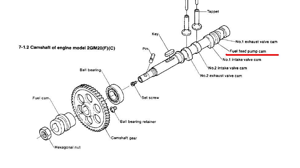

Your target is to get the arm of the lift pump dead centre ON the "Fuel feed pump cam" as shown below. I thought I had it but it slipped off to one side and when the bolts were snugged , the arm of the pump was bent.
One new pump into the scrap heap.
Use extreme caution to ensure you've hit the target. Good luck.
