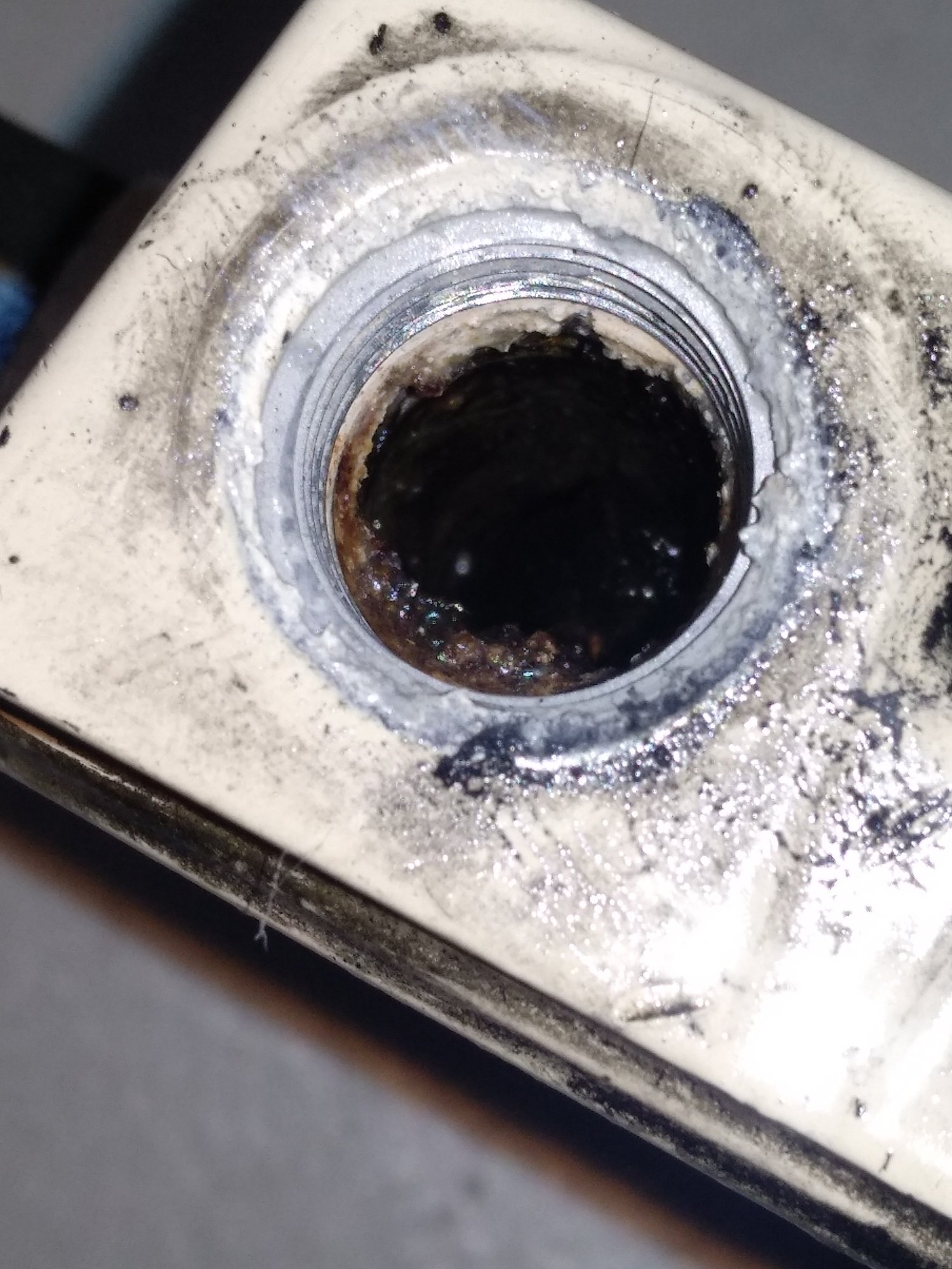

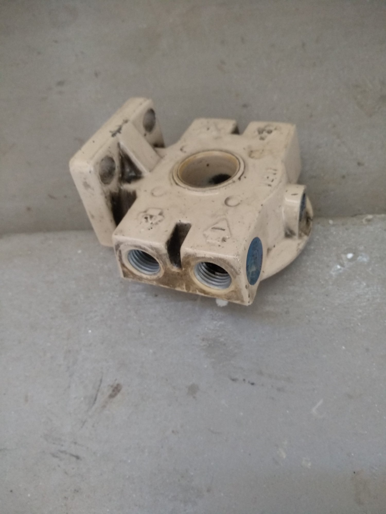

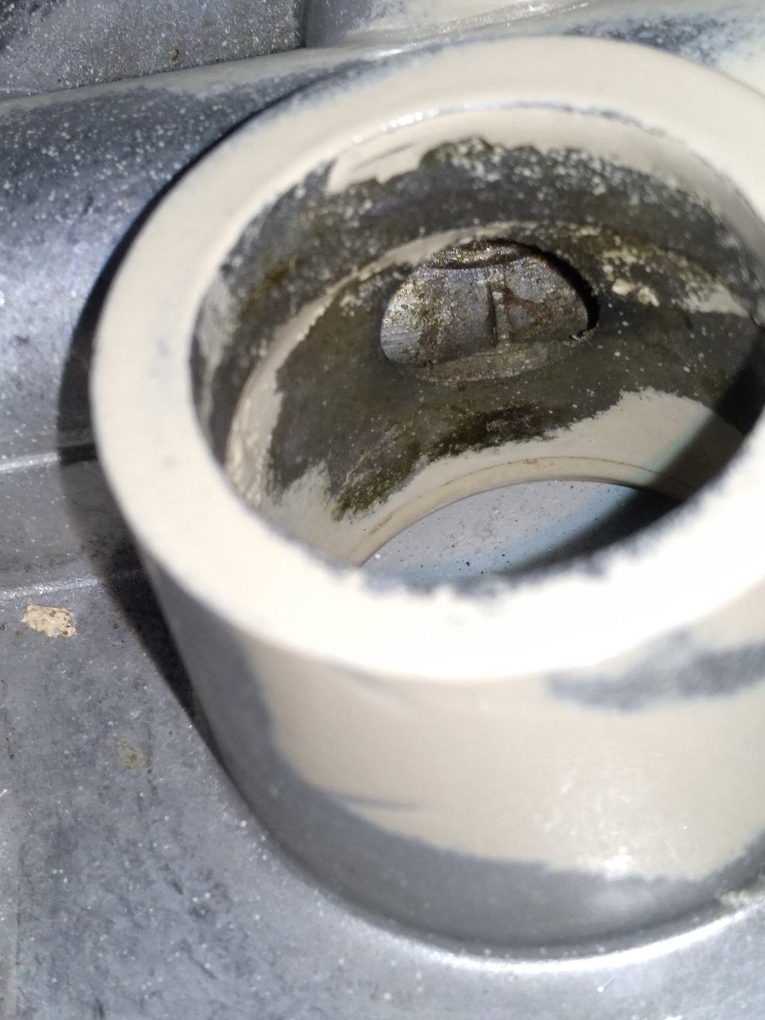

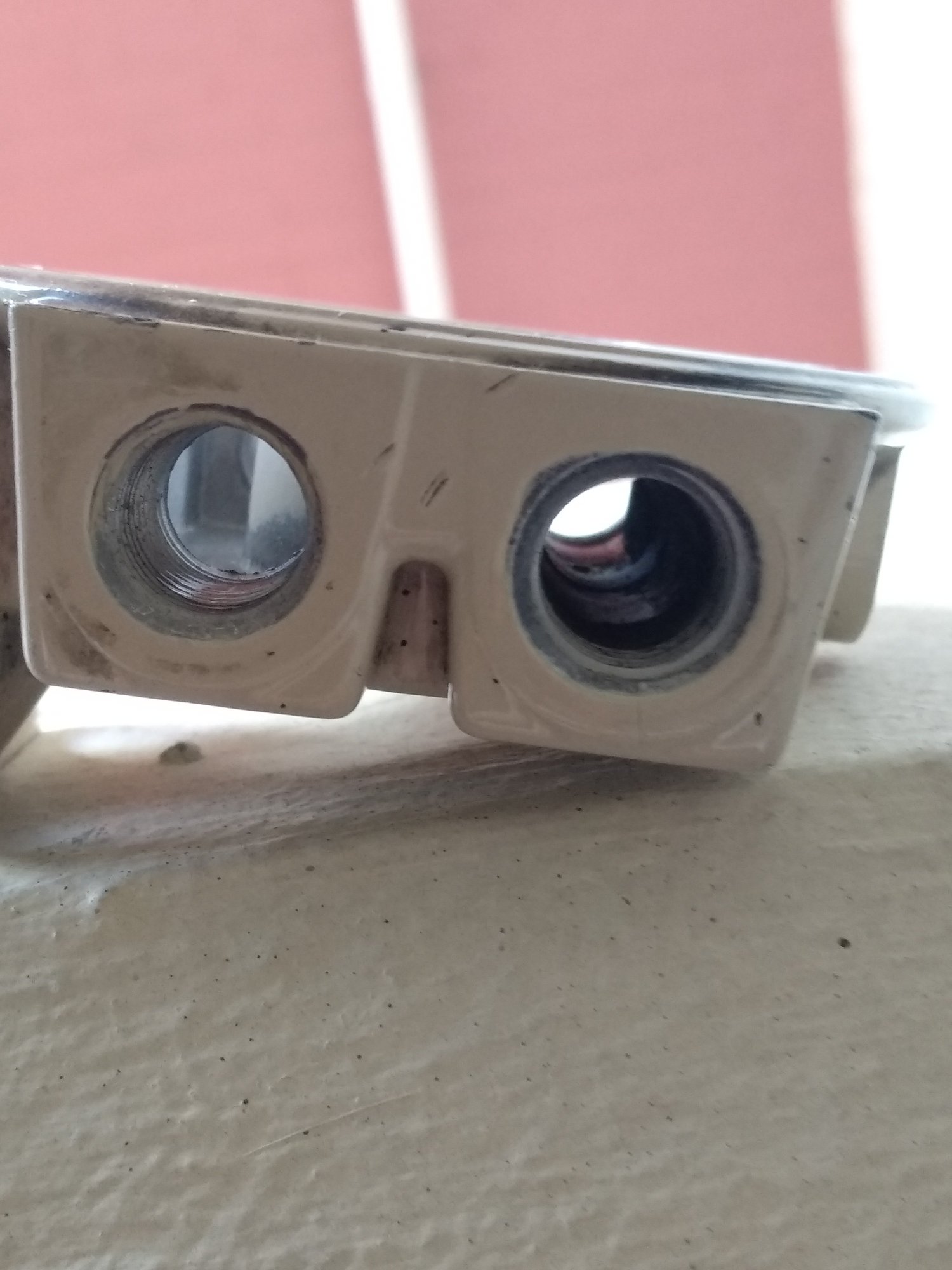

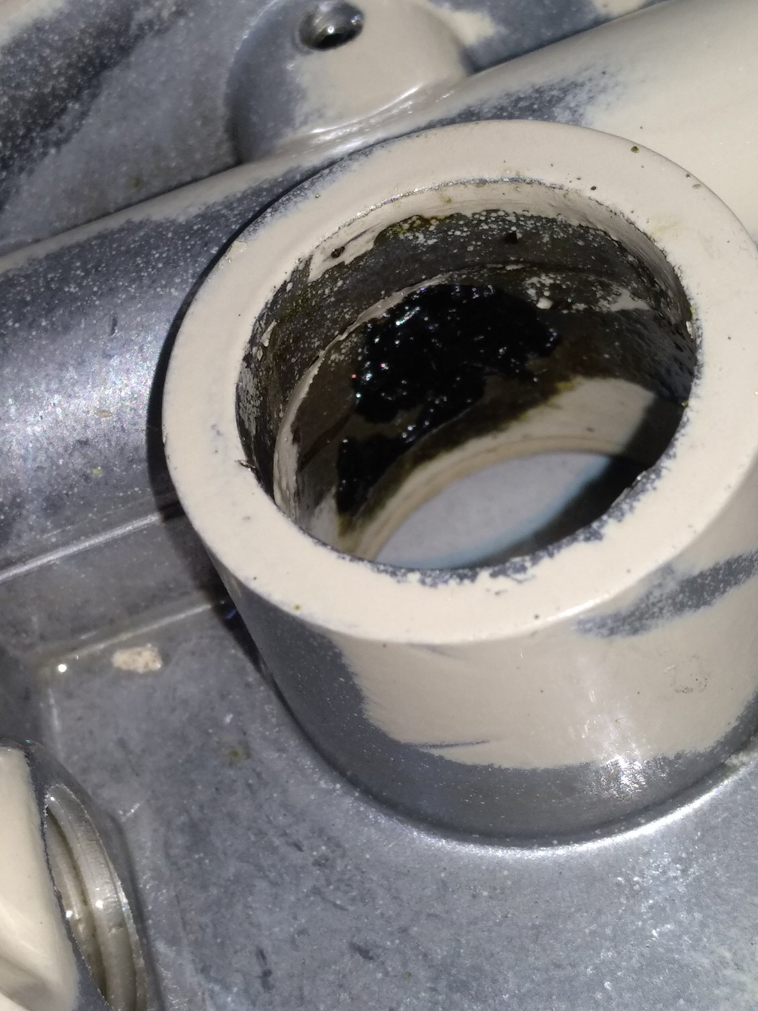

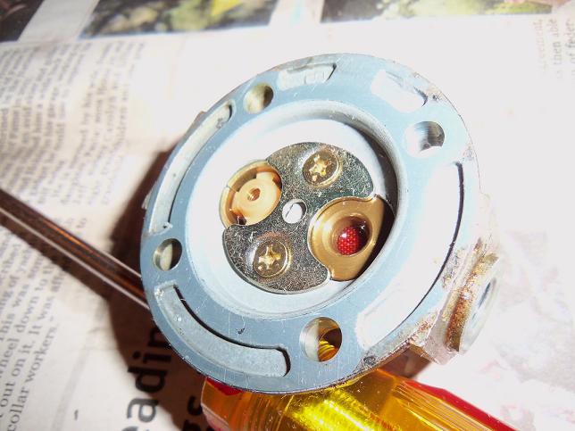

Finally!! Problem solved. Start by bleeding air from hp side. Not much bubble. Ran engine at usual test rpm. Starving at 2800rpm. Checked sec.filter, vacuum on hp side and empty on inlet side. Didn't suspect LP Pump 'cos it's brand new. Remove Racor filter assembly and found gunks in filter head at inlet and inside passages. Decide to installed a brand new simpler version of Chinese copy of Racor filter. Fill up with diesel prime LP pump to bleed air bubble and ran test. Initially rpm was unstable. That's to be expected. Shortly rpm stabilise and push it up to 3000 then 3300 and finally 3500rpm. Stayed there very stable
So problem solved. Gunks stuck in inlet passage of Racor filter head assembly.
First 2 photos shows the gunk choked inlet ports. Next 2 photos show cleaned Racor head unit.

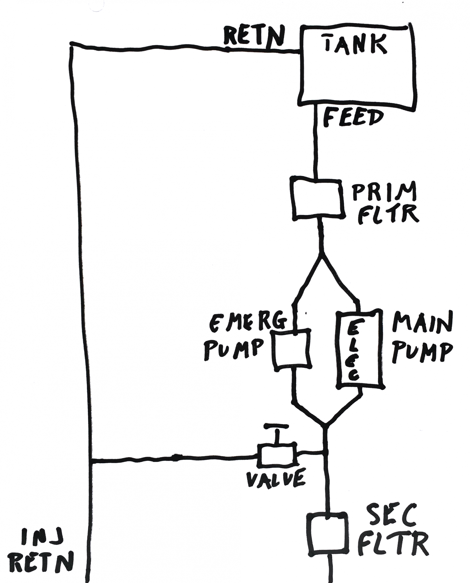

Thank you both for your detailed input in this thread. I initiated a different thread regarding draining the separator and eventually found this comprehensive thread. I love the proposals you guys (and others) put forward about a revamped system that is more reliable. After studying the entire thread I am going to put off my filter change (no water in separator) until spring when I will drain the system and modify it. I now have a proposal that I think can simplify your proposed changes and add even more reliability at very little cost and effort.
I will decommission the existing mechanical pump because I hate the ramification of a failed diaphragm and have no desire to trash an engine over it.
My system will have the tank feed a separator then to a pair of pumps in parallel which will feed the secondary filter. I may try to replace the secondary if I can find a suitable filter and a straightforward way to bleed air. I have access to CNC machinery and can easily make a fuel pump block off plate.
My variations on your combined themes will be:
1) a second pump in parallel for both emergencies and bleeding. Thge main pump will run with ignition on. The emerg pump will be wired through an existing switch on the engine tray. The momentary switch will be replaced with an on-off toggle switch. This way, in the case of a main pump failure, I can manually start the emerg pump. I can also use the emerg pump to bleed the system. Other than those instances, the main pump will be the only one running. In my mind there should be no need for any plumbing other than simple tees before and after the pair of pumps.
2) The primary filter bleed valve. I don't think a 3 way valve plumbed as a Y is necessary. In my proposal, a tee feeding a 2 way bleed valve should suffice.
Is this logical? If there are problems with this arrangement I would like to know and you two have more than supported your knowledge on the system.
